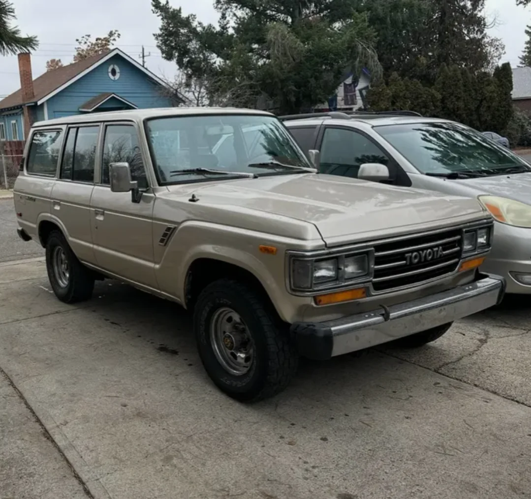

Looking for some real time help wanted. I'm going to be looking at an '88 FJ62 in a couple hours. It's a pretty clean rig, 245k miles. Bone stock. What I know so far:

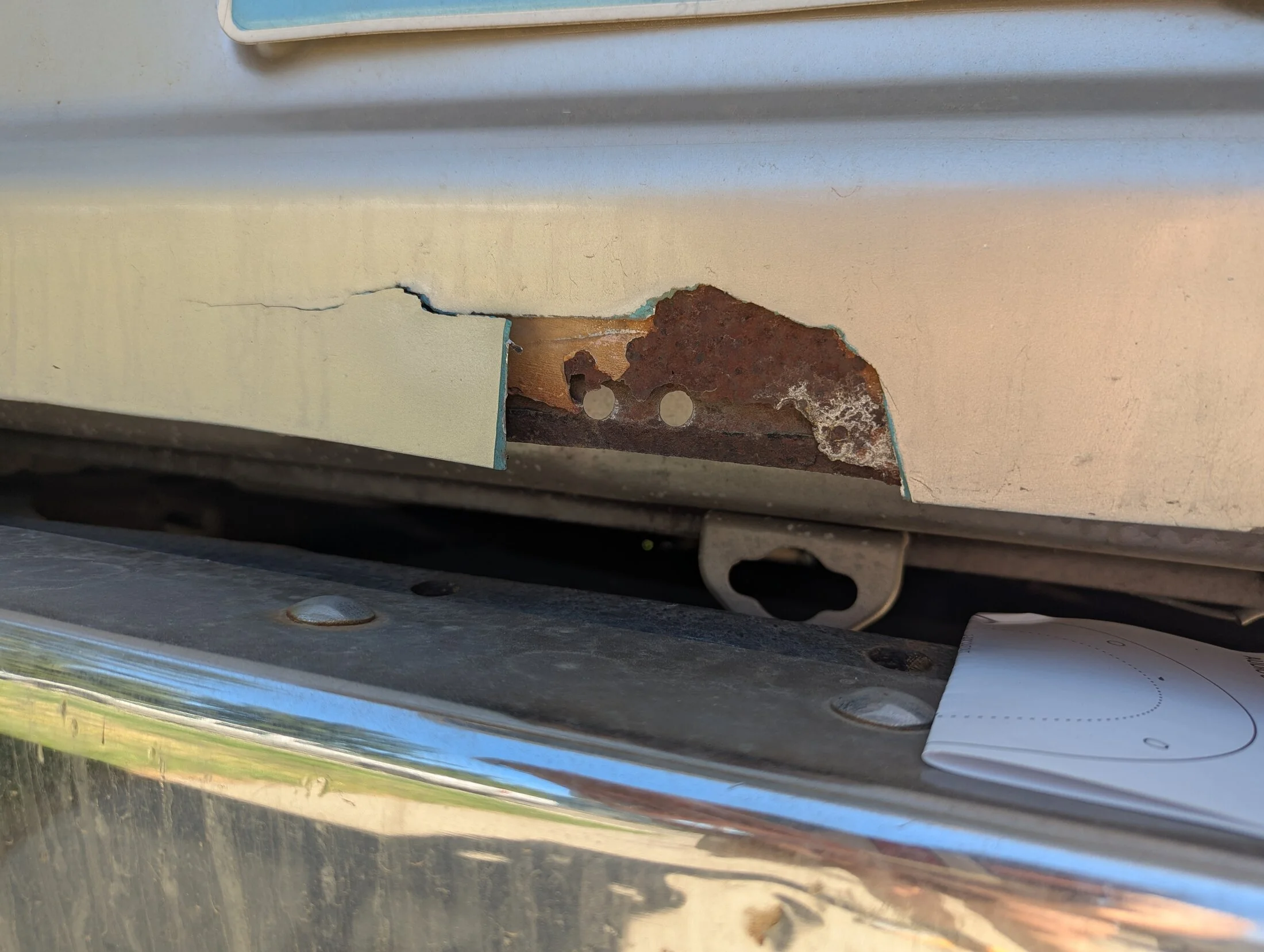

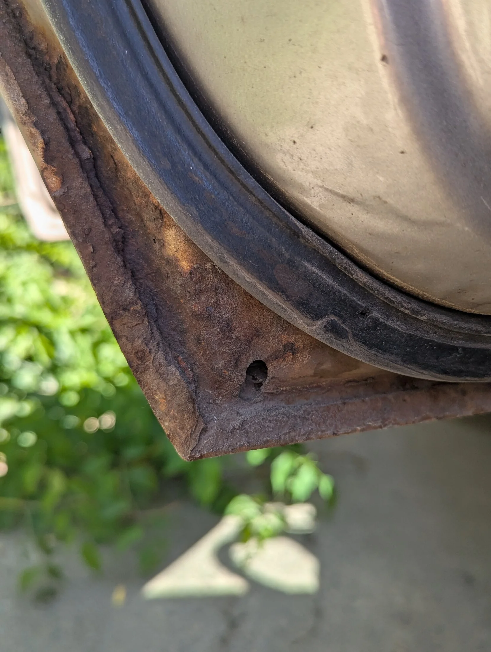

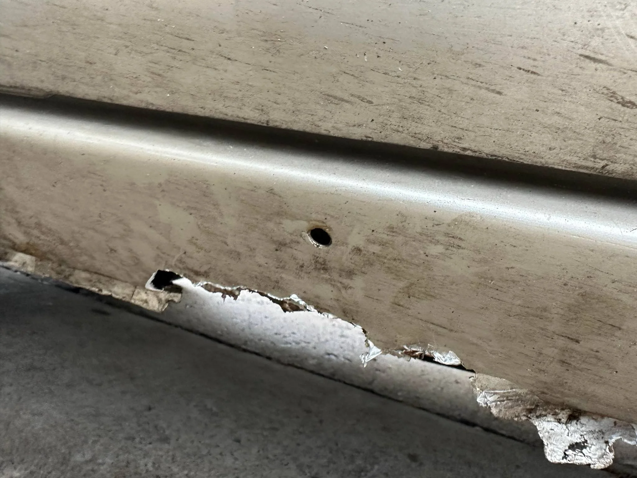

- right rear rocker has rust and supposedly a little rust on lower tailgate. Otherwise, I've been told all panels are, wheel wells are is great shape.

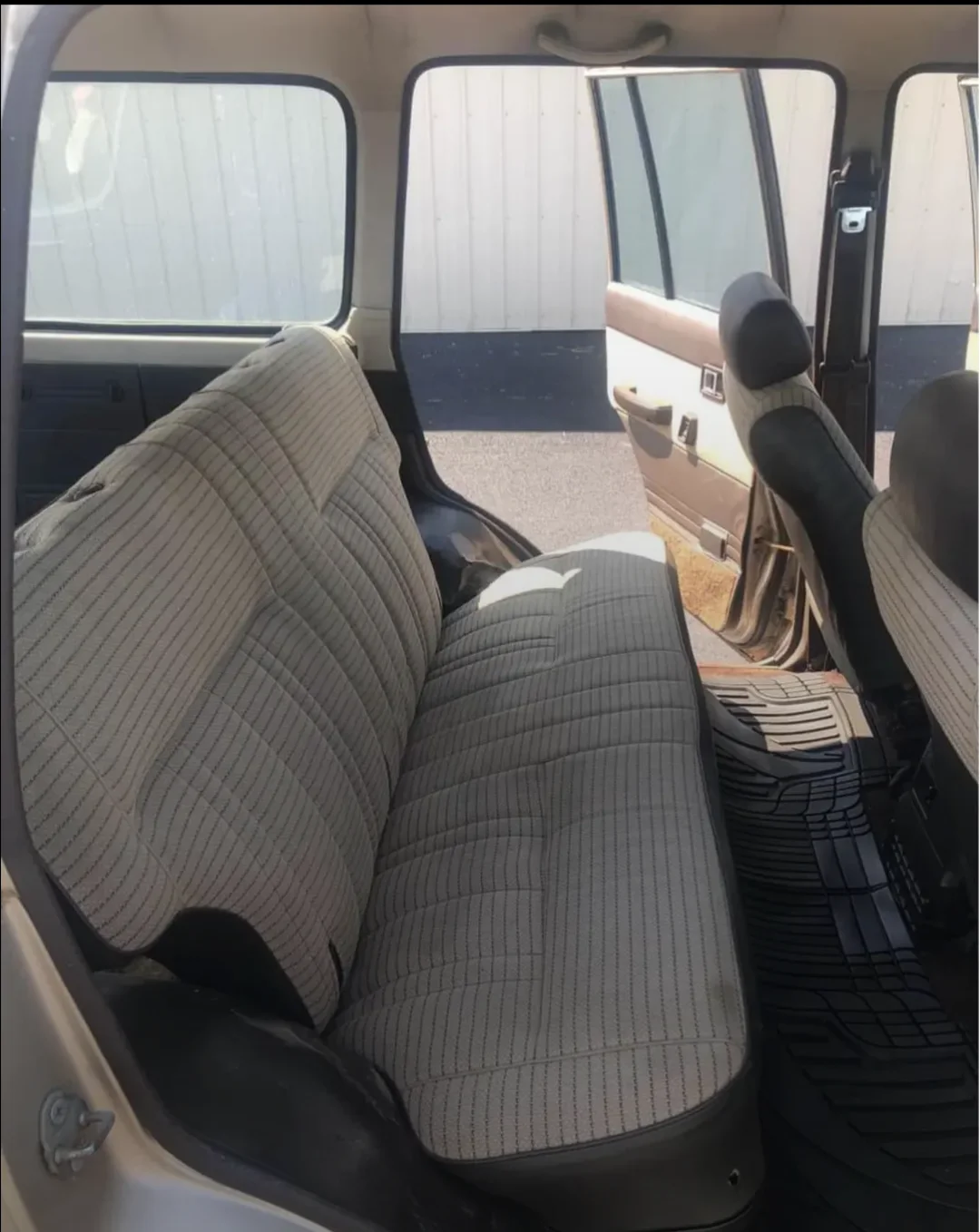

- Interior has had seat covers, seats underneath look to be in very good condition.

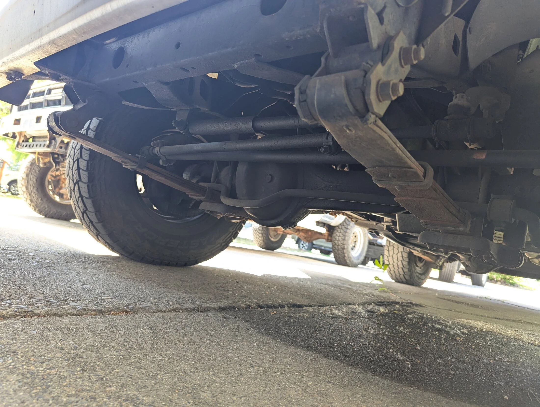

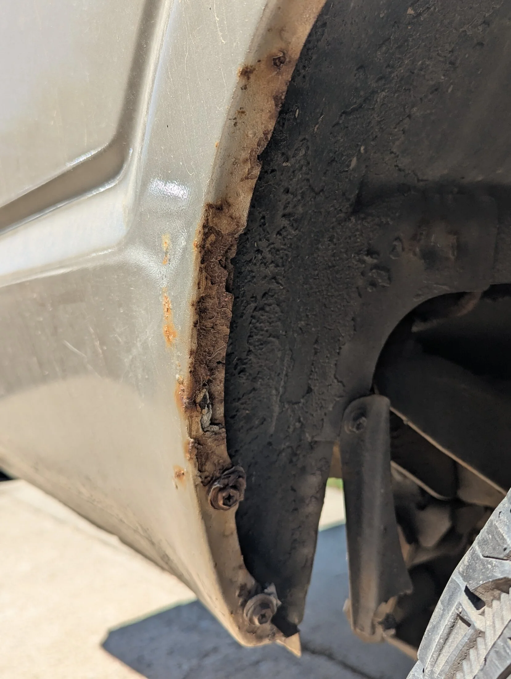

The frame doesn't look bad, but I don't like the door and rocker rust. Dunno, for the right price it might be OK.

He's asking 12k

Not the right price for me. I'll let others chime in. I guess after owning one for 20 years I would want to start with another that is as rust free as possible. If you could fix, or pay someone else to fix, the rust problems I'd look into what would be involved with that cost wise and figure it into your offer.

The shocks are toast, steering stabilizer needs to be addressed and the rear main seal.

Interior needs Could use a good detailing.

With the visible rust on that I would walk away at $12k. Unless you are ok with driving her knowing she will keep rusting away and showing more character with age.

Yea. With more thought, the body work is more than I want to get into right now. So the search continues for an FJ62. I'm still trying to budget 20k or under (of possible).
