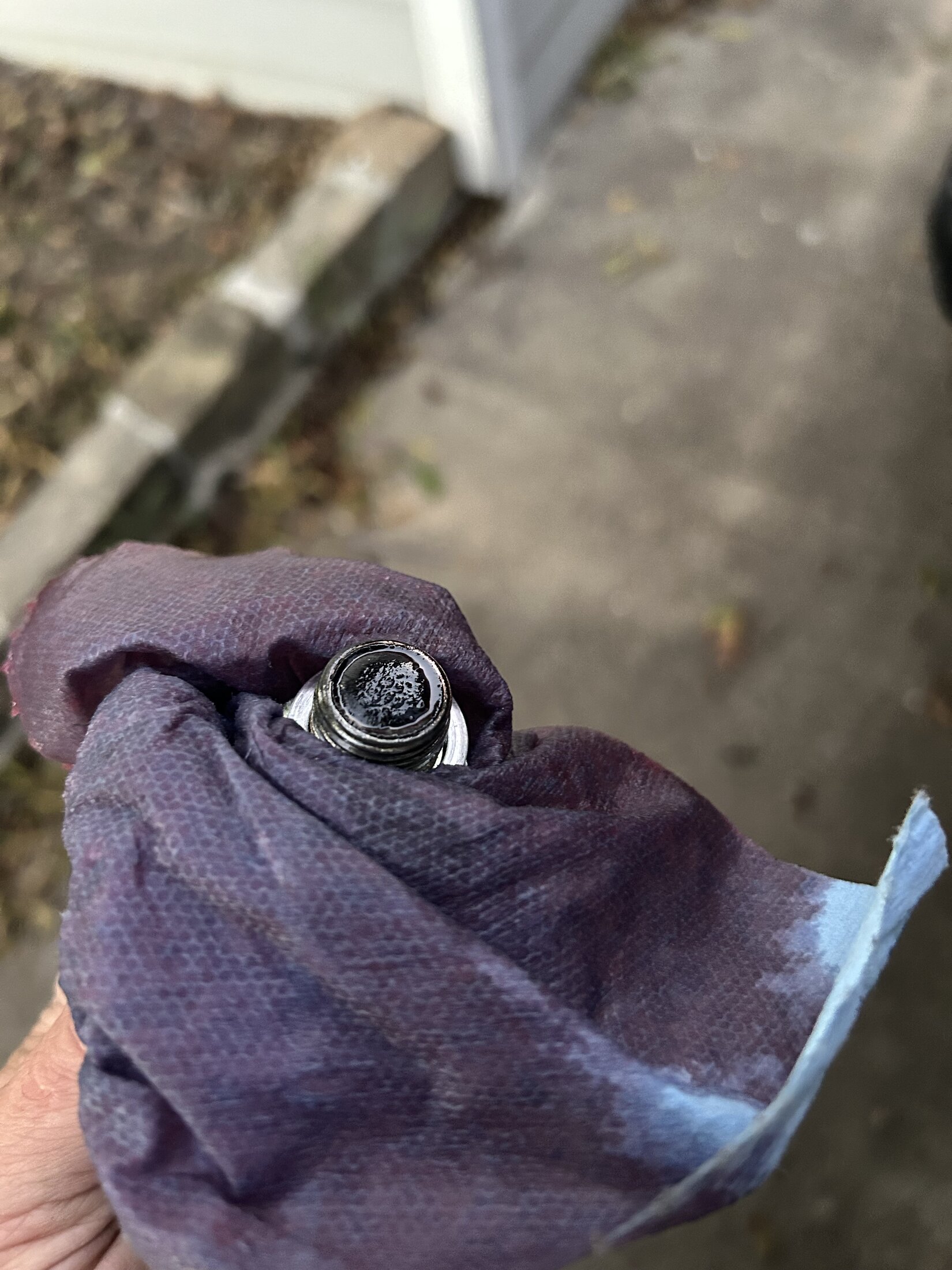

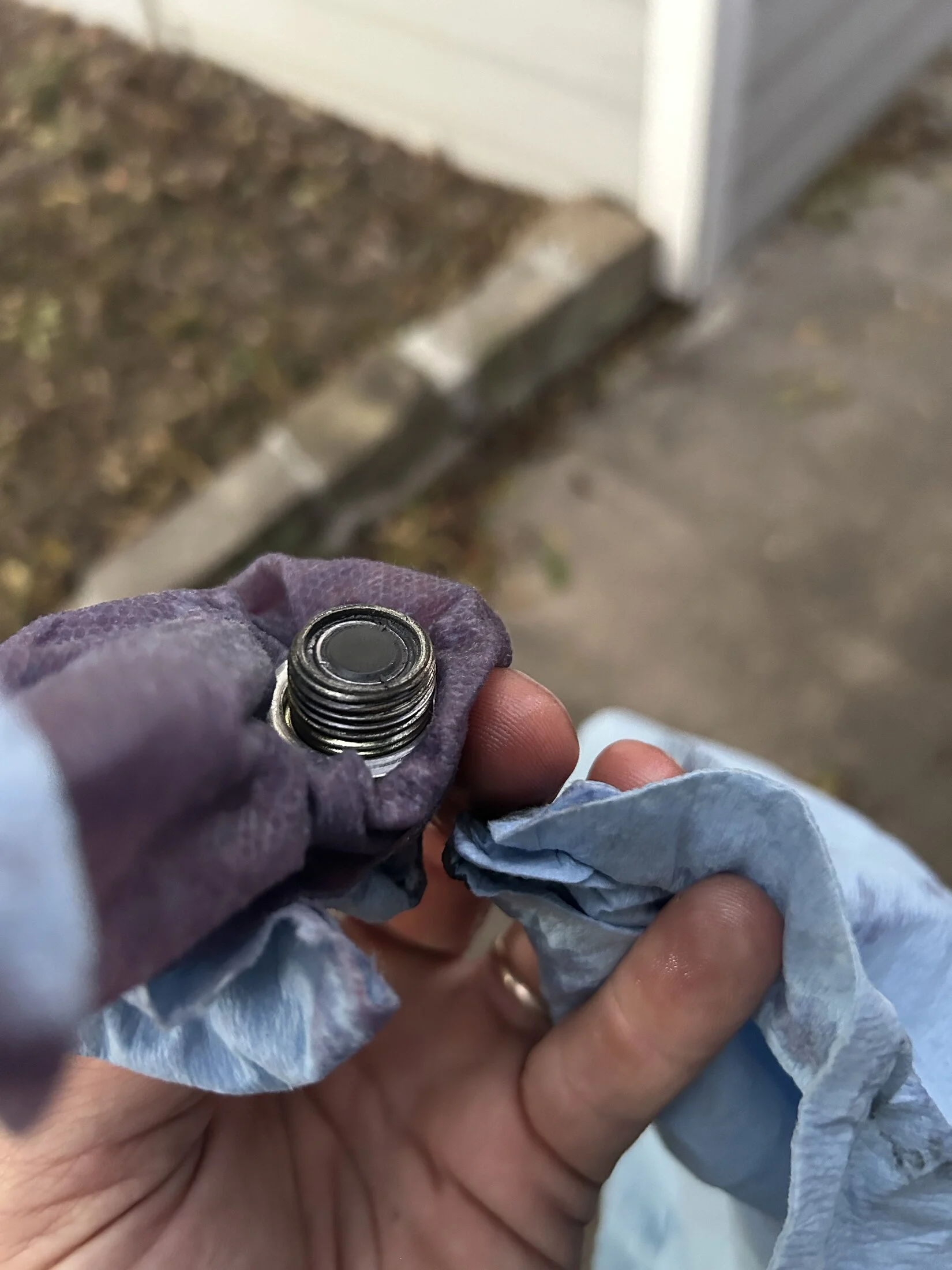

Pulled the plug, fluid looks good and doesn’t smell like the fried ATF I’ve smelled before. Stinks like it should I guess.
There were some fines on the plug, not experienced enough to know what this means.
Pics are before and after.
