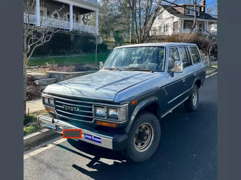

Mud, meet Gen. Waverly.
There's a story behind both the FJ62 and the name. First, the 62 - when I was in high school, my best friend's family got one new as the family car. I distinctly remember bumping into them in a Carl's Jr. parking lot and instantly falling for the two-tone paint and the overall vibe of the Land Cruiser. In a lot of ways, this truck is responsible for imprinting me with the LC bug. I've been messing with the idea of getting a 62 for at least the past 20 years, but I never had the mechanical skill, financial wherewithal, or the space to get my own until recently. So stoked for this truck to finally be here.
Next, the name. Bob Wallace and Phil Davis are the two lead characters in the movie White Christmas. Gen. Tom Waverly is their CO as they are fighting somewhere in Europe over Christmas 1944. Since Wallace (1970 BMW 2002) and Davis (2008 BMW 135i) are here, it was only fitting that the 62 gets the honor of that name, politics of its current bumper stickers aside. It was a Maryland resident its entire life after all.

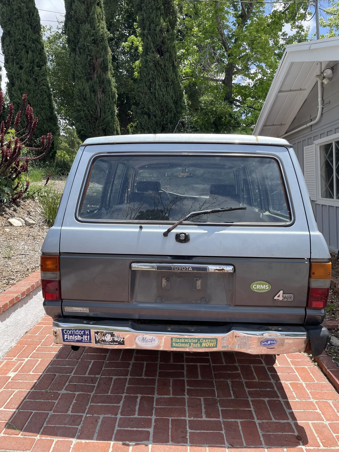

I have absolutely zero plans for it right now, aside from cleaning it up and assessing rust. Rear C-channels are swollen up a bit, and it has a few spots starting up on the roof. Doors and rockers look pretty solid. It's filthy and needs a vacuum really bad, but the plan is for a slower burn to evaluate at least for now. We all know how that goes. :)
Nice truck. Congratulations. Now tear off those stickers before @ToyotaMatt sees them.

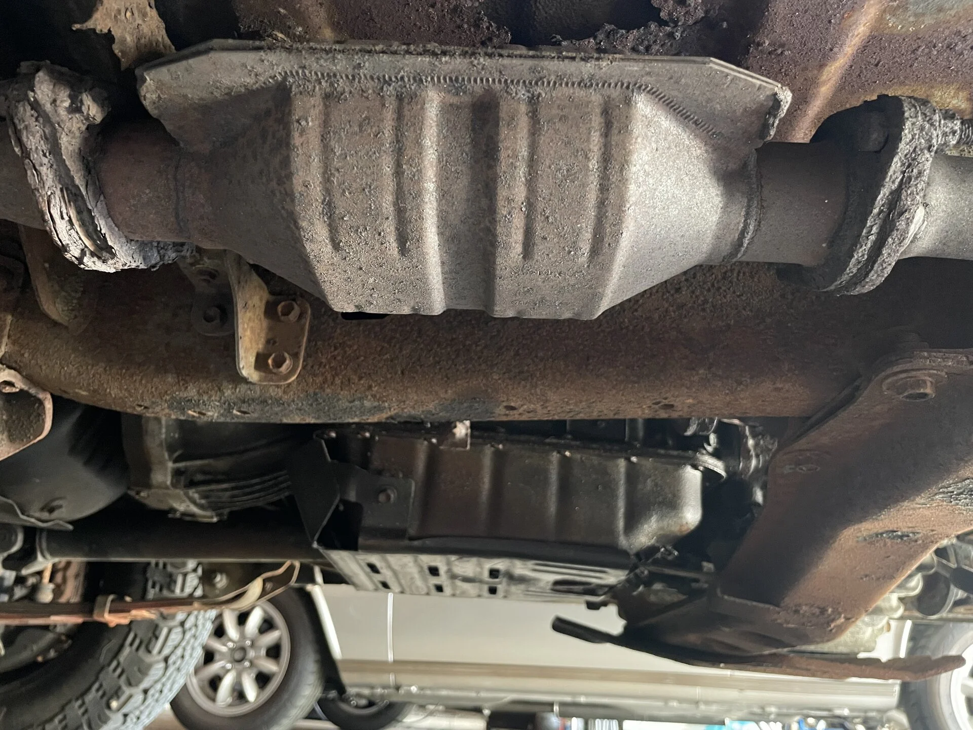

Cat is a replacement but very old, so that is on the list too. Will have to check the smog pump, but it's there and appears to be doing its job. Will run the motor and pull off one of the lines to check for air flow. Air injectors look new-ish.
I am leaning toward the idea of going all-in and doing the injectors and cat along with the rest of this stuff. I won't be receiving the fuel pressure regulator for a few weeks, so it may just make sense to start the teardown and get those injectors out for a rebuild now.
Have you priced CATs in Kalifornia lately?
It's like $250 for a Magnaflow Commie-fornia spec cat, apparently there are two. Install could be more since the old one is welded in but I haven't looked too closely yet. Looks like most of the manifold-back exhaust is available new, either OEM or aftermarket, except for that center Y-pipe.

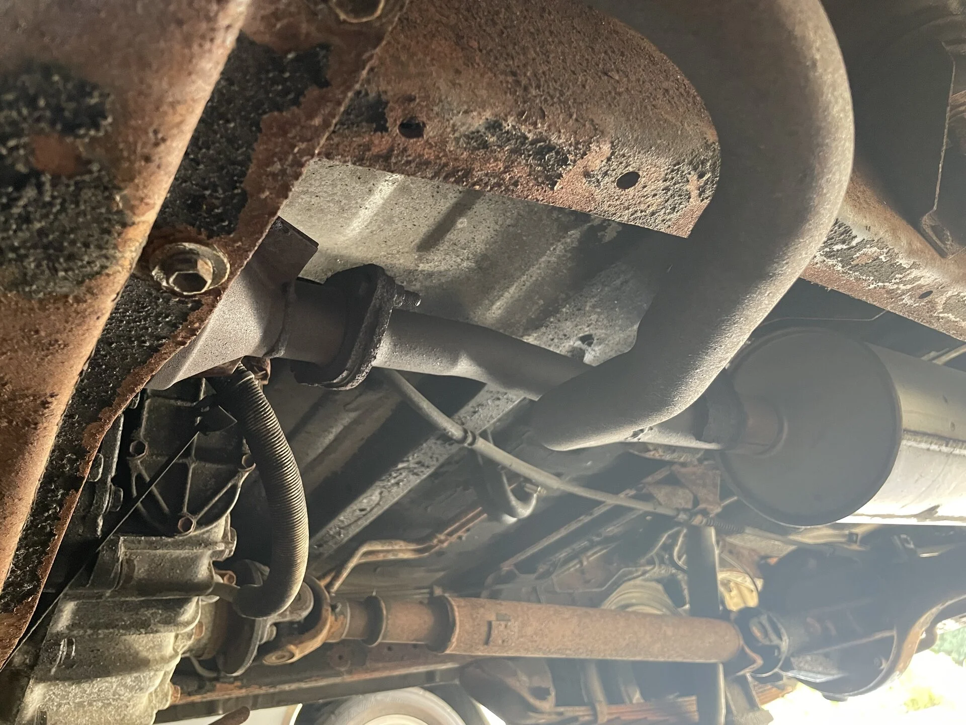

Y-pipe looks ok here, but the downpipes and cats are a rusty mess. I can do the cats and downpipes myself, since cat back looks ok.

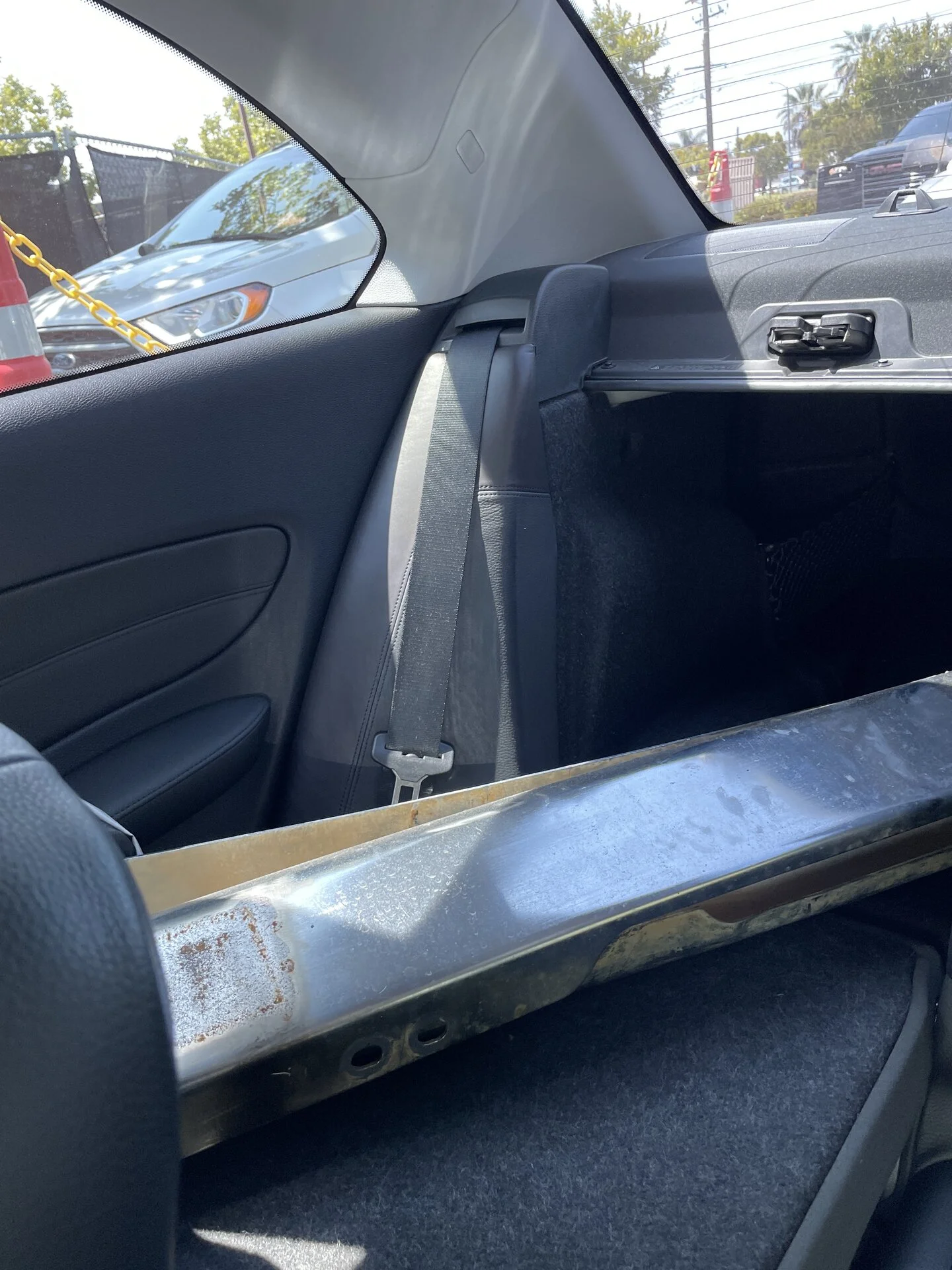

Bumpers! These are in decent shape, think the front is 62 specific but we’ll see. Seller says it was too big for his 60.
