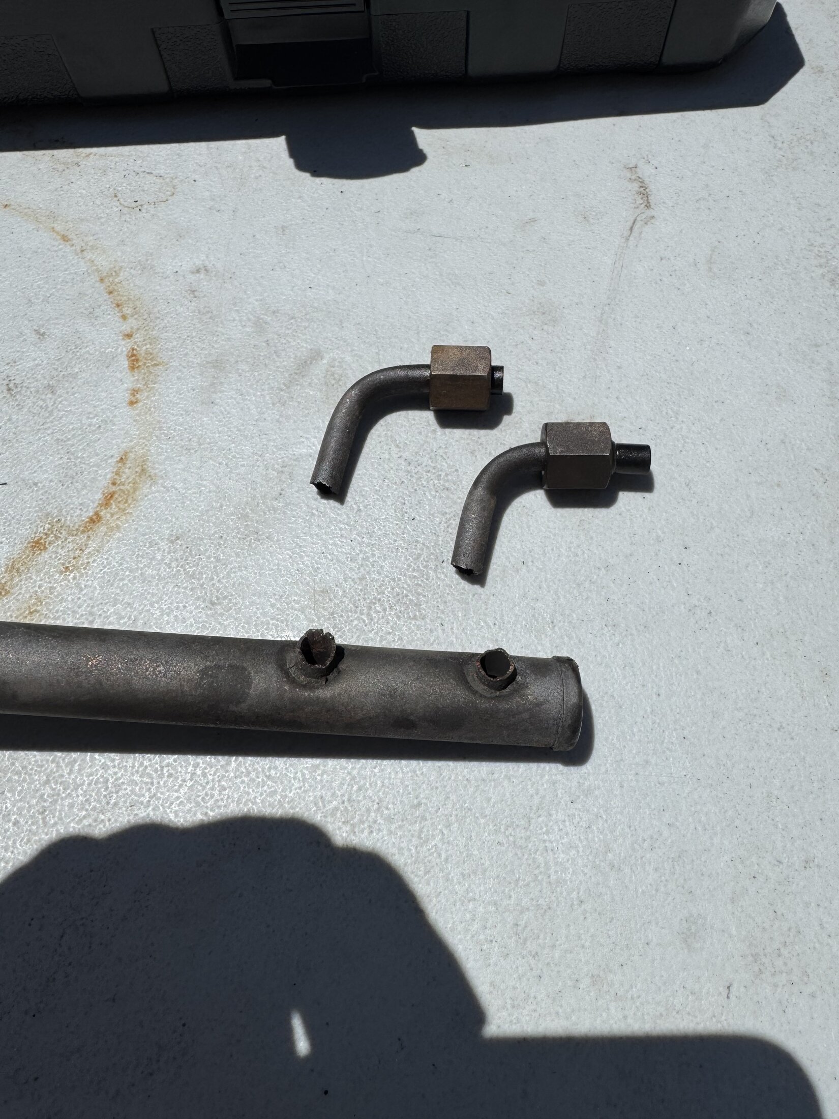

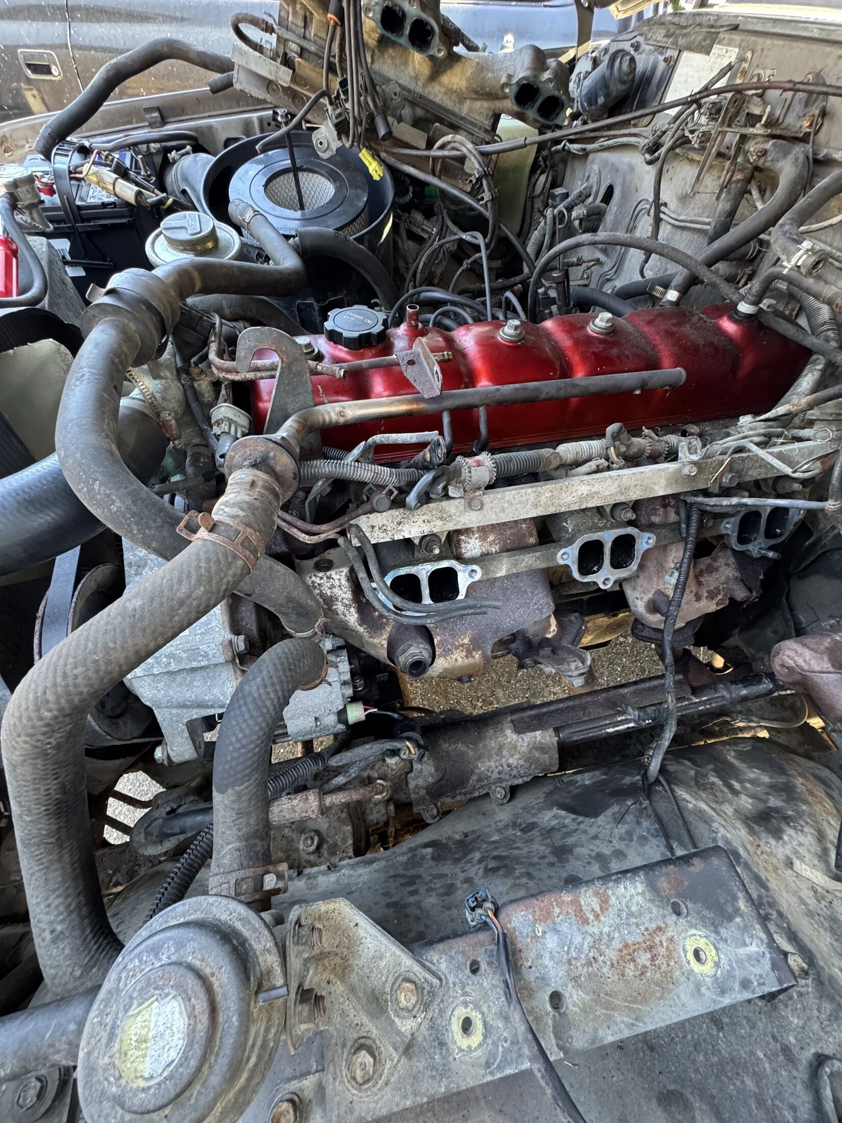

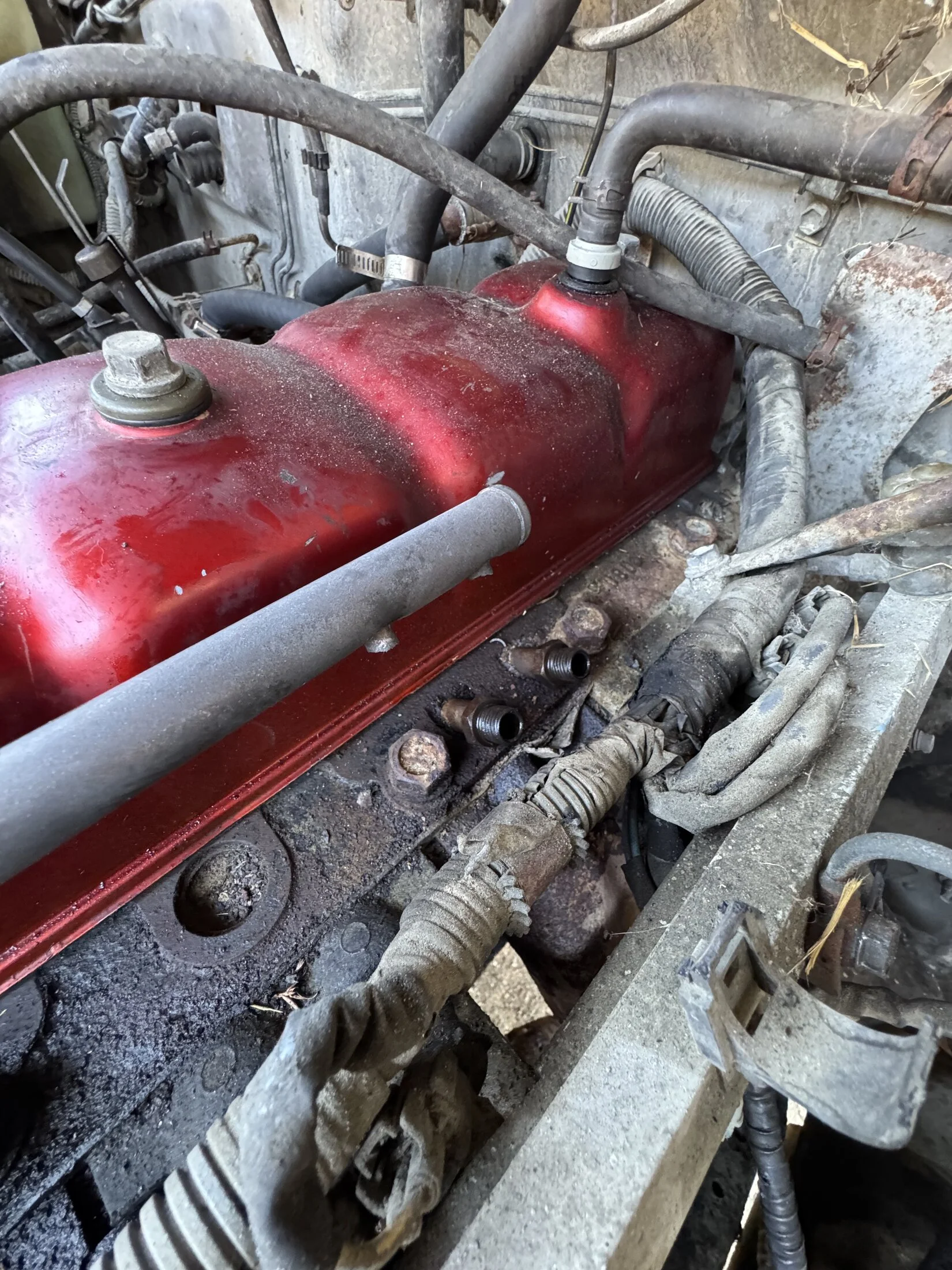

Hello everyone,
Recently developed a pretty strong ticking noise. Adjusted valves to spec with my Toyota repair manual. Didn’t fix it. Moved on to my next thought being an exhaust leak. Upon removing the intake manifold I found that the air injection manifold had two tubes that had completely broken off shown in pics. Now I’m left with the options of buying a new one used or possibly doing an egr delete? Advice?
The EGR system doesn't interact at all with the air injection system. Those broken ai manifold nozzles aren't part of the EGR system.
I purchased a very good condition used air injection manifold a long time ago from a vendor parting out cruisers. I had one broken nozzle.
Toyota still sold the cylinder head plugs that replace the ai ports in the cylinder head .. years ago. If you want to go that route.
If you cant find a used ai manifold, its acceptable to block off those two holes in it that are missing the nozzles and run the engine like that. It will still pass a smog test.
Maybe you can buy a new-old stock ai manifold from Japan

Ok thanks for the info, very new to all this stuff so I appreciate all this info.

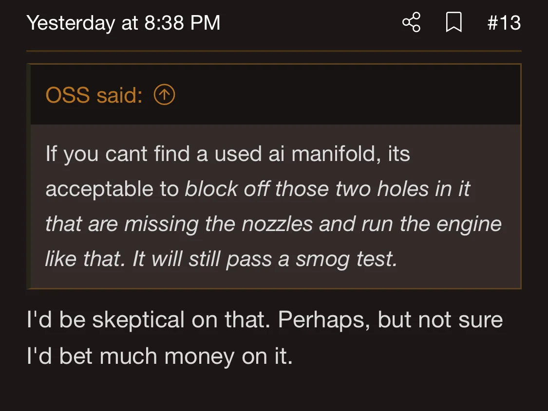

I'd be skeptical on that. Perhaps, but not sure I'd bet much money on it.
I had 2 broken off & sealed air injection nozzles on my 2F air injection manifold & my engine passed smog tests for 15 years.
Interesting. I do know all smog tests are not the same (for example, Tucson is slightly less stringent than Phoenix), so not sure how that would measure up nationally.

I have an automotive stethoscope and had spent a lot of time trying to diagnose but was till left uncertain. I’ve decided to desmog. Seems like the easiest cheapest option right now. I’m gonna put it all back together Thursday night and will update my post. Thanks for sharing.
