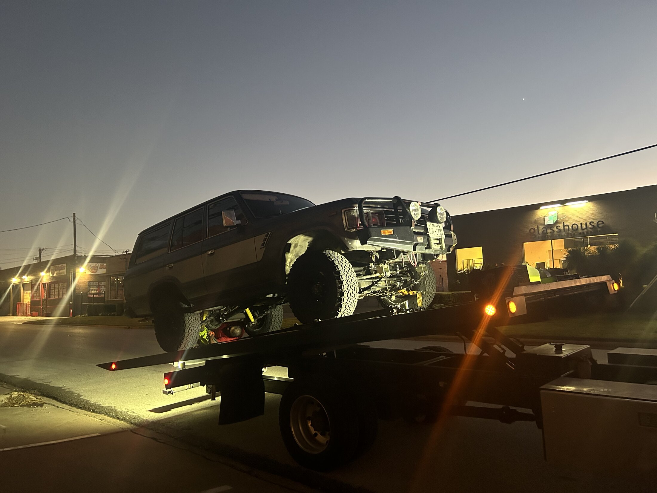

As I for now I’m 200 miles from home with a rolling brick. Had it towed it to friends rental house that has somewhat secure parking. Made it back to my lodging and am trying not to suck down the beer too hard.
