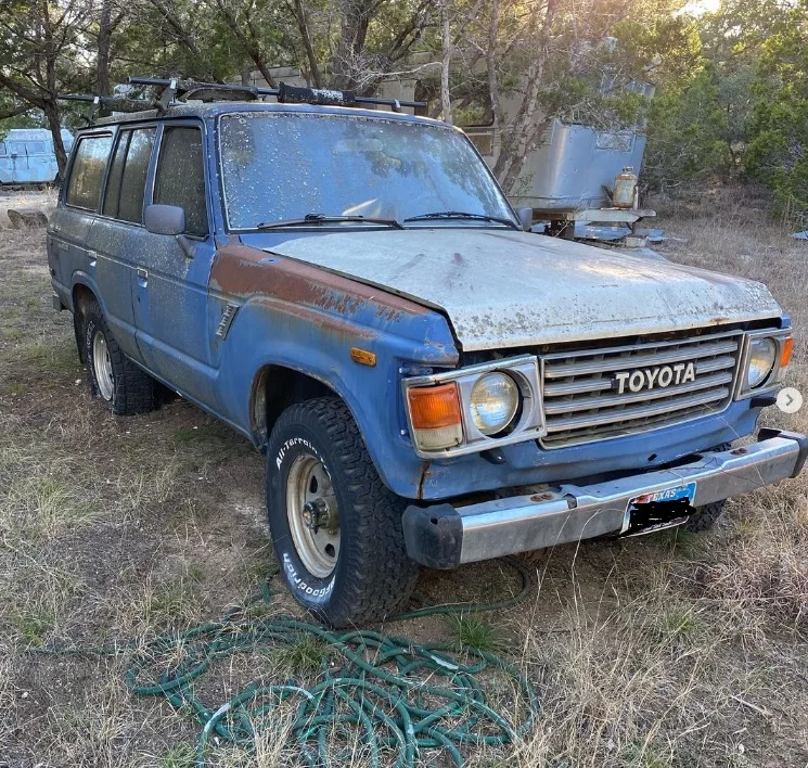

So, here are details of the 60:
- '86 FJ60
- 175K miles
- de-smogged
- headers installed 20 year ago, no Flowmaster, etc. was installed
- sitting for ~5 years
- stock carb
There are a lot of considerations when thinking about moving forward with the resto. Mechanically, the estimate is ~8.5K with some wiggle room. And then there are some upgrades I'm considering for when it gets here in Munich. See below:
- H55F
- 2" lift kit
-33" tires
- upgraded exhaust to realize benefit of headers
- possible conversion to EFI
- removal of non-stock metal rear bumper and add one that could do 2 swing outs for tire and jerry can?
In Munich we'll probably be using it mostly for toting my drums around and my wife's artwork. But would like to add some bits and bobs over here to allow us to do some overlanding/long term camping in Africa or ME. Some of our best friends also have a newer model LC that is setup for such.
The upgrades above are in an effort to allow her to more easily attain adequate speeds on the Autobahn/get a bit more oompf out of the engine/decrease the odds of running into any emissions issues when importing to Germany and possible improve gas mileage.
I'm thinking with the mechanical I'm looking at ~22K? That would included some much needed body work and a decent paint job.

if you don't get into body work, your budget is very doable.
looks clean and straight....so suspension, brake, tires, rebuilt knuckles, rebuilt aisin carb and some refreshed seats will be $6-7k USD.
I guess i'd straighten the grill and headlights too.
Then look into H55 and EFI if you deem it necessary

If there's a will there's a way, but I'd have major reservations about trying to get this ready for regular use in Germany:
  • MPG is 12 on a great day, and fuel cost is exponentially more in the EU
  • TUV inspection is notoriously strict and having semi-restored 60's before, I can't imagine the time and money one would need to pass a German inspection that routinely fails 5-year old BMWs. Not just mechanical needs, things like gauges in KM, headlight regulations, on and on.
  • I believe suspension modification and oversized tires would be a non-starter for TUV, but I haven't done that research.
  • I know most automotive modifications require proof of purchase from a TUV-approved supplier with proof of professional install.
  • Almost any frame and suspension rust and most body rust is an immediate TUV fail.
  • Truck is de-smogged which is an immediate fail on inspection and probably import
  • On top of spending close to $10k on mechanicals, then needing likely thousands more for TUV, you're spending thousands more on shipping and import costs
  • A perfect condition truck struggles at 75+ mph, you'd be blown away on the Autobahn by anything other than commercial trucks
  • You could probably find an HJ or other 6X platform rig once you're in Europe that would be much easier to bring up to German registration standards
Good luck, and if you go for it we'd all love to read about it.

Are there rust holes through the roof? Looks like it in the pics.
