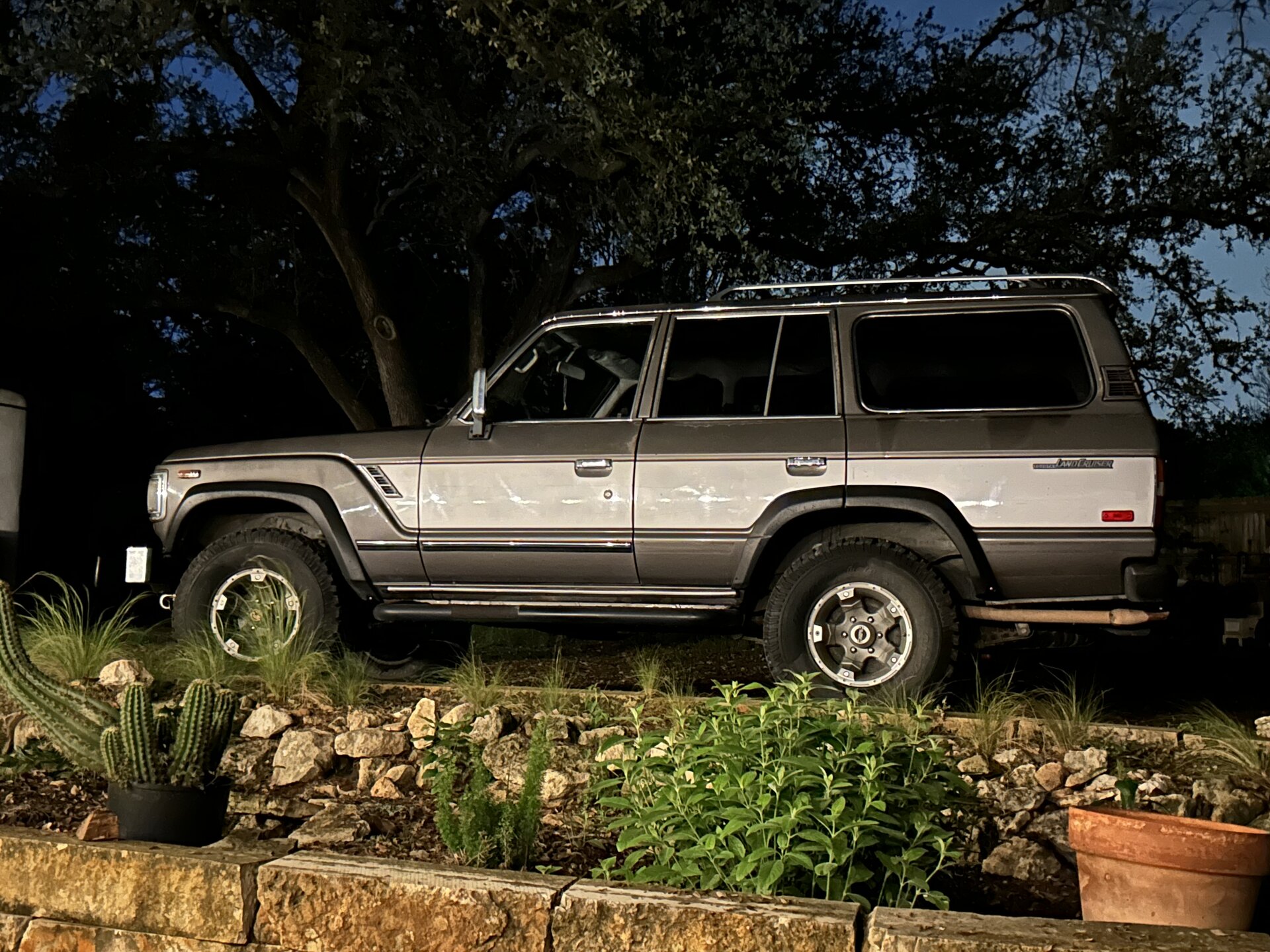

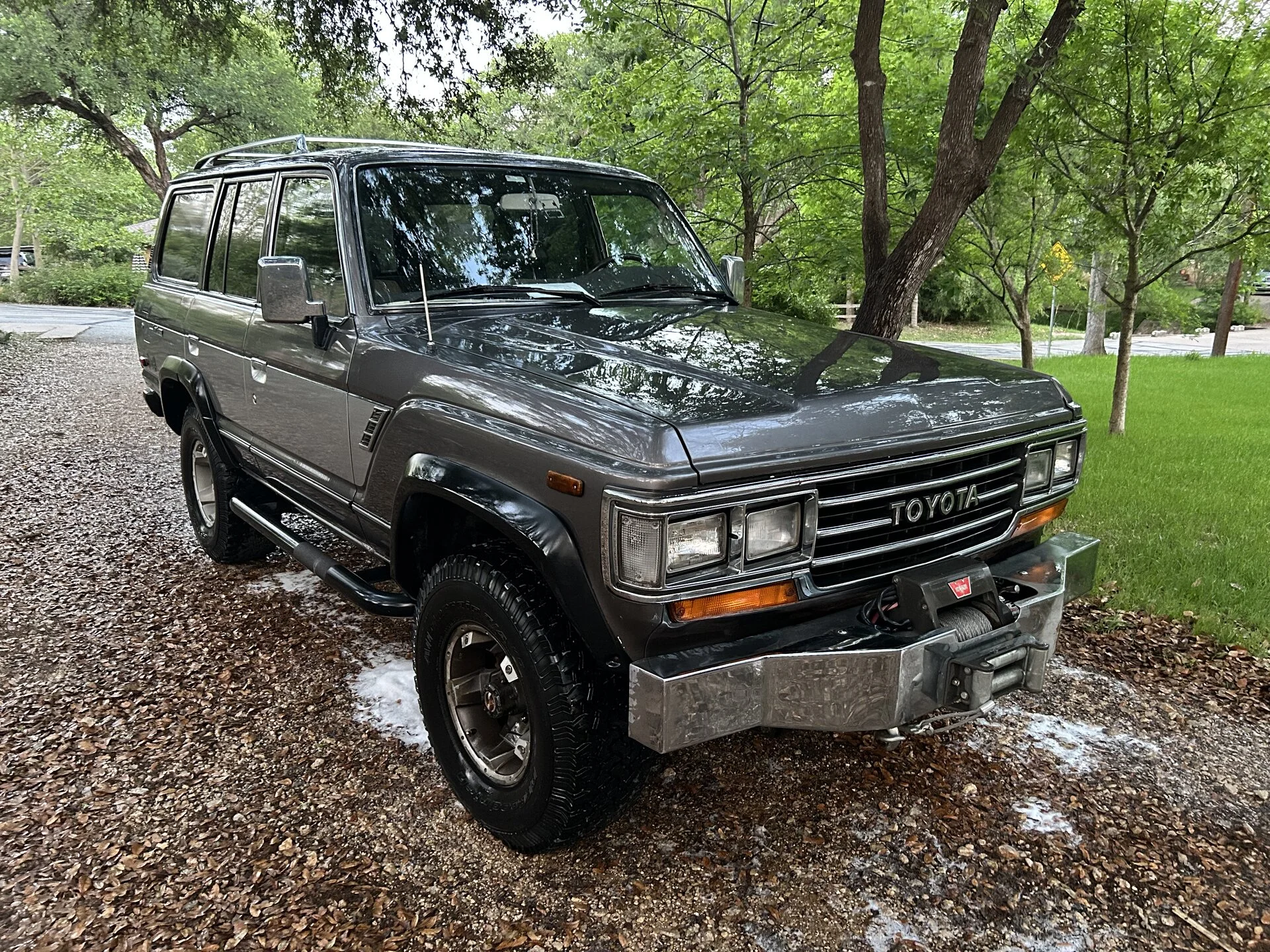

Been over in the 40 section for awhile but recently this ended up in my driveway. 1988.
It currently belongs to a friend of mine and she doesn’t know what she wants to do with it so it’s now under my care.
Current issues/plan…

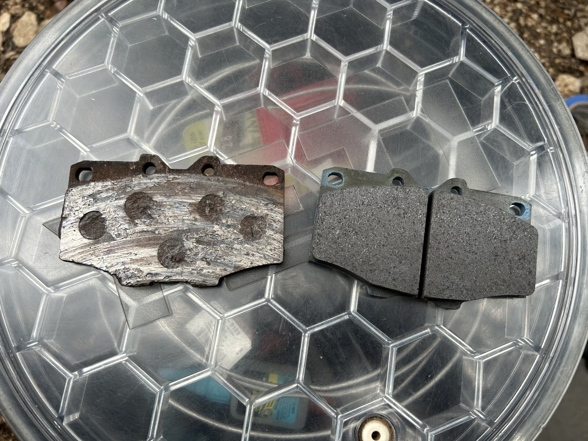

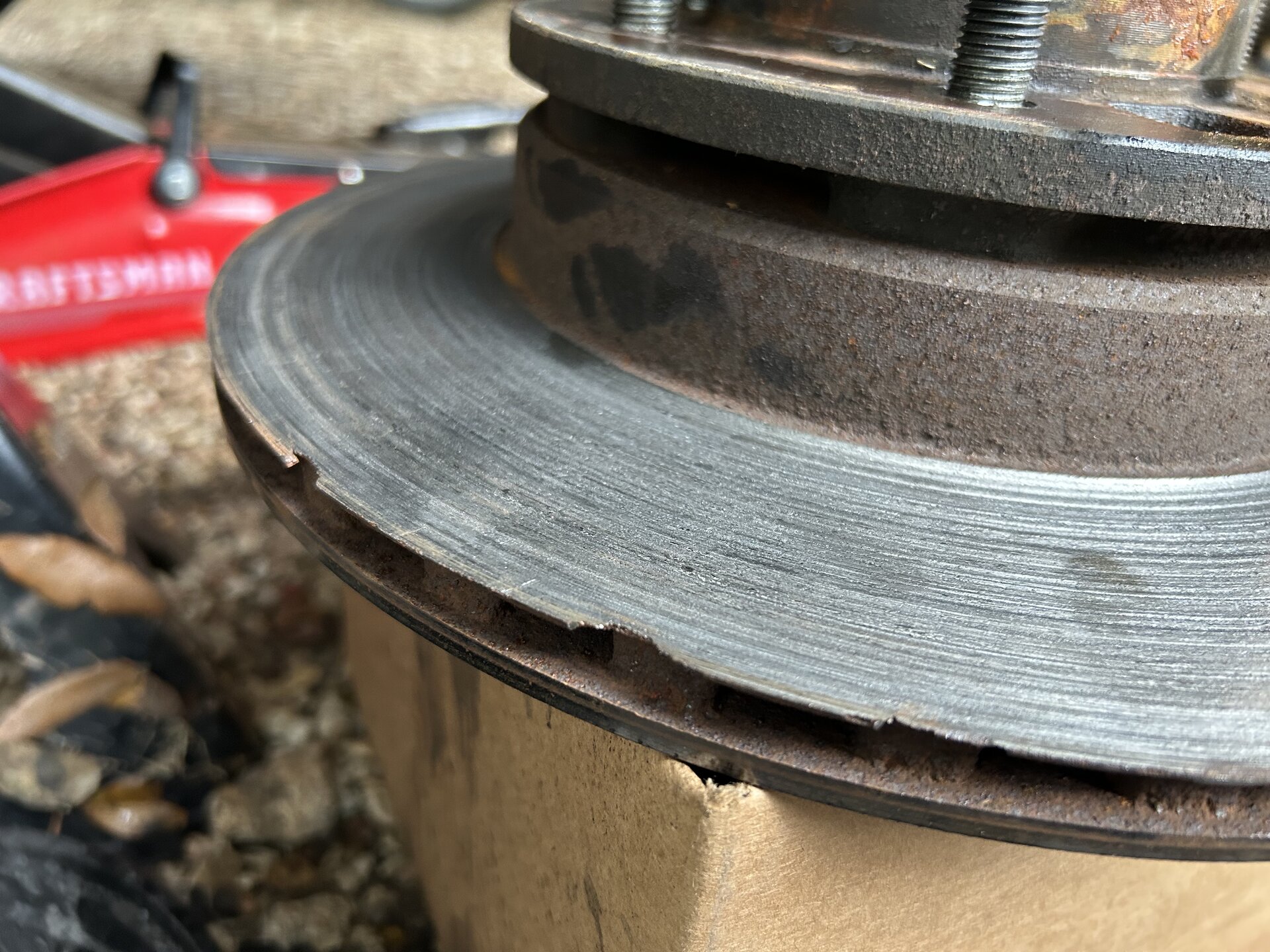

- front ps brake= metal on metal. Ordered new rotors and pads. Hopefully don’t have rebuild the calipers (did that on my 40) but should probably order up the kits for when I’m in there, just in case.

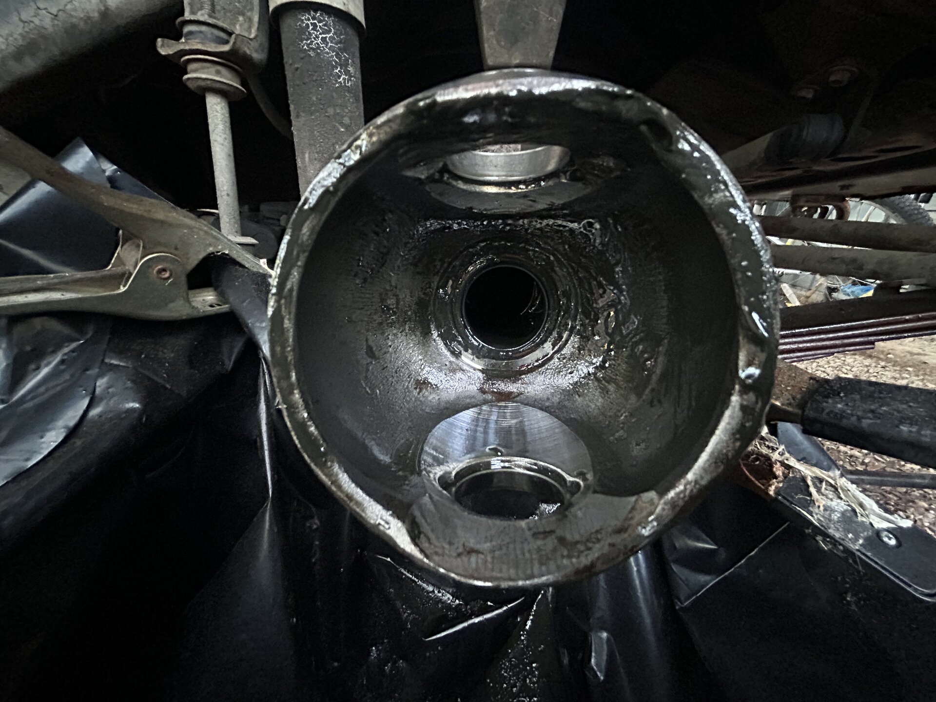

- suspension is pretty wacky, especially up front. Birfs don’t seem (too) leaky so I’ll leave that for now. Plus, my 40 really needs a knuckle job. I’ll start with shocks and work my way down from there. The leaf springs seem pretty weenie, dobison is probably in order.
- the biggest thing: I’ve searched but can’t seem to find the right wording or really an answer: it idles fine, if a bit low (still around 600, just sounds low) but bogs down under load. In drive or any gear, at idle, it really bogs down. Wondering if it’s a sensor thing, a transmission thing, a thing thing?
Mostly a lot of cosmetic stuff and general neglect. Needs new tires, pealing clear coat arresting, replace and/or juice up the seals externally.
Really curious about the bog though.
Any thoughts would be appreciated.

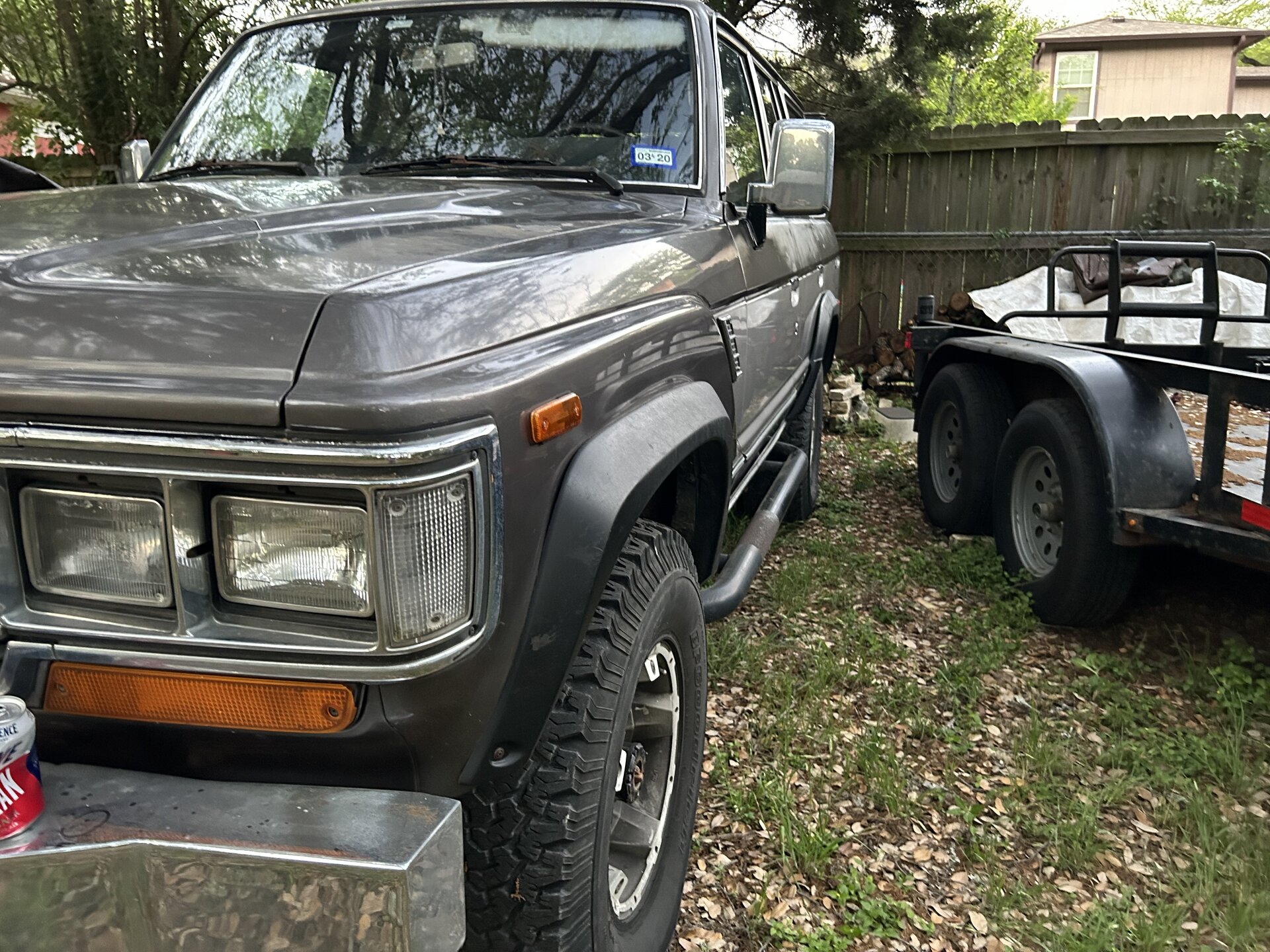

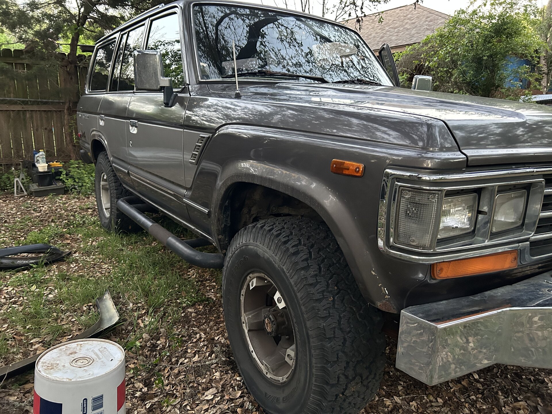

Oh yeah, I did pull off the ill fitting fender flares and the remainder of the door trim that was half falling off.

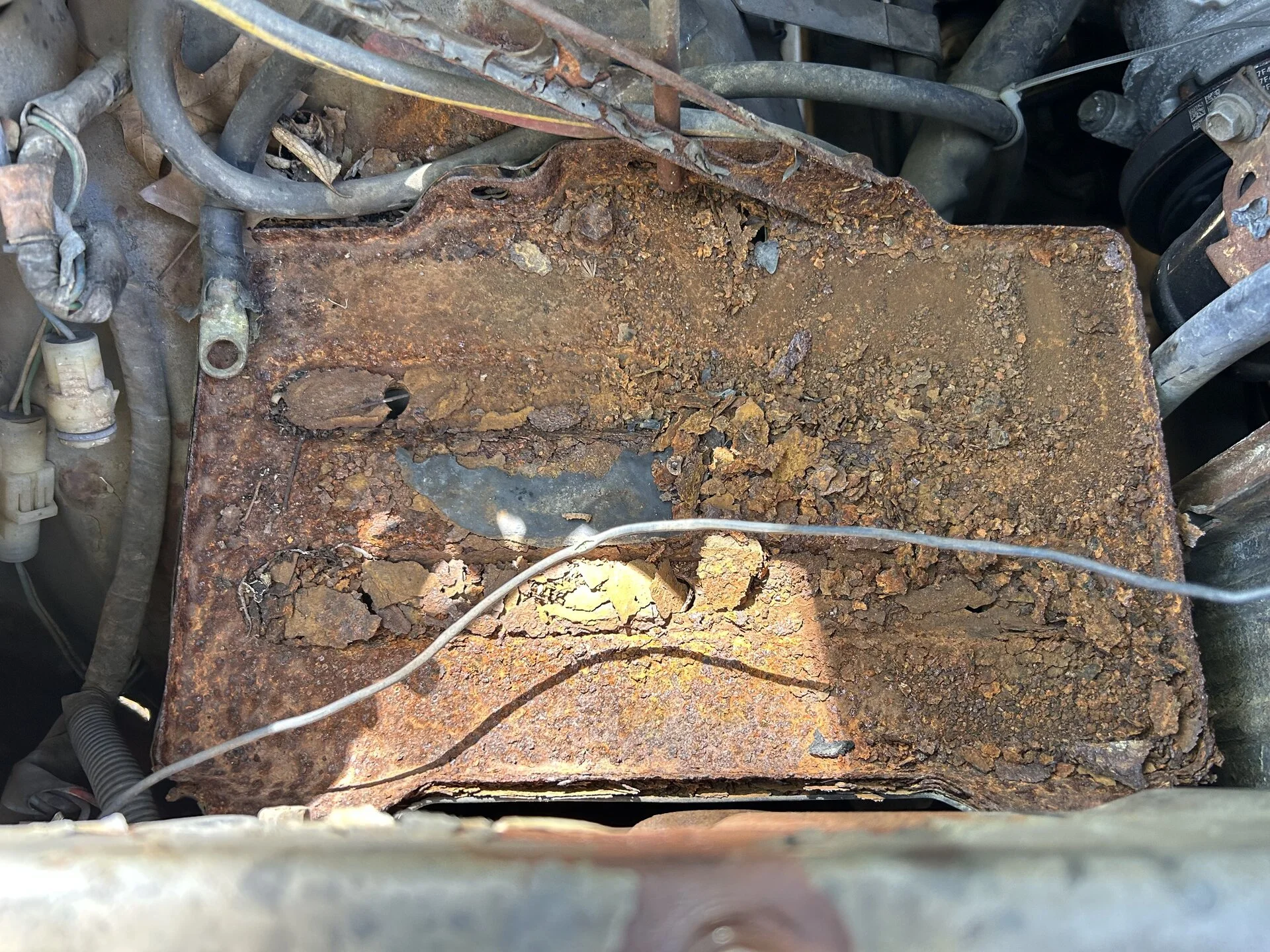

Ordered up a new battery tray and futzed with some of the PO brilliant wiring…
I do kind of like the fender flares but they were installed poorly and were rubbing holes in the paint. They look like a nice add on if done right. Too many holes for stabby mcstabsalot’s installation, no pics, but I’ll treat them and fill with aluminum solid bucked rivets for meow.

Back to that bog down while under load (in gear) at idle.
I'm struggling with search phrases to pin point what could be the issue.
I'm getting pretty good in the romper room garage (40 series) but this AT, EFI world is like a mysterious mist.
Is there a timing issue at play?
Fuel delivery?
I dare not fondle the golden screw just yet...
Regardless, I am out of town for work until saturday. After I tackle the brakes, I'll see about driving it up to @aljollano for a hopeful diagnosis.
In the meantime, if anyone has any idea, I'd certainly appreciate the input...

Looks like a fun rescue project. The entire world thanks you for ditching the flares and stick-on body trim.
FYI - the rotors are pressed on with the wheel studs, so leave a little extra time (or press work) for a rotor swap.

I saw that stud/rotor thing in some random youtube vid, think it's wise to grab some fresh studs? Don't have a press, but have used the "bang the nut" method to get studs out on different rotors in the past.

You don't have to have a press for the wheel studs, and I'm not sure I'd replace the studs if the threads are not boogered. A press is just a bit more elegant than banging on lug nuts.

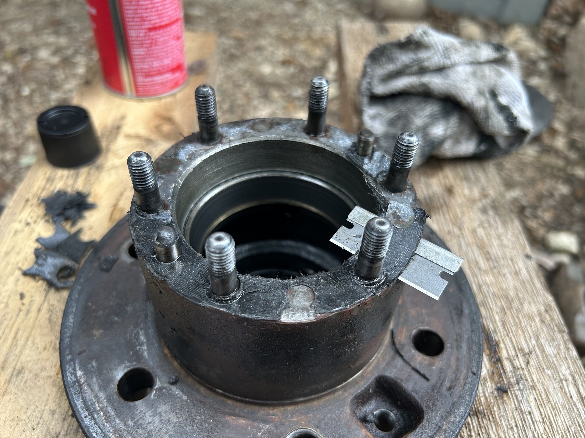

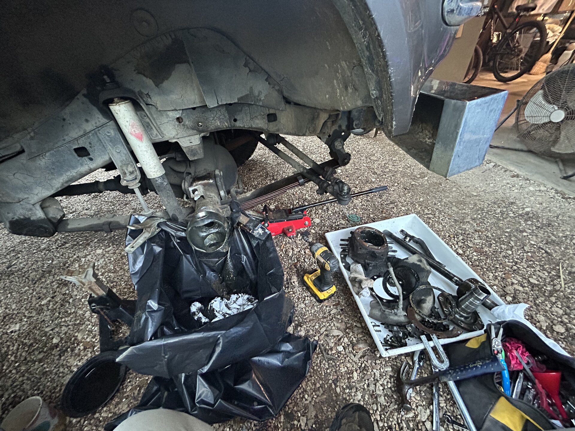

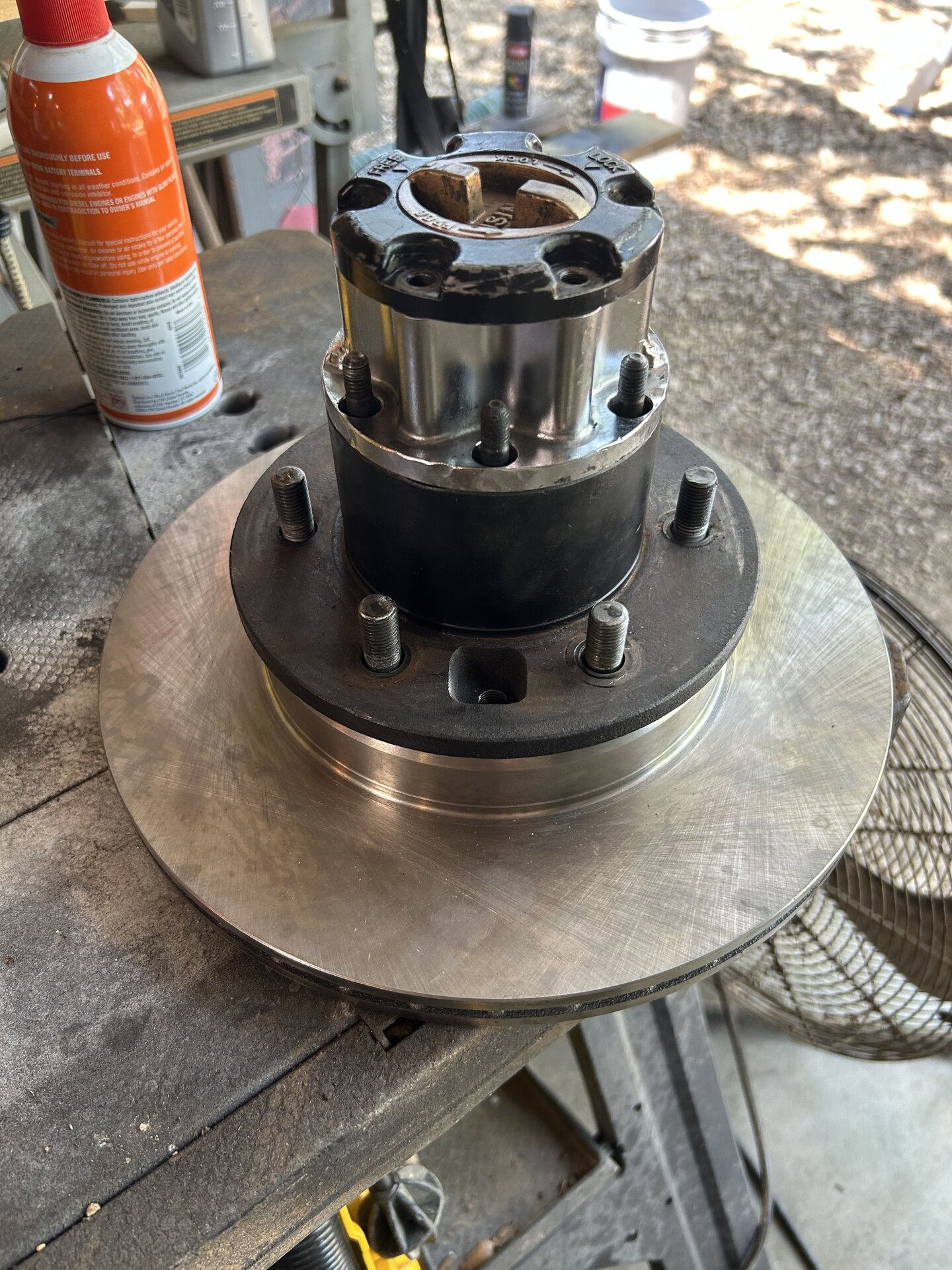

Welp, eyebrows deep in a simple brake job on the 62 series.
Knew the rotors needed replacing as evidence from the grinding sound when I picked it up. Should’ve known this would be a full knuckle job and hub refresh. My dumb ass bought new rotors and pads thinking it would be that easy. Dumb ass.
Waiting on parts…
While waiting on parts, I’ve been cleaning and then cleaning some more. Then I clean before I clean again. That cheap harbor freight parts washer is looking pretty attractive…

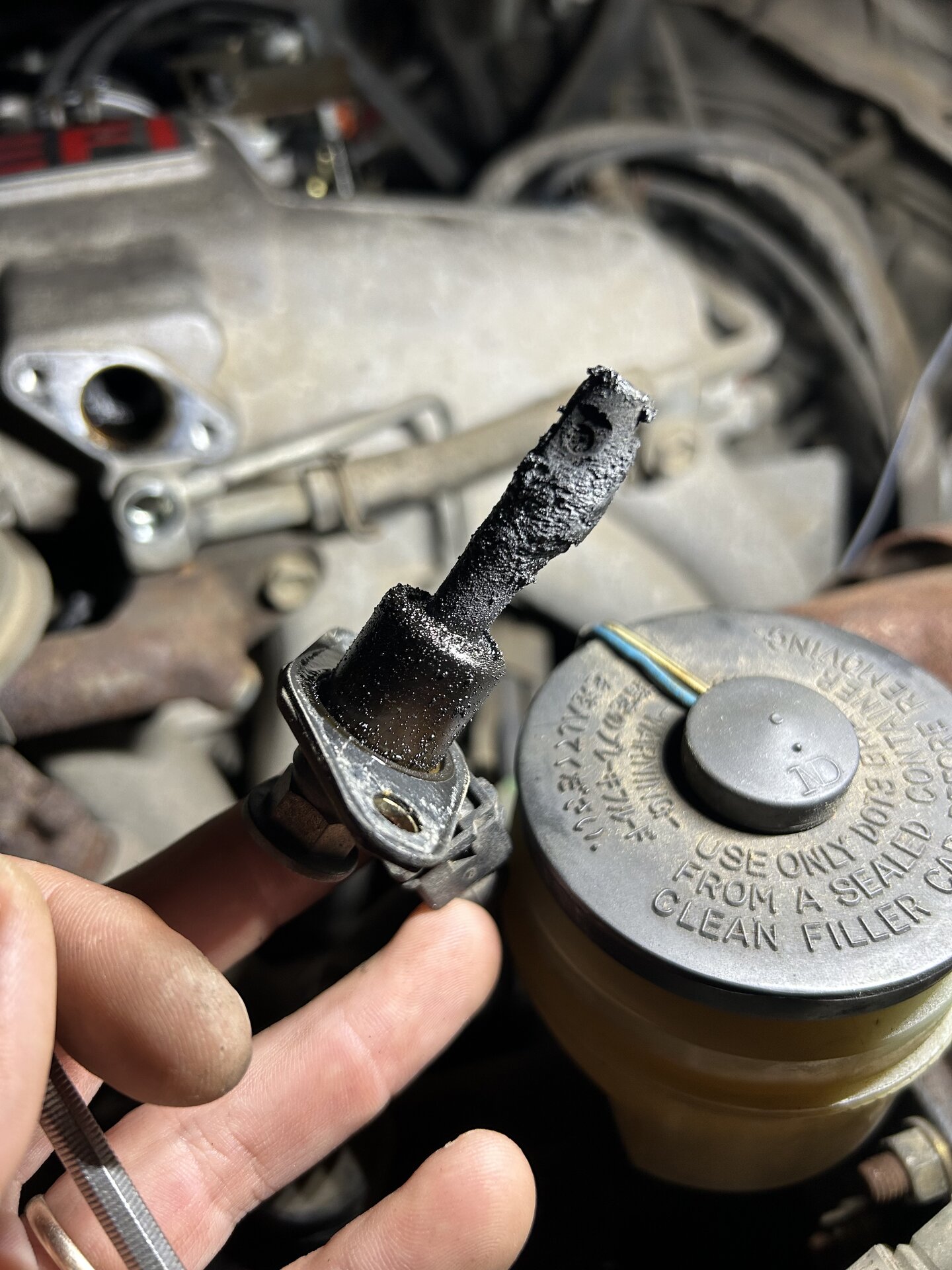

Clean your cold start injector folks.

- cleaned cold start injector

I got some nice stainless battery trays for mine online .
Ended up getting an oem one from Toyota.
Refreshed the gusset, ospho’d and painted.
Considered the ss one but the OEM was not expensive.
