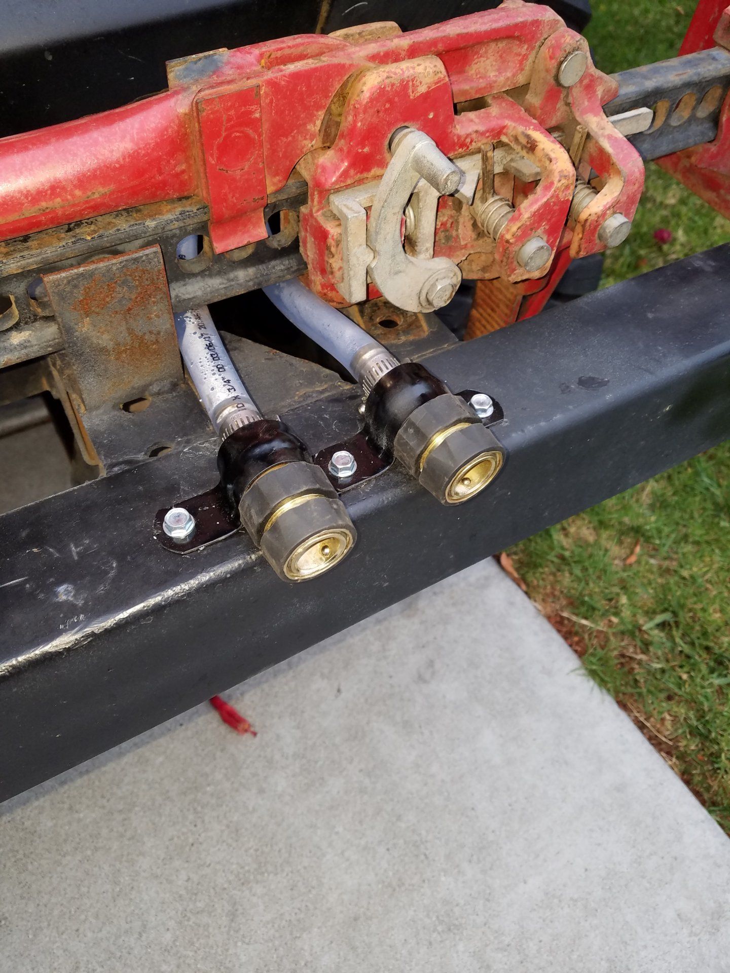

We even had time to finish my shower.

M6, confirmed. I went back Home depot and got M6-40mm and they work great. Also got a bucket for my shower kit. I almost got the orange homer bucket untill I saw an all black one with a screw top in the paint area. Had to get black.
