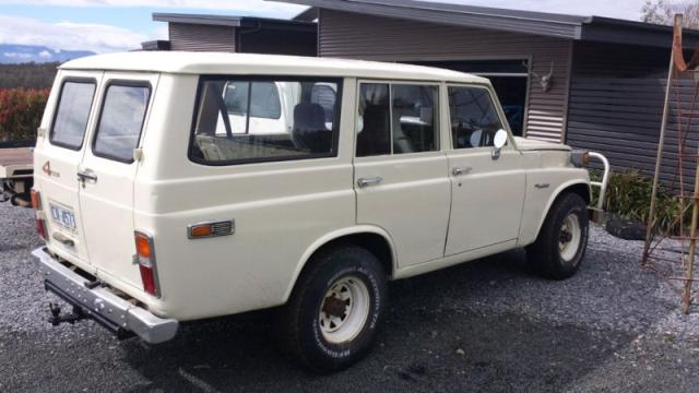

Hey guys.. I might be jumping the gun a bit here but I've got my eye on a tidy 79 FJ55 that I'm hoping to inspect and subsequently take home this coming weekend. It's been a few weekends since I got the green light from the minister of finance so my brain has been in overdrive and my eyes are bloodshot after going through countless threads on mud...

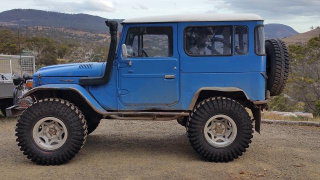

But I thought Id share my master plans on here anyway.. So I have a 1984 BJ42 at the moment and its had considerable work done, I'm hoping that all this hard work will go across with minimal fuss onto the FJ55..

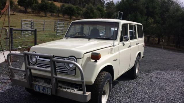

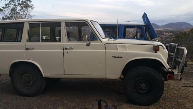

Donor vehicle:
and in its current form:
Ah the one from legana I've been drooling over that on gumtree
Yeh I've got some photos of the gutters and theres some floor pan rust. The gutters have been repaired and aren't too flash but I'll be taking a magnet with me when I go to inspect.

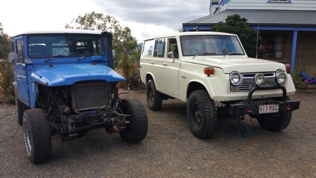

Well got a family now (wife and 2 kids) and so options are limited for taking the 40 anywhere.. everything is preceeded with 'take a kid!' so the 2 seater 40 doesnt suit our needs for camping. Rego for 3 cars as well as the cost to build and maintain a 3rd which is also a consideration. Believe me if I could keep the 40 I would but for the short term reflective of our budget (slim to none!) it will be more than sufficient as a long term replacement.
Purchased the above 55 for 3.5k then spent $300 on a tow from Perth to Hobart cos it died as I pulled into the servo there.
Its got towed to a mates place because my driveway is too steep to get up with a car trailer +55 on the back.. I'm hoping to get it fixed with spares from my mates 2f so i can drive it the 5mins home.

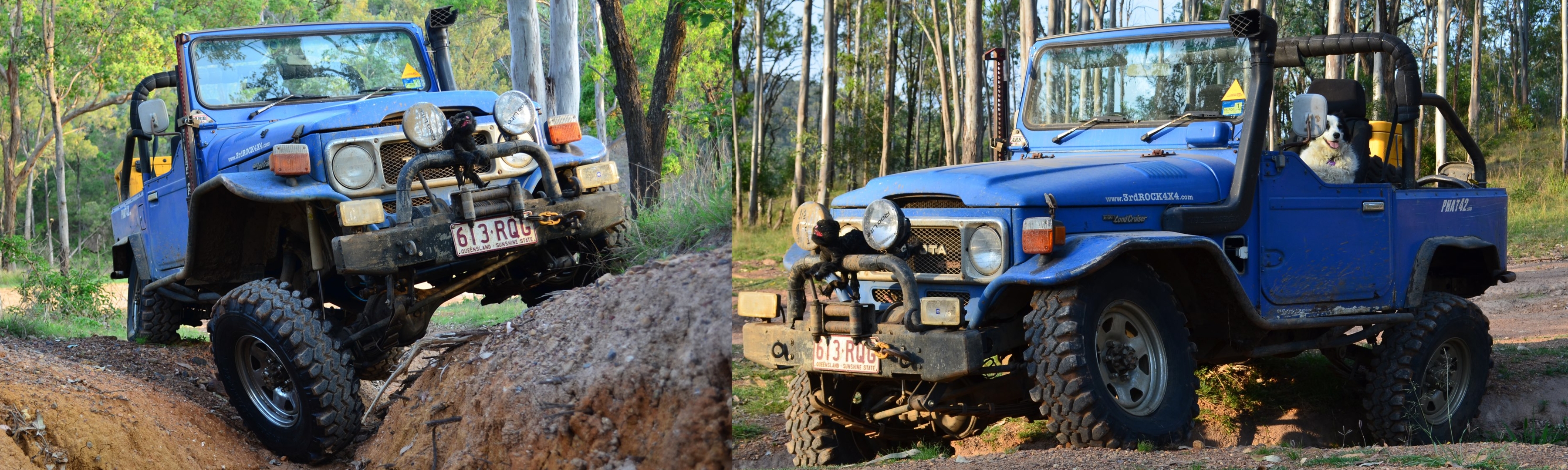

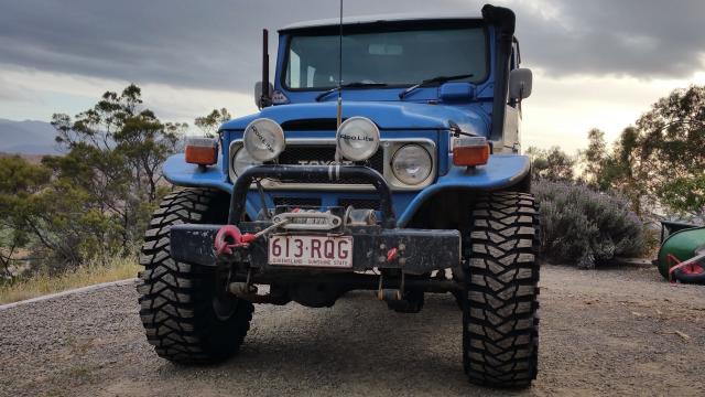

Since i recall someone asking for a few more photos of the BJ42.. here are some I got recently when I had an opportunity to try some 37 Sticky Treps on the 40 when I was helping to frieght them interstate for a mate.. No scrubbing up front, but the rears needed some grinder work on the sliders to even consider flexing..

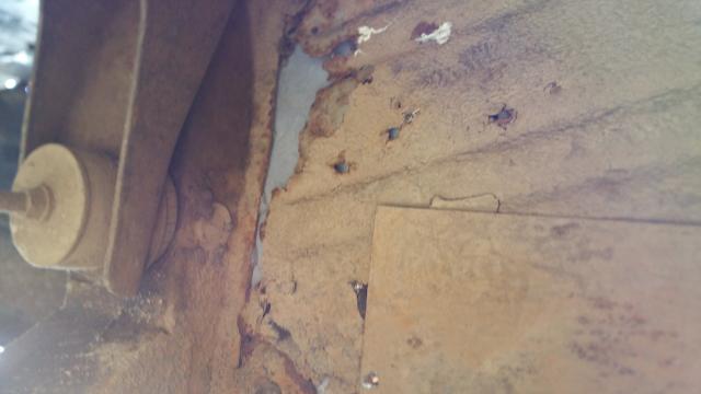

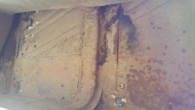

Here are some photos of the rust issues (that i've found) that will need to be dealt with:
lower door hinge behind the driver
Passenger footwell
Floor behind the drivers seat
drivers footwell

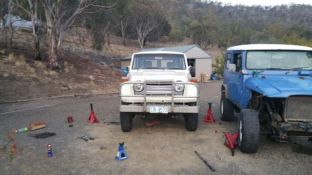

So the mrs went away with the kids up to Brisbane (where we've moved from) for 3 weeks on xmas day and this gave me an opportunity to start the getting the 55 sorted.
Because all the gear I want for the 55 is still bolted to the 40 I've got to go through the motions of removing all of the fancy stuff from the 40. I bought a BJ73 at auction which will help me restore the 40 to stock specs (powersteer, 3b, big eye springs, disk brakes, rear drum and 5spd gb and transfer).

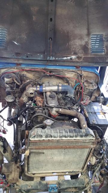

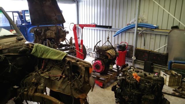

First order of business was taking the 15b out of the 40 and putting a 3b in.. I had a gt2052 turbo kit prior to the 15b install so this went on too.
Both engines out.
3B in with turbo slapped on

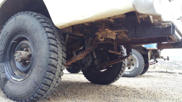

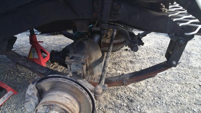

Next was the front diff and springs, it was easy enough to disco everything and wheel out the diff complete.
Unfortunately the springs are lifted a bit and I had to take the wheels off to get it under the 55.
Before I could move onto the rear end I had to sort out the 40 with disk brakes from the bj73, so this is now done.

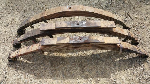

The 40 has 60 springs in the rear, so these custom spring packs will need to be split, leaving the 2 longest leaves in the 40, the same with the 55. this will leave the 2 main leaves from the 55 pack, to this the rest of the custom pack of the 40 will be bolted together and the rear drum with park brake, 60 series diff and ubolt flip kit will slide under the 55.
Both engines out.

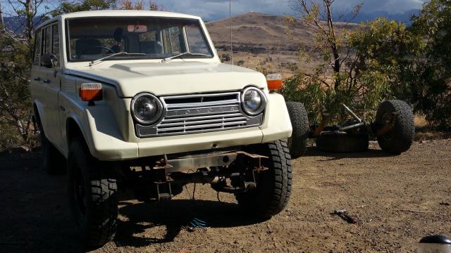

Suspension is pretty much done.. I might need to donate my extended front shackles to the 40 i'm trying to prep for sale.
The rear diff needs to come out so I can transfer the sway bar brackets across.
The width now matches the front with a 60series diff with late model drum brakes in the rear.

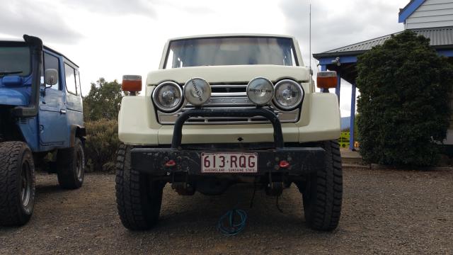

rested the front bar from my 40 on the 55 to see how it would look. I think I'll leave it with the 40 and build something new for the 55.
hybrid spring pack in the middle.
stock rear diff and spring removal in progress.
