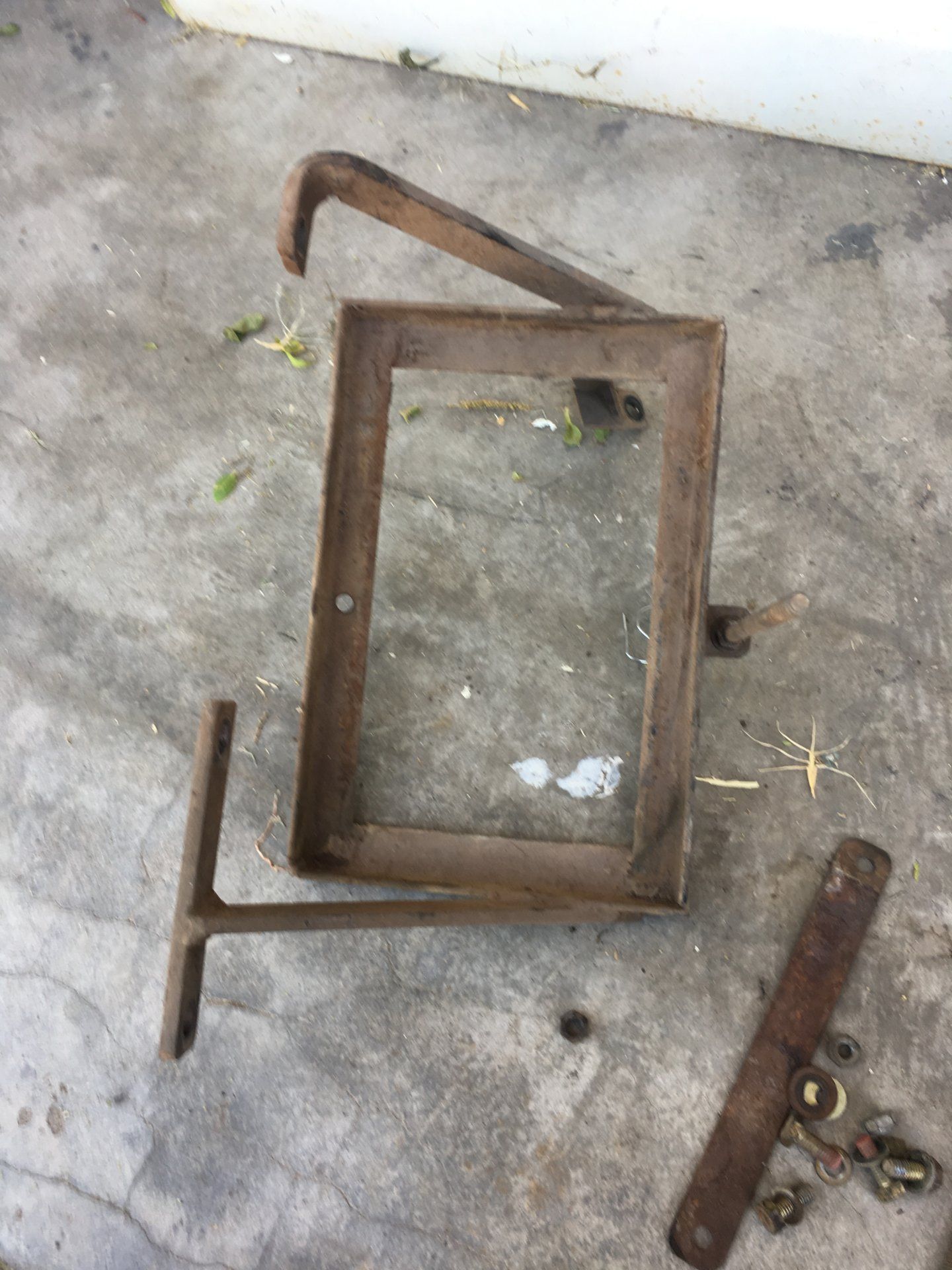

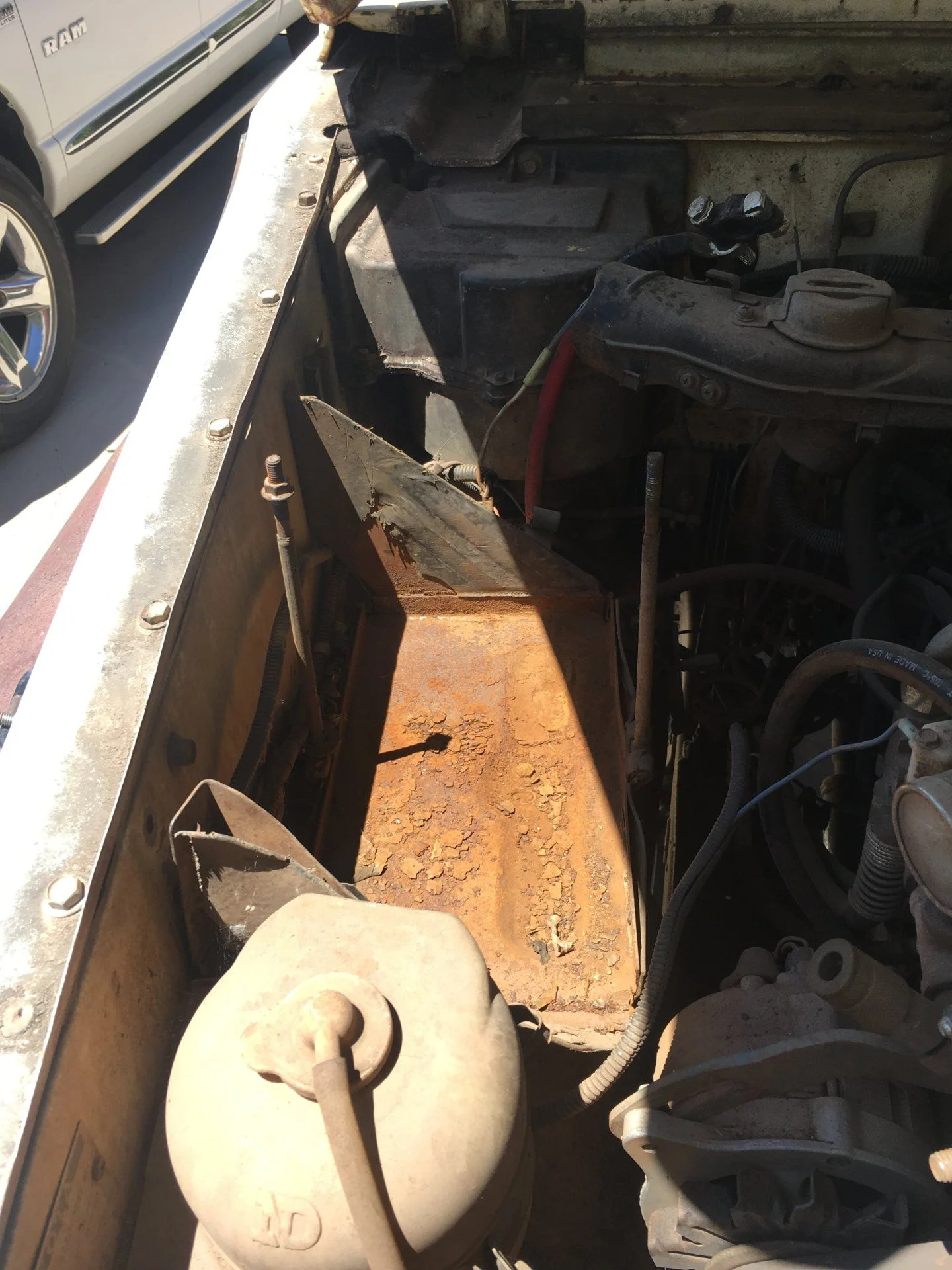

The original battery tray has been beat on and neglected, time for some refreshment. My auxiliary battery tray isn’t much to look at (fabbed up years and years ago), but noticed my engineering skills were shabby where hold-down placement is concerned. Gonna change that.

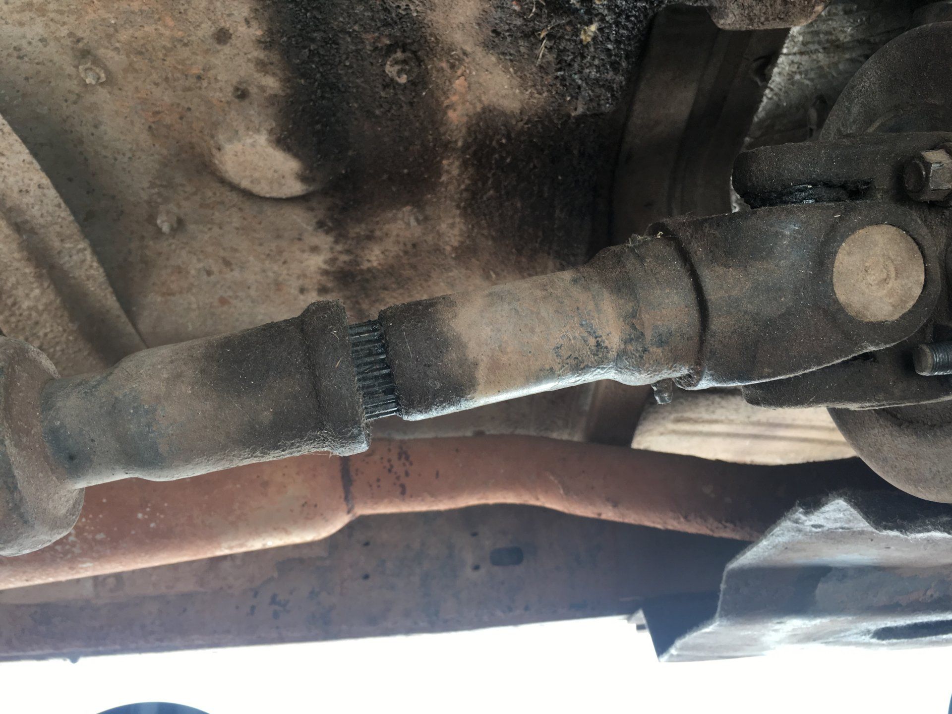

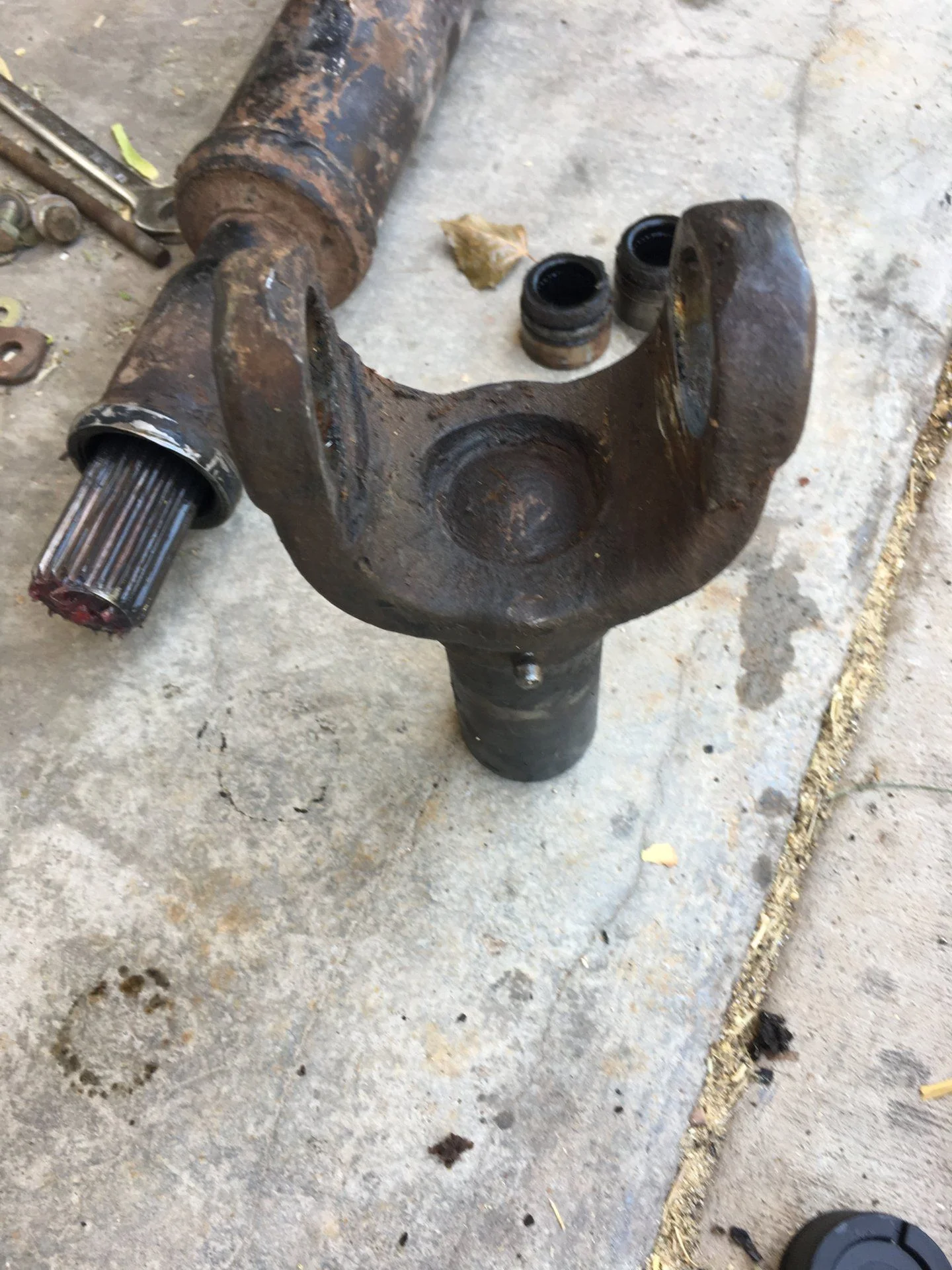

When I put the longer, taller Alcan Springs in the rear, I was never able to lengthen my drive shaft accordingly due to my local d-shaft builder closed shop, then the economy tanked, and I had no money for such expenditures, and plus it still worked, so f-it. Over time, the springs have relaxed and the yoke is barely holding on, so it really needs to get taken care of.
And then I noticed for the first time, that there is no method of pressure reduction in the yoke as it compresses, so my idea is to drill a hole in the cap and insert a rubber plug with a weep hole.

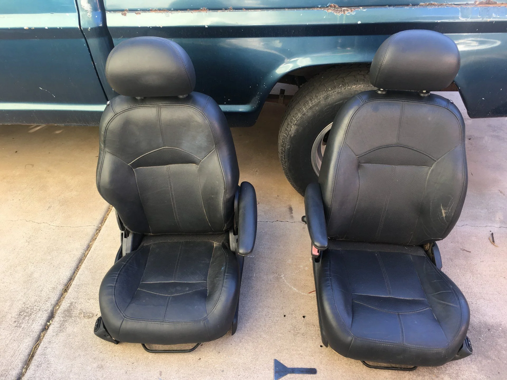

When I installed the overdrive in my Pig, I was certain that would be the best modification. Next I put in power steering and couldn't imagine anything could top that. Then I installed late model F-150 captains chairs with adjustable lumbar support. THAT was the ultimate upgrade.
Looks like you got some comfy seats...enjoy. Look forward to meeting you at the Pig Party.
