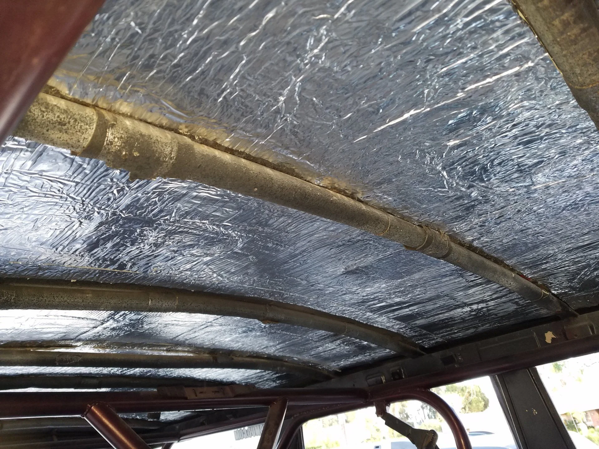

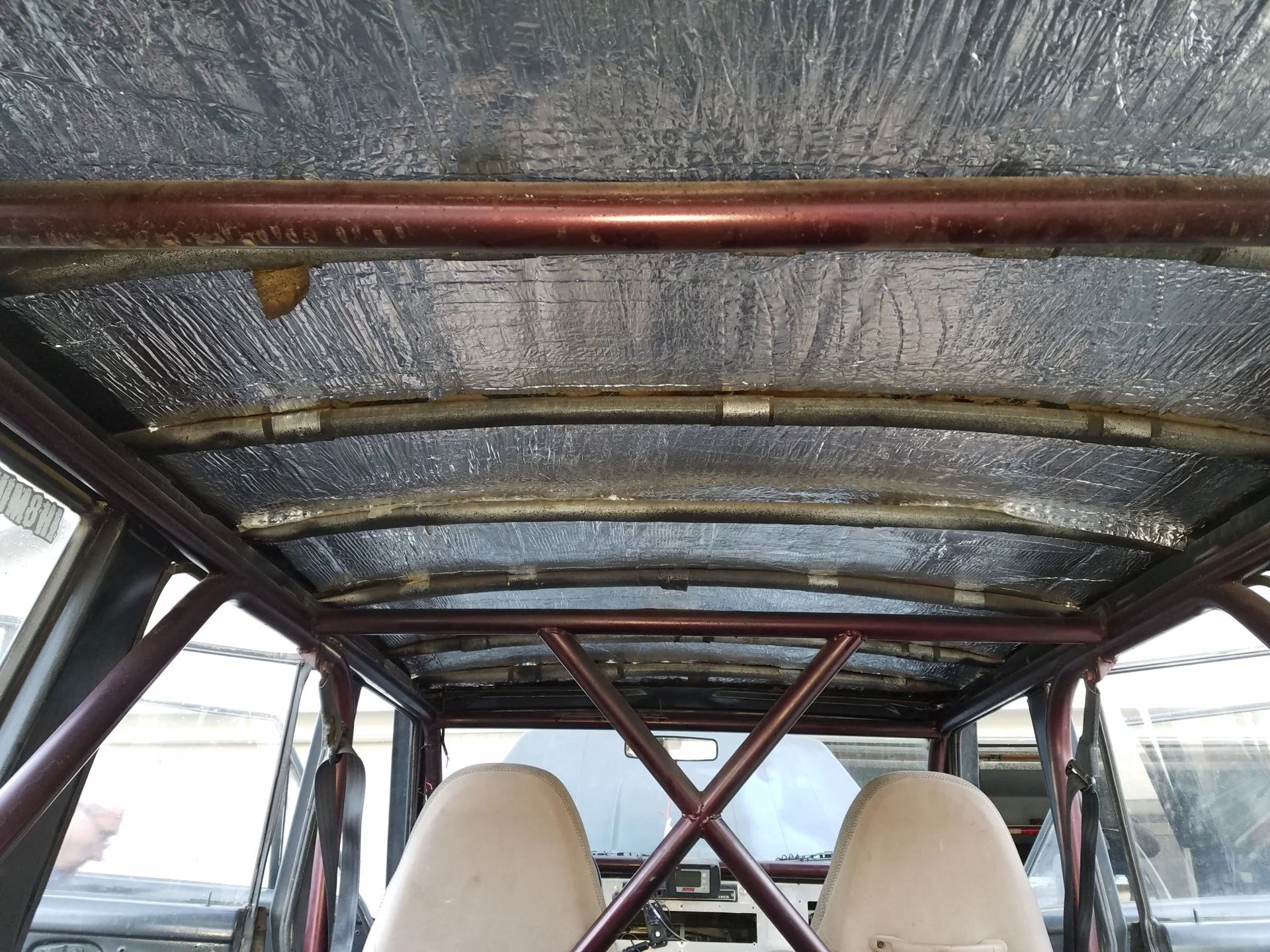

We buttoned up the pig. Adjusted the steering box cuz it had some play. A few other odds and ends. I got some duct wrap from the depot and lined the roof. Its self adhesive foam with aluminum backing. The glue is meant to stick to the aluminum side and doesnt like dirty metal so i got some spray glue and tacked it in. It deadend the sound pretty well. Actually the truck was super quiet on the drive back. I also dropped about 30 degrees in the hot spots of the floor. It will be even better when I redo the exhaust and put on door/roof panels.

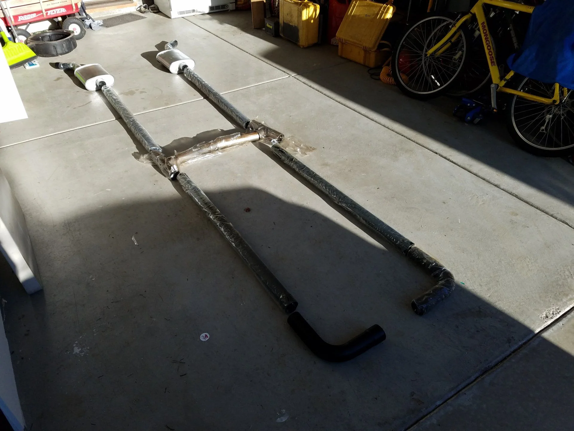

The PO made it out of EMT and bent them to fit. I don't really like it but I have decided that I probably couldn't do any better. Plus it will be covered with panels in a few weeks.
A little change in the roof insulation. I used 3m 77 spray adhesive and i was reading online that it is only meant to stick fabric for a short time while you fasten in other ways. It was corroborated by the 2 strips of foil laying on my seats after work. I stopped the depot and got 3m 90. It sprays more like silly string and tacks up real good. I think it will work way mo bedda.
