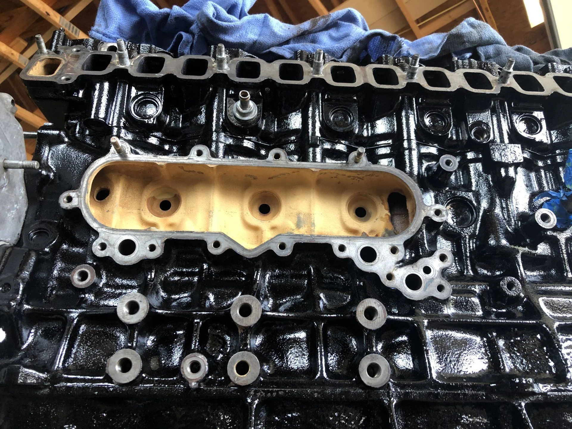

No pics, but I got all the tape off (using only a few razor blades). I touched up a few areas I had missed, mostly placed on the head that you could only see if you were upside down under the intake manifold. OCD is a bitch.
I have to work all weekend, but maybe I can start to put the motor back together. Then, we mock up the transmission and stick the motor in the engine bay to test fit.

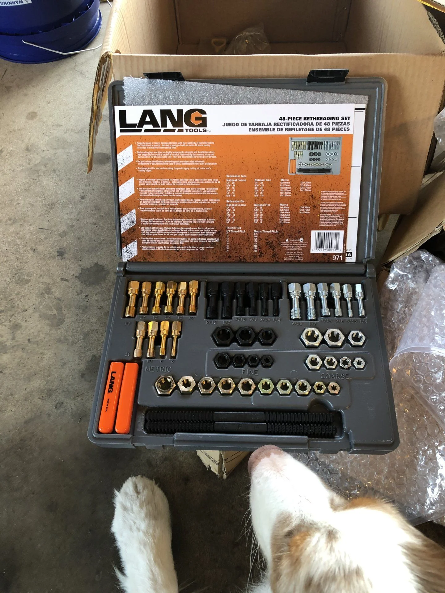

Today I got everything unmasked and chased all the threads. I invested in a full re-threading set of taps and dies. Tomorrow the parts start going back on.

Those little thread files at the bottom of your kit are lifesavers. Everyone should have those.....
I threw mine in my tool bag in the 80 after last years Round Up after watching them being used in a pinch to fix threads.
Same here Cim.... Marlin gave us a clinic on the uses at Tucker74’s expense. I use mine all the time just to figure out thread pitch if I’m replacing hardware, or with my new to me 80 trying to figure out what wrong bolt the previous shade tree mechanic used.

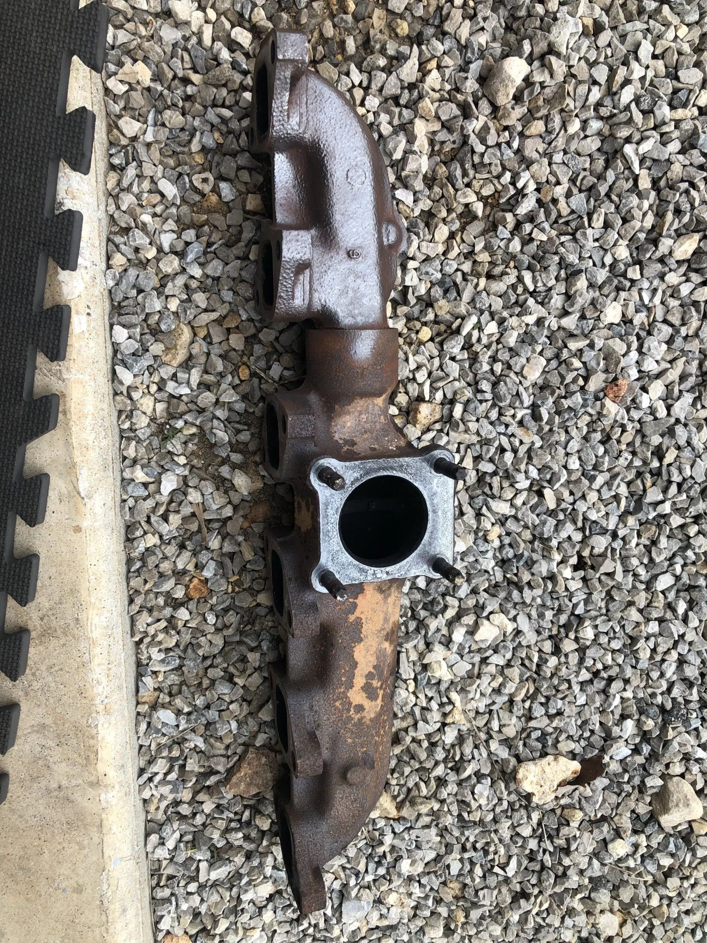

The exhaust manifold was filthy. I spent all afternoon wire wheeling it and got it masked and primed with high heat primer.
