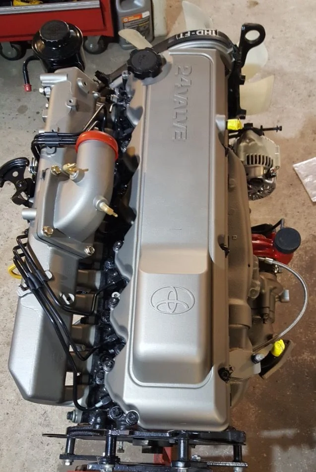

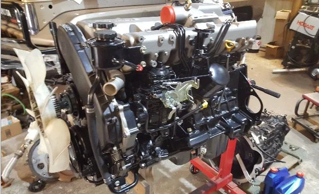

Joe, I'm just the untalented guy with the camera. Rob would be the person to talk to about the technical stuff.
Is it your's ? Sorry if I missed it elsewhere but WOW ! :clap:

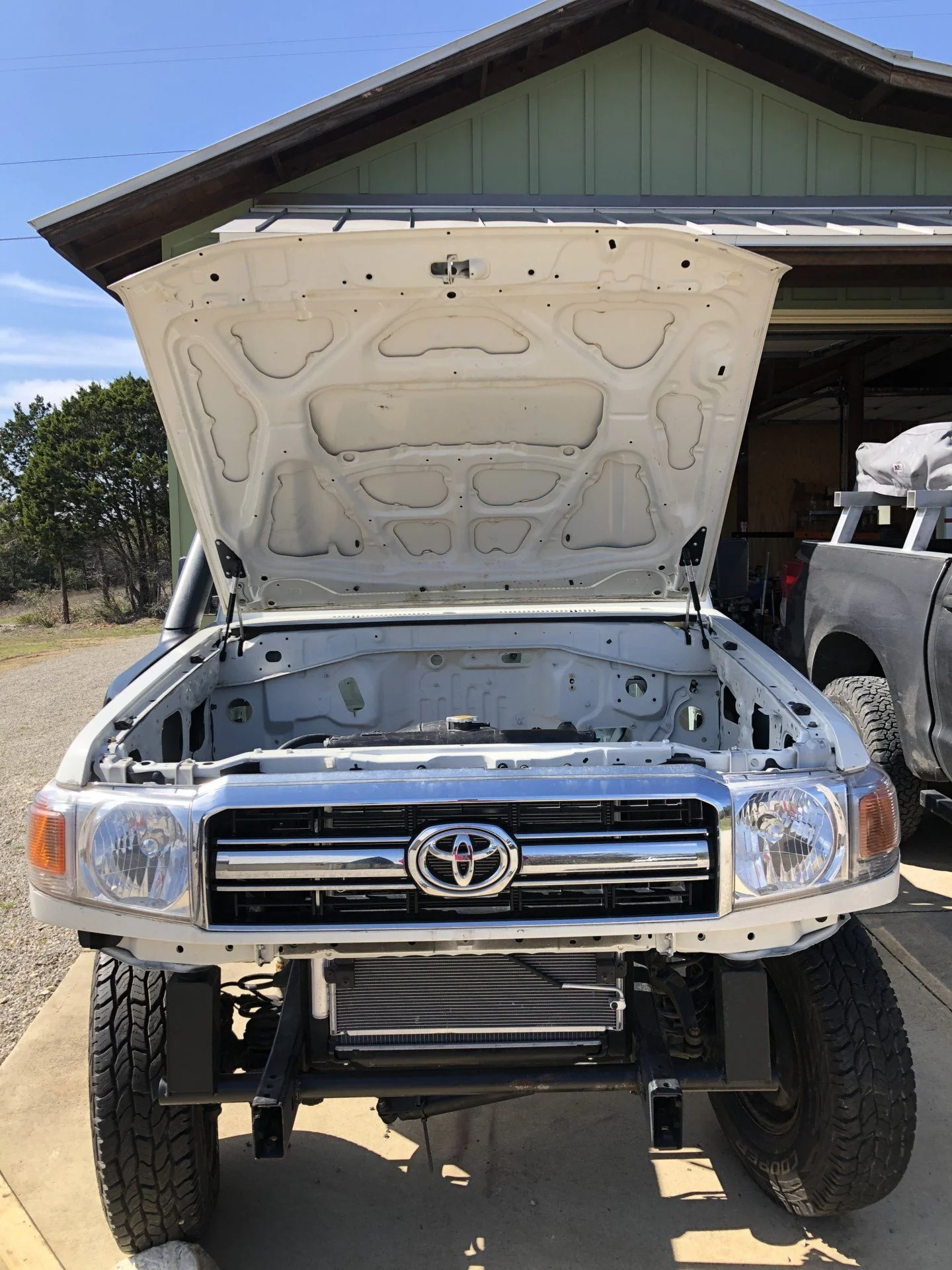

It belongs to one of the shop's clients. (Replacing a petrol engine)

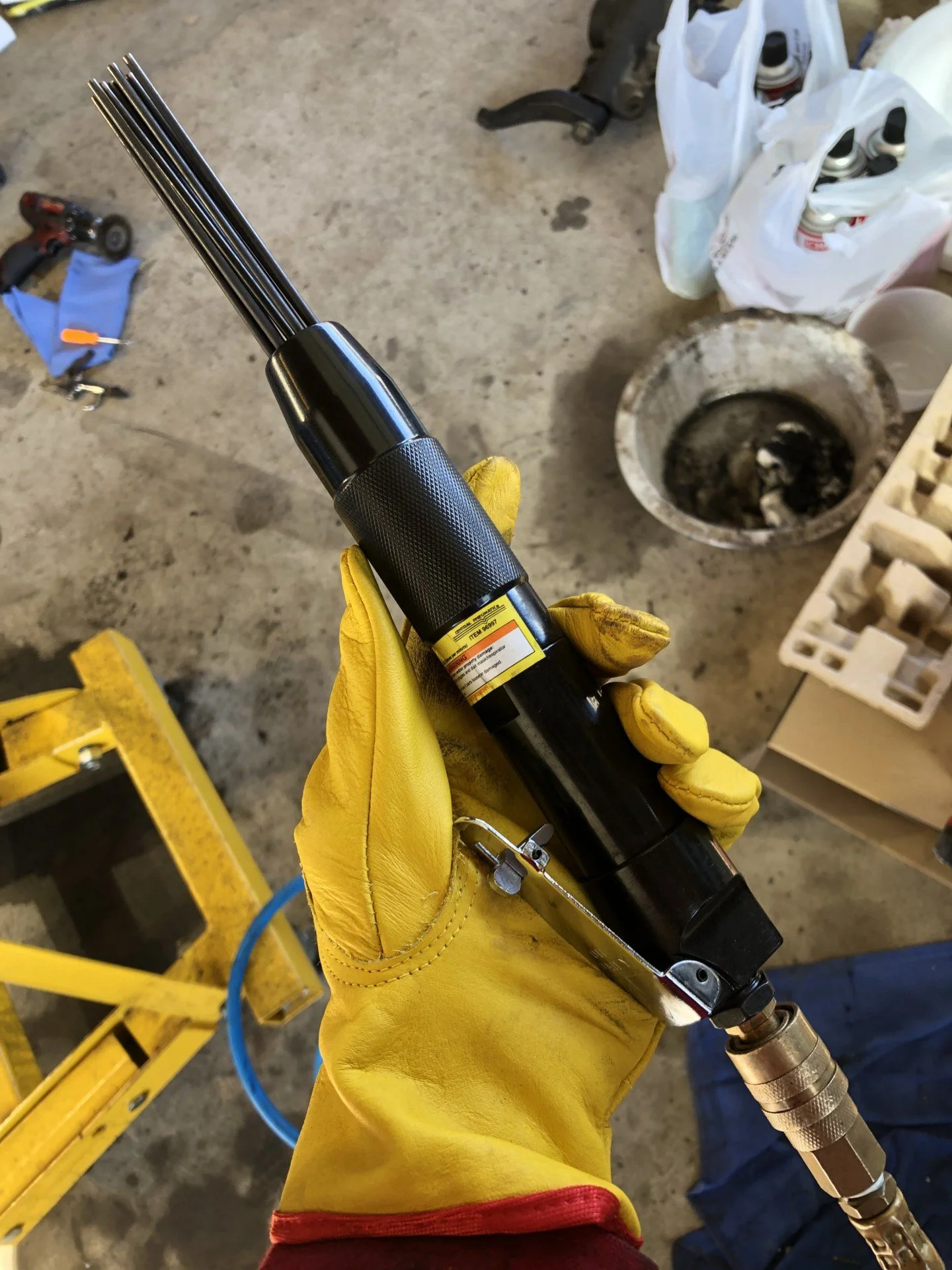

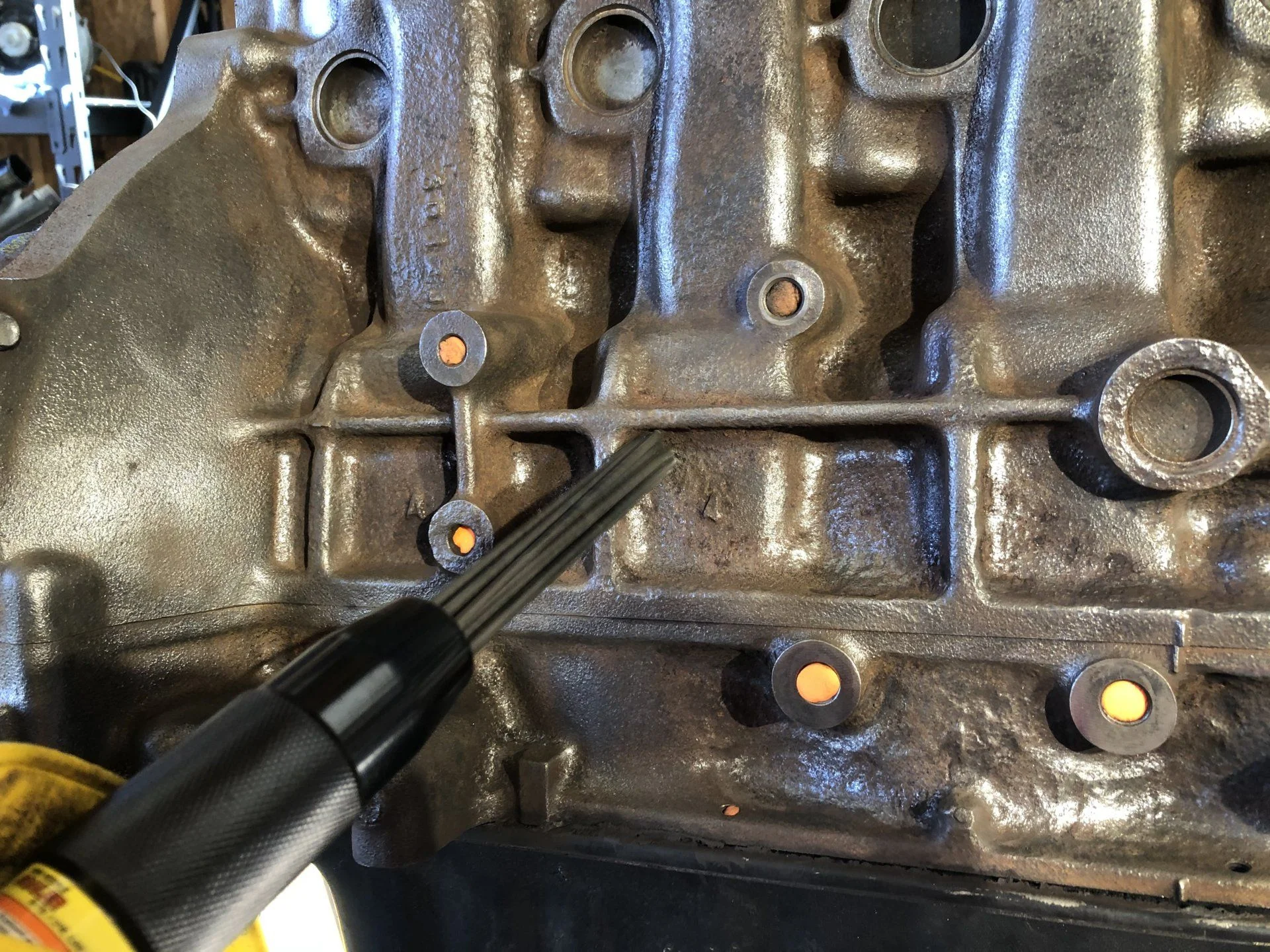

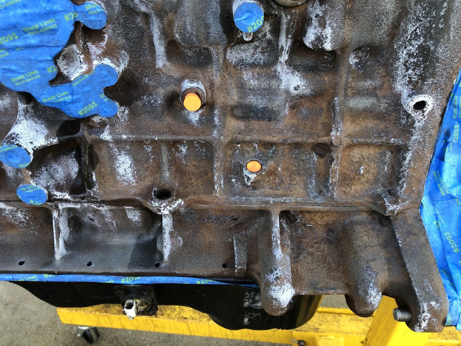

In an attempt to make my motor look more like those above, I bought the cheap mini needle scaler from HF. It worked amazingly well and really knocked off scale and crud that I thought I had really gone over well. NOW I’m really ready to degrease and paint.
Also, @cwwfj60 stopped by and delivered some parts for my HJ61. He was nice enough to help me weasel the last bolt in place to mount the second gas strut. Kitty launcher is GO.

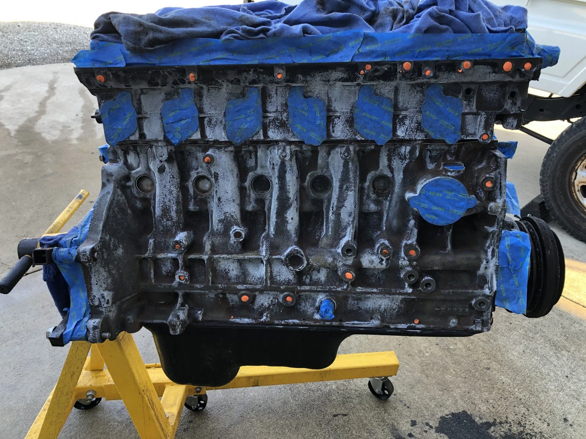

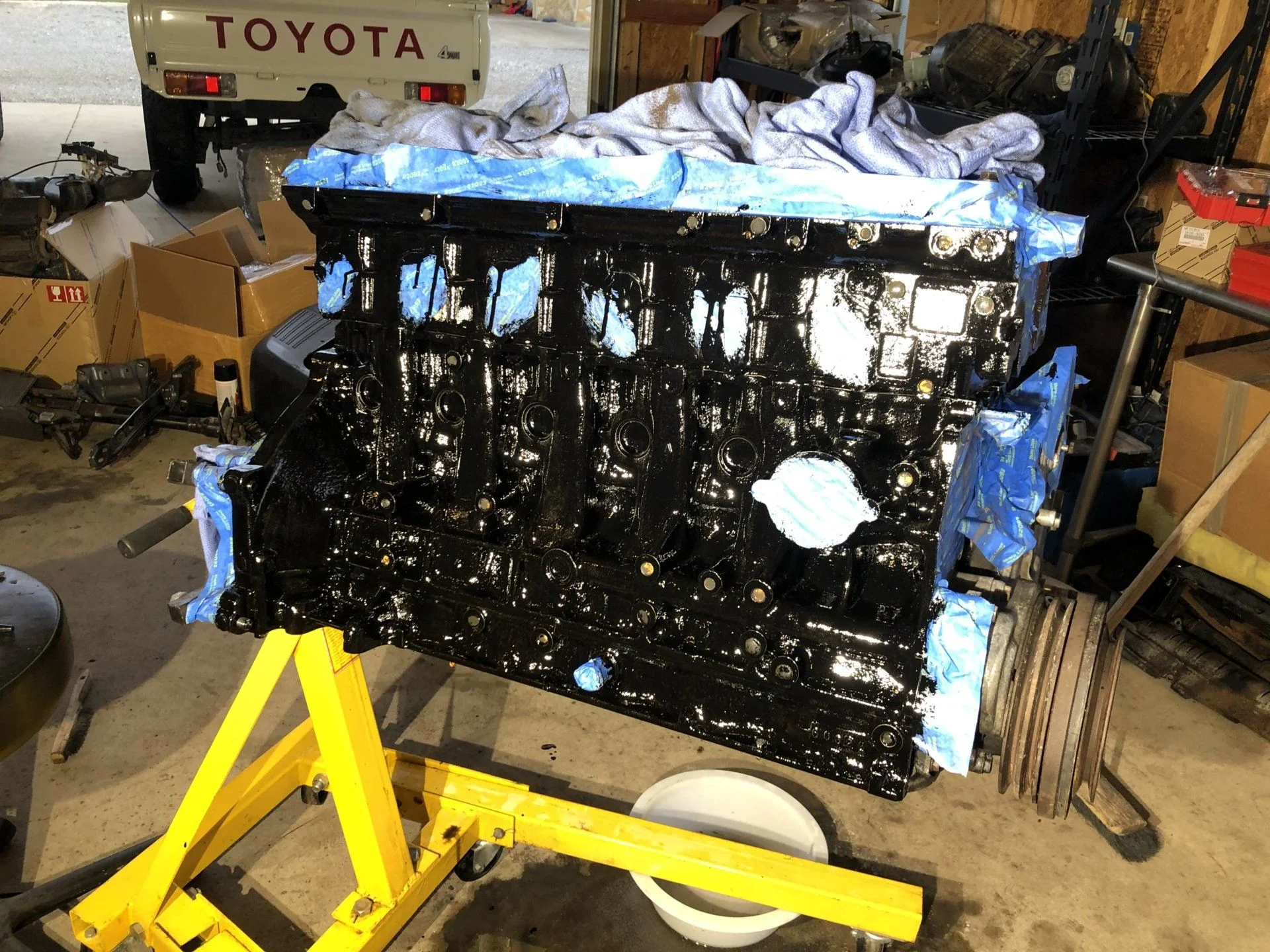

I finally just gave up making my block look as clean as @SNLC’s, and just treated it with the KBS degreaser/cleaner and Rust Blast. Now it looks like the motor has frosted wingtips, which is not a great look. I Blasted a couple more areas that still had residual surface rust. I’ll wash it off again, and let it sit overnight. Enamel goes on tomorrow.
Also, fun fact: if you turn compressed air from the air compressor directly onto one of those little earplugs, it will shoot out at you at approximately 3000 mph. Usually right into your eye.

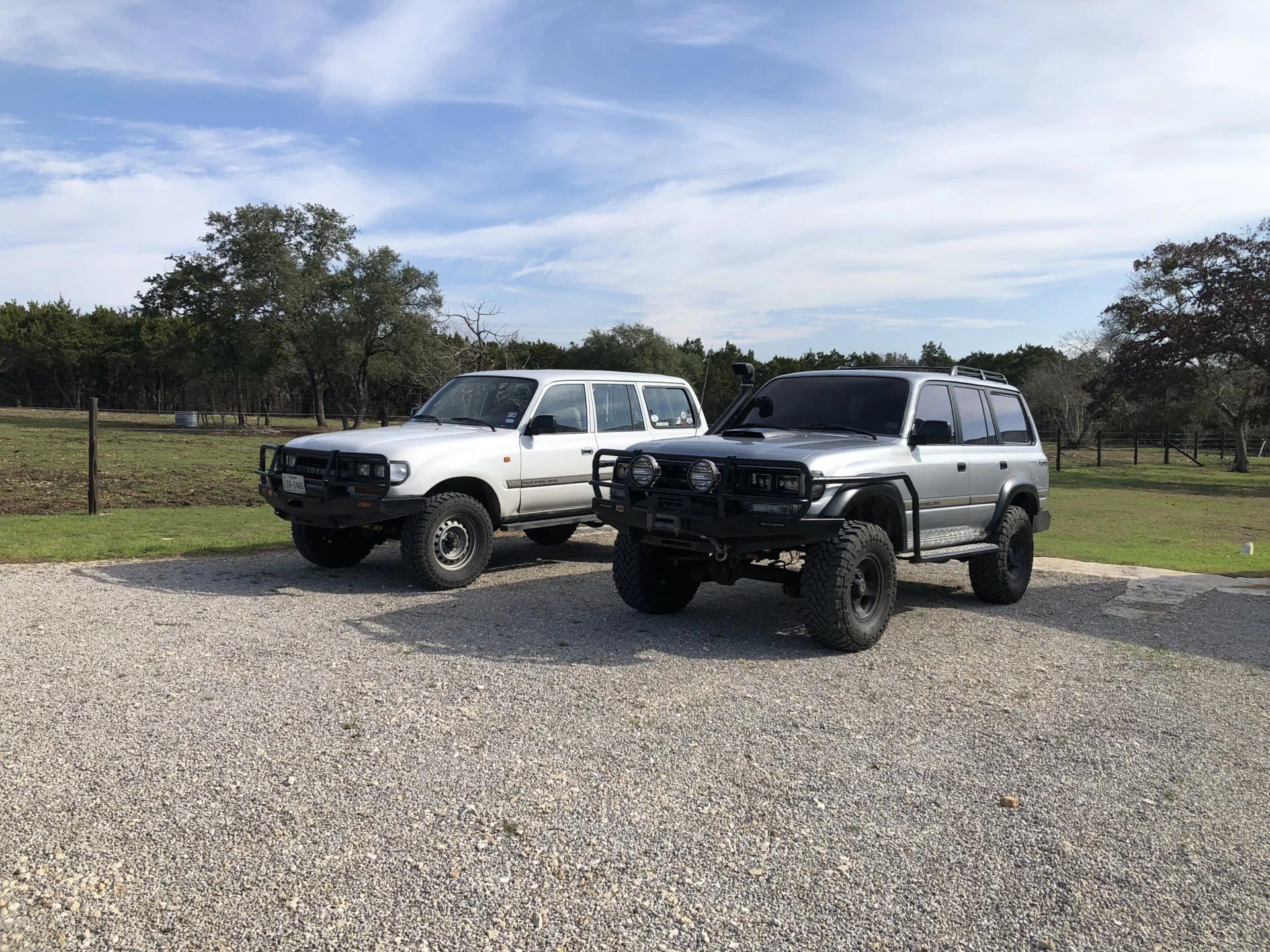

Yesterday was derailed slightly in terms of getting 79 work done. I traded one diesel 80 for another. @joekatana keeps supplying me with incredibly cool trucks, and I am very, very grateful for that. My poverty pack 80 is staying in Austin with my good friend @davegonz, and Dave’s turbodiesel 60 is staying in Austin, too. Follow all that?
All I know is that Marilu the HDJ80 is the nicest truck I’ve ever driven, and certainly the fastest.

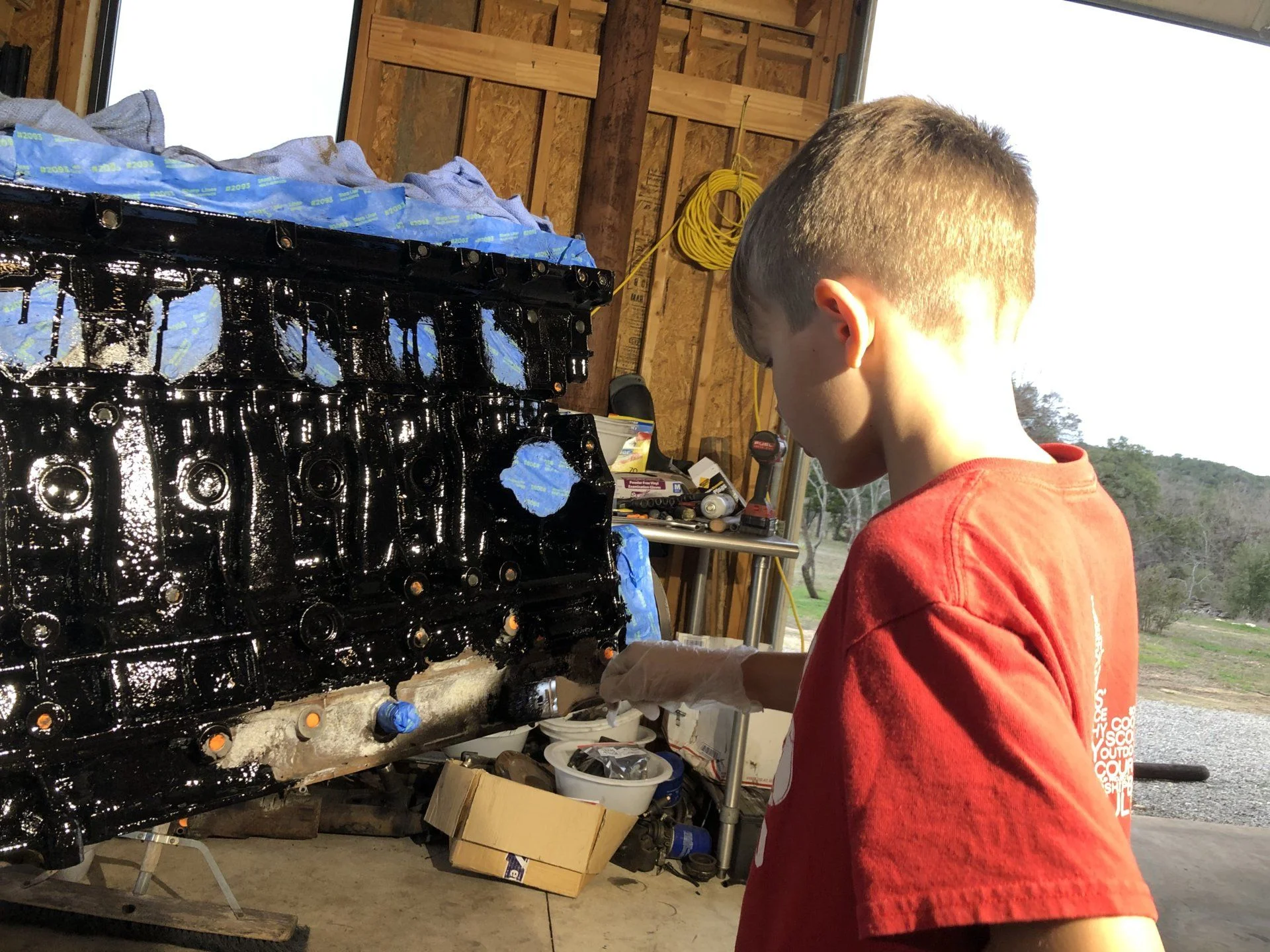

I finally got the enamel brushed on the block this afternoon.
I had an apprentice with me to finish out the painting. Luke, age 8, finished out the last corner of the block.

In the last five minutes of today’s workday, I started to unmask the painted FT block. I thought I was all done with razor blades, but clearly I am not. Overall I think it looks at least half decent.
I’m sure it will be super looking all assembled.
Kelly, as said by @Mr Cimarron and @davegonz, it’s not just good, it’s good enough!
