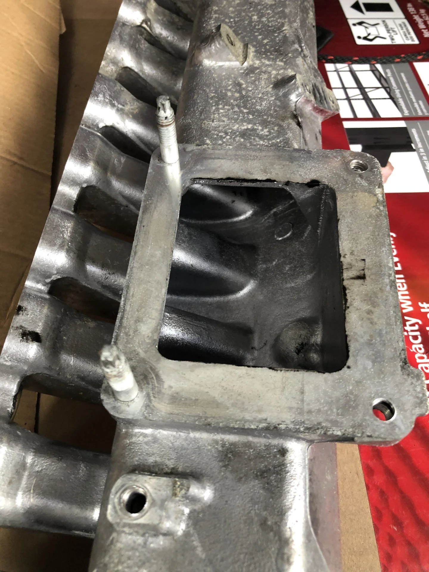

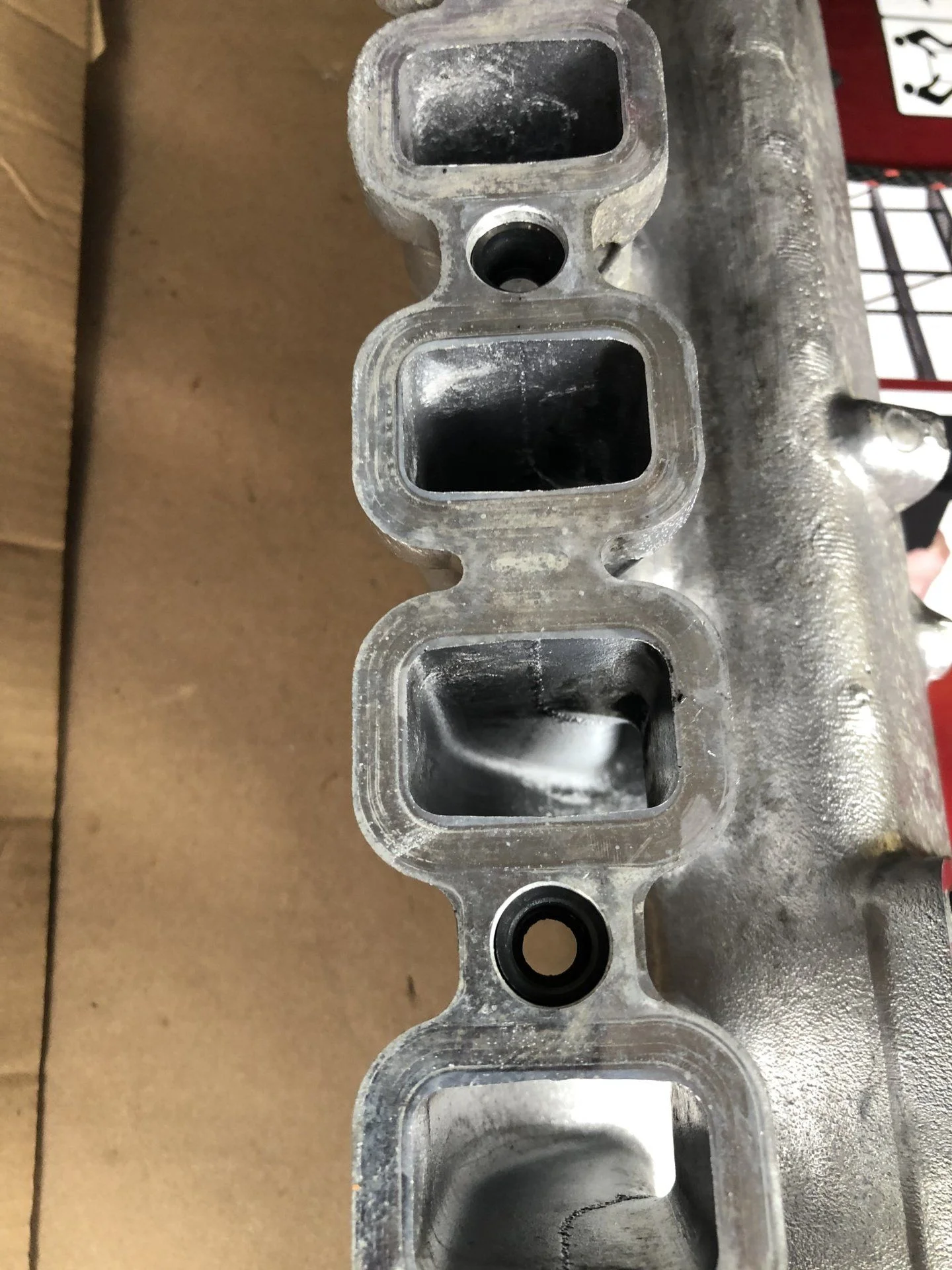

I did get the FT intake manifold cleaned at the only remaining good radiator shop in Austin. I had made some progress cleaning the carbon goo out of it, but they got it shiny and clean.
I asked him if they hot tanked it, and they only replied that they had used ‘other methods.’ Proprietary secrets, I suppose.
Now off to @roma042987 for some vapor hone goodness.

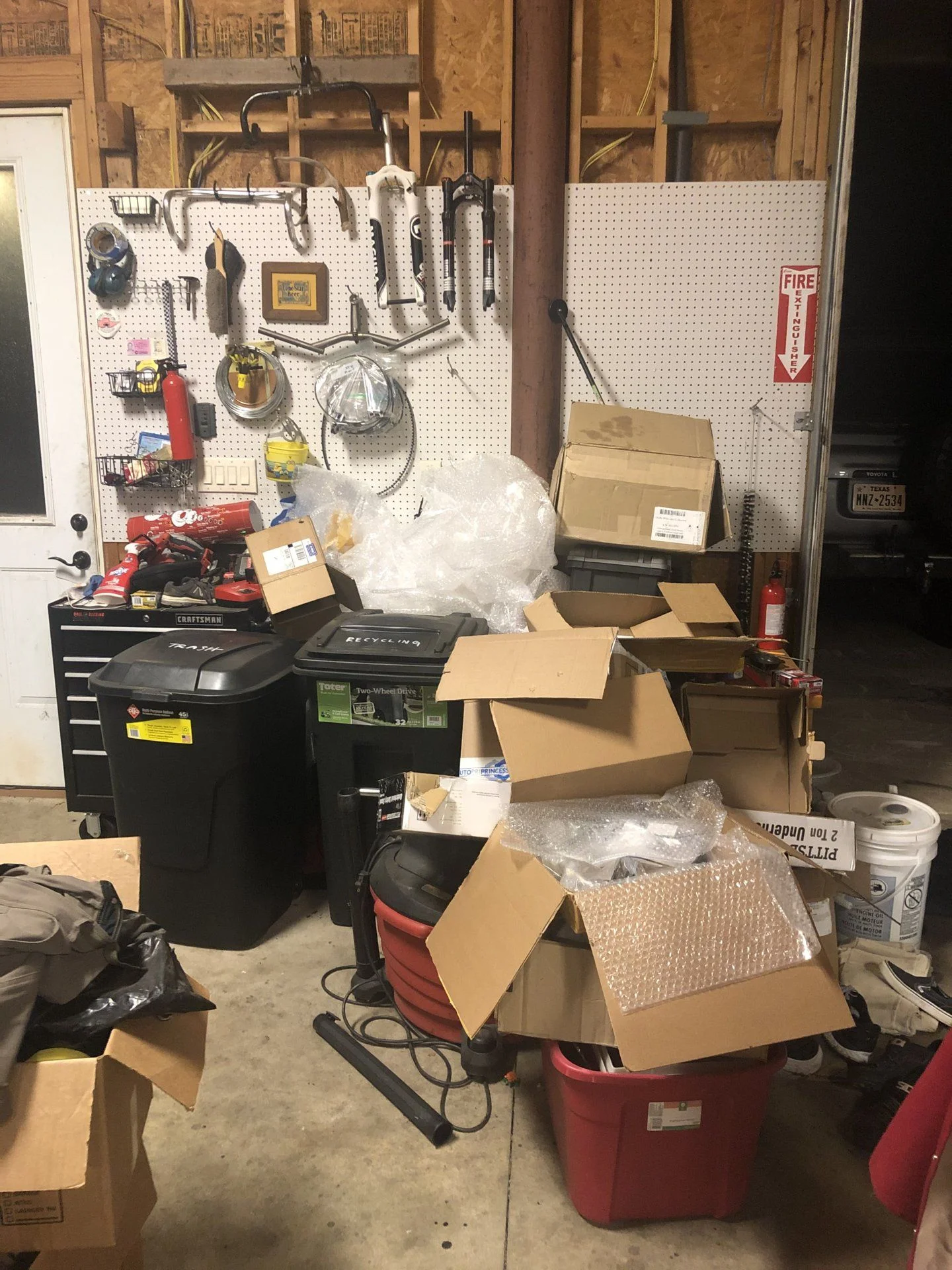

I just made the ‘DHL recycling zone’ over in the other corner. That’s the extent of the ‘cleaning’. Though I did wrap the h55 I sent @SNLC in about 300 wraps of extra Partsouq bubble wrap before my kids could stomp the bubbles out of existence.

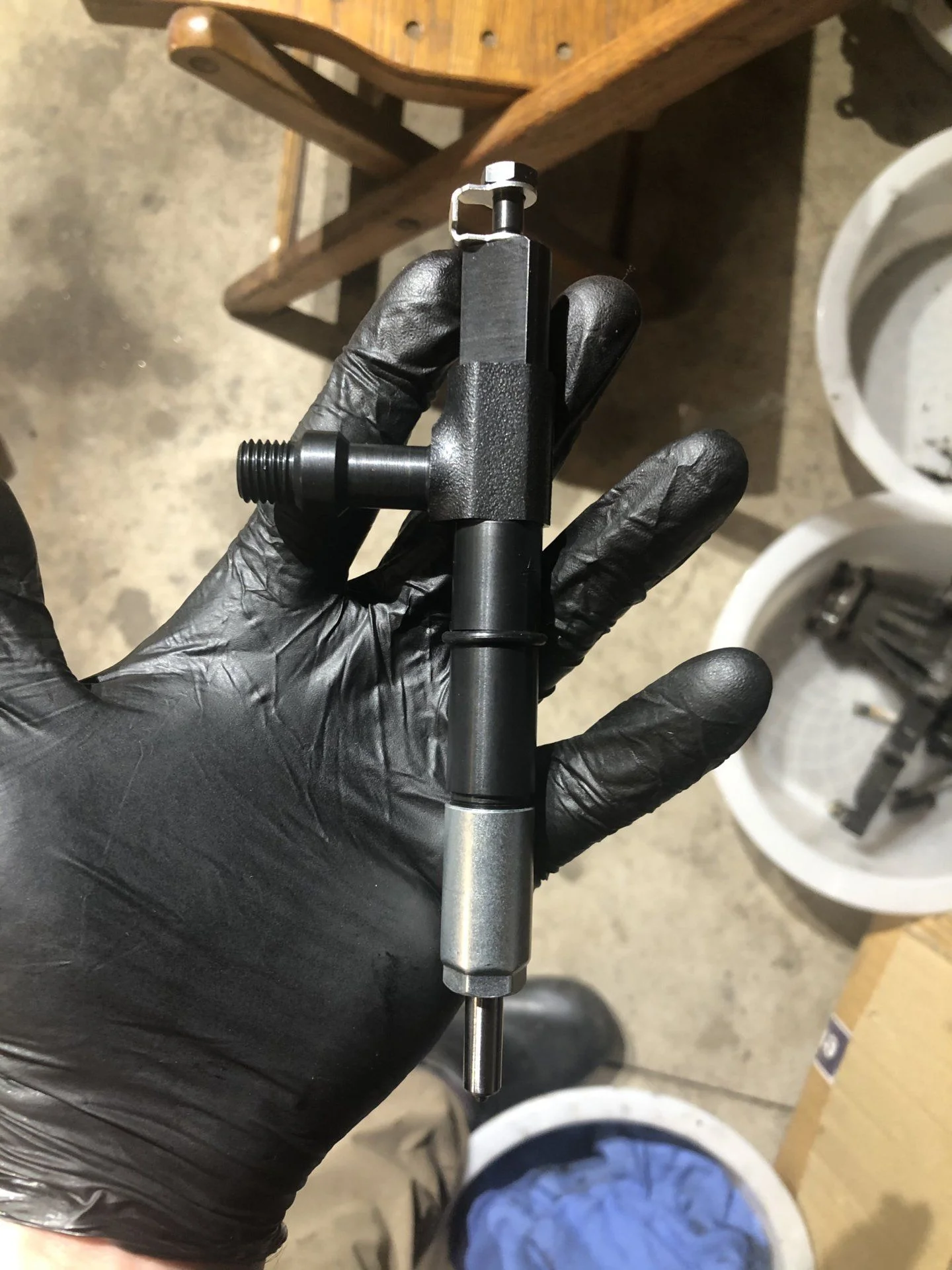

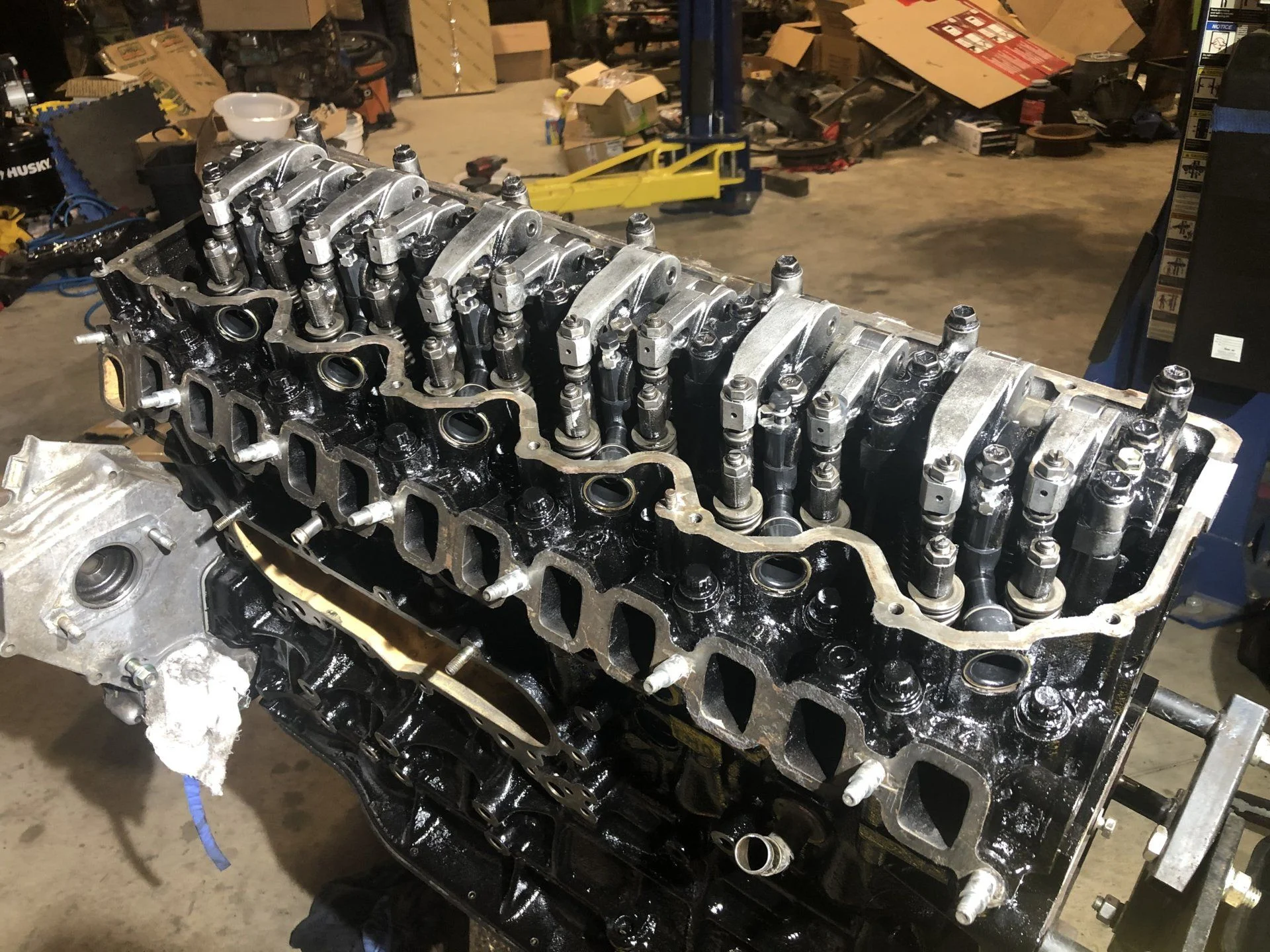

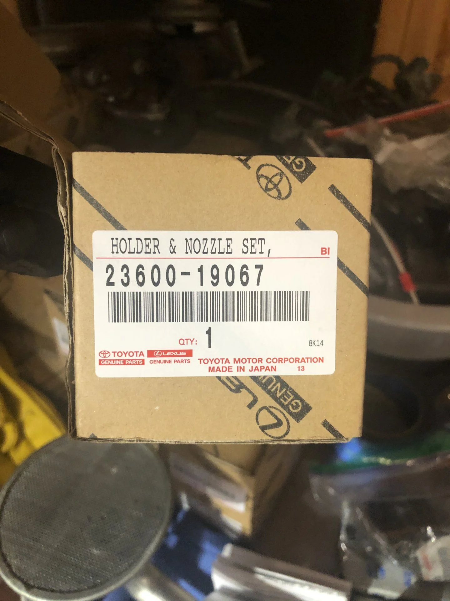

In actual progress I got the injectors in. These things are freakin’ expensive. I held onto them with two hands. Injector #4 was a tight fit; I had to tap it in with a rubber mallet. All the others slid into place easily.

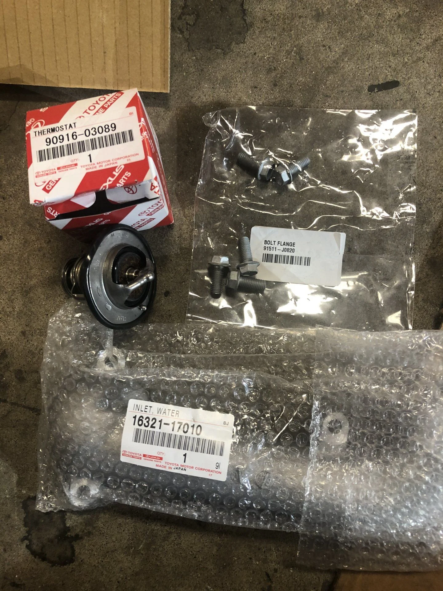

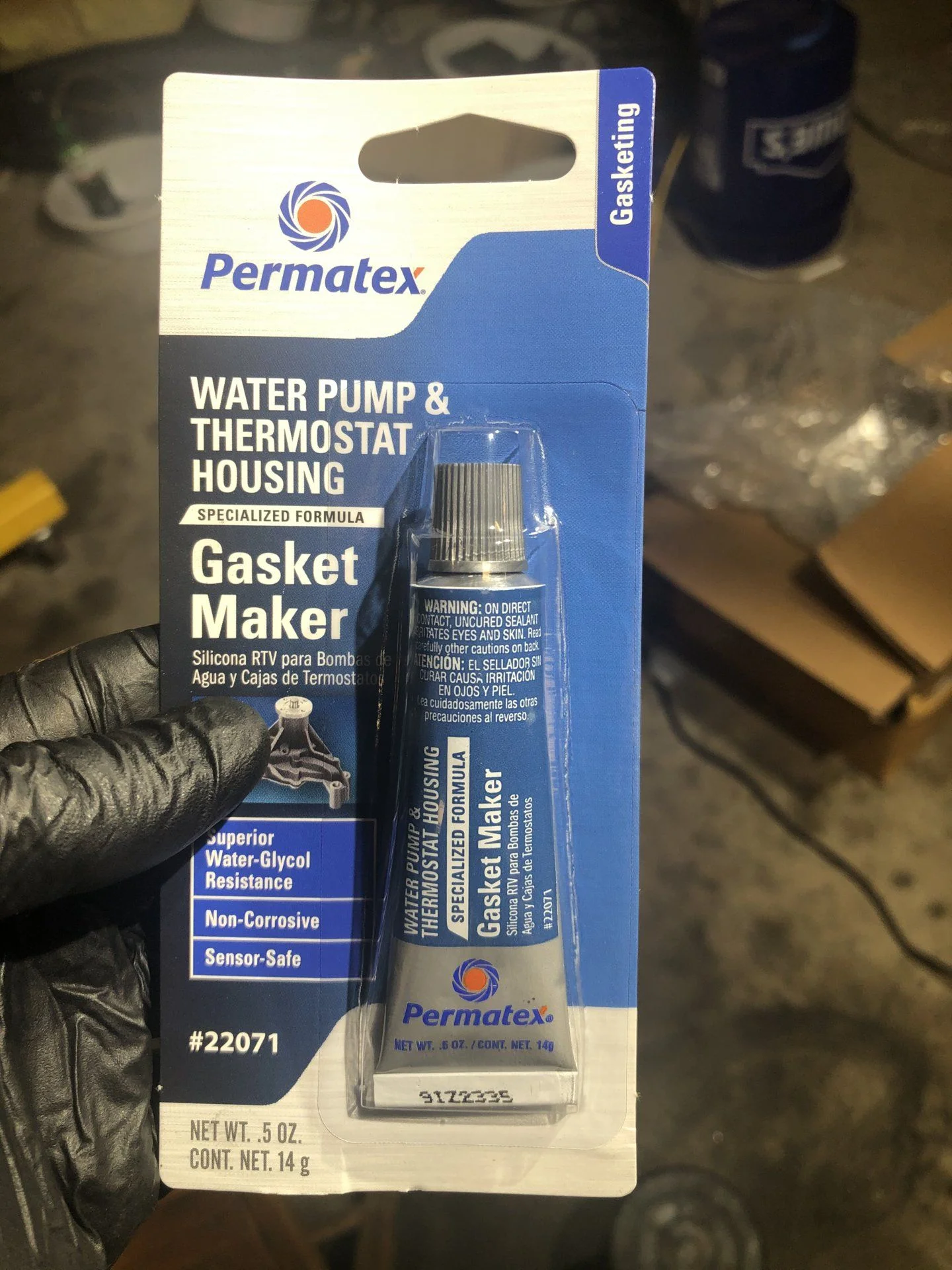

Thermostat and water inlet on, with a shmear of water/coolant formulated Permatex. thermostat gasket part number, not pictured here is 16346-66020. I used the one out of my engine overhaul gasket set (04111-17020).

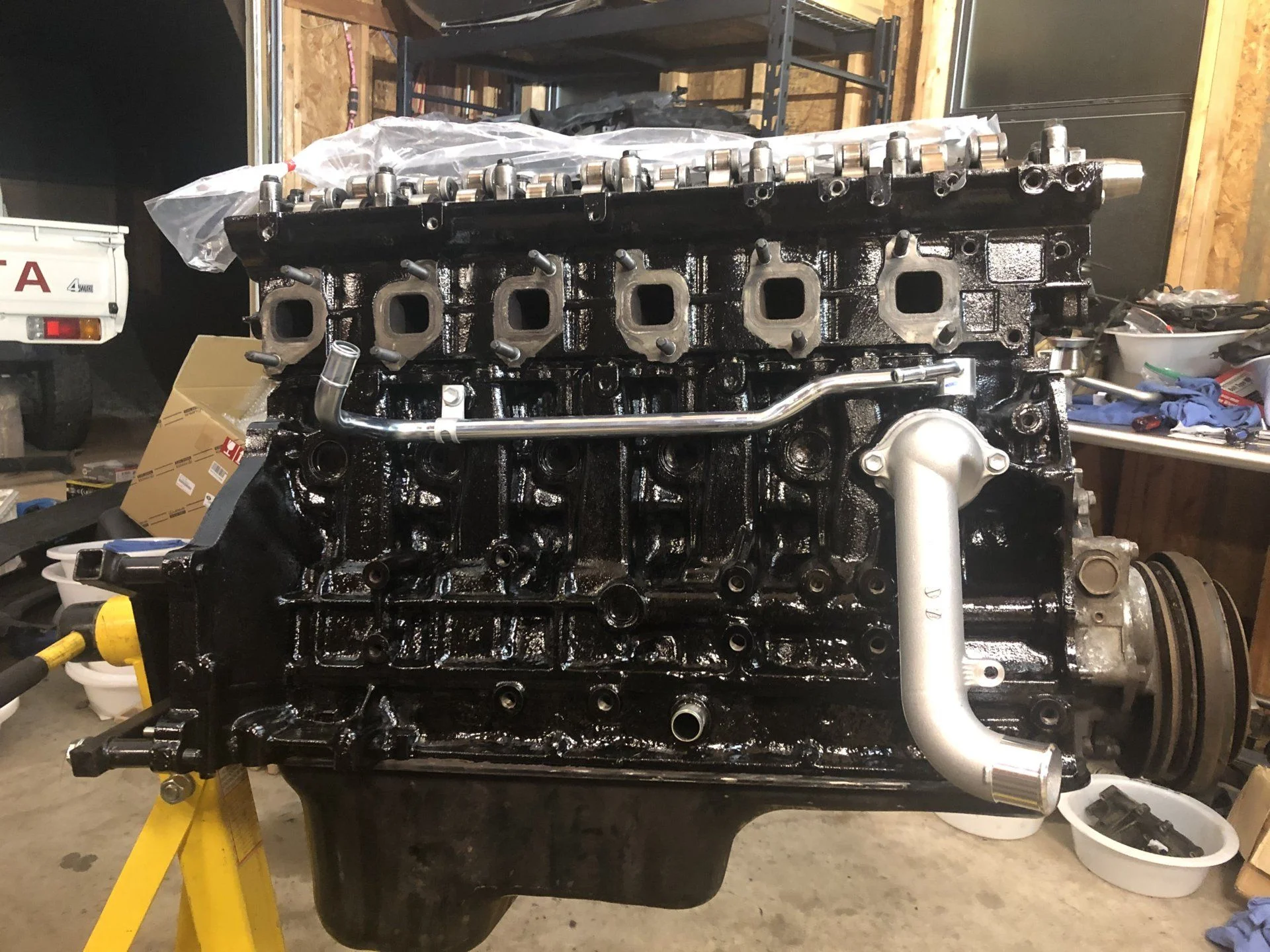

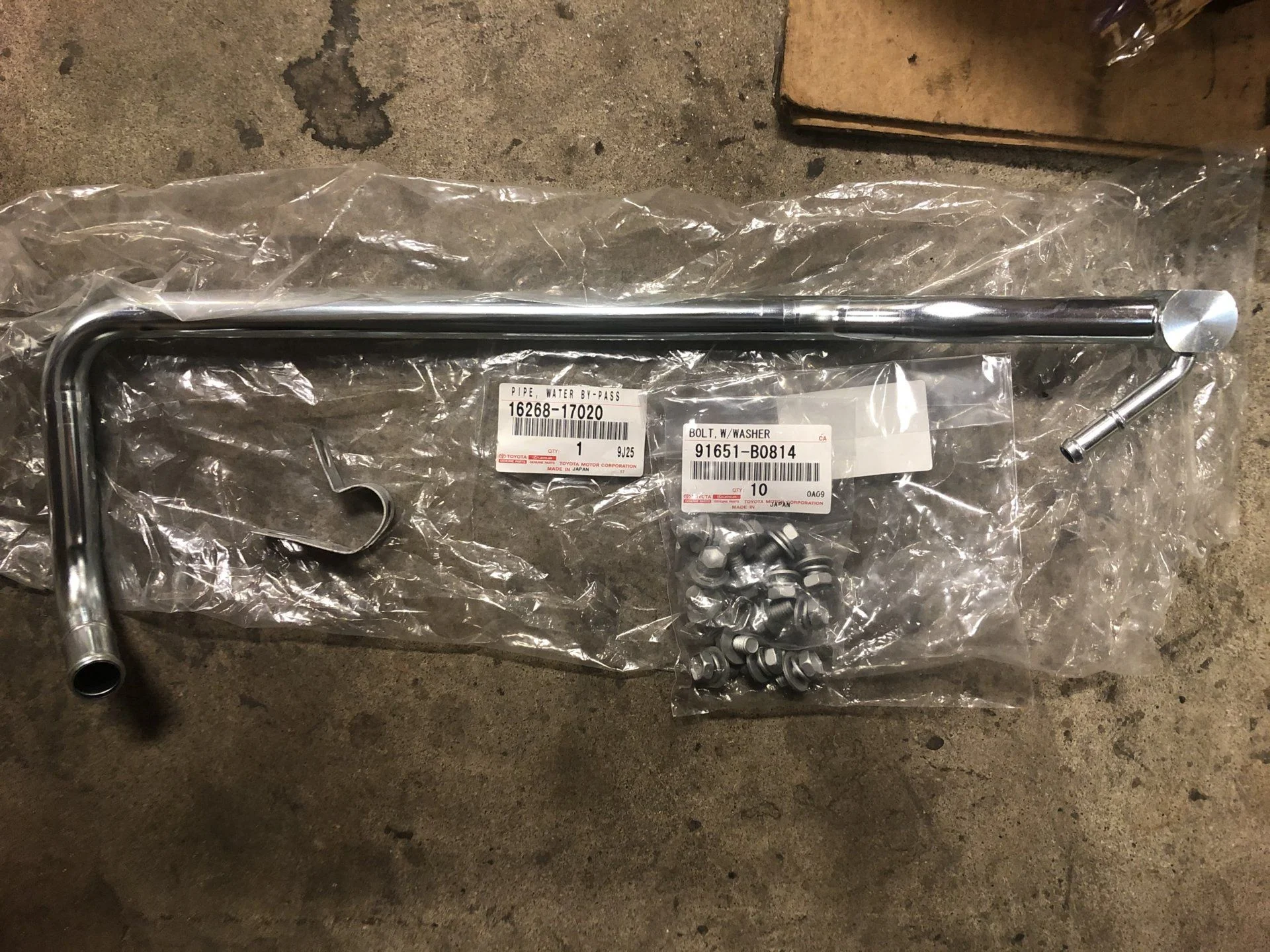

Water bypass pipe on next, with a quickly spray painted support bracket. New parts and hardware are a joy.

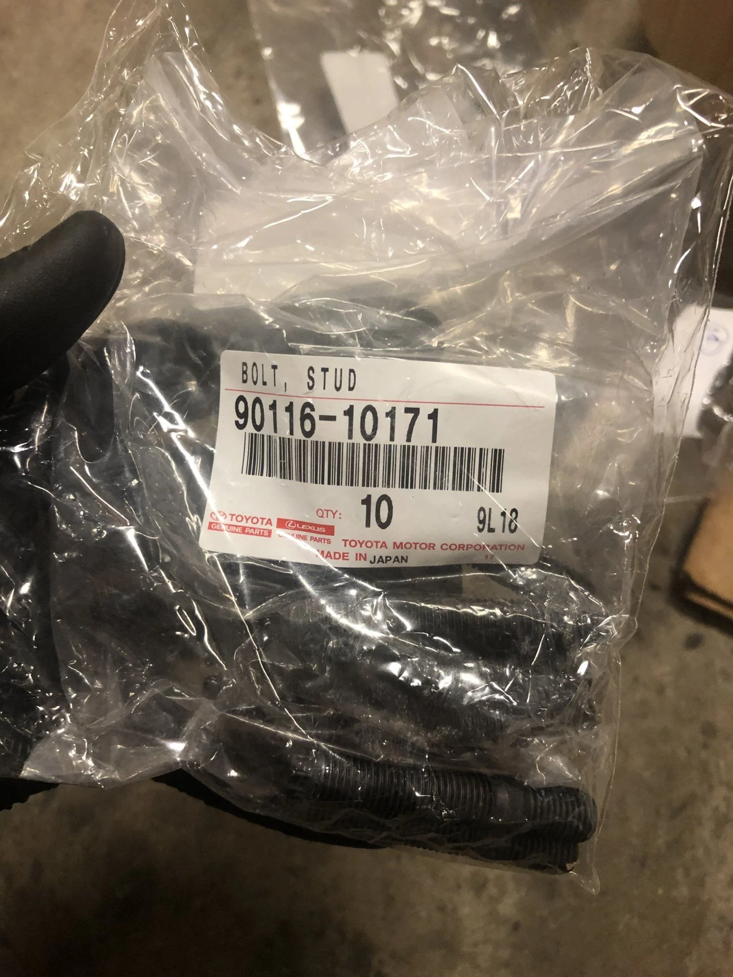

Exhaust studs are next. I need to grab a set of external torx bits. Yes, I could just double nut it but I’d rather do it right.

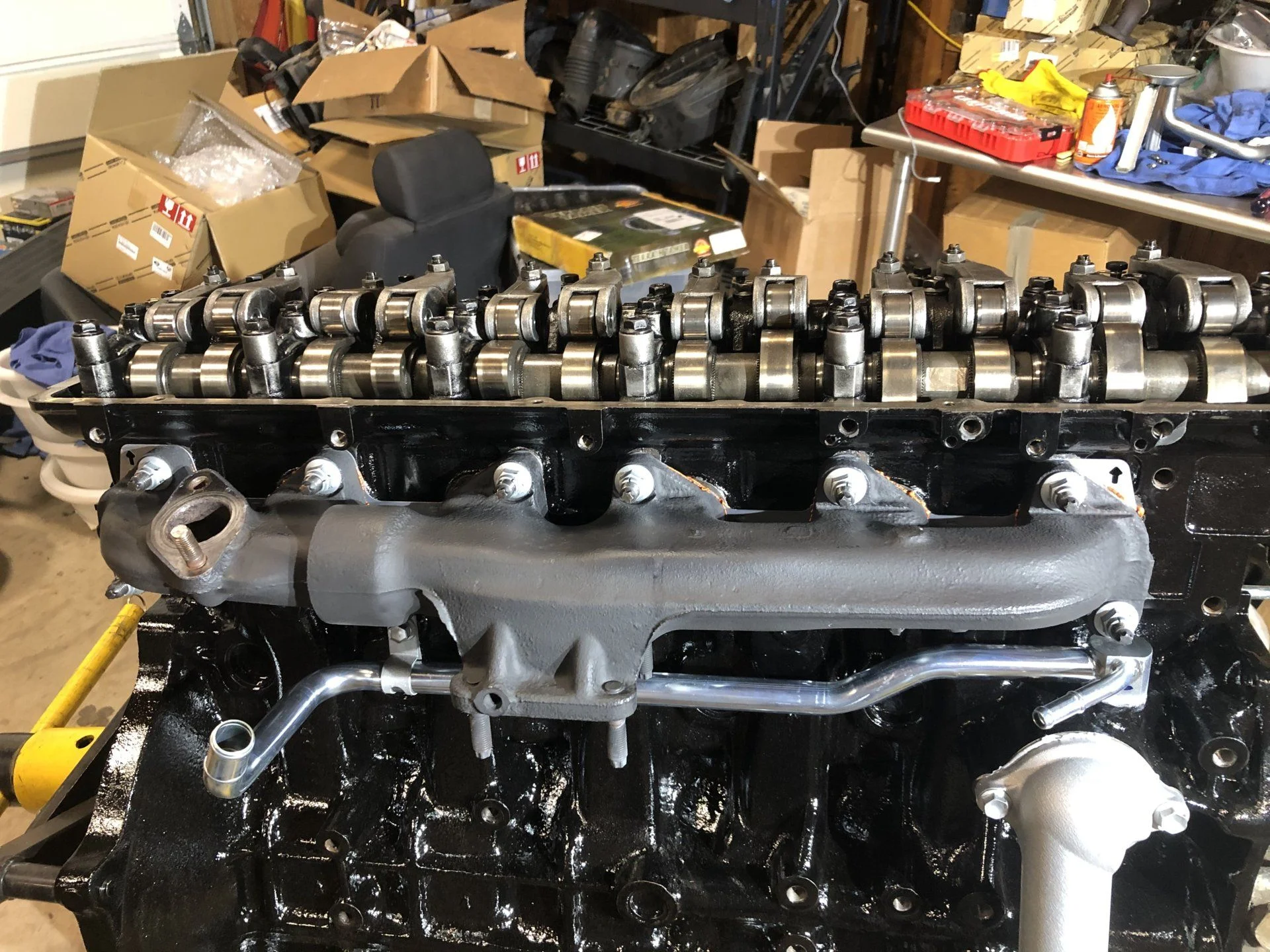

I got the exhaust manifold on, but of course didn't read the FSM...the turbo is supposed to go onto the manifold FIRST. Fudge. It'll fit if I unbolt the water bypass pipe.

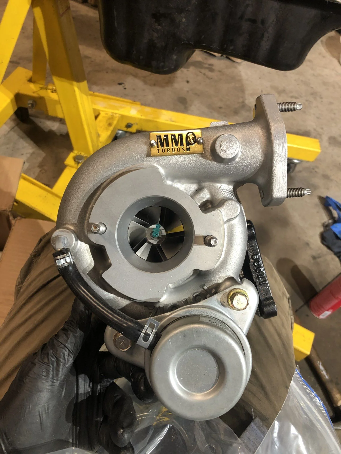

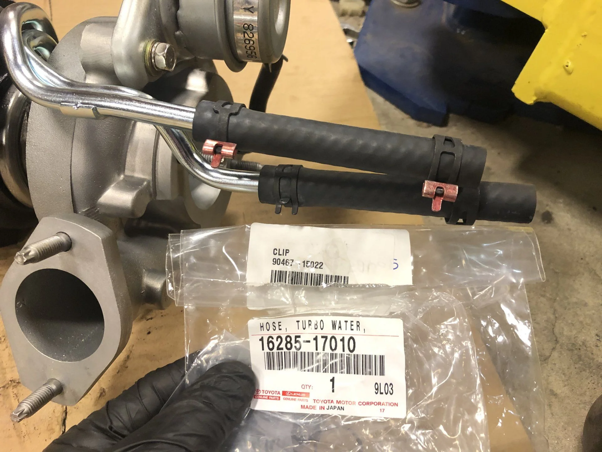

Start getting the MMP 1HDFTE turbo ready to go. The turbo water pipes went on fine but....of all the thousands of parts here I don't have the two turbo oil pipe studs. And I've had the turbo in a box here for a year and didn't look it over fully. More naughty words. Ordered the studs.
Can't find the third flange bolt that holds the turbo onto the turbo stay. This is getting old. Ordered it.

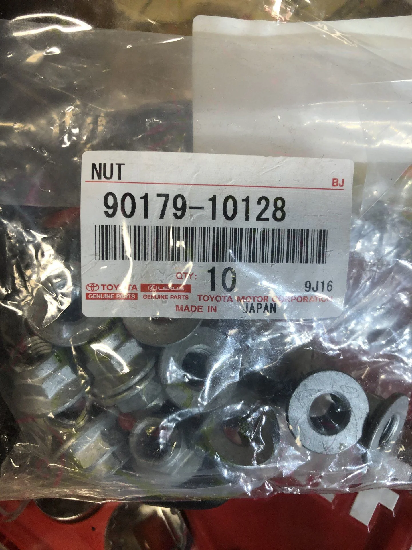

I went to put on the water pump. Pump: check. 5 bolts 91511-B0830: check. 2 nuts (shut it, Tucker) 90179-08040: check.

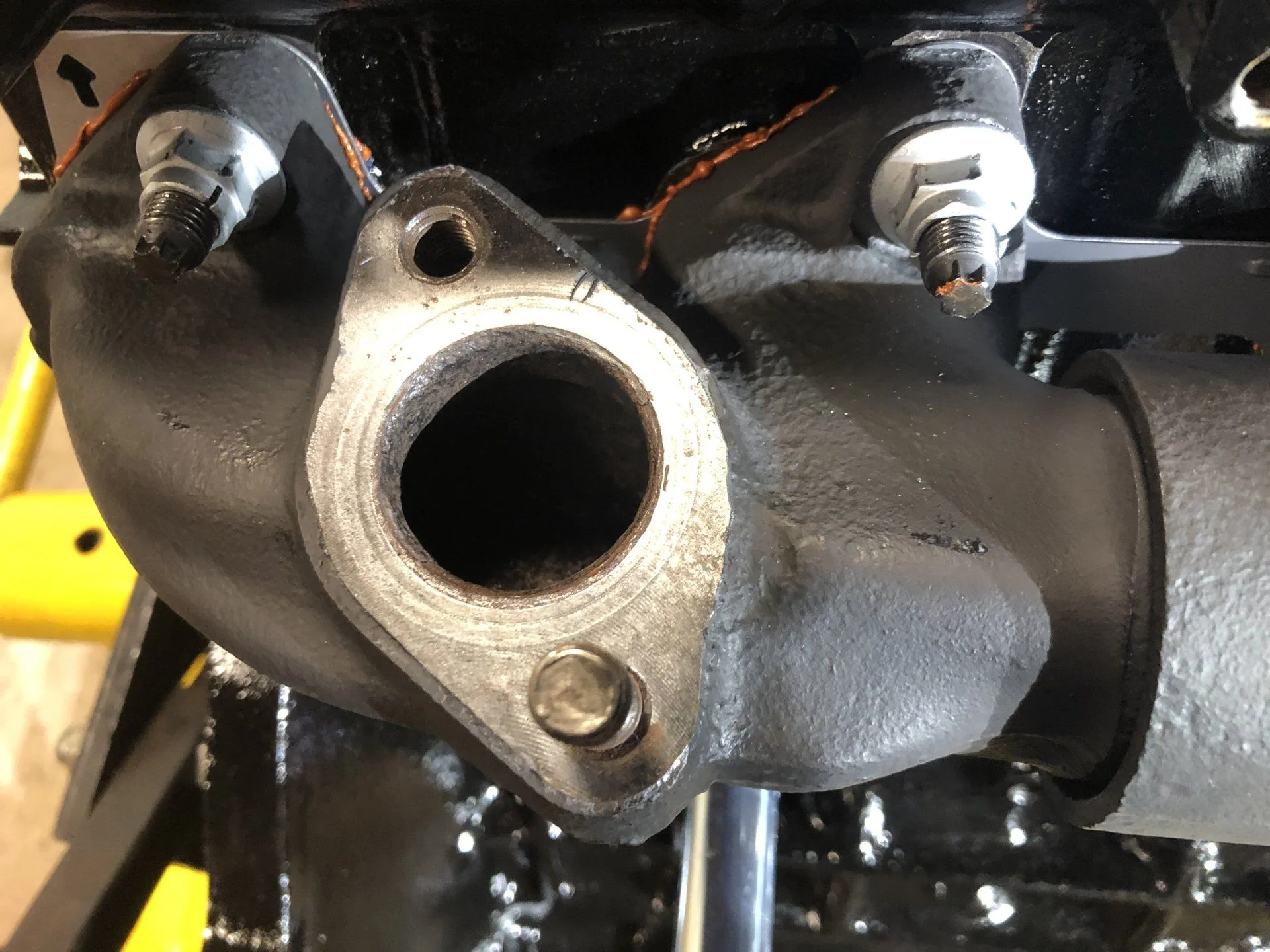

Exhaust manifold nuts. Side note: tightened the studs to a little more than hand tight with an E6 external torx driver.
I’ll make a blanking plate for the EGR system and put the EGT probe there. Once I order the missing stud.
MMP 1HDFTE turbo, fresh rebuild to stock settings. I am using an FTE turbo because 1. It’s sitting on the shelf and 2. I loved @davegonz ’s setup using this turbo.
