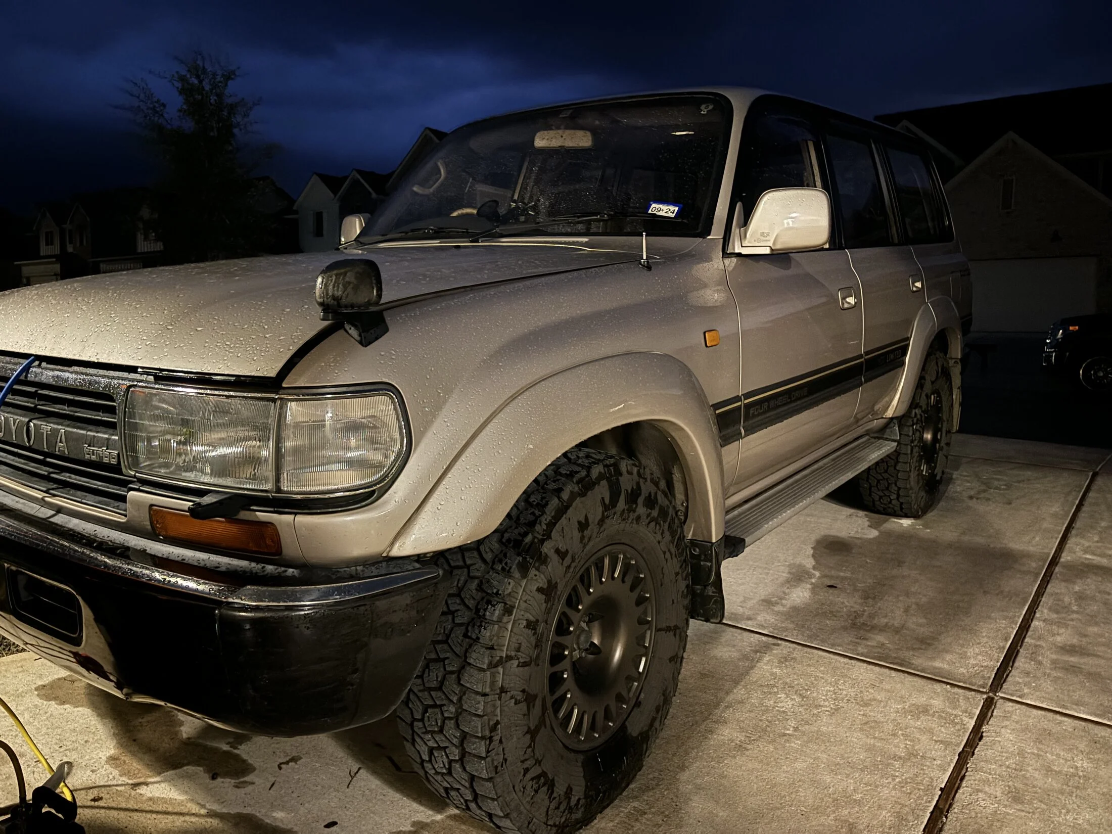

After weeks of searching and crunching numbers on importing either a KZJ78 or an HDJ81, I decided to search the old FB Marketplace and Craigslist for one that had already been imported. There were surprisingly more than I thought there would be. There was the typical gamut ranging from too expensive to too clapped out or modified for me. Then I ran across this gem on the Marketplace in Rowlett, TX. Same year and color as my first Land Cruiser but with far fewer miles and tons of the JDM goodness I really wanted. A few conversations with the seller and a price agreed upon, I was set to pull a u-haul trailer up and snag her over the weekend.
Carpet and seats are damn near immaculate. Headliner and dash are pretty great. Even the D light still works!

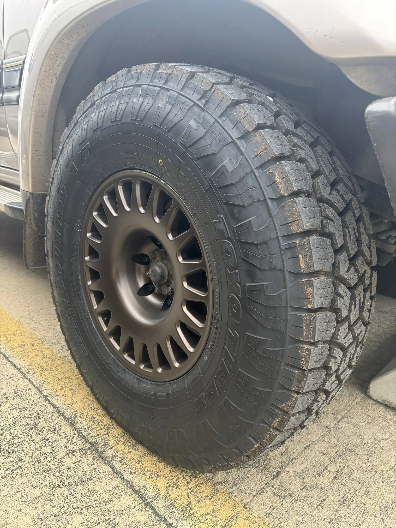

Also decided to spurge on a new spare tire to match the setup the PO put on her (Toyo AT3 & Nomad Sahara) since what was under the truck was completely trashed. I’ve never bought “expensive” fancy wheels for a rig before. Historically, I have either run oem wheels (new or existing) or some cheap steelies of some sort. I’m actually really digging them. I might’ve picked something slightly different but these are pretty badass. Digging the AT3s also. Anxious to see how the do for me.

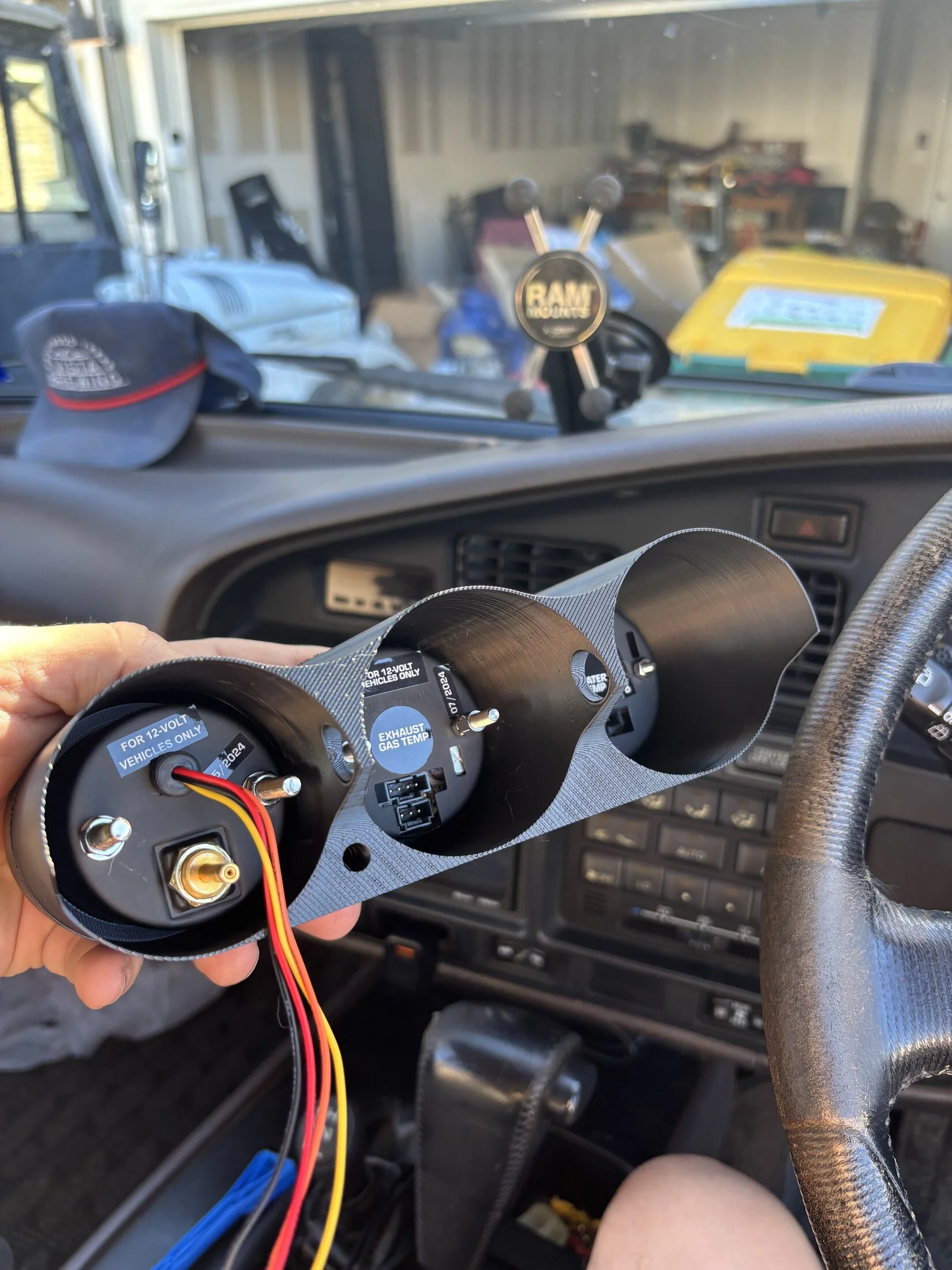

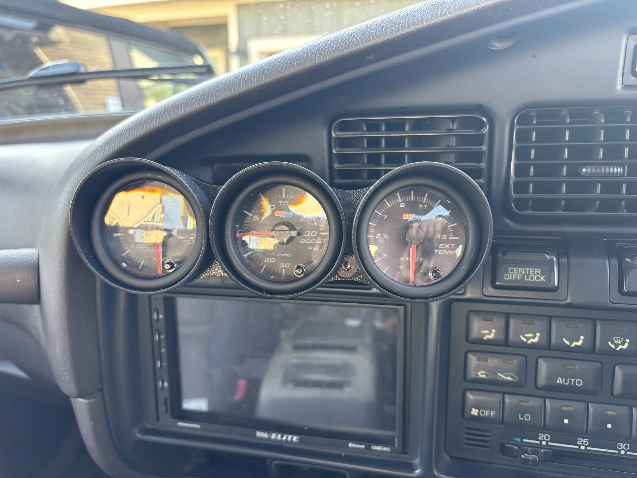

In an effort to prepare for my goal of squeezing more performance out of this old girl by turning up the boost, fueling, etc. I have started the process of adding some gauges. So taking the advice of my new best diesel friend @davegonz I purchased some gauges in the EGT, boost & water temp flavors to monitor critical metrics and avoid melting expensive stuff.

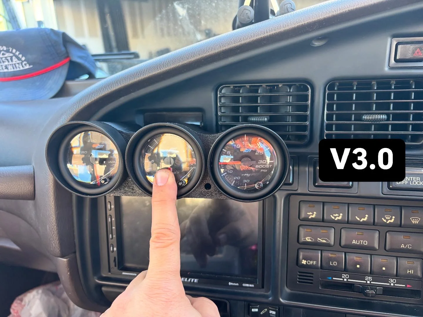

This project coincidently coincided with the purchase of my first 3D printer. And so I set about the task of designing and printing various parts I have dreamed up/borrowed from smarter people for my new 80. One of these projects is called “where can I stick 3 gauges in an early 80 dash?”.
Iterations:
I dig it, but it covers more of the cluster than I’d like.
Next:
Not in the ideal location but not terrible. Plus it utilizes a relatively uncluttered section of the dash. Probably could’ve aimed it even more towards my eyes but I think it’s good enough for who it’s for.
Version 3 it is. Mounted!

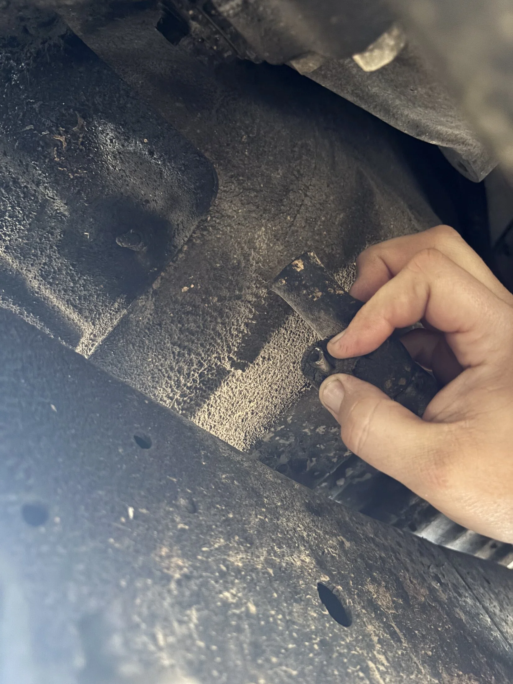

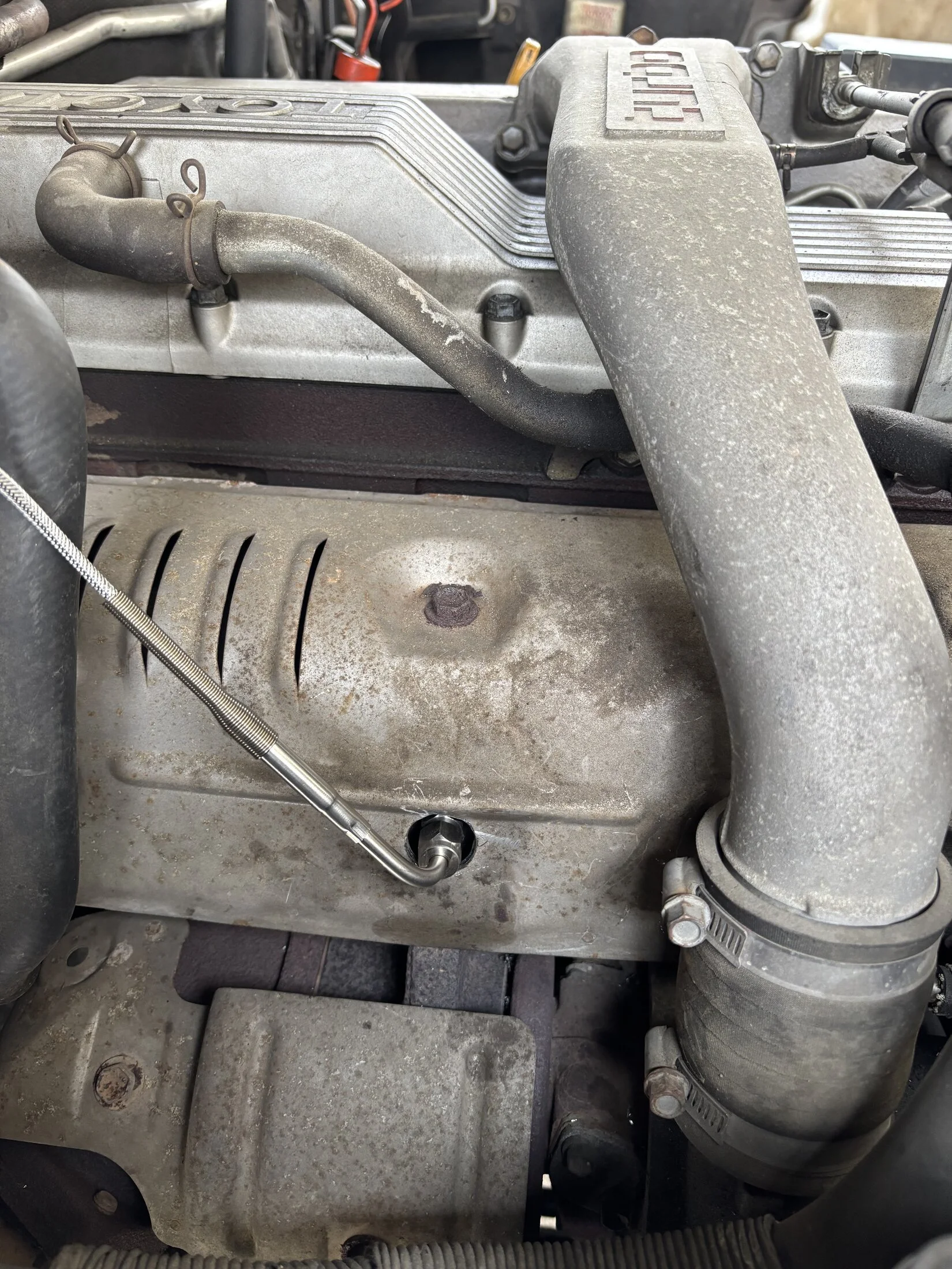

Still need to finish wiring and installing sensors but I was able to tackle the EGT probe install while the wife didn’t know my whereabouts.
It’s nice to only be slightly nervous about drilling a large hole into my exhaust manifold instead of being outright terrified. Something about refurbishing a clapped out 40 will do that to a guy.

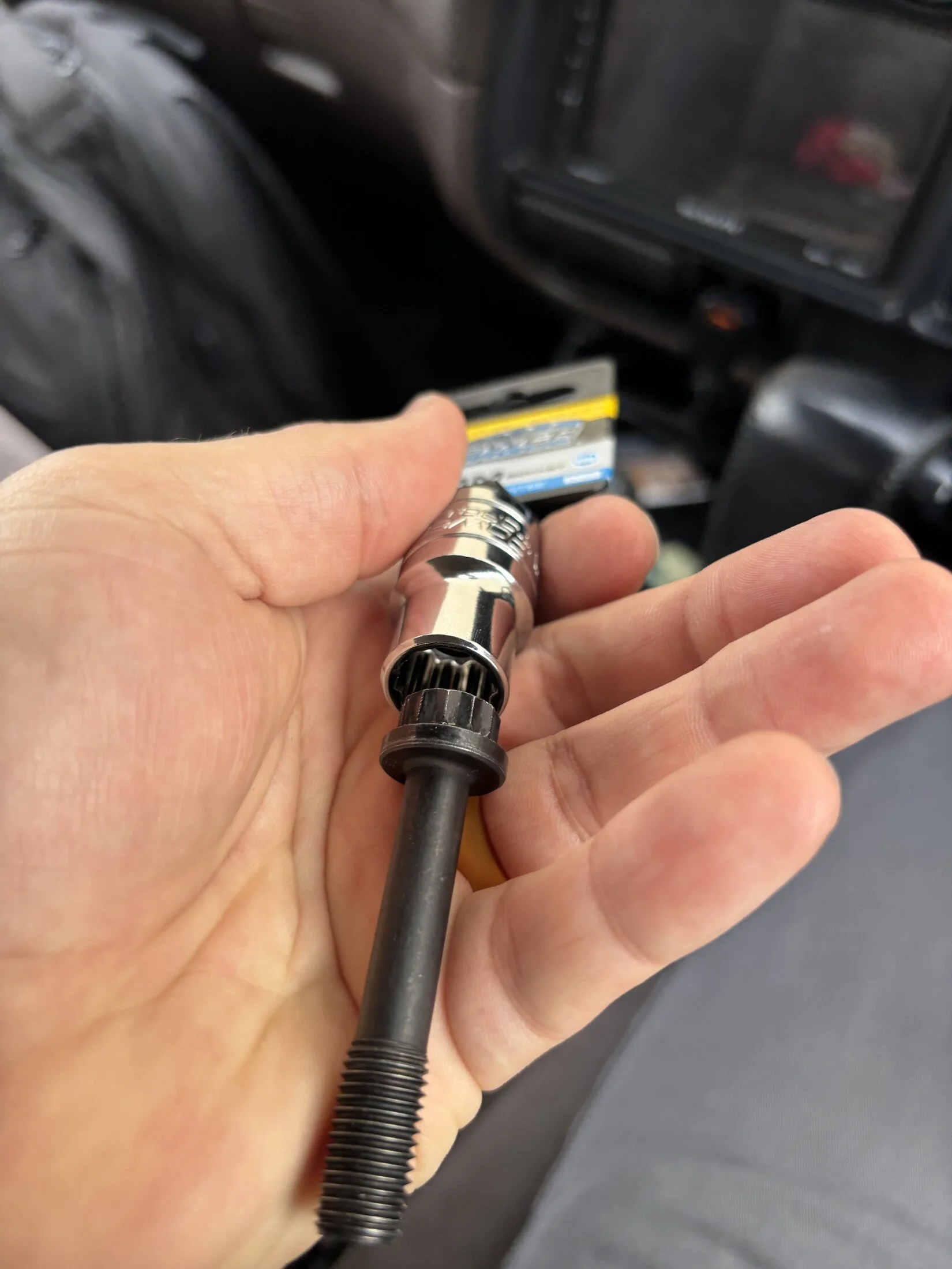

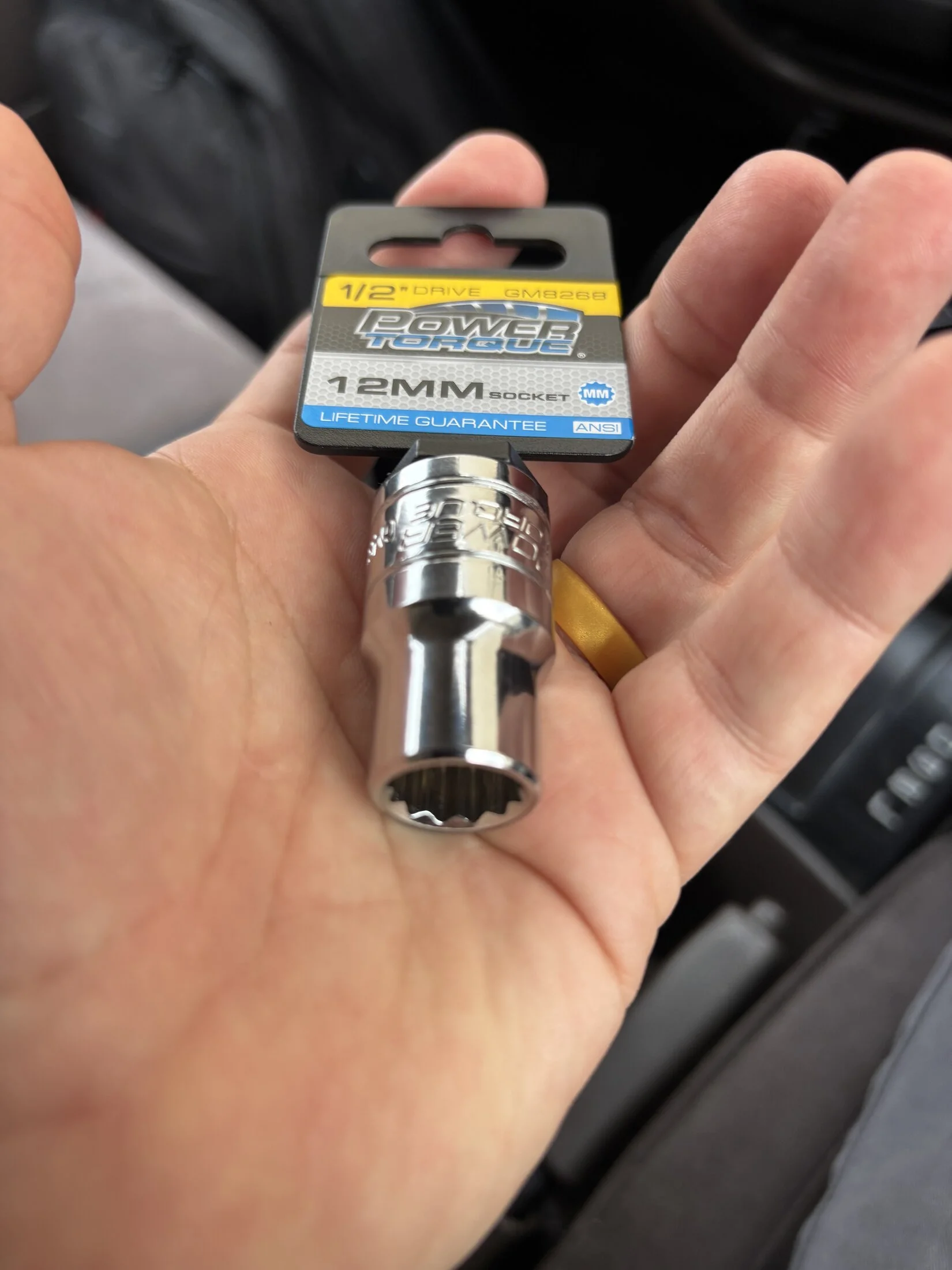

After far too much google searching and talking to small town parts house guys unnecessarily I finally got the correct socket for the connecting rod bolts. Turns out it’s nothing fancy whatsoever. Just a 12 point 12mm. Posting for posterity as I couldn’t find the answer anywhere.
Which gauges are these? Did you make the housing yourself? Thanks.
Those are Glowshift. I went for them because they more or less match the color of the stock gauges and the price was right. Actually just got them all hooked up last night finally.

Those are Glowshift. I went for them because they more or less match the color of the stock gauges and the price was right. Actually just got them all hooked up last night finally. View attachment 3841080

Nice, I need to get off my donkey and get these gauges done. What about the housing? Did you make it yourself? Great set up.
Oh sorry! Forgot to answer that part! Yes I modeled it in cad and 3d printed it. Thanks!
I emailed Glow Shift a while back and they said they didn’t make gauges for the HDJ81. Do you happen to have the model number or part number for these gauges? Thanks.

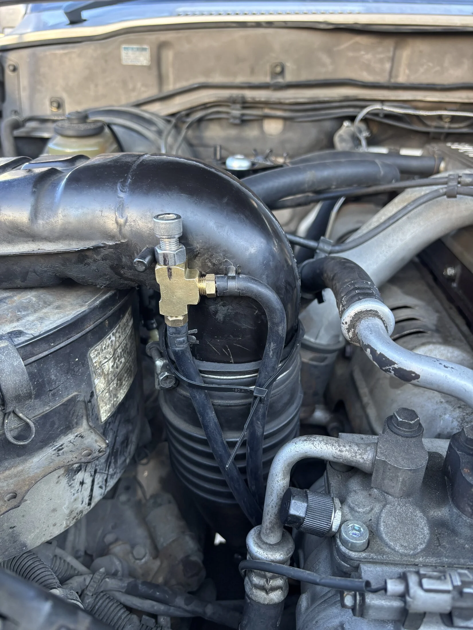

With the gauges installed, I’ve been fiddling with the fuel. Was still getting high EGTs so I turned it down again. Also got a boost controller installed finally. Fiddled with that and got it to give me 14-15 psi reliably. Getting the over boost light and hitting 1300F occasionally. Feels pretty good, I just hope I’m not doing damage. Exhaust and/or intercooler next.

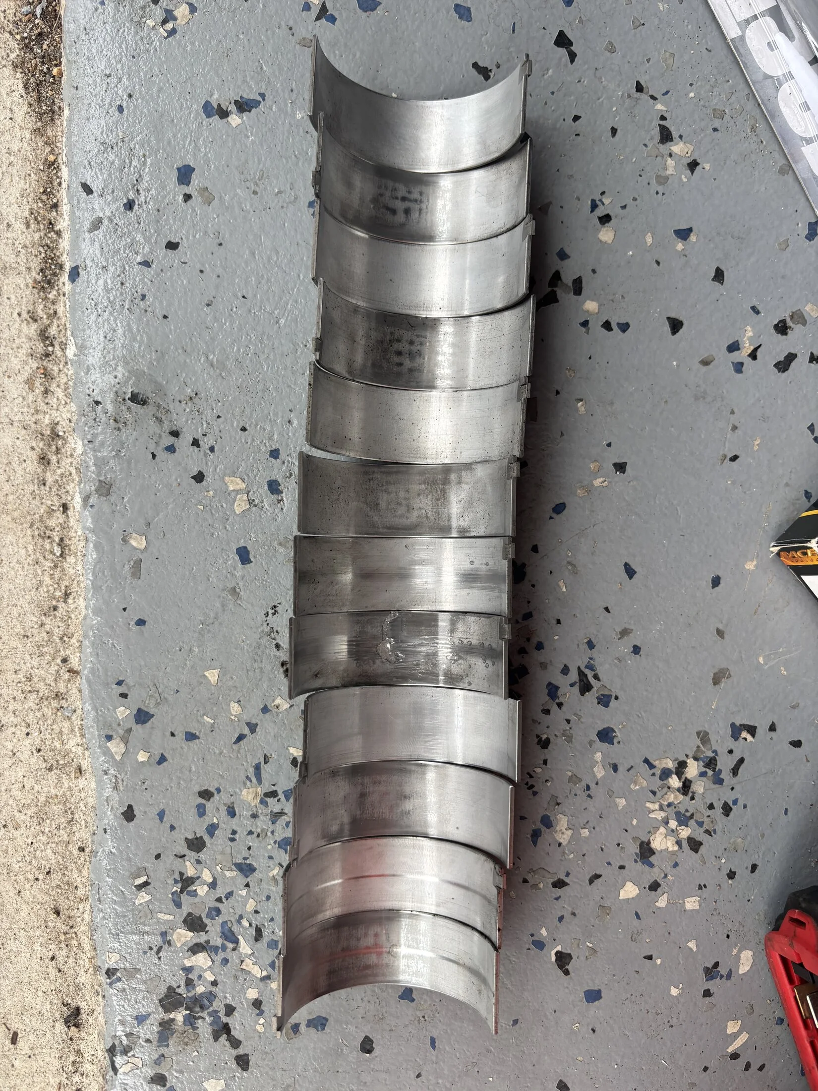

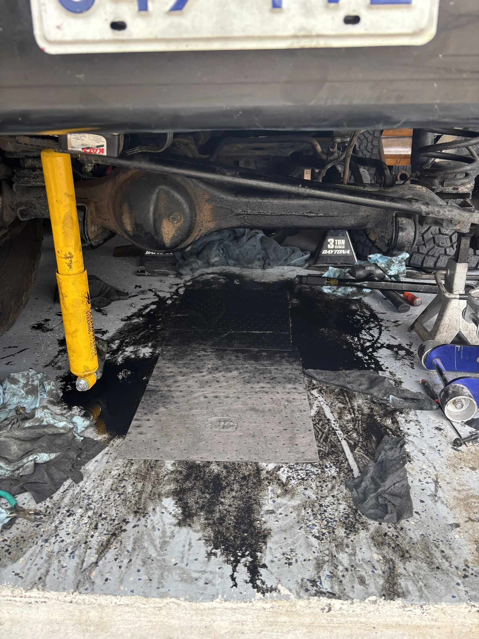

Keep forgetting to post this. Finally got around to swapping the BEBs on the 1HDT. Holy hell, what a job. I hope I never have to do that again. I was absolutely drenched in old nasty diesel oil the whole time. Pretty sure I ingested some and/or absorbed some via osmosis.
All but number 4 were still intact albeit with some damage on at least number 6 as well. Very glad I knocked it out. Also found some metal bits in the oil that appeared to be from what was missing on number 4.
Was the damage on no.4 the top or bottom shell? I have heard the bottom shell wears more. Thanks.
Actually all of the wear seemed to be on the top shells with the exception of the streaks on no. 4 and 6.
