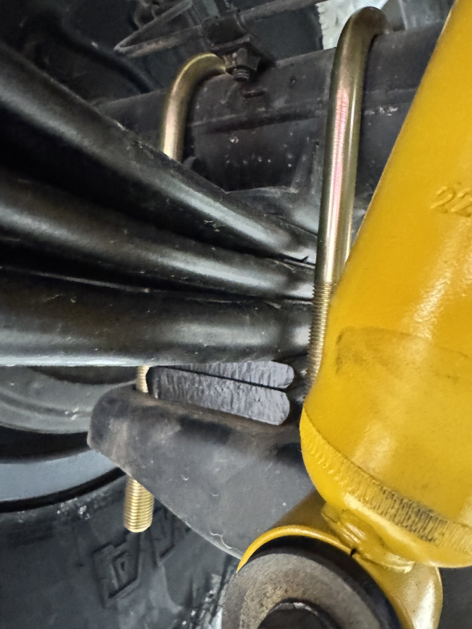

Aight, I put my thinking cap on and came up with the obvious fix for the ass high aspect.
These springs come with 2 spacers that are only there to fill the gap for a standard Ubolt setup to work. Without them most units would possibly bottom out and not get fully tight.
This is a real issue with Dobinsons springs because most ubolts are made for thick OEM packs.
So....simply move the spacers from the bottom of the pack to the top.
Instant 1" lower.
Tagging @orangefj45 for a tech tip
I was going to say, I wouldn't be surprised if there is some engineering reason for the location of those spacers and you'll need to move them back.
It's like you have a piece of wood in there now for some hill-billy lift action.![]()

Its not often you see people put lowering blocks into a landcruiserhow did tie the spring centrebolt up into the locating hole in the axle perch to stop the axle moving or sliding around

I am not sure if it has enough HP to get axle wrap, but maybe?I was going to say, I wouldn't be surprised if there is some engineering reason for the location of those spacers and you'll need to move them back.
No reason having those blocks on the top or the bottom would effect axle wrap.I am not sure if it has enough HP to get axle wrap, but maybe?
Having it the way you have it now can cause axle wrap, like adding lift blocksNo reason having those blocks on the top or the bottom would effect axle wrap.
