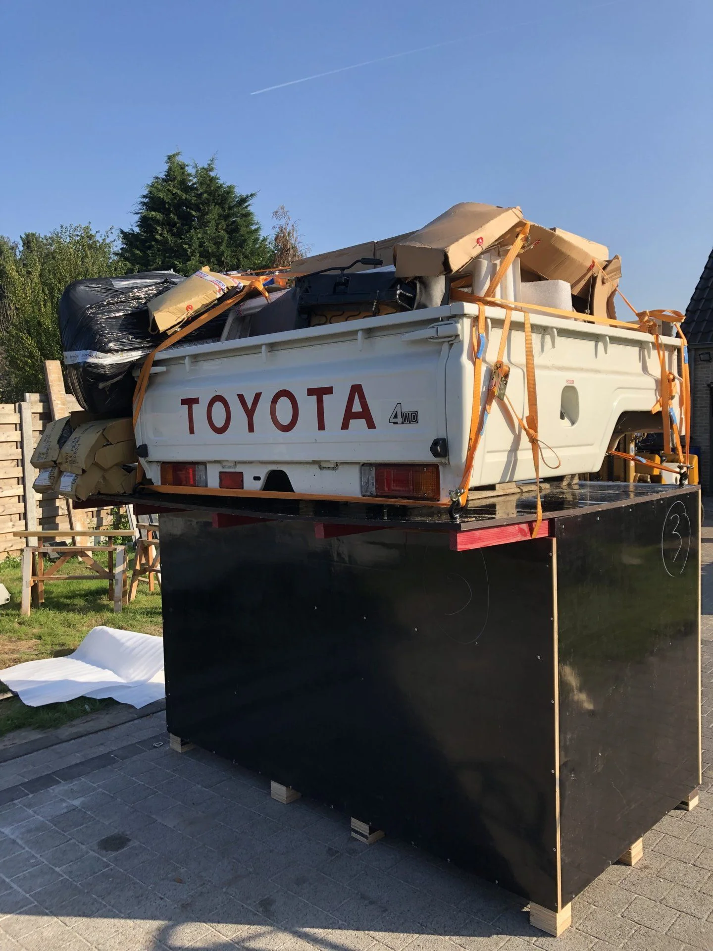

A few months ago, I was innocuously texting @joekatana and telling him much I was enjoying driving the HZJ80 poverty pack I had bought from him. He asked me what my plans for my next Cruiser project were, and I told him that I was pretty happy with the 80, sprucing it up while driving it daily. I did mention that I really dug @Spallet ‘s HDJ79 and @Mr Cimarron ’s Cummins/75/80 build, and that @c2dfj45 ‘s 79 builds were awesome.
I think my exact words were, “if you ever found a 79 pickup body, I’d love to build one.
And Joe texts me this:
I mean, it didn’t even take him 10 seconds.
And then this:
followed by:
And I had just bought a 1HDFT and H151 transmission from him, with intentions to upgrade the 80...well, that got derailed in about two seconds.
I immediately called Joe and we hashed out a plan. Joe volunteered to do the heavy lifting, i.e. all of the frame and body fabrication, and then turn everything over to me like a big pile of adult Legos. He had enough parts to make a complete wide nose 79 body, brand new, an old-style dash (which I prefer), and column, and brand new seats. Add to that a clean, Texas-titled, rust free 80 frame with factory locked axles... now we were getting somewhere.

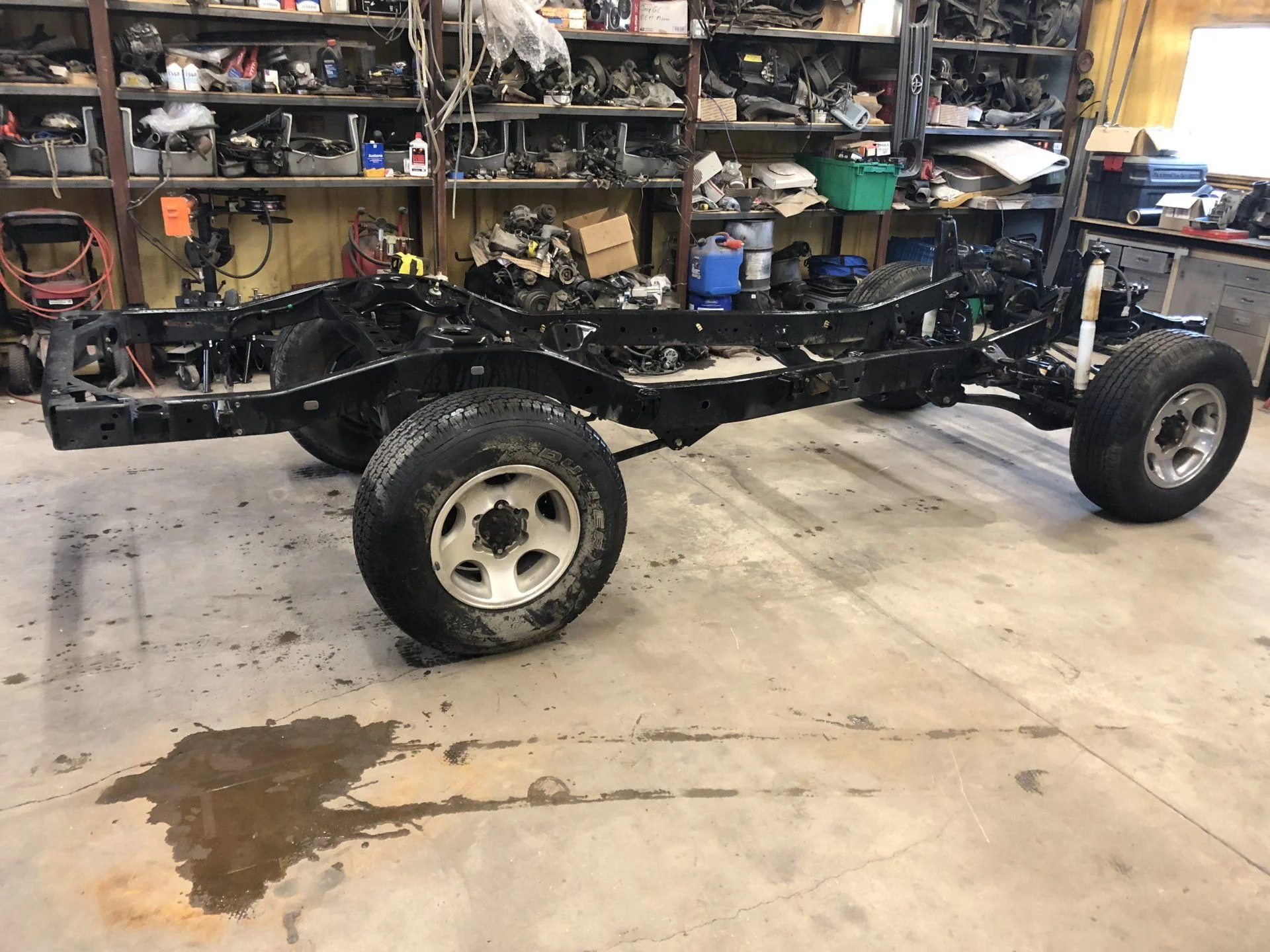

For the past couple of months, Joe has been working on all of the fabrication, and he delivered her as a rolling chassis today.
Time to get to work.

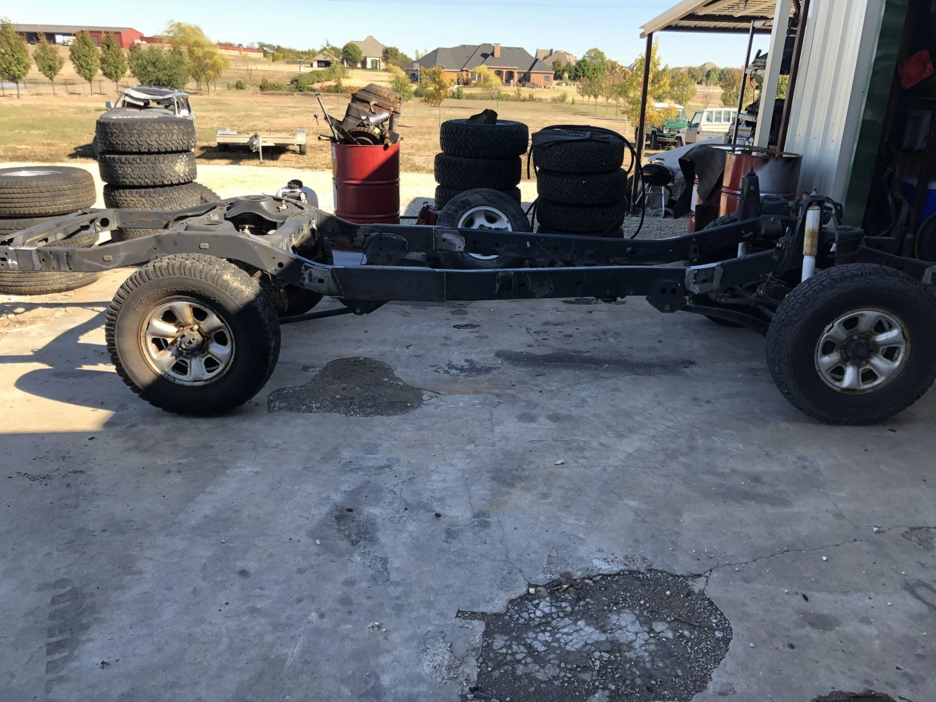

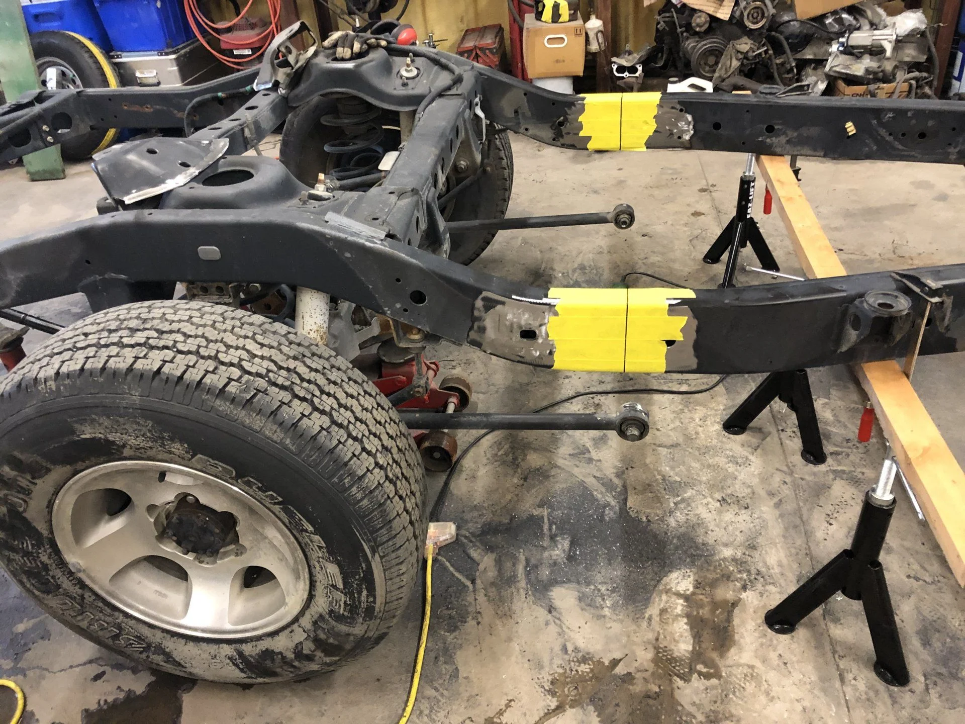

Joe started by prepping the 80 frame, which was really pretty clean.

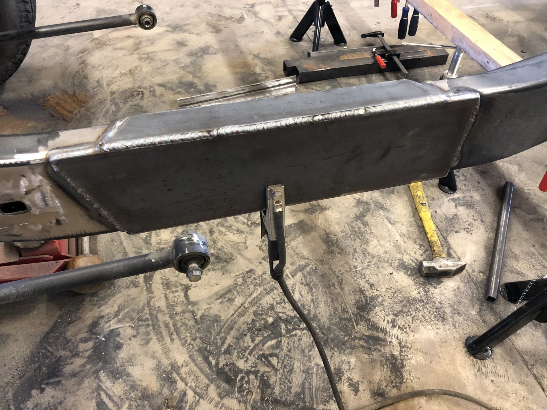

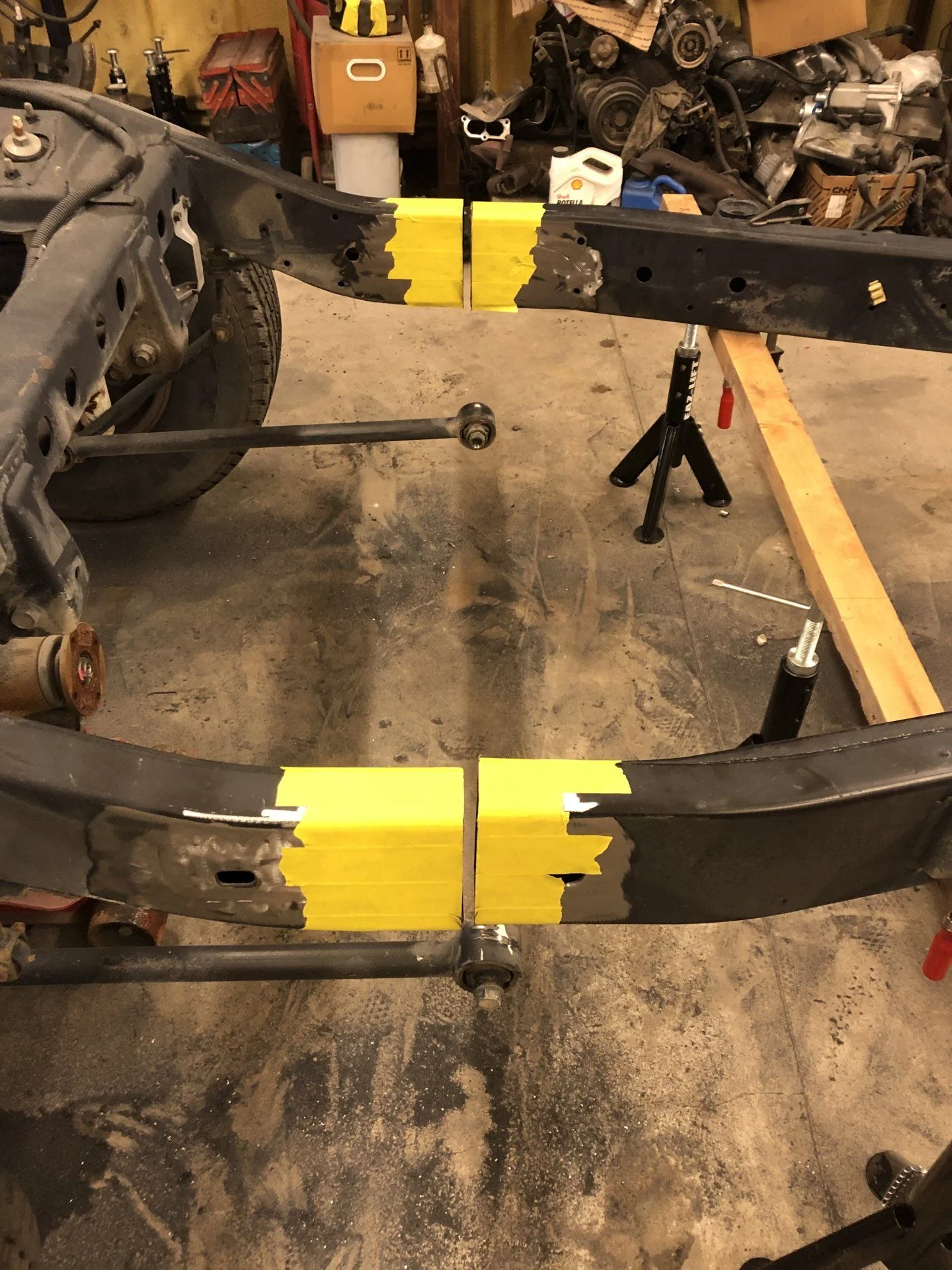

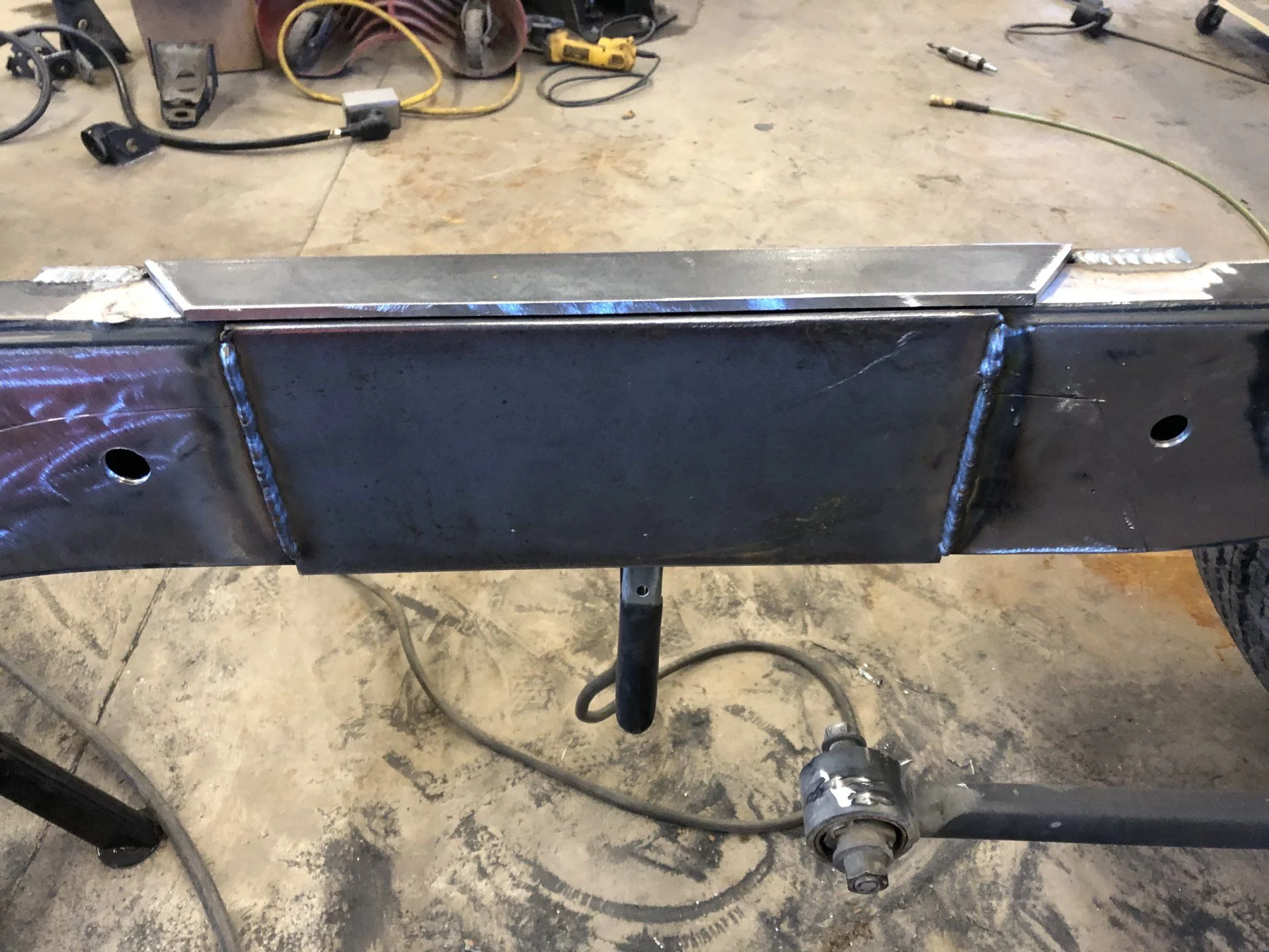

Prepped for the frame stretch just in front of the rear axle, where the control arms mount.
And sawed that sucker in half.

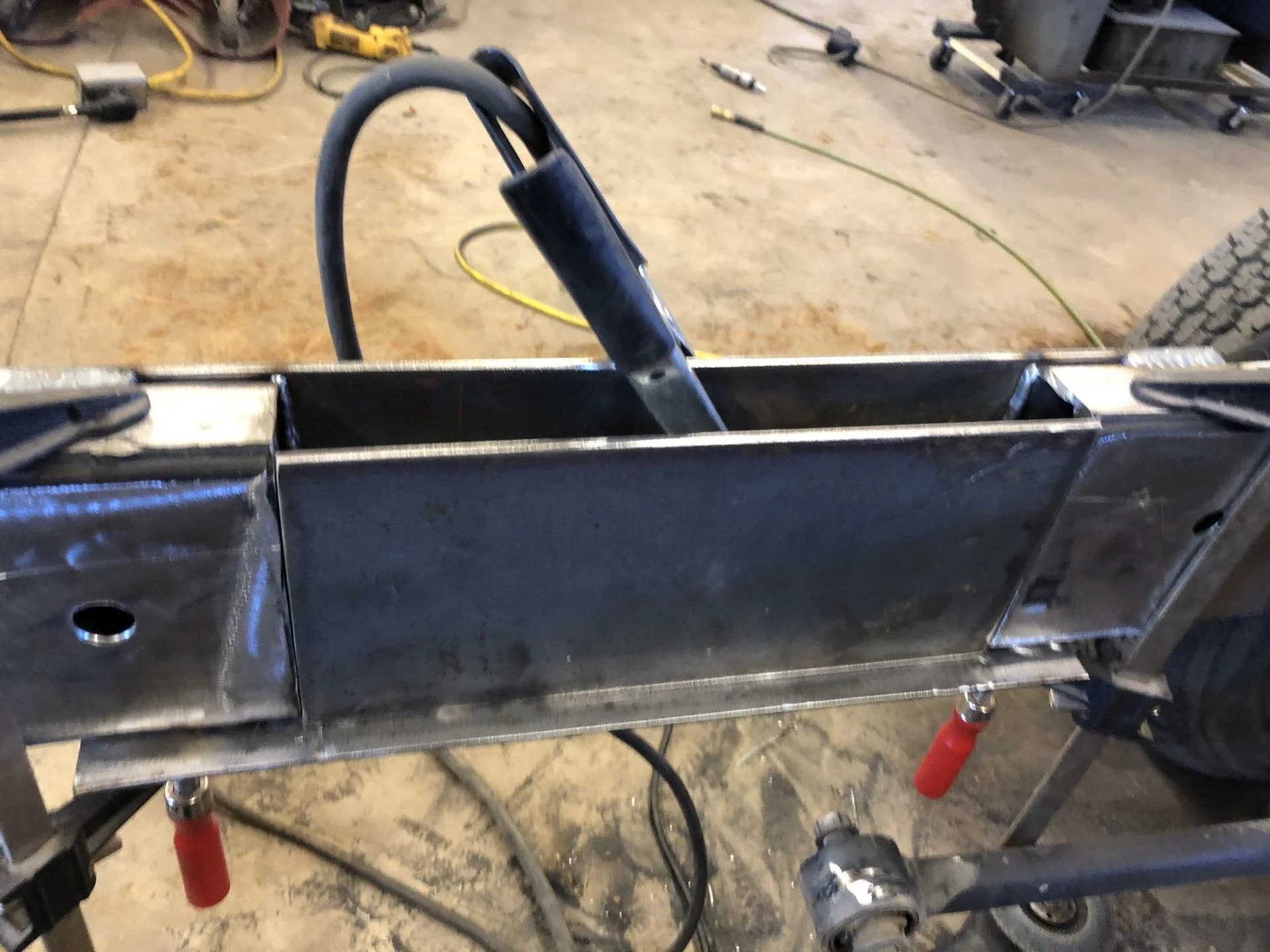

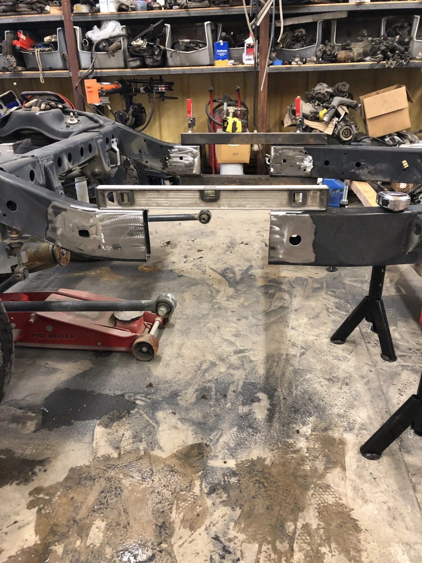

Frame was stretched 13.5”, plated with 8mm steel.
Rolling stretched frame.

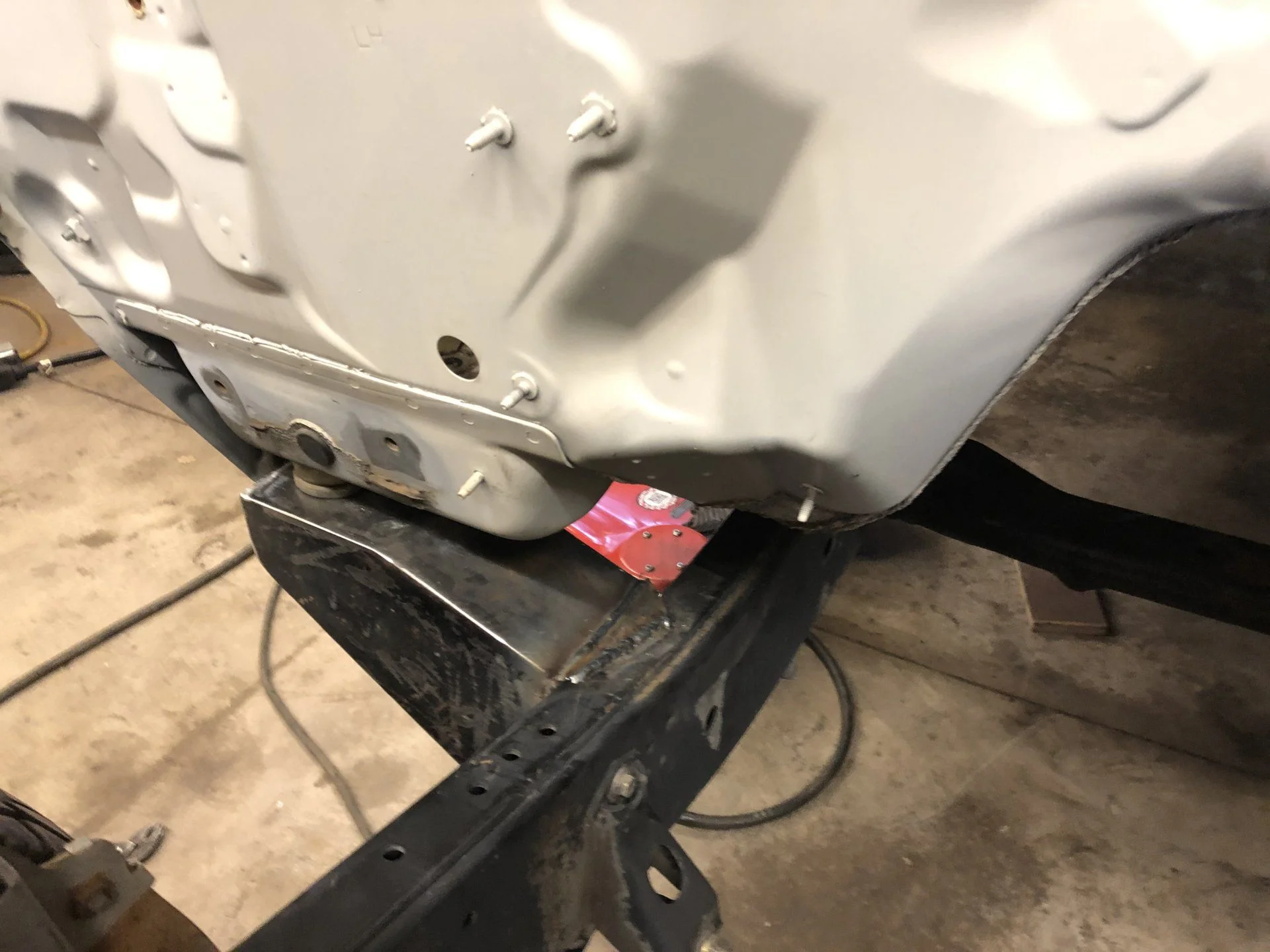

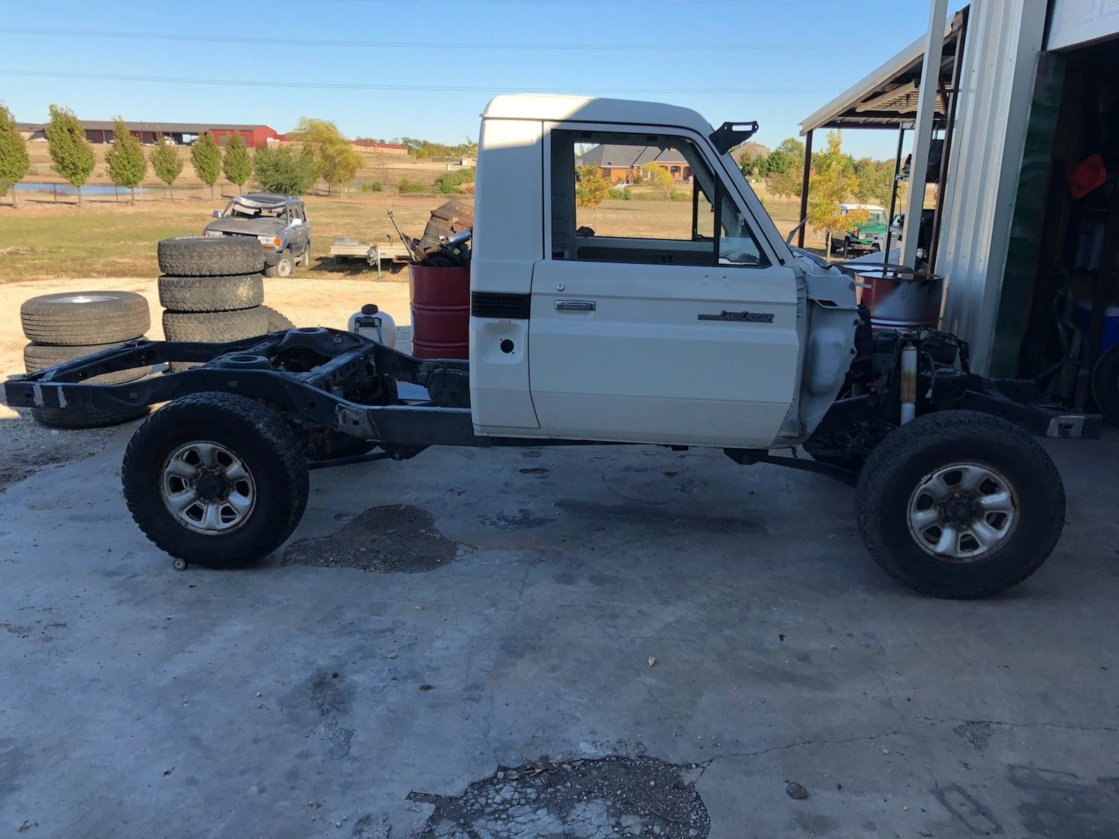

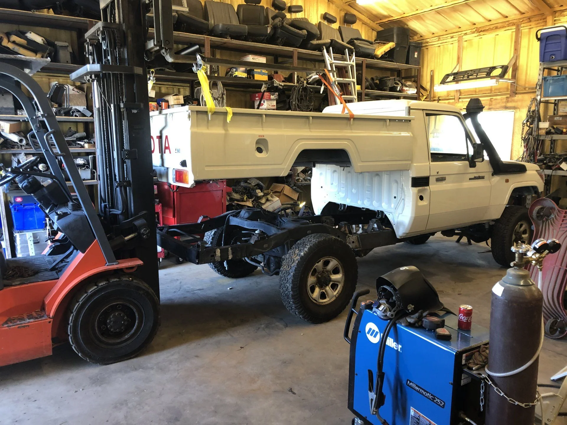

Cab test fit.

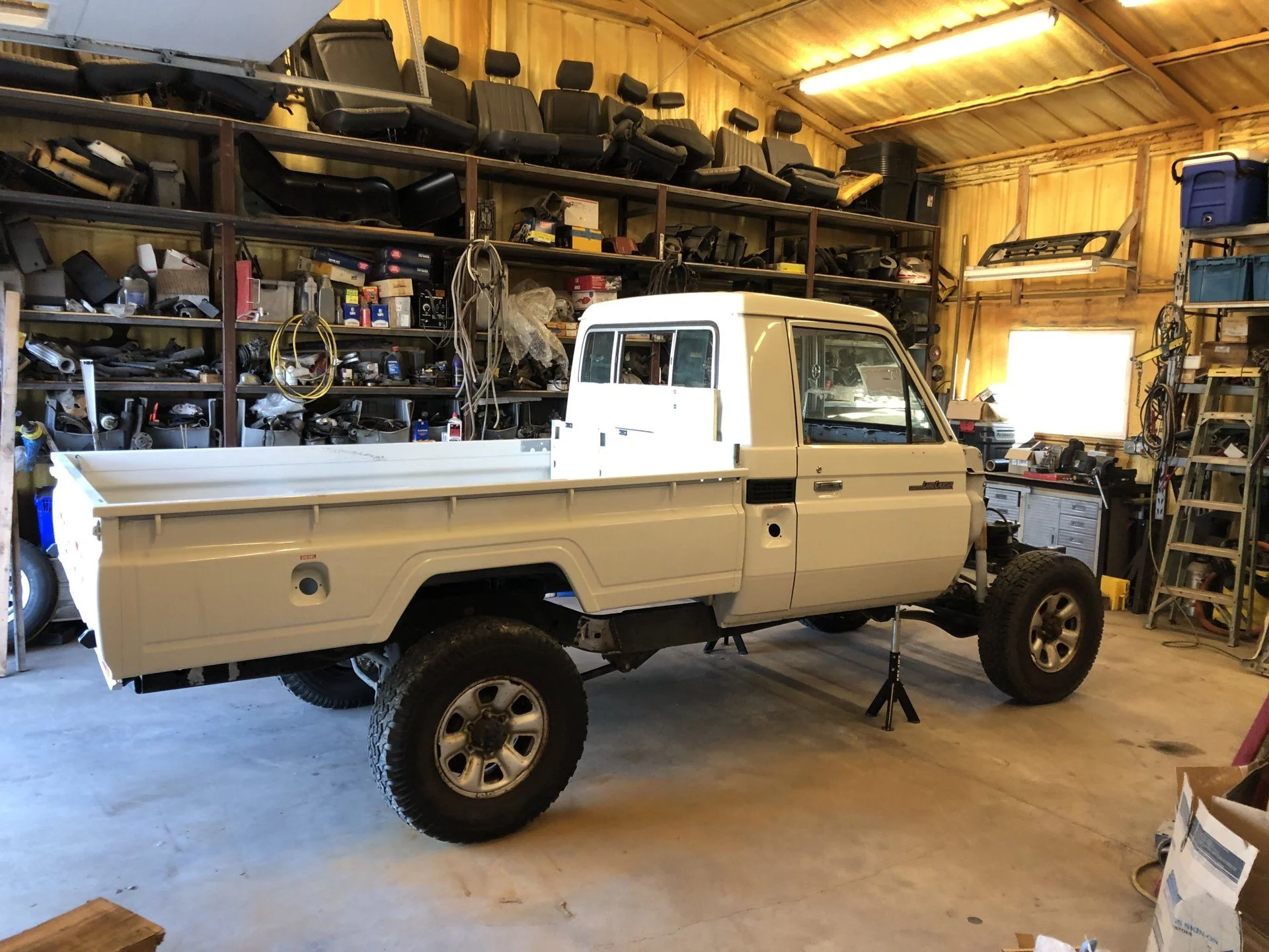

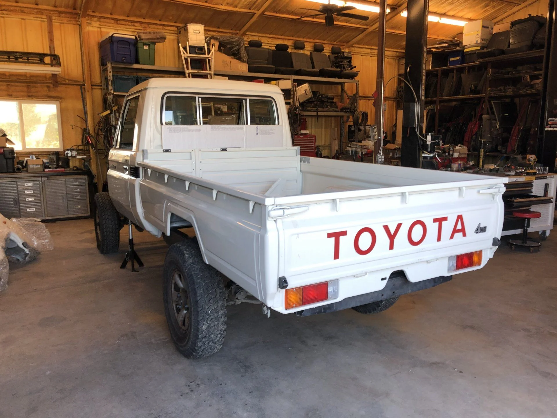

Bed and cab mocked up for the first time. I’m pretty sure I actually started drooling in anticipation when Joe sent me these.

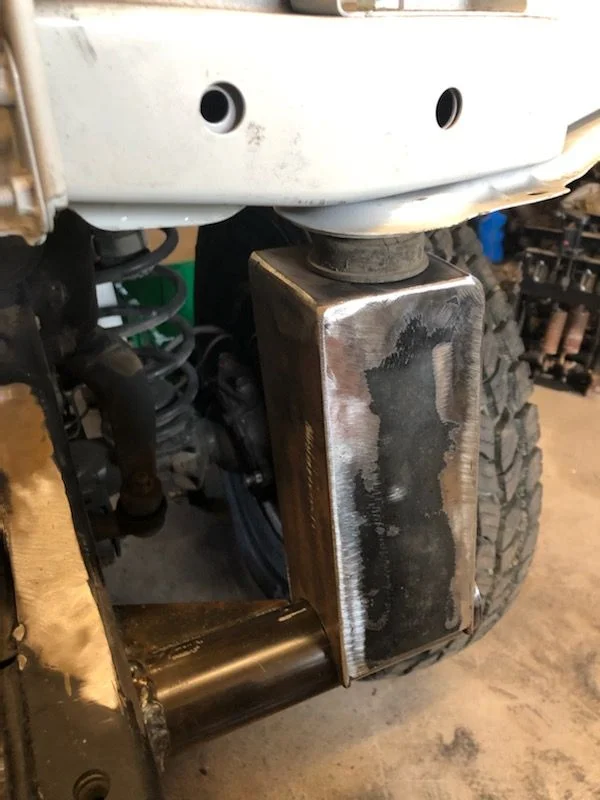

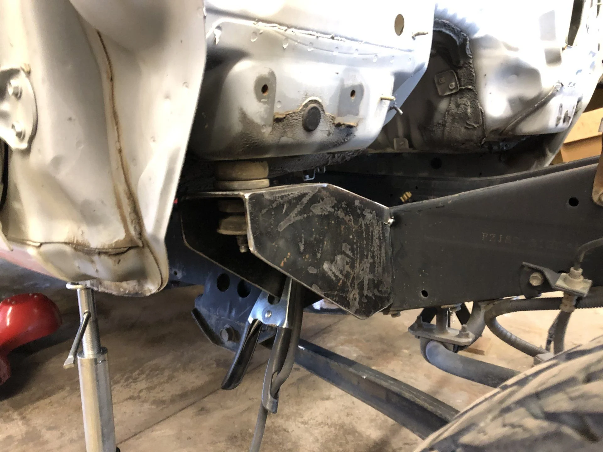

Frame to cab mounts.

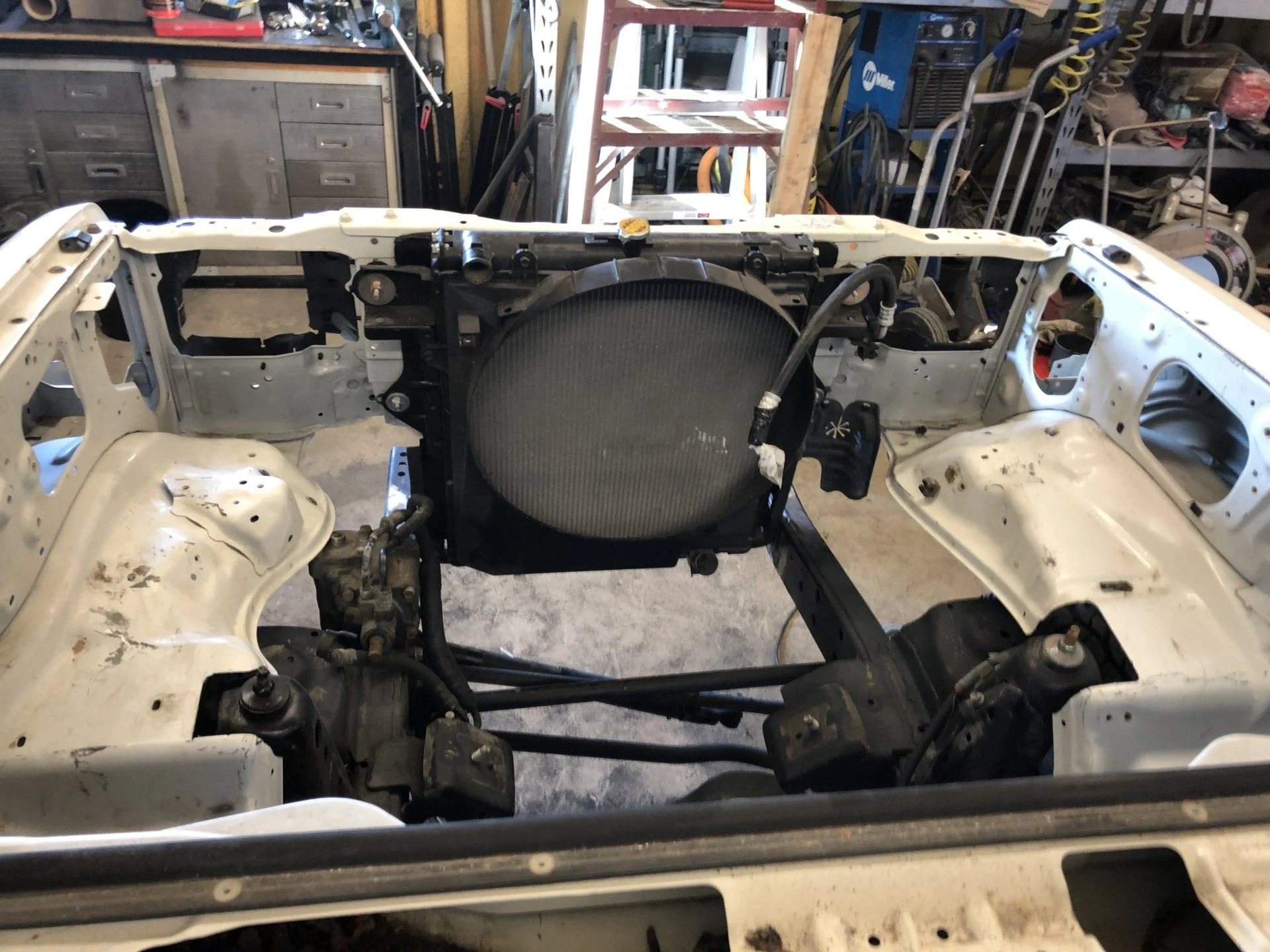

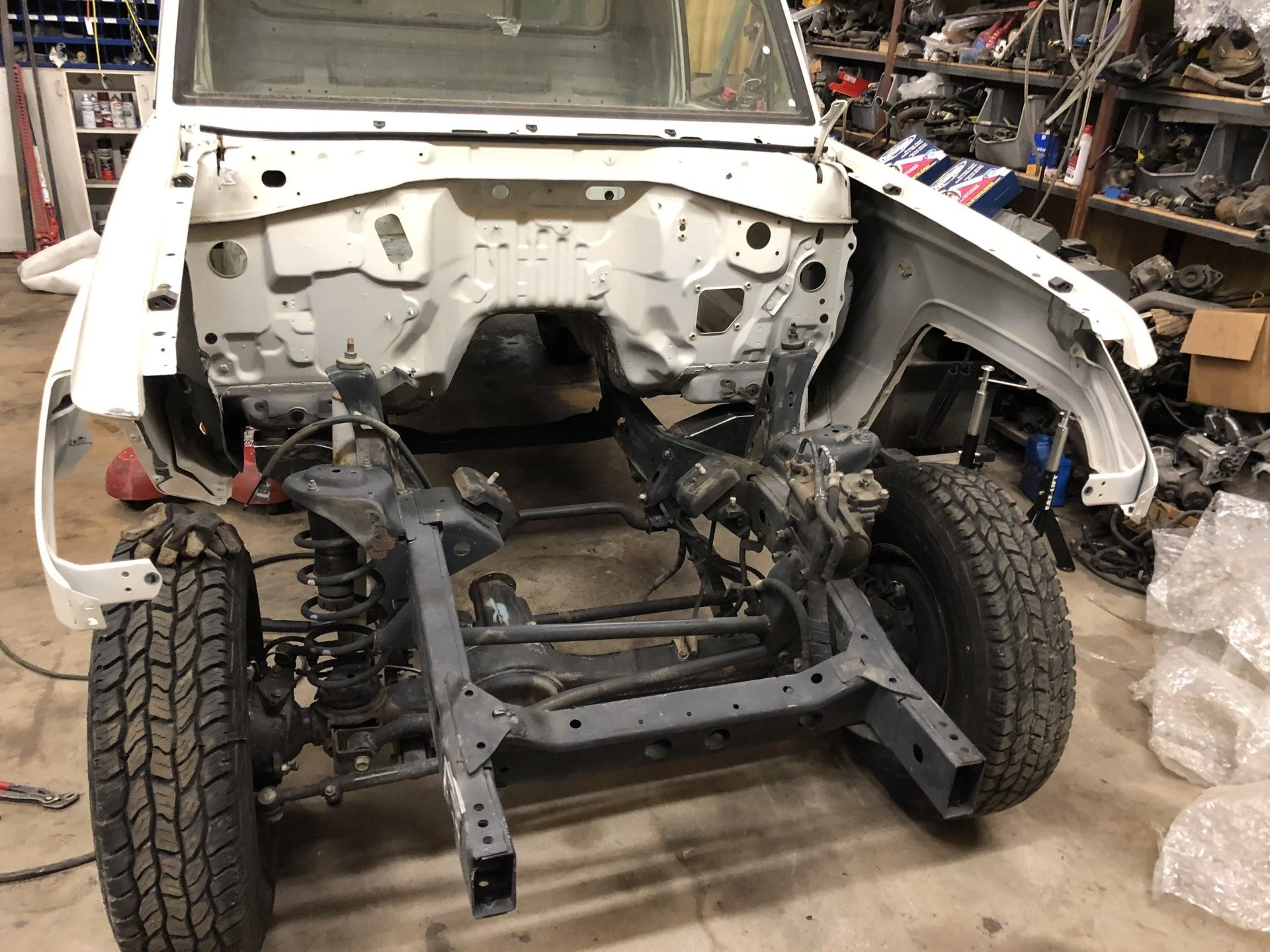

Lining up the front end.

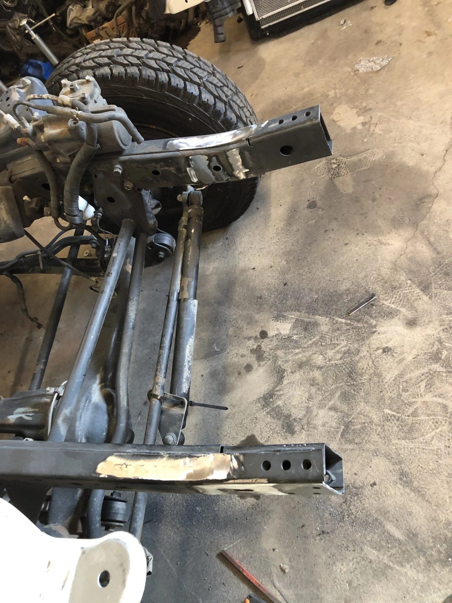

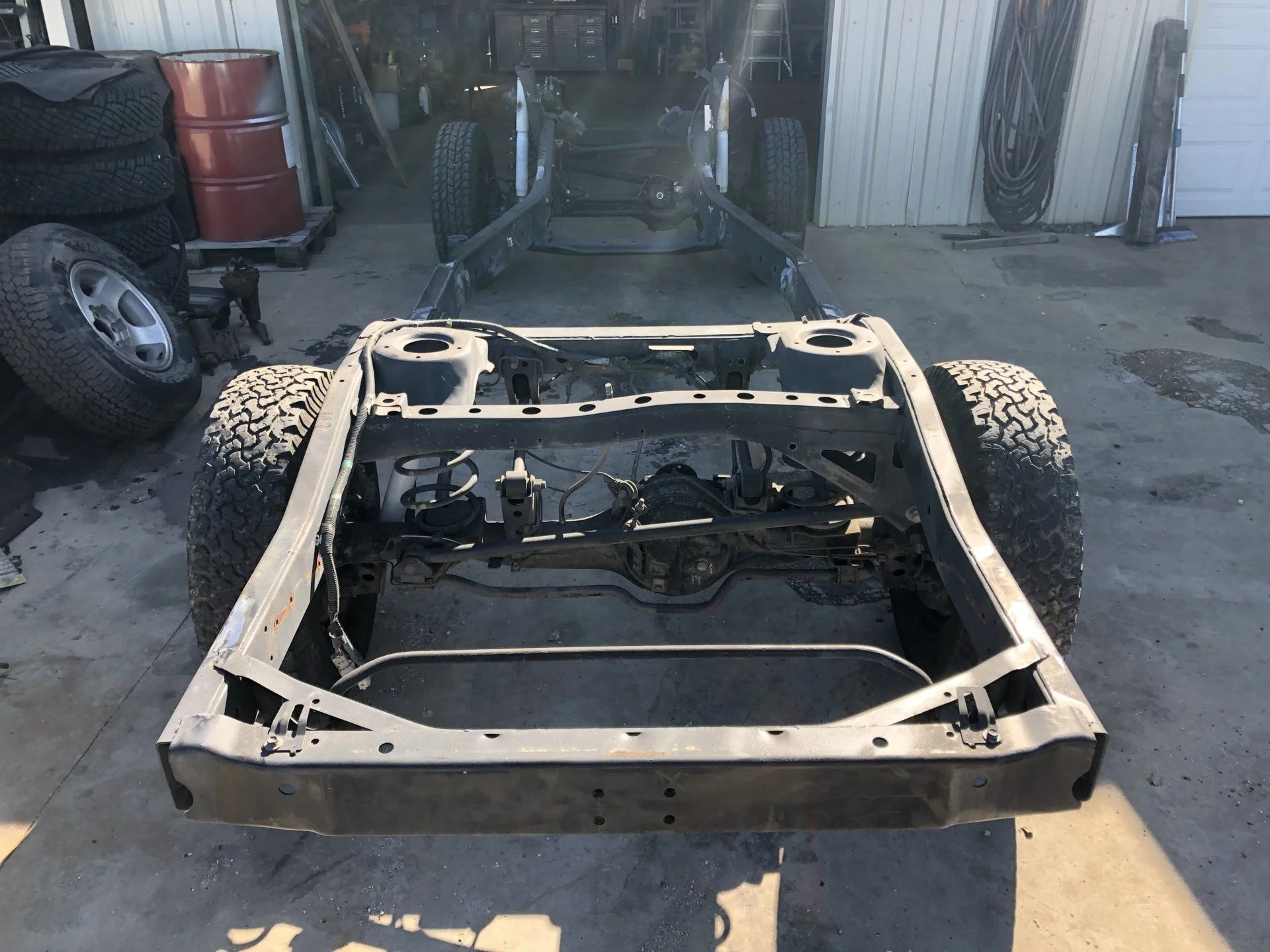

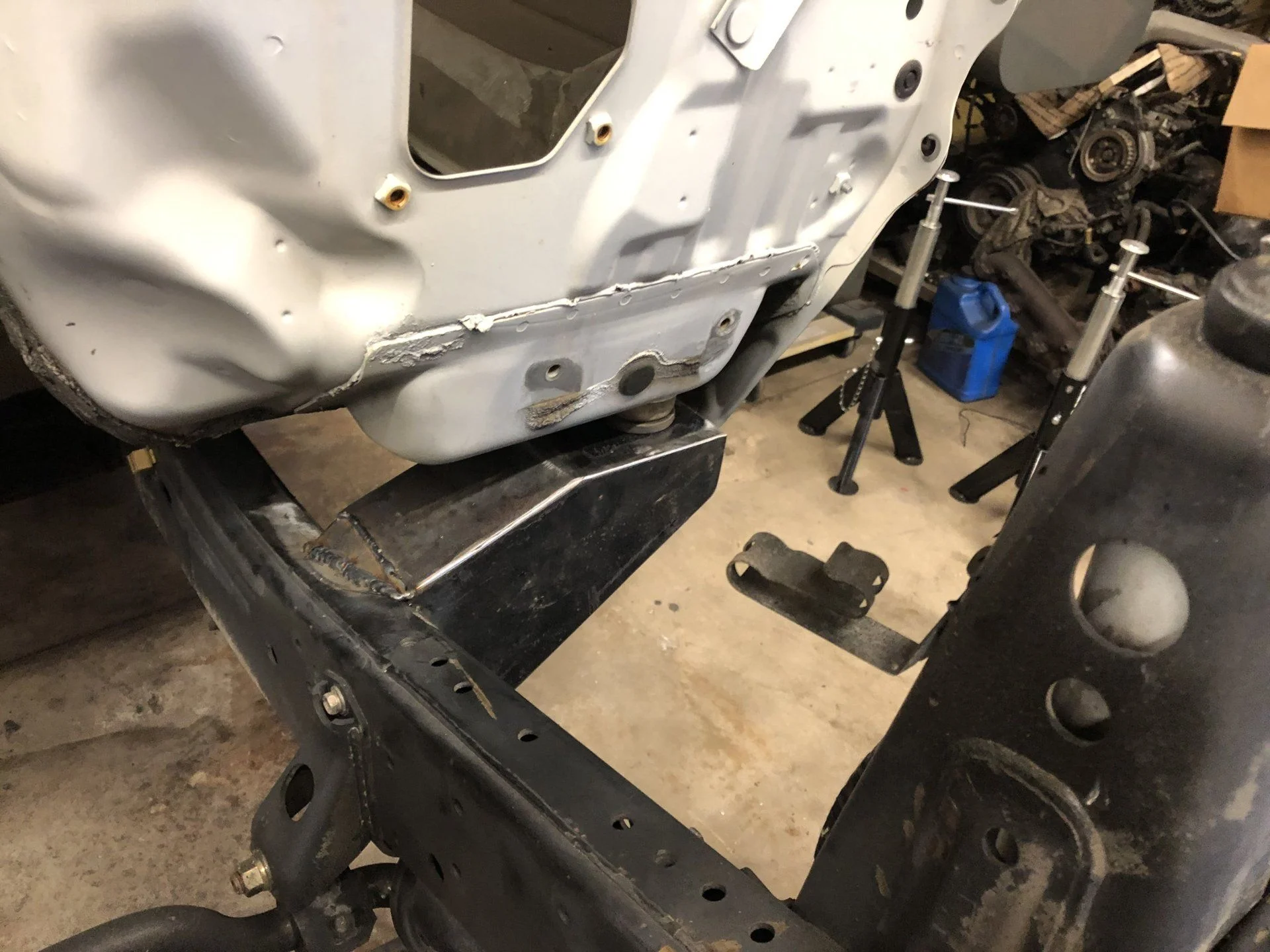

Stock 80 crossmember gotta go.
Clearancing the inner fenders for the shock towers.

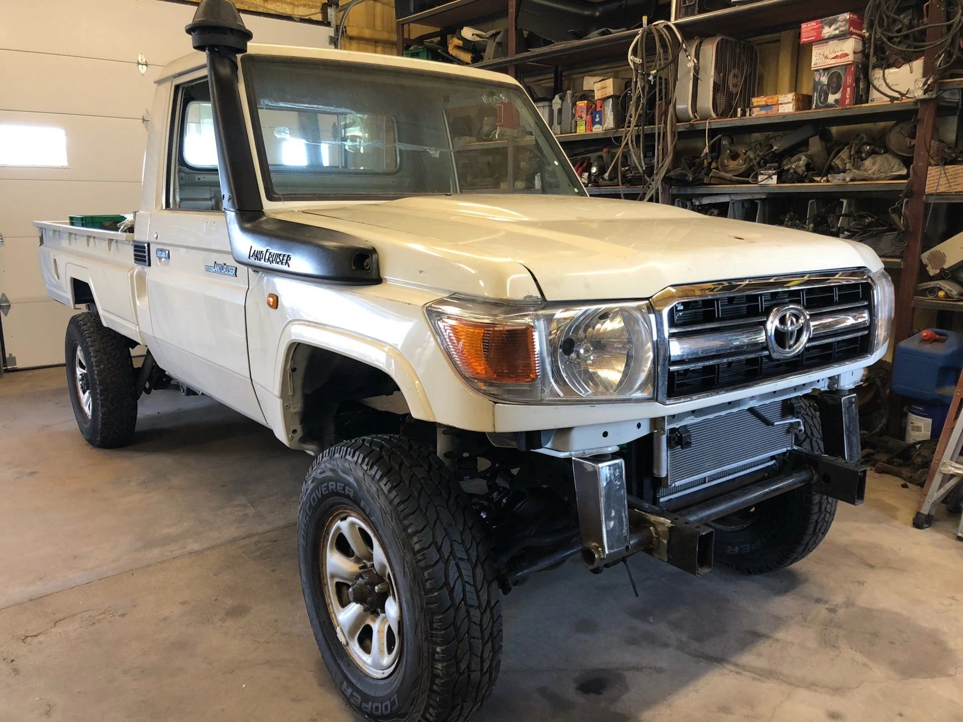

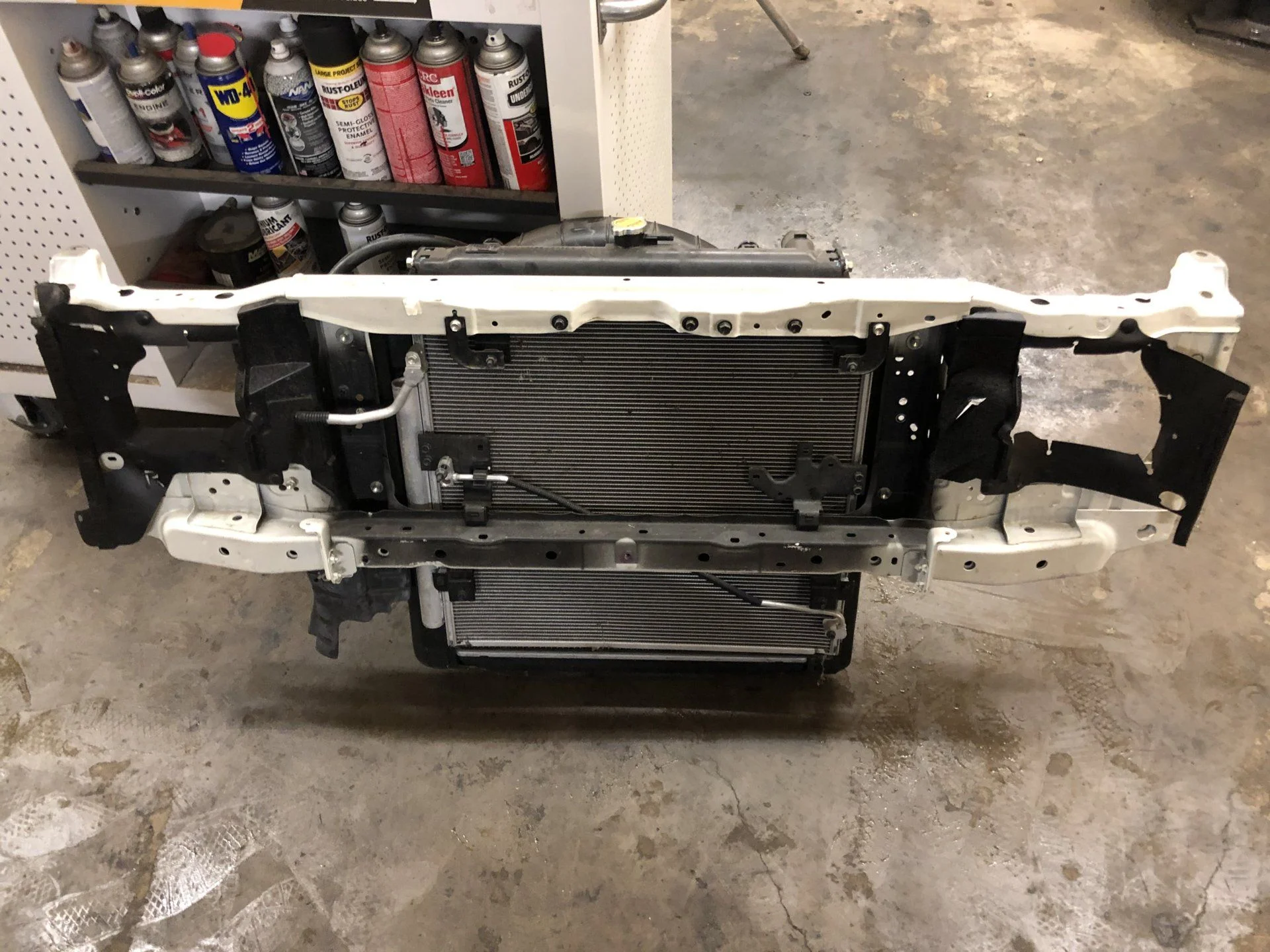

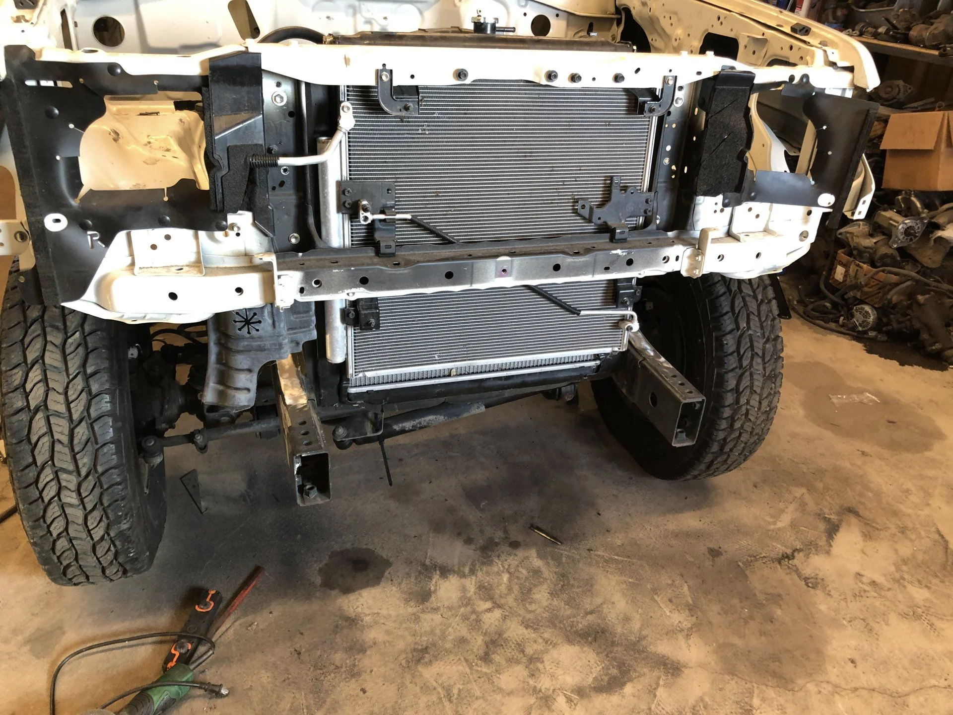

Complete radiator, core support, A/C condenser were next. Bolted up to determine crossmember and fender support placement.

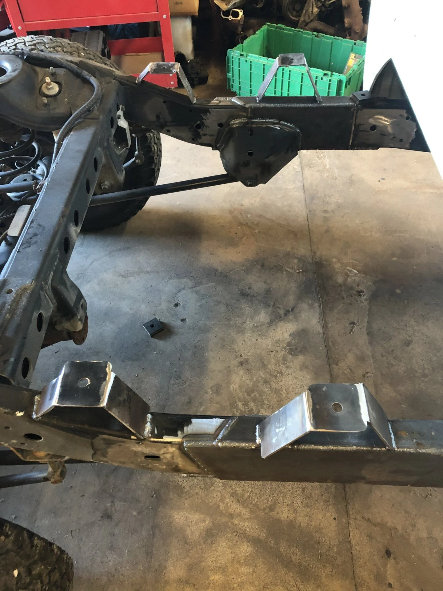

Beefy tubular crossmember - just like a real 70 series! - and front fender mounts.

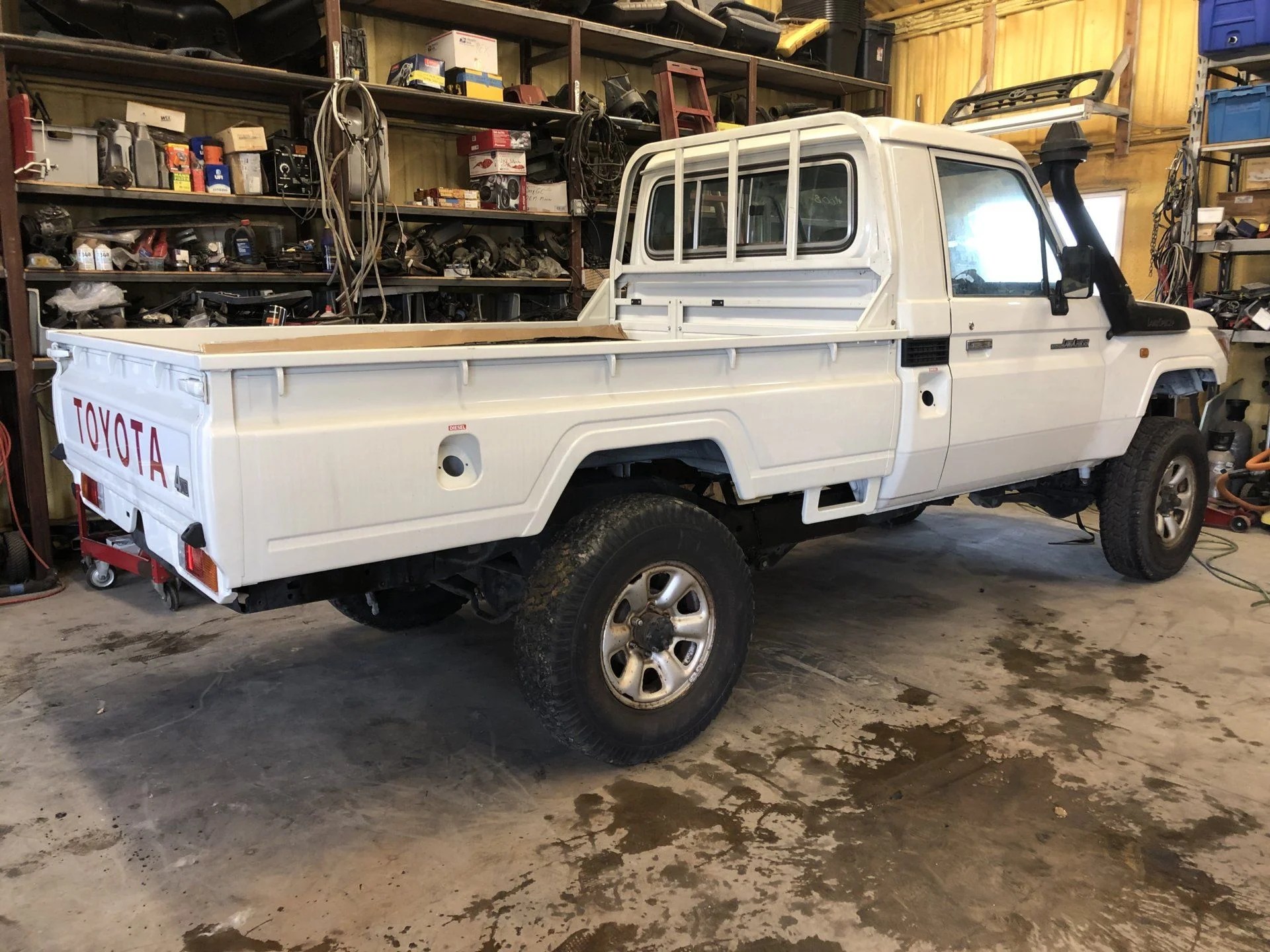

And BOOM it actually looks like a truck.

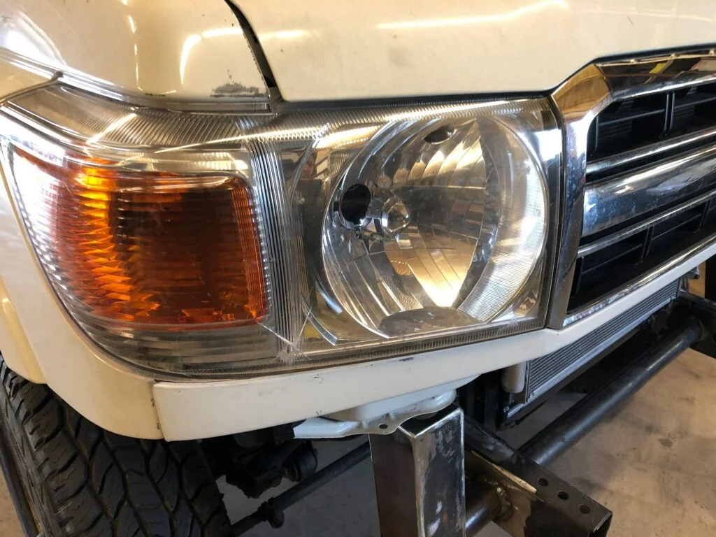

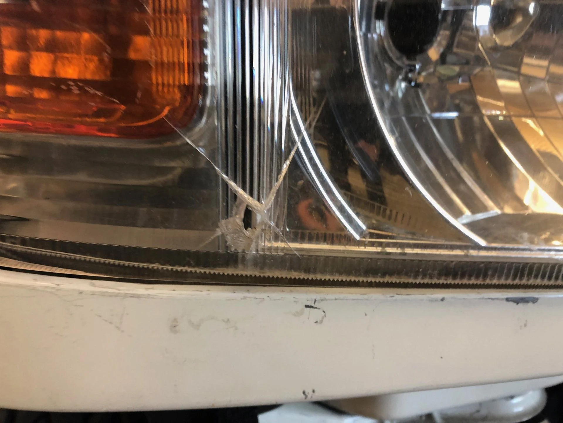

Found a little damage from being shipped all over the place in its previous lives.
Expensive, but available new. One bonus of building a 79 is that Toyota is STILL MAKING THEM. 99% of what I need is out there somewhere, which is really nice. I’m gonna be buying so many parts...

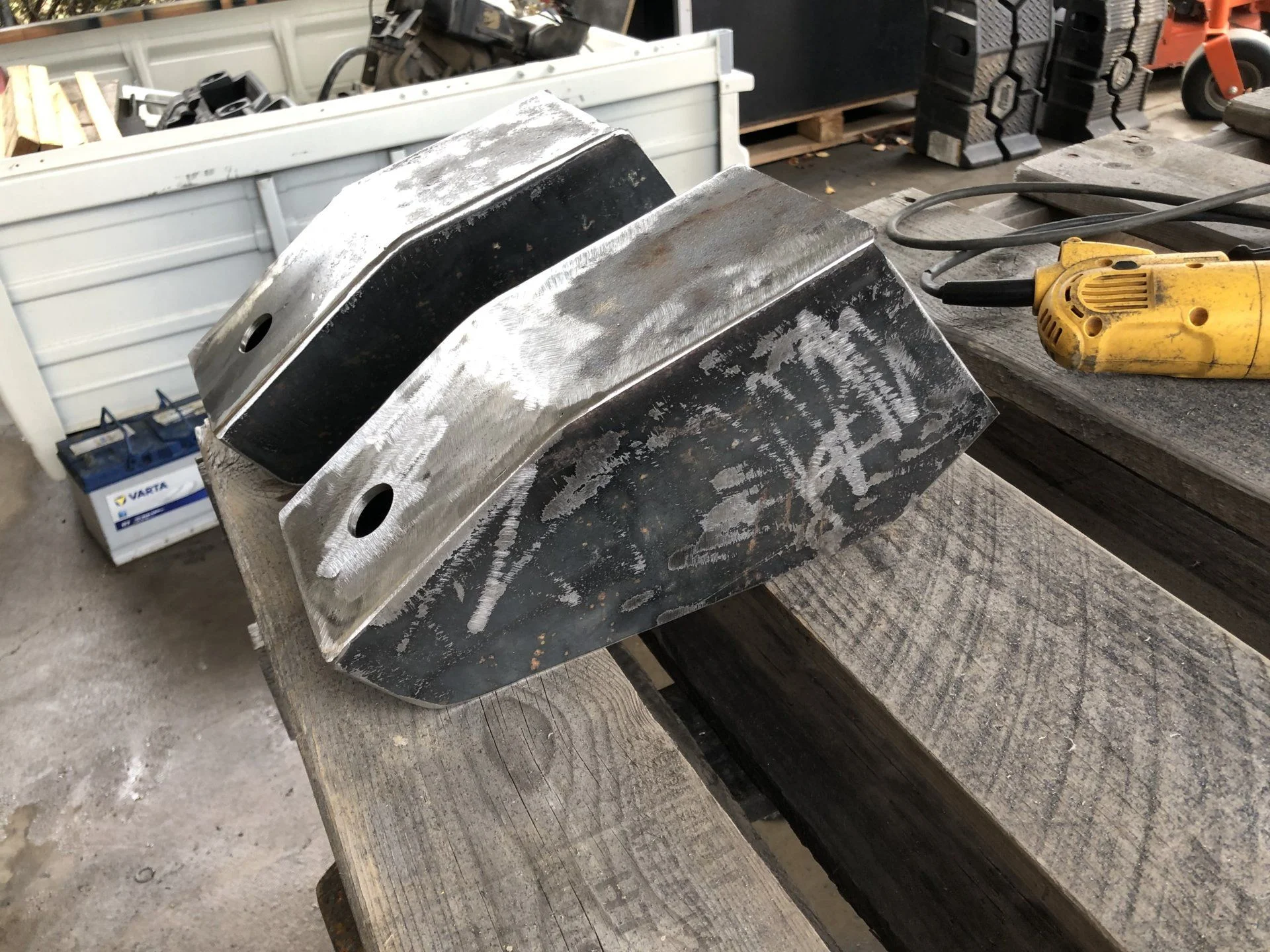

Last major fabrication on Joe’s end: bed to frame mounts.

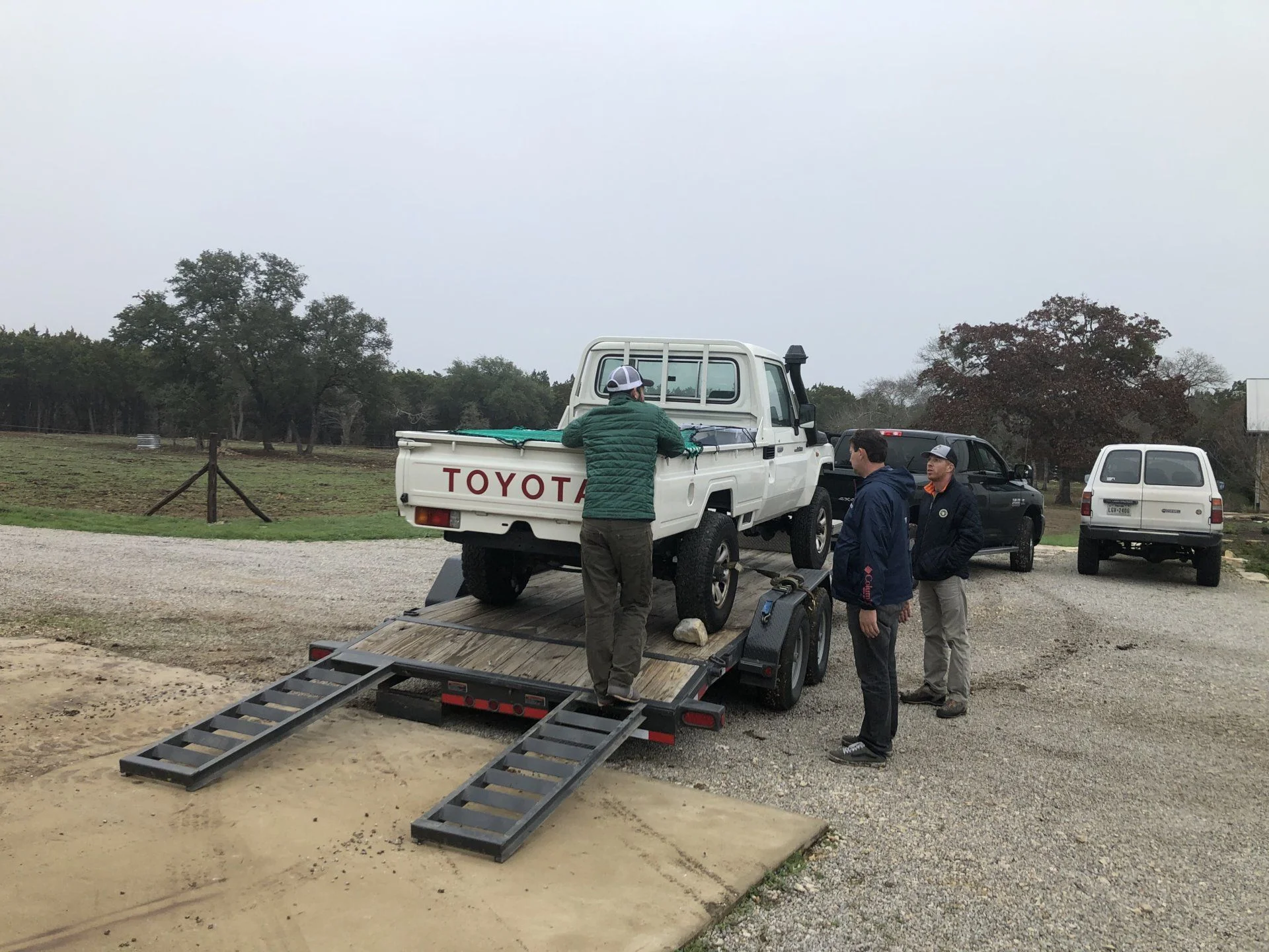

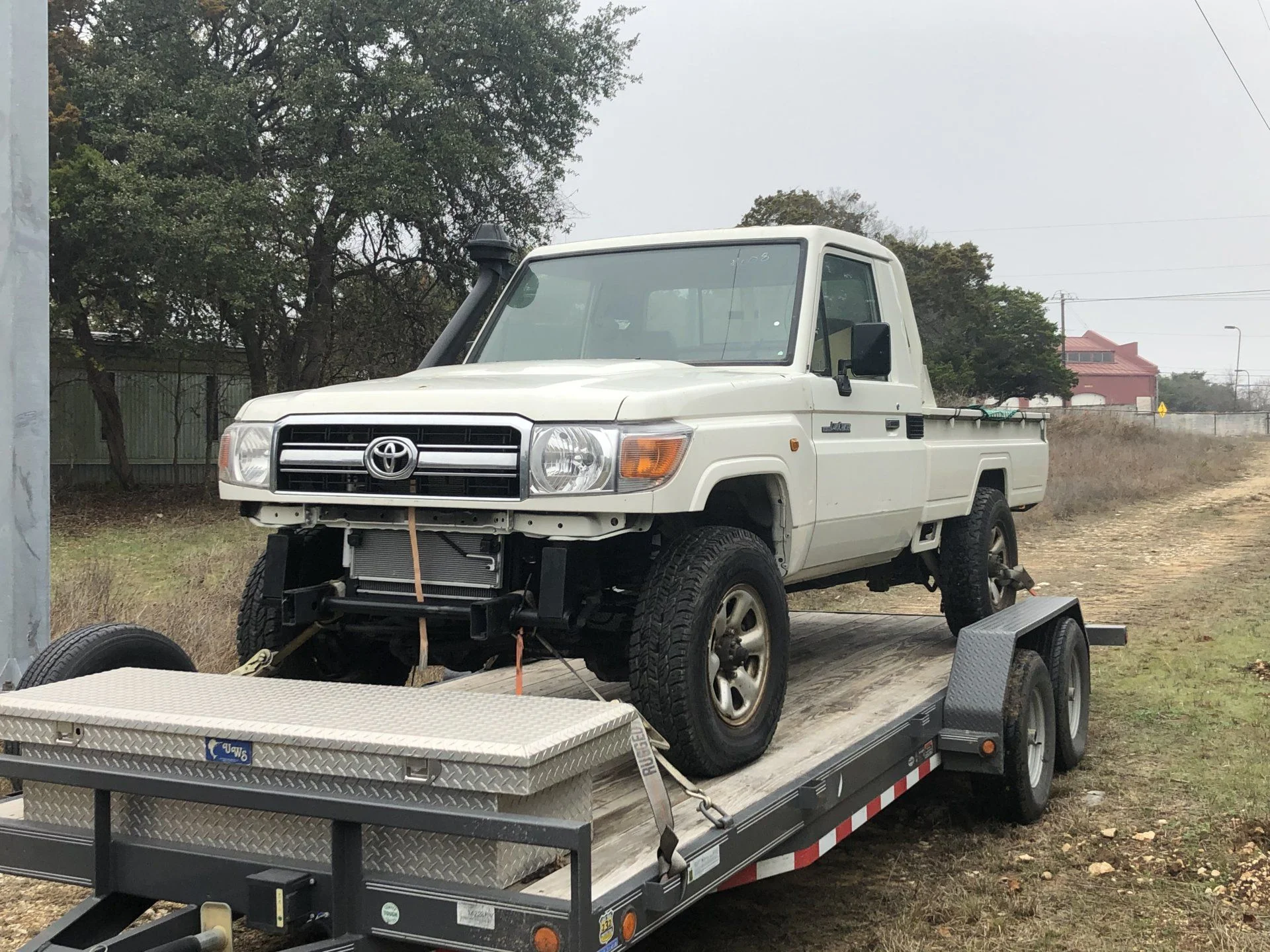

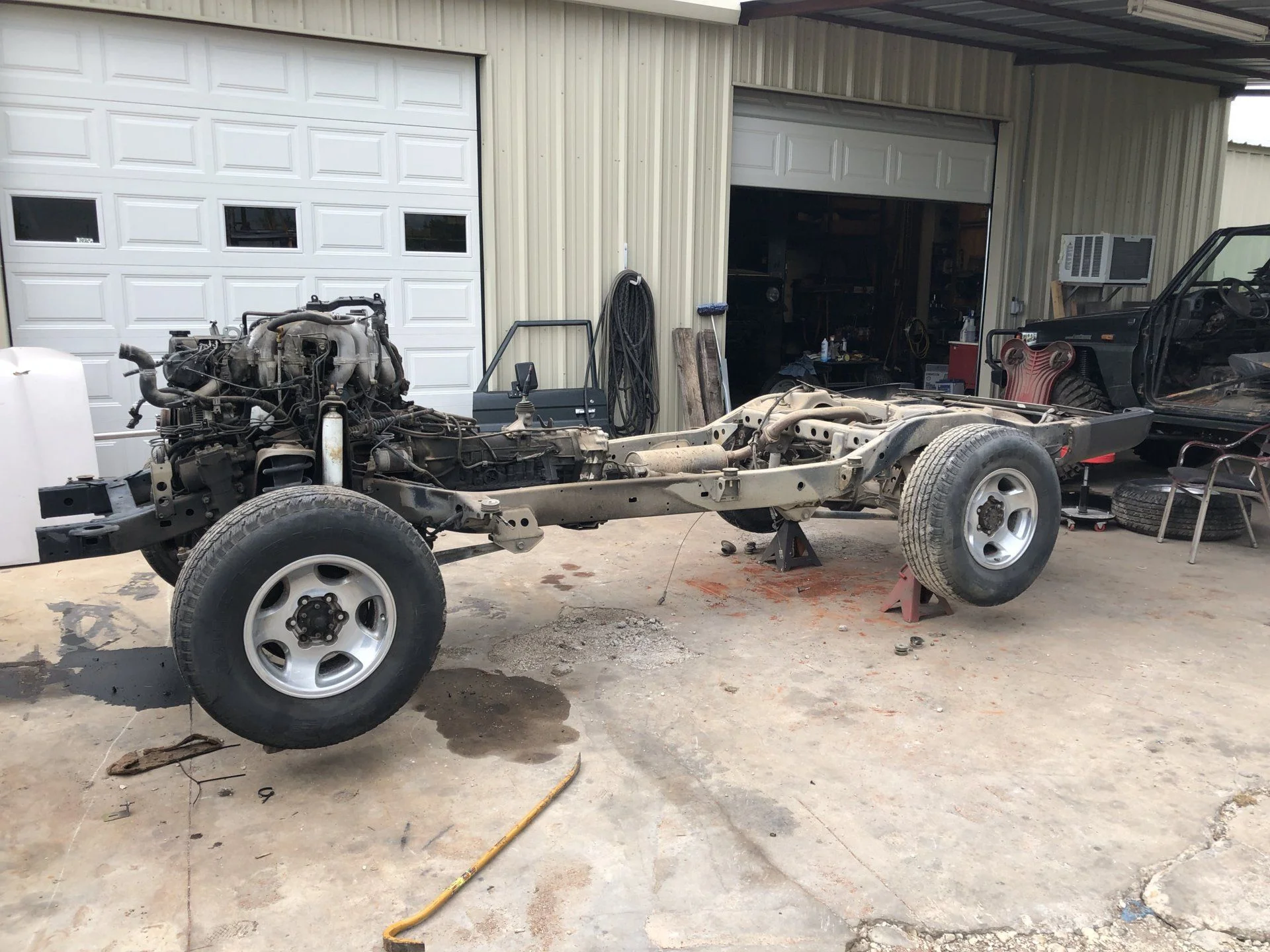

And that brings us up to today. Joe had to run down to San Antonio to pick up another vehicle, so he was kind enough to drop the 79 off at my barn this afternoon.
@Mr Cimarron and @Unoman came over to help. Despite having no steering linkage, and no parking brake, it was surprisingly easy for the four of us to roll the 79 off of the trailer and into a new home just outside the barn.

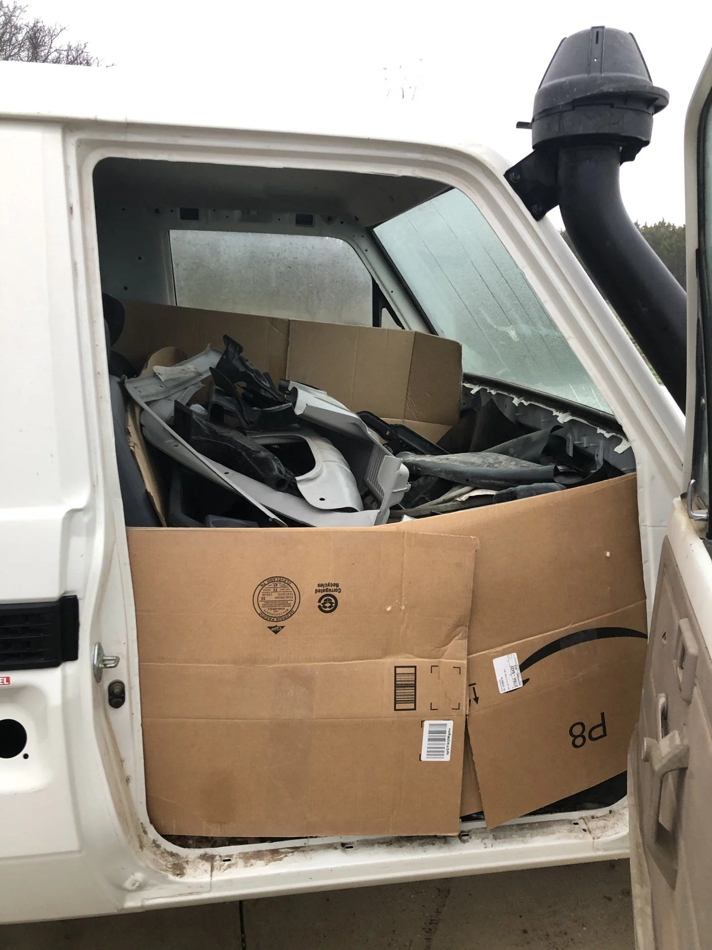

A cab full of cab parts.

1.5" is what we ended up moving the motor back.....the middle hole is what we added to the passenger side mount. The driver's side was way more involved since you have to extend the mount. I'll confirm that 1.5" measurement but I think that's the number.
