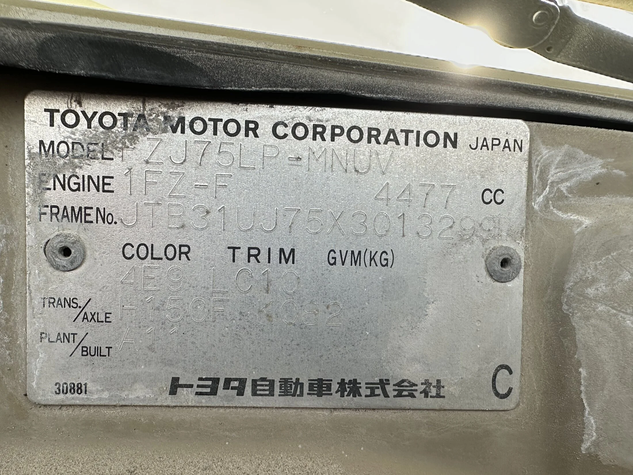

Thanks Juan! I got some pictures of the engine and VIN tag, attached. Believe it is a 1FZ from 1999. I’m hoping to crawl underneath it and take it for a drive next week.
It is an LX and a '99 model. Normally there is a another VIN plate on the driver's door jamb showing month and date of fabrication in English and Arabic.
Hello,
As mentioned above, it is a late model 75 Series pickup. LX grade, GCC spec.
This truck's 1FZ engine has a carburetor and the late model charcoal canister, which is a good thing.
The battery holder is missing and it appears to have been replaced with an iron bar sometime in the past. Chances are the whole battery tray is either gone or on its way out, and needs replacement.
Battery terminals look factory. Check the fusible links for hacks.
The washer bottle cap is missing. Windshield washers' tubing runs below the battery. Check it for damages.
There is no emissions control equipment. Depending on where in the US this truck is going, this may be a concern. However, a good carburetor mechanic can help you with proper tuning to meet emissions requirements.
The pressure valve on the air filter housing may need some attention.
The transmission should click when you shift gears. If it does, it is in good health. Otherwise, it may need fresh oil or an overhaul.
Juan
