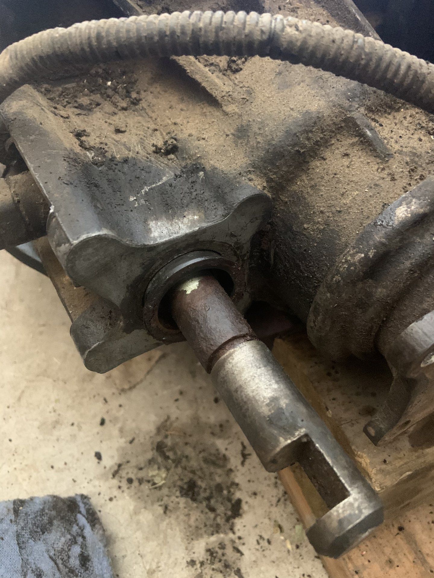

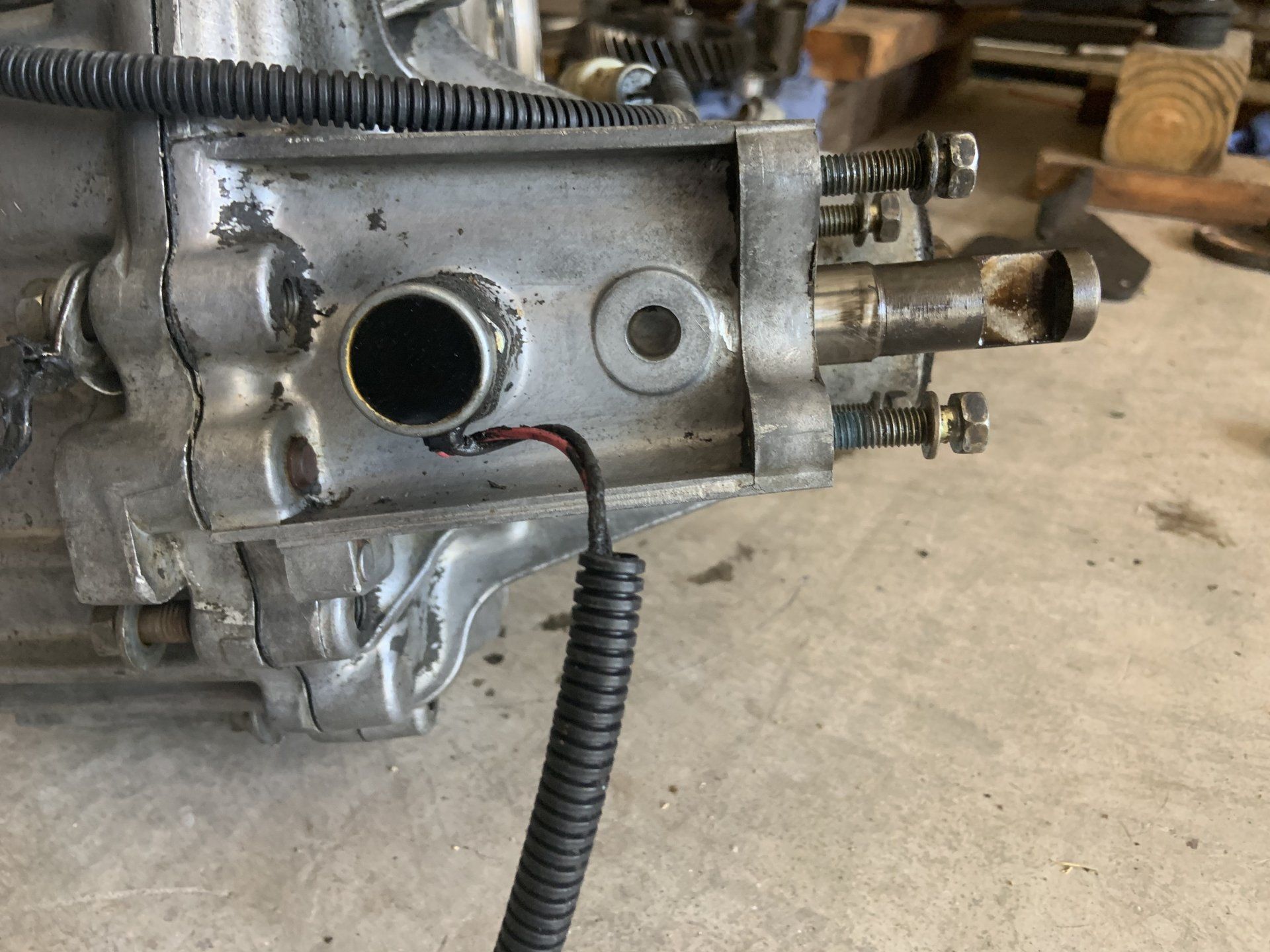

I hope so! Cruiser cases are pretty simple, so that’s nice. I am finding out some more differences between the 34mm and 38mm split cases. The first noticeable difference being between the 34mm manual front output engagement and the 38mm vacuum engagement. The 34 has a threaded boss with a plug which houses the detent spring, the 38 has the boss, but it’s blank without threads. The bore for the fork shaft has oil grooves along the top and bottom to provide lube to the vacuum unit on the 38. The 34 does not.
The outer bore diameter is the same, so the seals and shaft boot could interchange. Not sure if the grooves would need filled or if the seal would adequately keep the oil in.

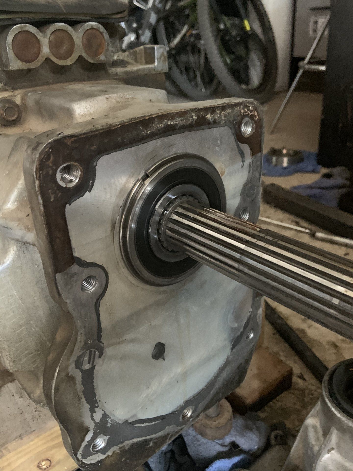

Came across a snag. The machining on the input side of the case for the bearing clearance is different. The 38mm input is smaller. The snap-ring retaining the output bearing on the adapter interferes and won’t let the t-case mating surface sit flush.

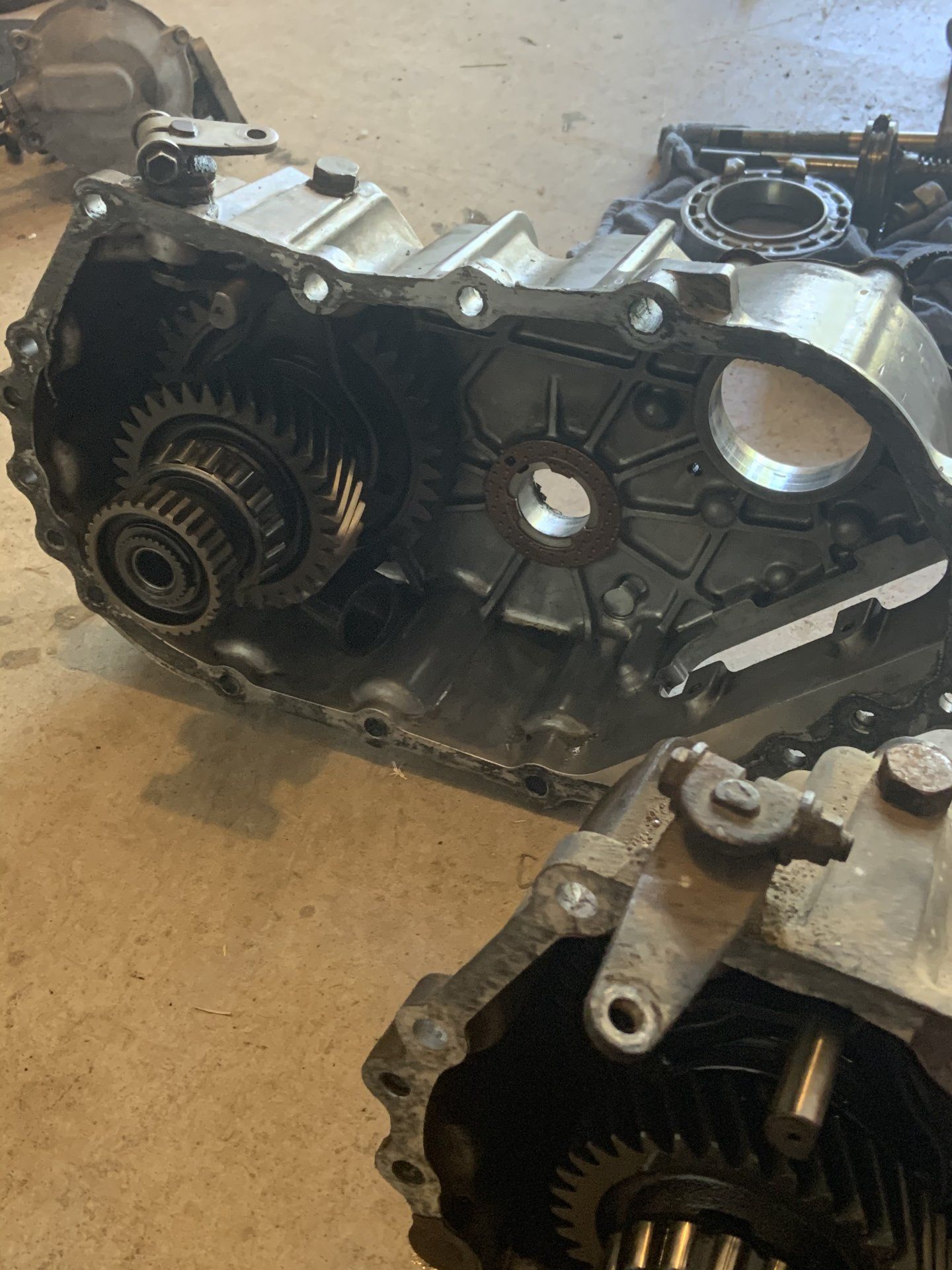

So, anyways, here’s some more tech.
The front output selector shafts are actually the same length, it’s just that the forks are oriented differently and some different machining done at the ends.
The High-Low selector shafts are oriented differently as well.
The high range gear set on the 38 is larger. Haven’t counted teeth yet to verify gear ratios.
