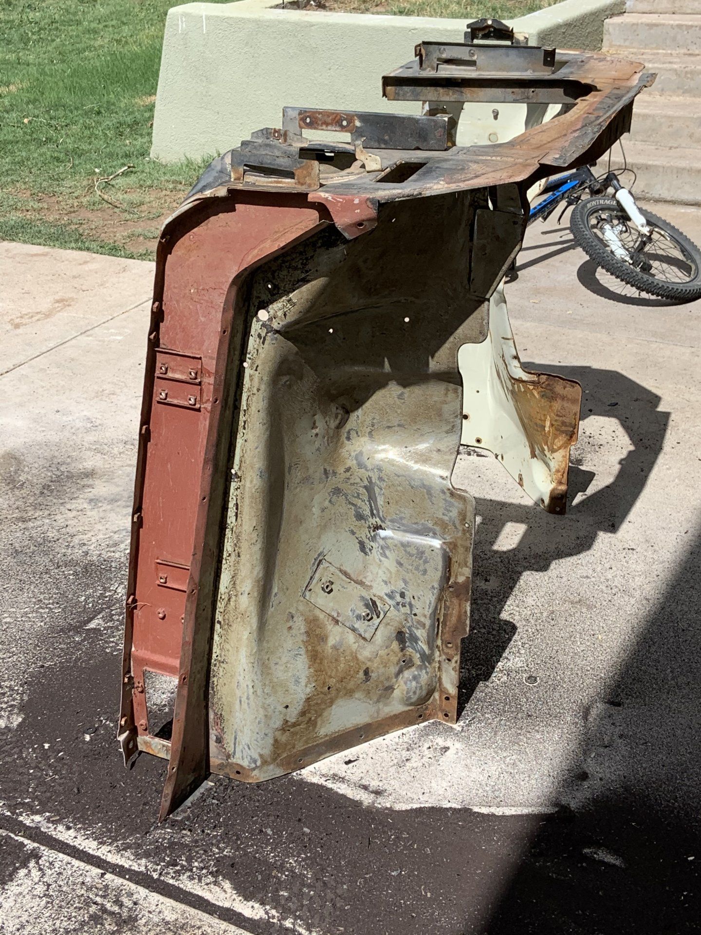

On the inner fender too?
Oops, no I made a plate and rubber gasket for that. I'm not sure why now, if it for a reason or just an after thought.
Probably an after thought and I know I wanted it blocked for the cold air intake to motor. I didn't want hot air going down the inner fender to the air cleaner.

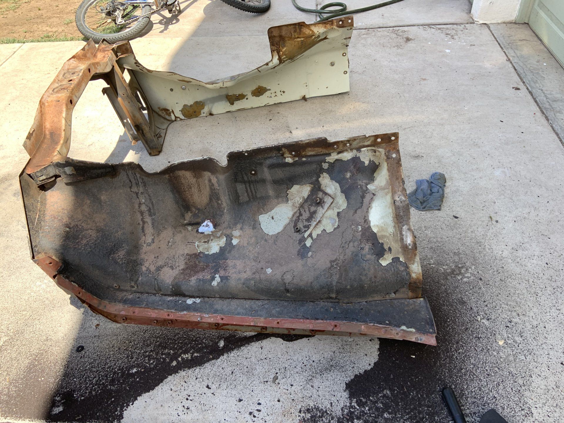

Stripped the undercoating.

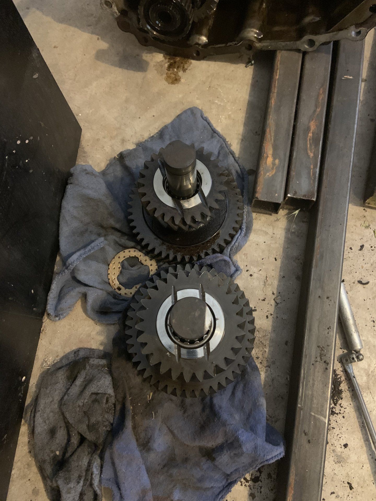

I have a 34mm case.
I also run the Marks over/under gears, Marks only uses the 34mm shaft and gives a bushing for the 38mm case.
Learnt something new today! I never knew they ran a bushing for 38mm...
So, anyways, here’s some more tech.
The front output selector shafts are actually the same length, it’s just that the forks are oriented differently and some different machining done at the ends.
The High-Low selector shafts are oriented differently as well.
The high range gear set on the 38 is larger. Haven’t counted teeth yet to verify gear ratios.
High range should be 1:1 for either case, eh?

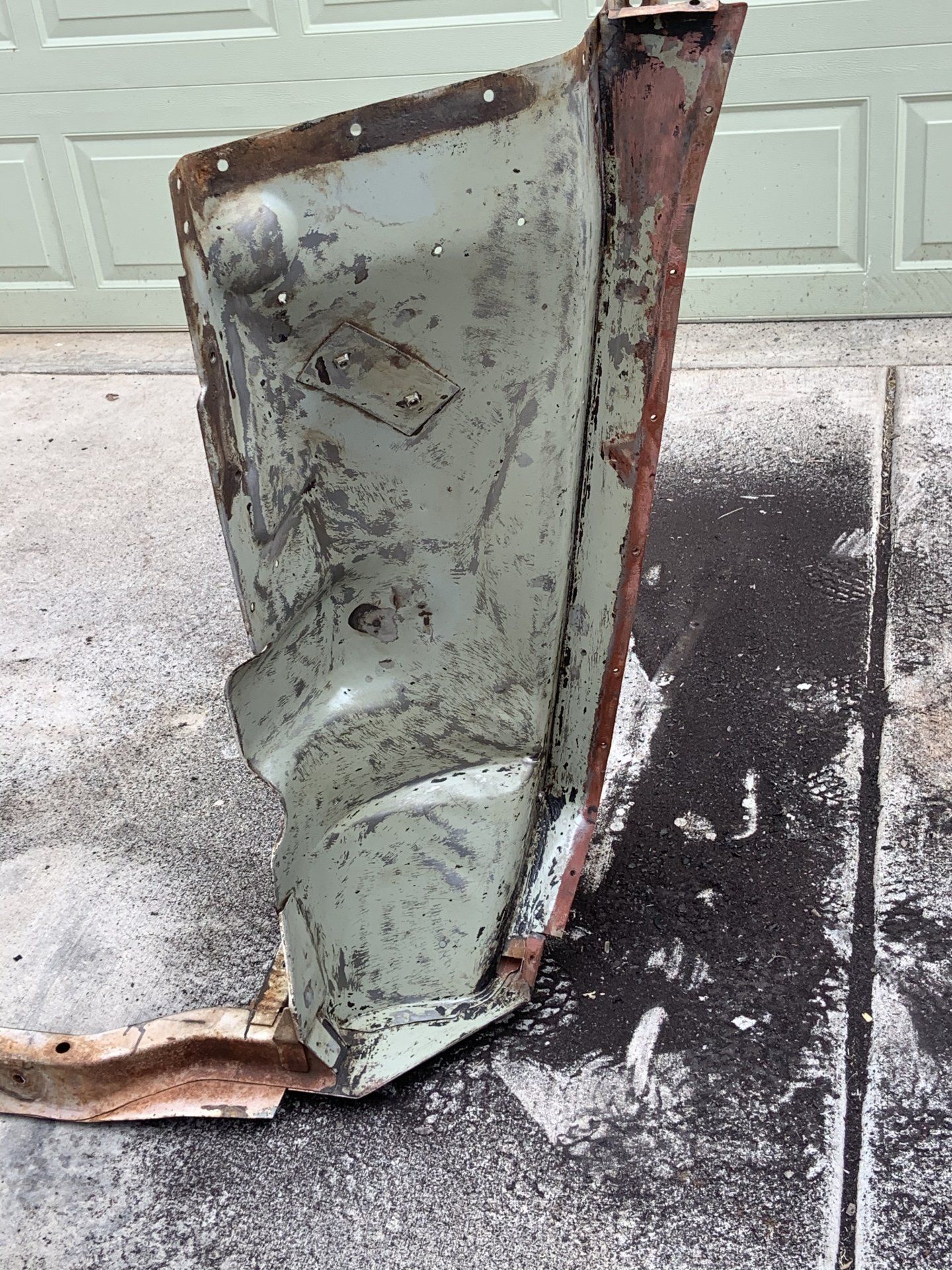

The undercoating still needs stripped off of the underside of the inner and outer fenders. While I had them out, decided to try to clean the stubborn buildup of dirt that has stained the sides of the inner fenders with vinegar. This seems to be another thing a lot of Cruisers have in common from years of driving around on dirt roads and such. The silicas like to bond themselves to the paint and resist the normal auto store cleaning products.
This was more of a trial for other guys to see, as all this on mine will be painted over anyways.
So yeah, vinegar and and a green scrubby. And elbow grease.
That would be pretty cool to make the engine compartment all purty...
On the inner fender too? I knew you filled the firewall hole, just don’t remember about the inner fender. I guess it would make sense for you to fill it unless there was something else to utilize it for🤔
Can't believe I haven't been in here reading for a month!
July has kept me hopping - can't wait to see what you have been up to!
Good morning TJ🙋🏻‍♂️☕️
Yes, both cases have a 1:1 high range ratio. Some of the aftermarket gear sets change the high range ratios. I’m looking to sink a 3:1 low-range set that Kurt sells when the budget recovers which still retains a 1:1 high range. There is a 3.3:1 set that reduces the high range by 10%. That seems purpose defeating to me when trying to get the best of both worlds in highway speed/rpm and trail crawl ability. The thinking could actually be that if a guy were to retain the 3:70 diff gears, the 10% high range reduction would give you the feel of 4:10 diffs.🤷🏻‍♂️
Nice! So you are giving your Piggy the 38mm shaft?
Ha, yes, he’ll soon have a 38mm shaft. I’ve always been told that chicks dig girth.
Is this part of the vacuum to mechanical conversion?
Yeah, this was one of the required modifications, otherwise there’s no way to secure the selector shaft in your preferred position.
