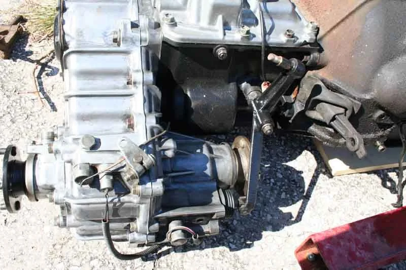

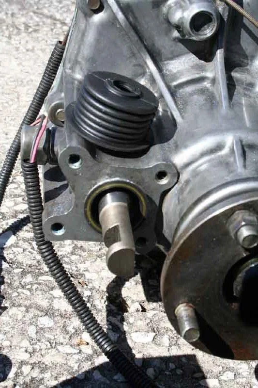

Heres the deal, its almost too simple. You use 2 seals from an 85 fj60 case. Also the linkage from an fj60 case works as well. It even bolts right into the shaft its self and the only other thing left to do is make linkage for the hi-low shift...
Easy as Pie...
Pics are of both seals and linkage...
-Al:beer:
You take off the vac shift assembly and there will be a hole where the 2wd-4wd drive shaft comes out of. You slip the seal over the shaft and seat it in the "hole". Then you slip the booty over the shaft and pull it around the first seal just like on the 85 cases. You then can bolt up the stock linkage from an fj60 t-case.

Do you need the ball/bolt/detent thing to hold it in gear? I see where the hole that would hold the ball bearing detent to hold it in gear is not tapped. Does it click in and stay in gear without it? This sure would be a great improvement for my rig.
shift shaft
I'm pretty sure you need to add the detent ball .which also means you need to add the detents in the shaft itself. You do have to pull the case apart to do this properly.
Well Its been staying gear for me...ill report if it pops out of 4wd or not.

No need to take the t-case out for this at all. Unbolt the 4 bolts hold on the vac shift...install seals. bolt on linkage.....maybe 15 minutes..
My whole drivetrain were out of the rig for that picture;)

guys, he's not changing to the 6o linkage rod, thats what you find when you take the vac. shift stuff off. in that case the 2/4wheel drive "switch" is acting like a detent.... not right, but it works
good info al!!!! :beer:
i'd definetly drill and tap the case for the detent setup. fwiw, the detent ball, spring and cap are the same as for the 2-4wd engagement. and they're fairly cheap from the dealer.
