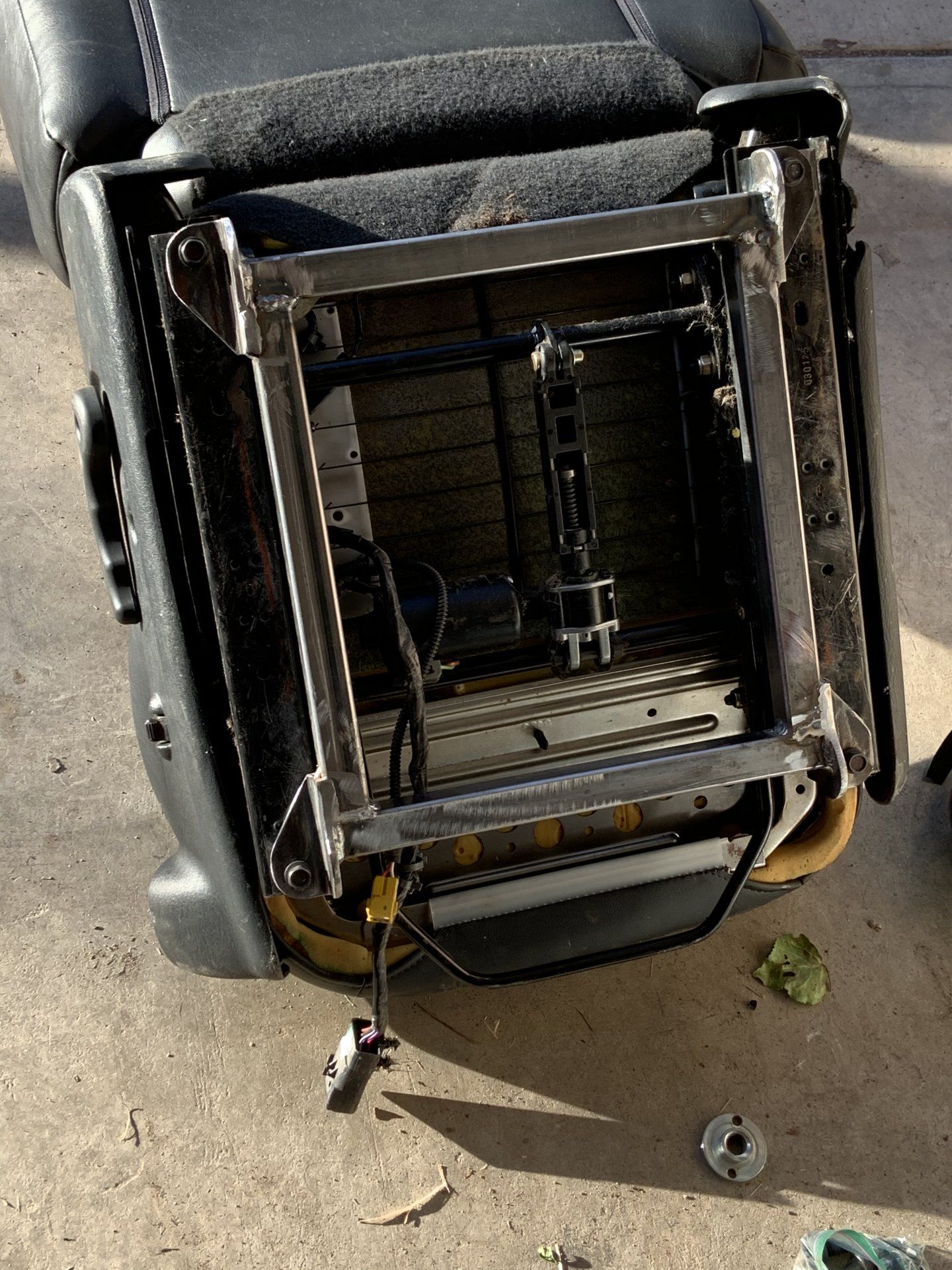

Decided to turn attention to finalizing the seat mounting. Way back on page 3, I constructed a Jungle Jim of angle iron to mount the two PT Cruiser seats mocked to look like a factory bench mount since I just removed them. A year and a half later, I don’t care for the Jungle Jim, so it’s on to plan B. Funny how letting ideas ferment tends to lead to better ideas. Sometimes. Maybe. Possibly.

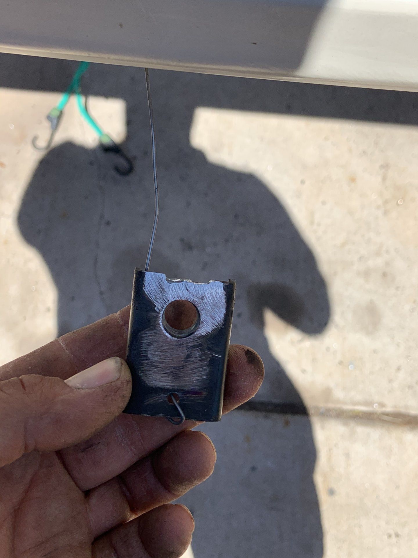

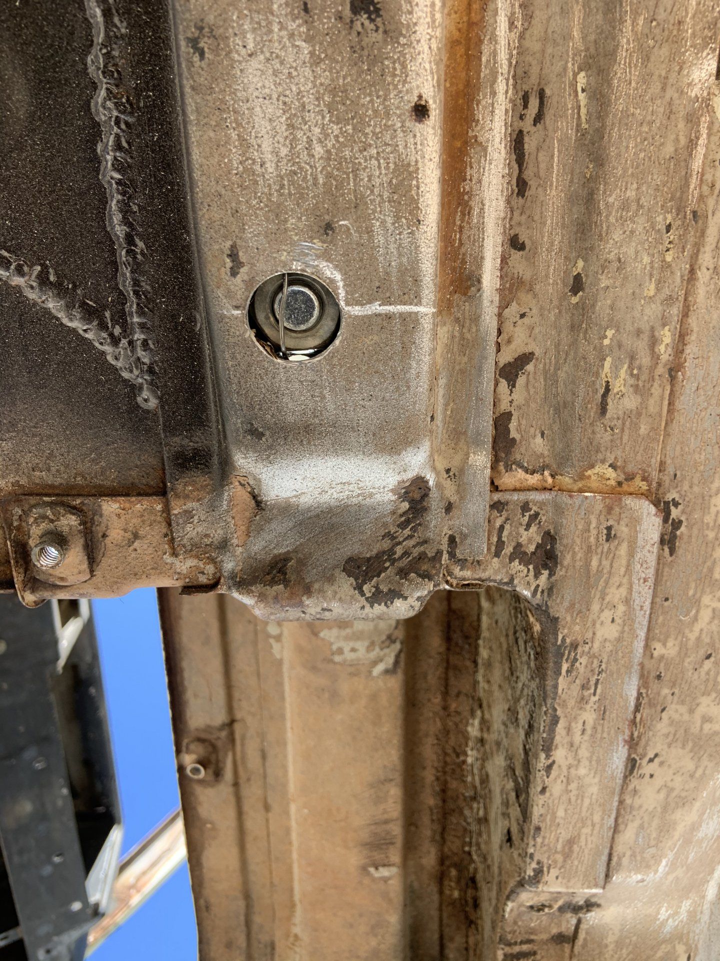

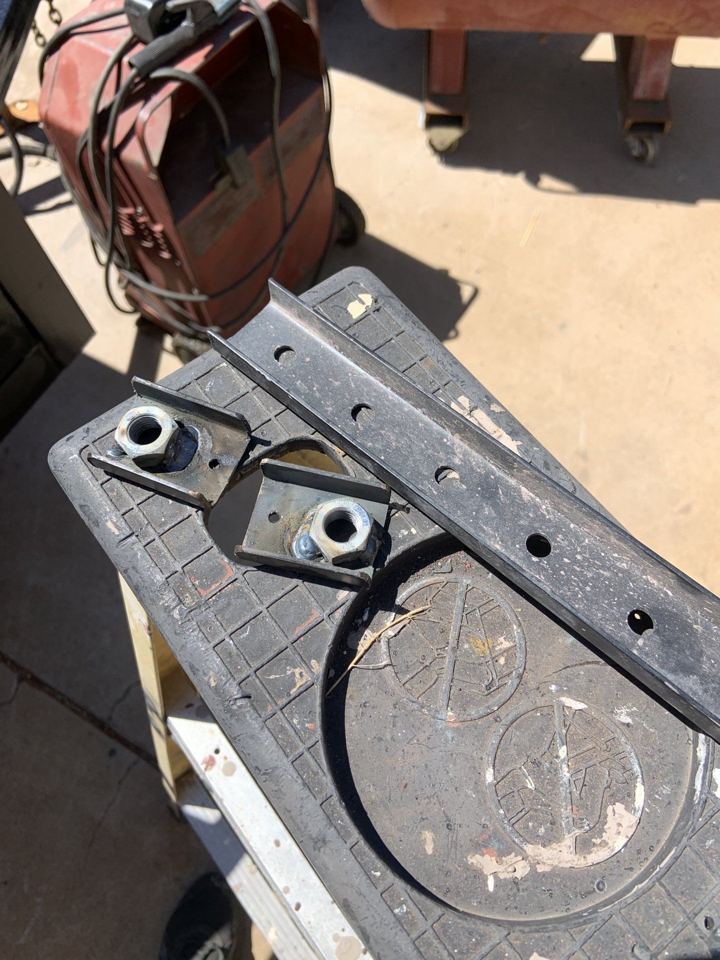

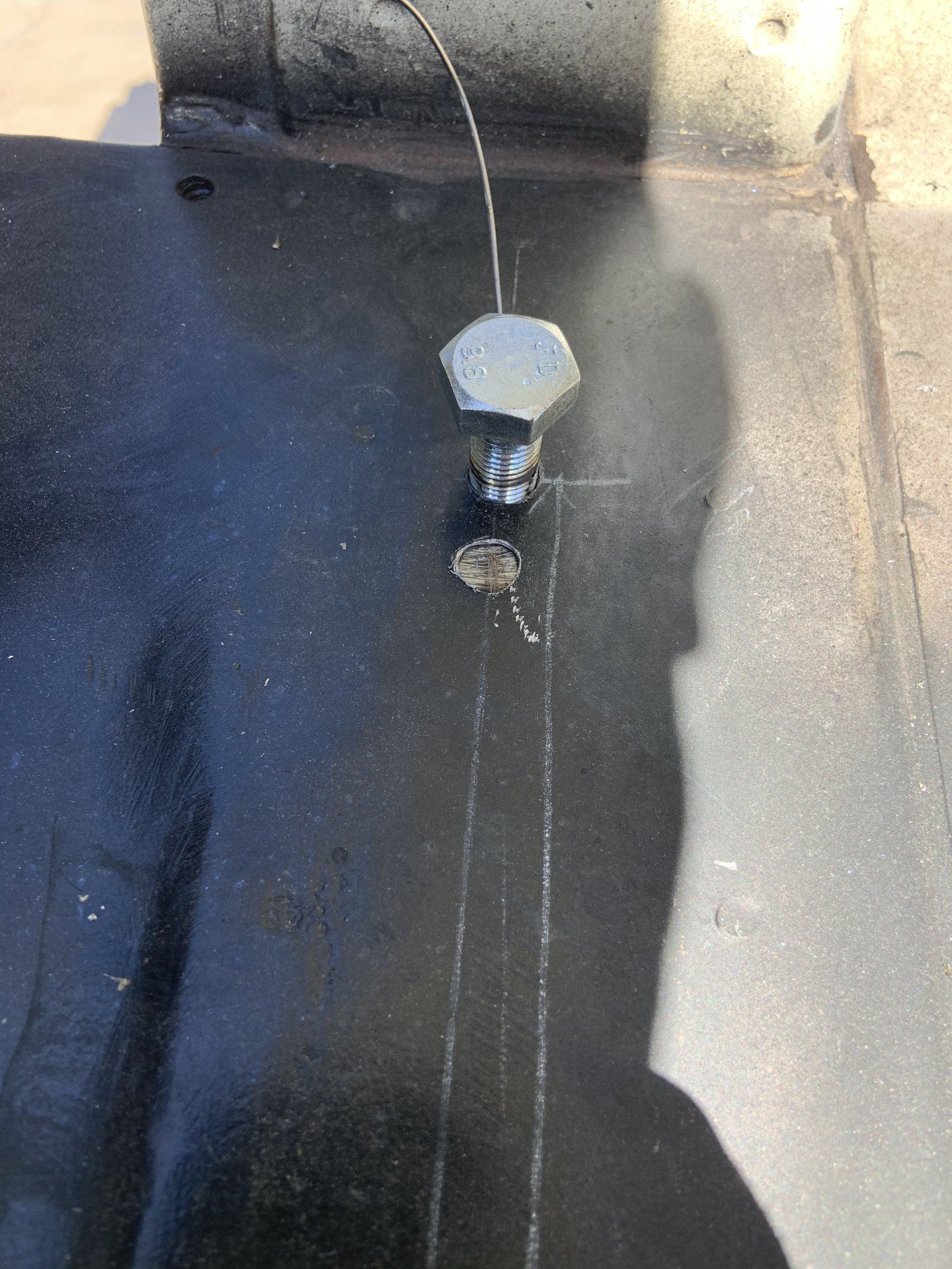

Decided to build two independent seat mounts that bolt to the floor and can be removable, upgradeable, you know, down the line. Since at least two of the original front seatbelt bolt holes became obsolete, the decision was made to remove the two pedestal mounts I welded in, and utilize the seatbelt bolt holes as holes for the rear seat mounts. Front holes would have to be cut, much to the chagrin of purists in the ranks, so decided to try to do them with a hint of flavor. 12mm x 1.5 Captured nuts were welded to some 1-1/2” stamped channel and “Scrapdaddy” wire-fished through the front underside tub ribs and plug-welded to their new homes. Rear seatbelt mount holes (factory captured nuts) were drilled and re-tapped to 12mm x1.5.

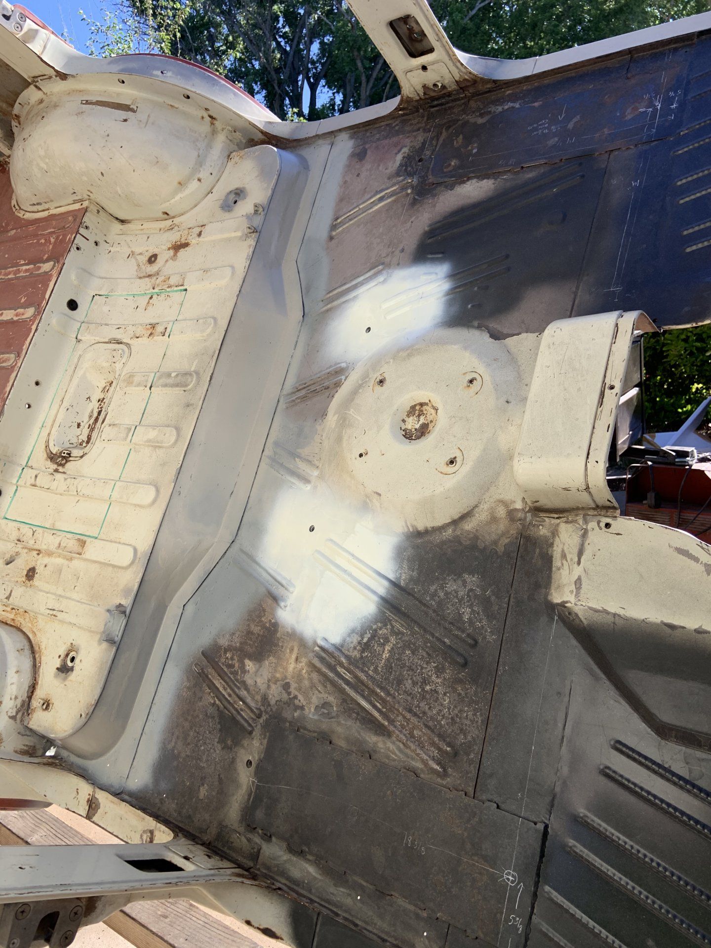

The inside front passenger was more of a procedure. A factory hole in the underside rib already existed in an area close in proximity to where a bucket seat foot mount would exist. But the topside required a portion of the oddball factory floorpan to be flattened and walled up for reinforcement.
