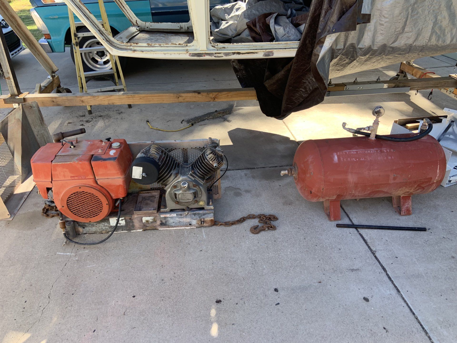

Anywho, one of the sweeter things that happened was getting this 10hp Kohler-driven, Dayton two-stage air compressor from work for free. Had a blown head gasket on one of the compressor cylinder heads. Was able to make a gasket. Now just need to get some belts and do some plumbing. Would like to mount the compressor and engine on top of the 30gal tank and put some castors on the feet and make it mobile. Should take care of my air needs from here on out.

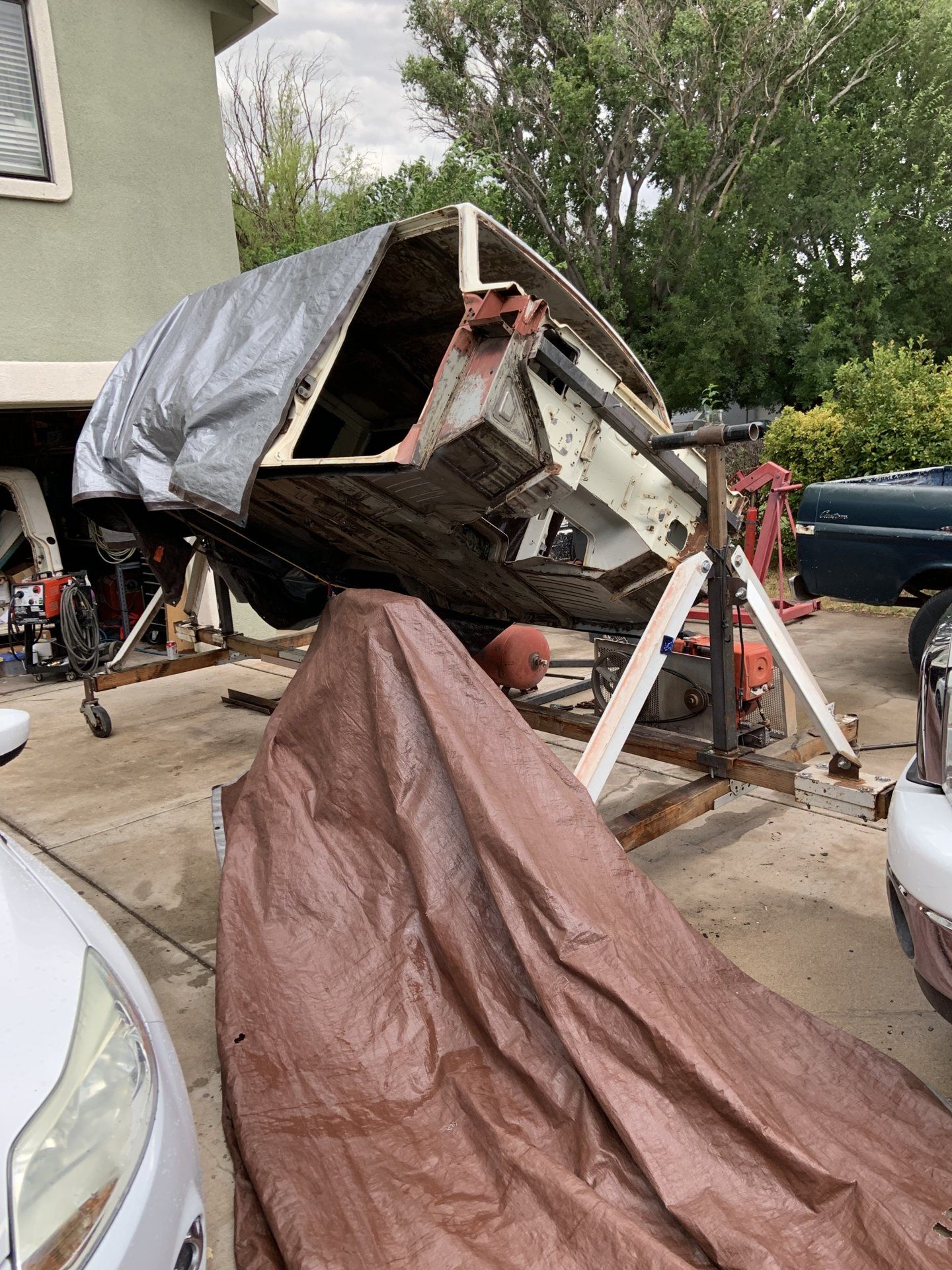

Been fortunate to dodge any significant storms in the last week. Tarps stayed buckled down for the few showers we did have.

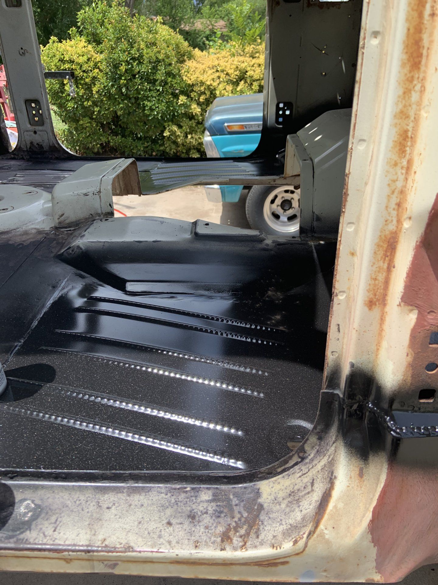

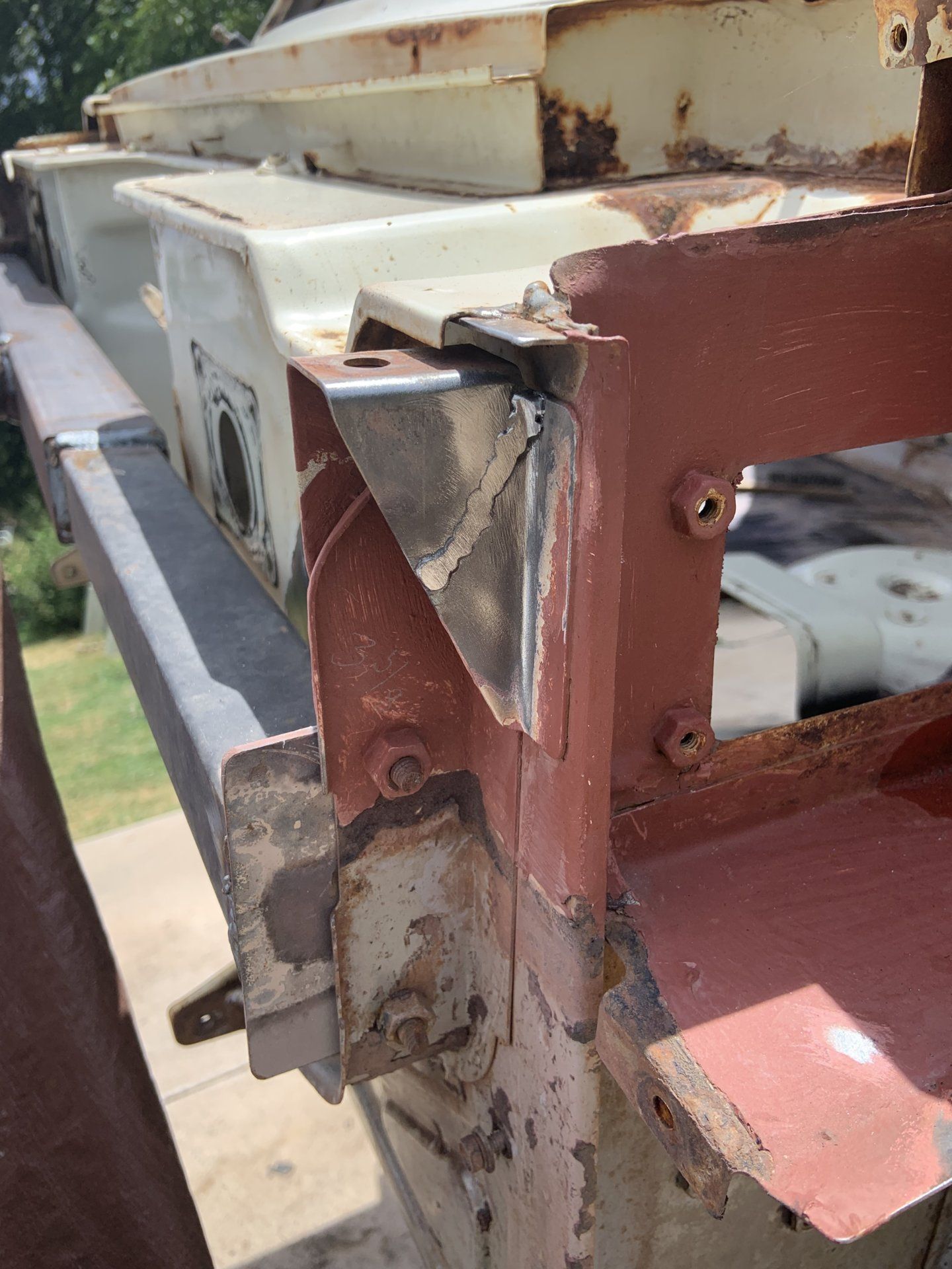

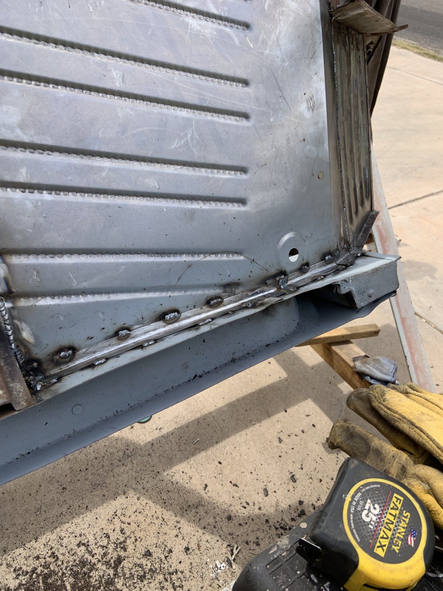

So I’ve been back and forth on how to deal with the bare metal from the tub repairs while I do all this work. Long story short, I’m just going to spray the areas down with some rattle can paint for temporary protection until it’s time to do the actual paint work, then I’ll just remove it with some stripper or sand before making my base layer with epoxy primer.

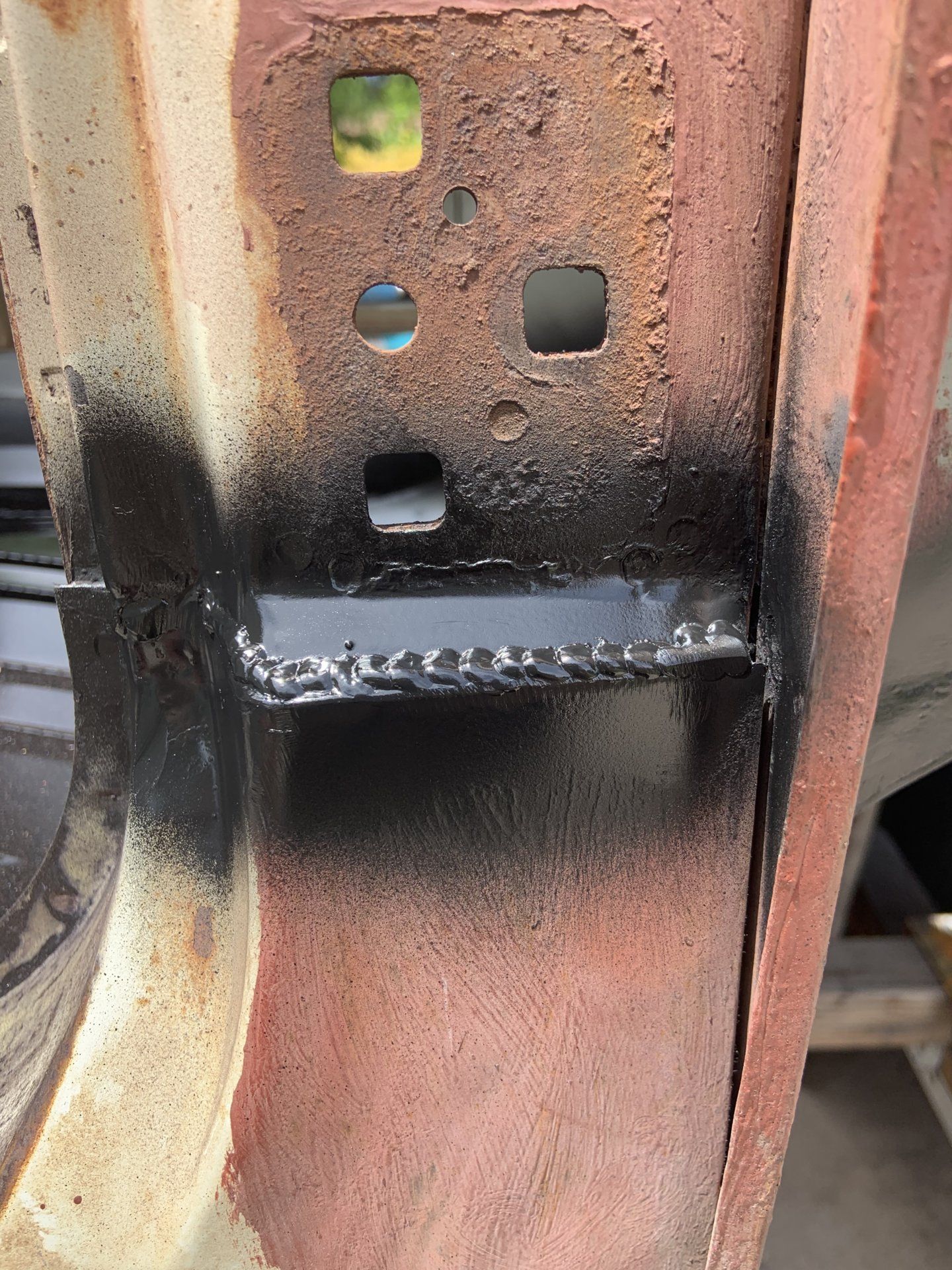

So I went back and cleaned up most all of the areas I’ve worked on so far and rattle canned them. Welded up those channel seams and a couple cracks on the upper mounts for the inner fenders.
Why not grab a couple cans of Self-Etching Primer and hit the spots as you go, most automotive paint stores carry spray cans of quality primer designed to work with automotive primer systems so no need to remove later.

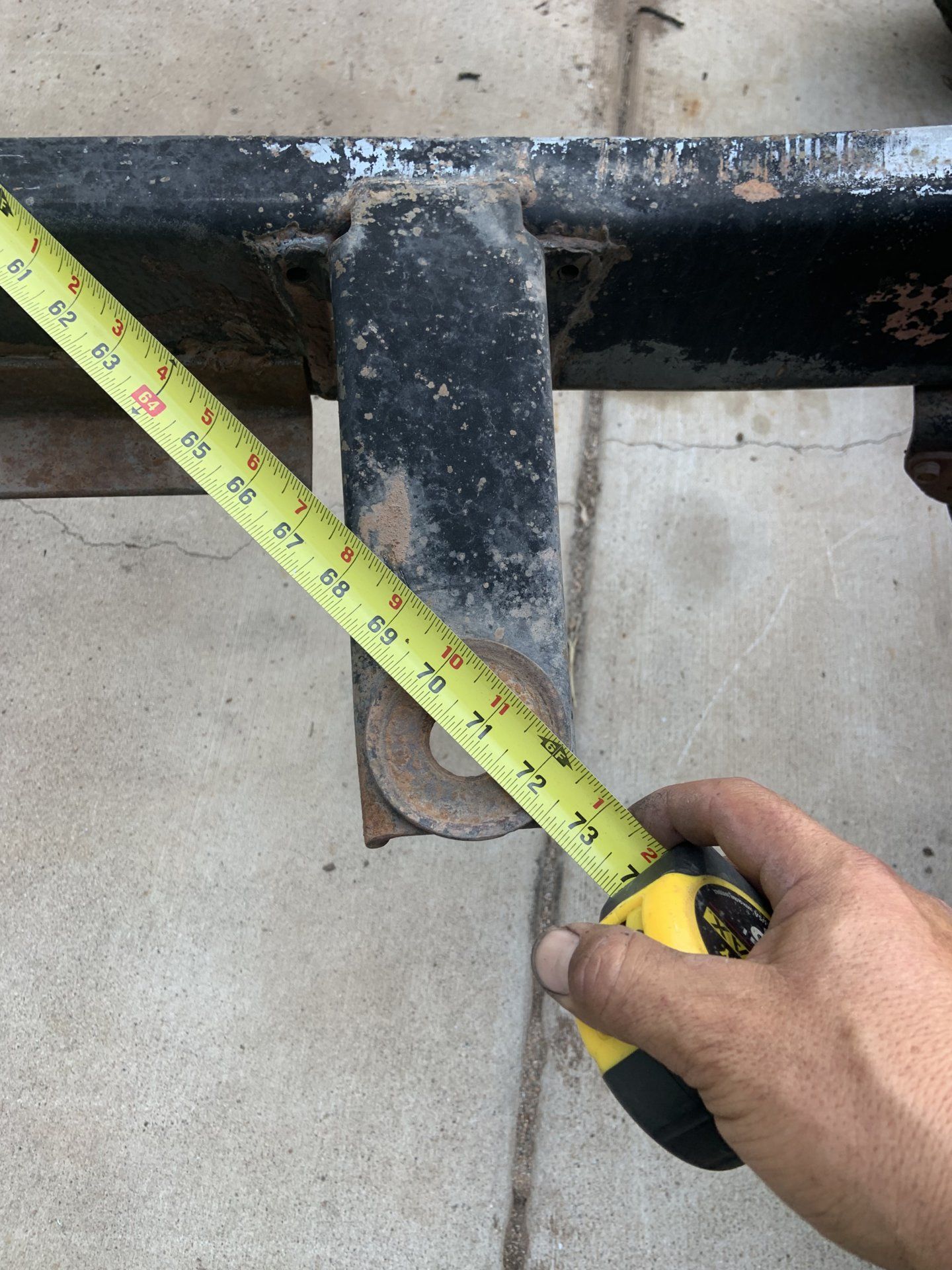

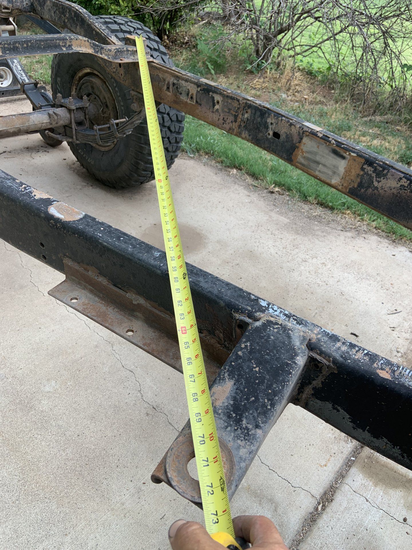

On another note, I’m finalizing the bolt hole placements for the front tub mounts. I took a couple quick measurements before cutting based off of the front of the lower extension of the A-Pillar and the inside sheetmetal of the rockers. This got me in the ballpark, but wanted to confirm it based on the frame. The measurement from the front tub mount in line to the second mount back is dead on 55” center to center. I decided to “X” it from the second mount back on the opposite side, and it’s dead on 71” center to center. All is right in the world...
