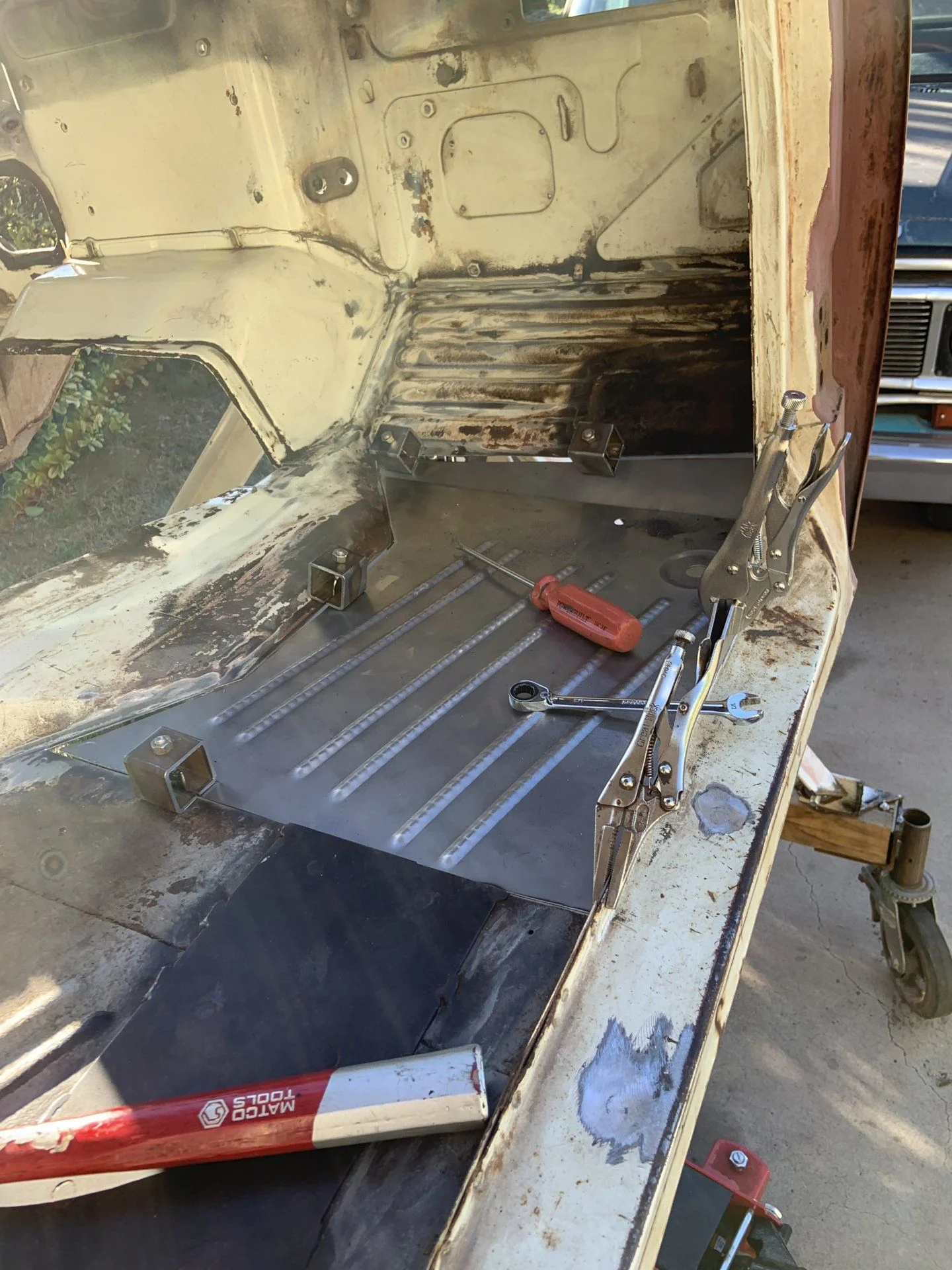

Got a little bit of CAD (Cardboard Aided Design) work in. Also removed the strip of floorboard left spot welded to the weatherstrip seam. Little victories...

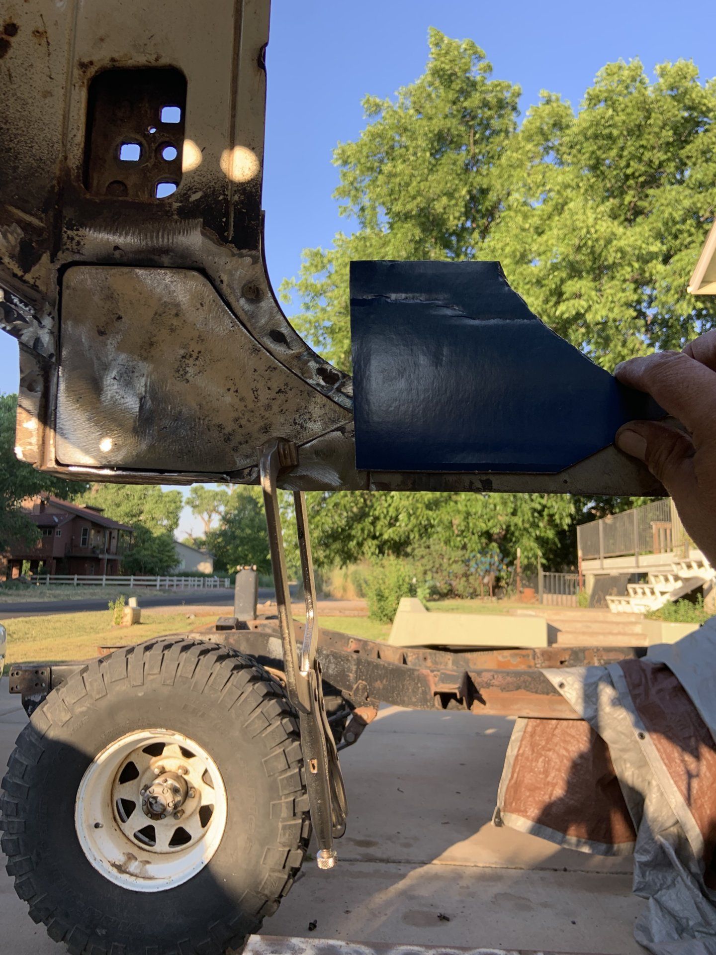

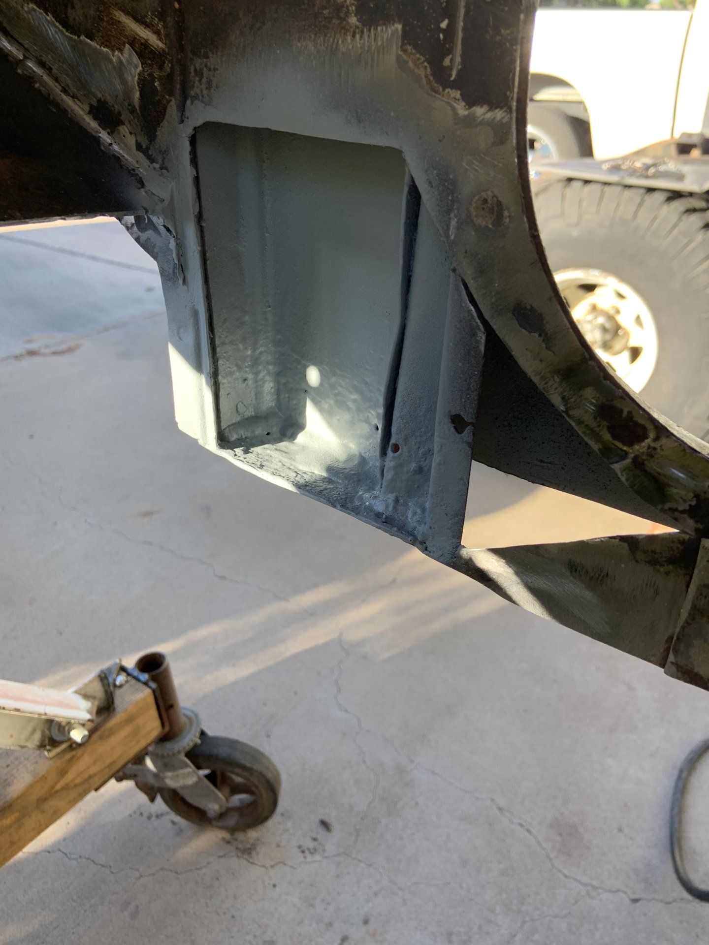

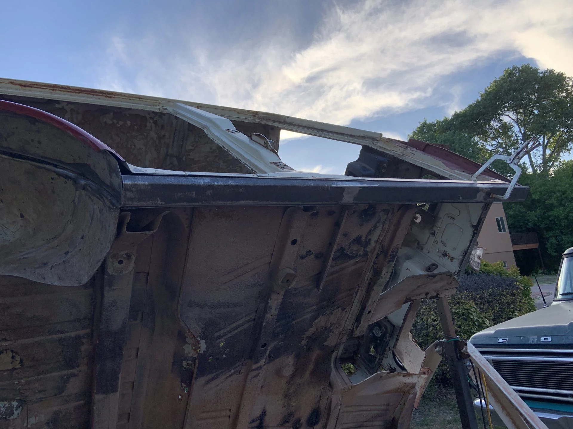

Couldn’t get much for any real work tonight, but mocked up the passenger rocker cap to see what might be done for a drain or clean-out of the lower A-Pillar. Not anything real snazzy. Still need to tack in the pan and tub mount before settling on anything, but may just be a few holes drilled fitted with some rubber plugs.
BTW - 2” from the bottom of the door sill to the bottom of the rocker cap.

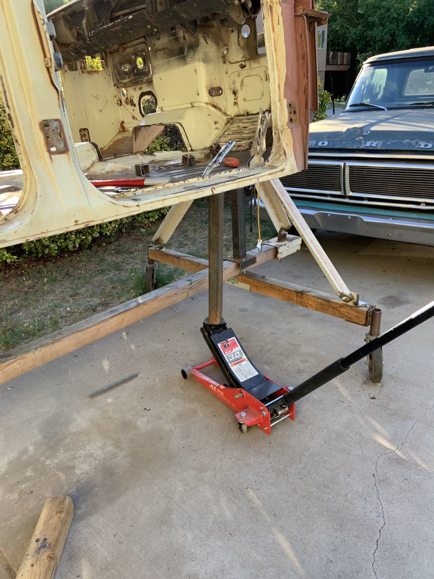

We are on the same path at the same time!

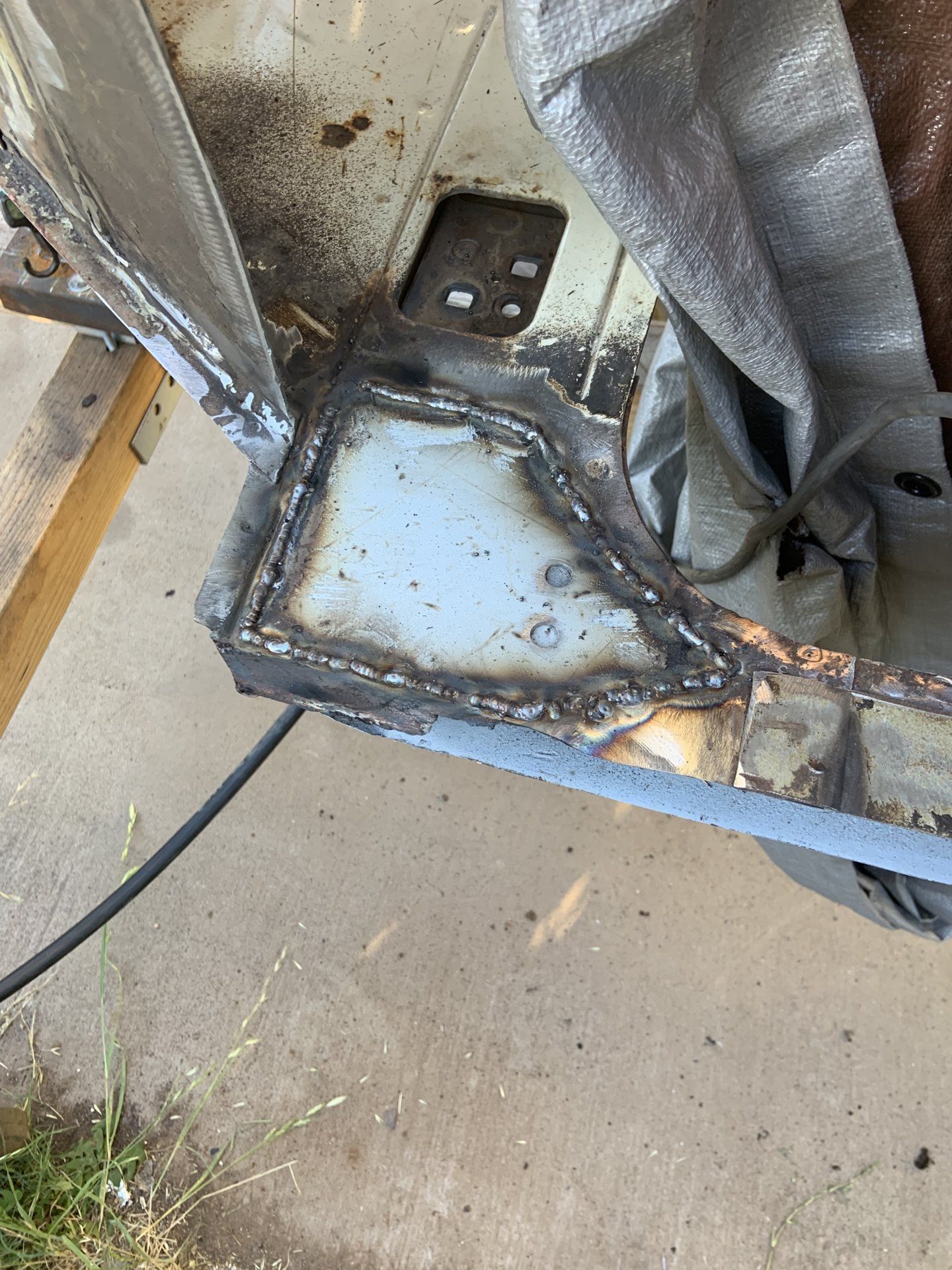

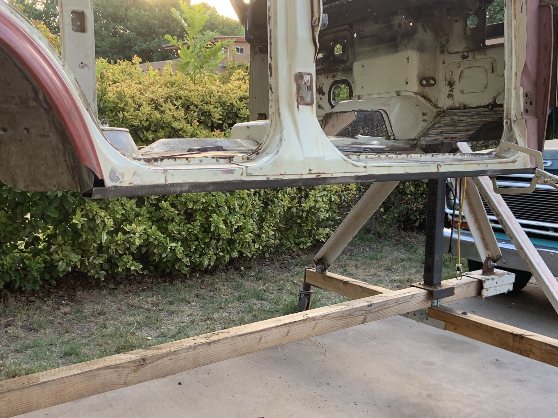

I am about to button up the drivers side after that I want to put it on a rotisserie to complete burning in the welds! So cool.

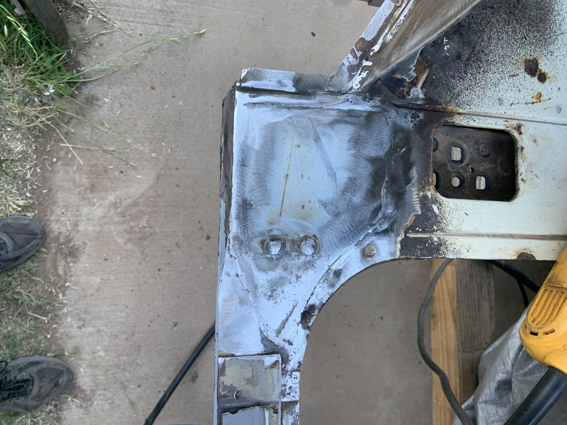

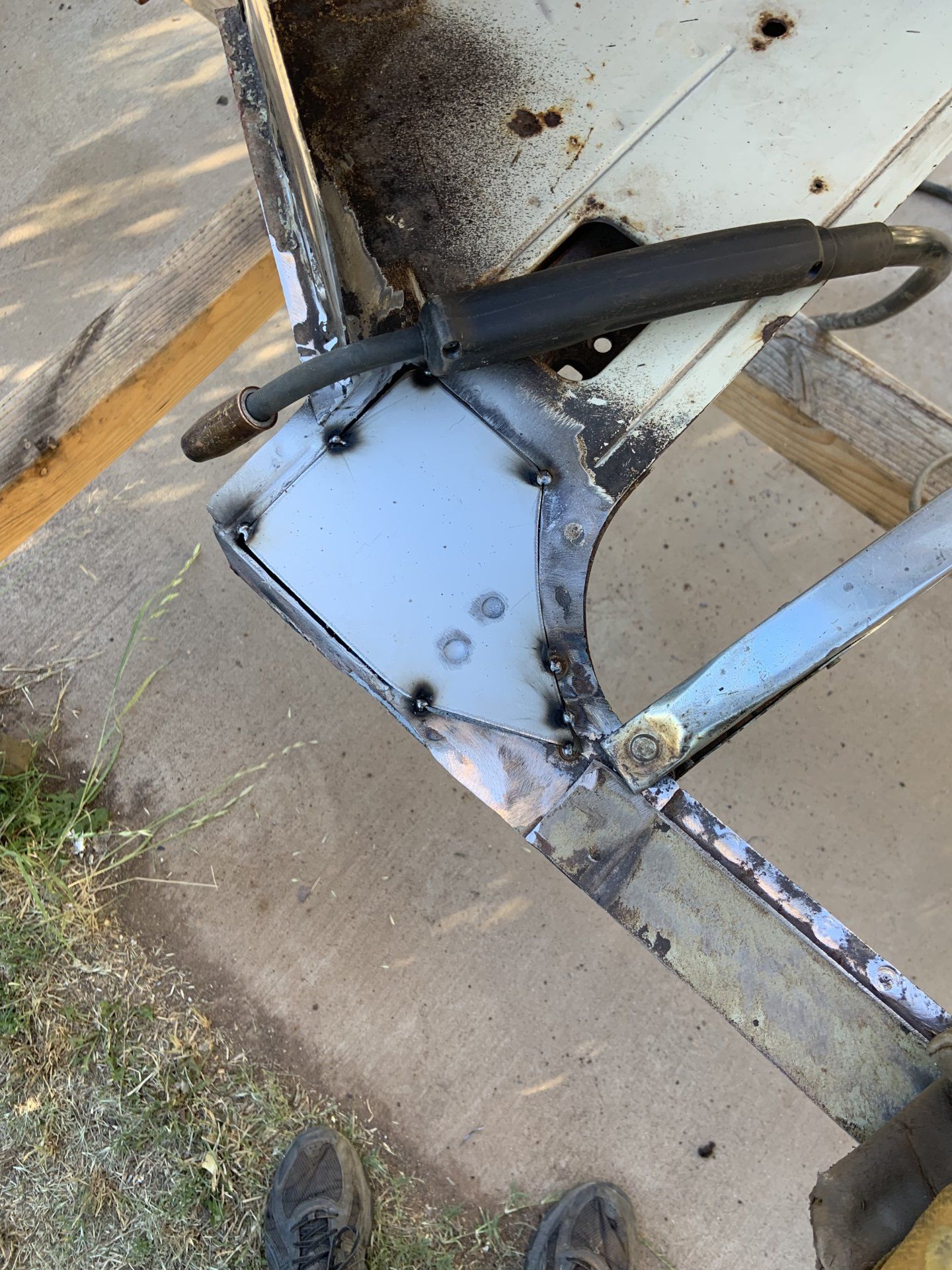

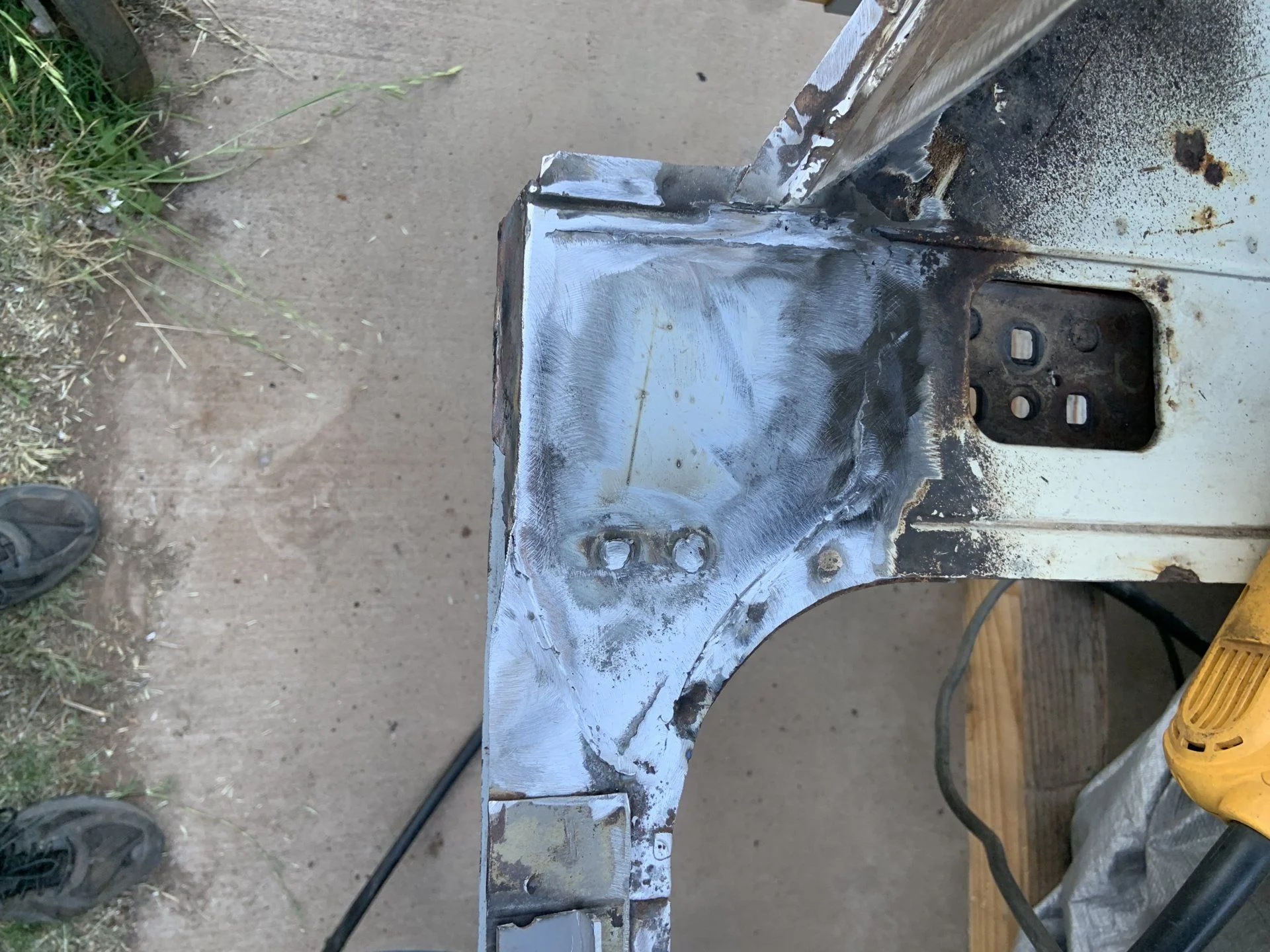

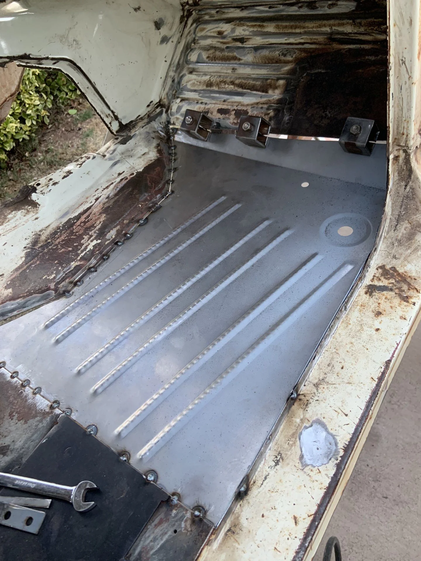

That patch was quite satisfying. Went in so nicely.
Have you blasted out the underside before you put in that rocker? I blasted it and POR15ed it inside. I plan on using this 3M Wax stuff as well, as per Jmack's advice.
I know, pretty cool! Several of us doing tub surgery👍
The upper inside of the rocker cavity I wire wheeled out and sprayed a couple coats of a rust converting primer then a couple coats of SEM Zinc Weld-Through primer. Before I put the nails in the coffin, I’m probably gonna hose it down with a couple more coats of spray paint where the weld heat won’t burn it. After that, want to come up with a couple places to spray some internal coating onto the internal weld seams to help seal those.

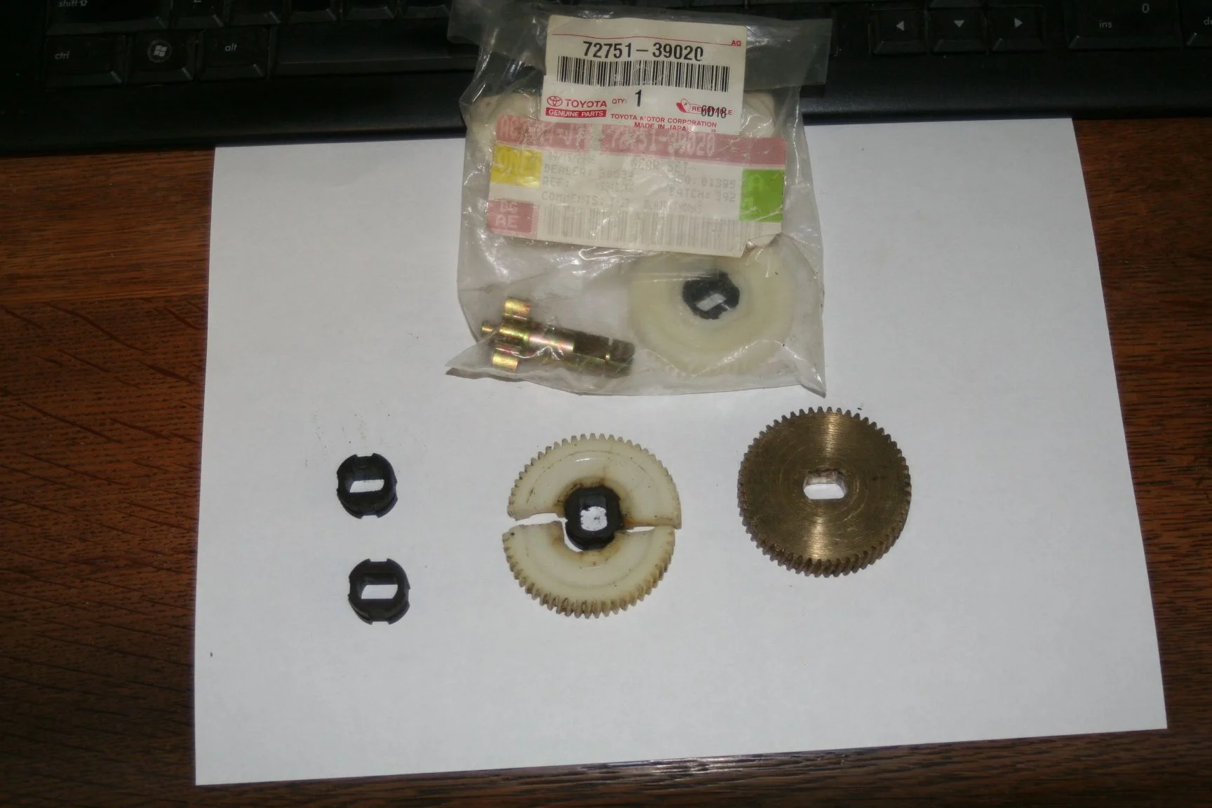

Hey Dustin,
I looked through all my tailgate junk and it's all early stuff. If you want to stay with a brass gear instead of buying that steel one, you can have mine. The one problem with it is the machining part. This batch of gears never had the groove machined in, so you'll have to have that done. I'd like to keep the NOS Toyota gear set...
You can see the flat surface where the groove should be. That groove is to let the cover plate sit flat on the housing.
