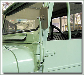

Are there tubs with holes predrilled in that location?
The style that bolts to the windshield hinges is still available with round and rectangular heads. Maybe the holes are the same distance apart?
Did those actually bolt to the hinges as Oem or is that where people have been mounting them. I don't think the hinge is the OEM location. Look at old lit u will see those telescoping arms mounted to the side of the cowl also. I don't think there are any tubs with oem bolt holes there. Just drill and bolt on. Doh.
I think that is the OEM location of those mirrors, but this pic is included on the same page at SOR, with this text, "Another factory mounting option that was used on 1958-1967 USA 40 & 45 Series and later model NON-USA vehicles, mirror arm location was below the windshield hinge on the small flat side of the front body cowl, as shown in photo. 1958-1967 USA 40 & 45 Series and later model NON-USA vehicles had factory nut plate welded to the inside area for mounting, so no drilling was required. For 1968-1984 USA models you also have this option for a mounting location for the telescopic mirror arms #166-02A, but drilling is required, two holes per side."

Since it looks like my rig is going topless, I just received these:
I'll get some rubber washers and extended windshield hing bolts to mount on the windshield hinges.
They vibrate pretty badly with a direct mount to steel. A rubber washer would only aggrevate things. I suggest cutting some thin plastic washers from something like the side of a milk carton to protect your hinge but still allow for a firm base for the mirror arm.

Much appreciated....I have several plastic washers I've made from milk jugs, so I'll install a few.
