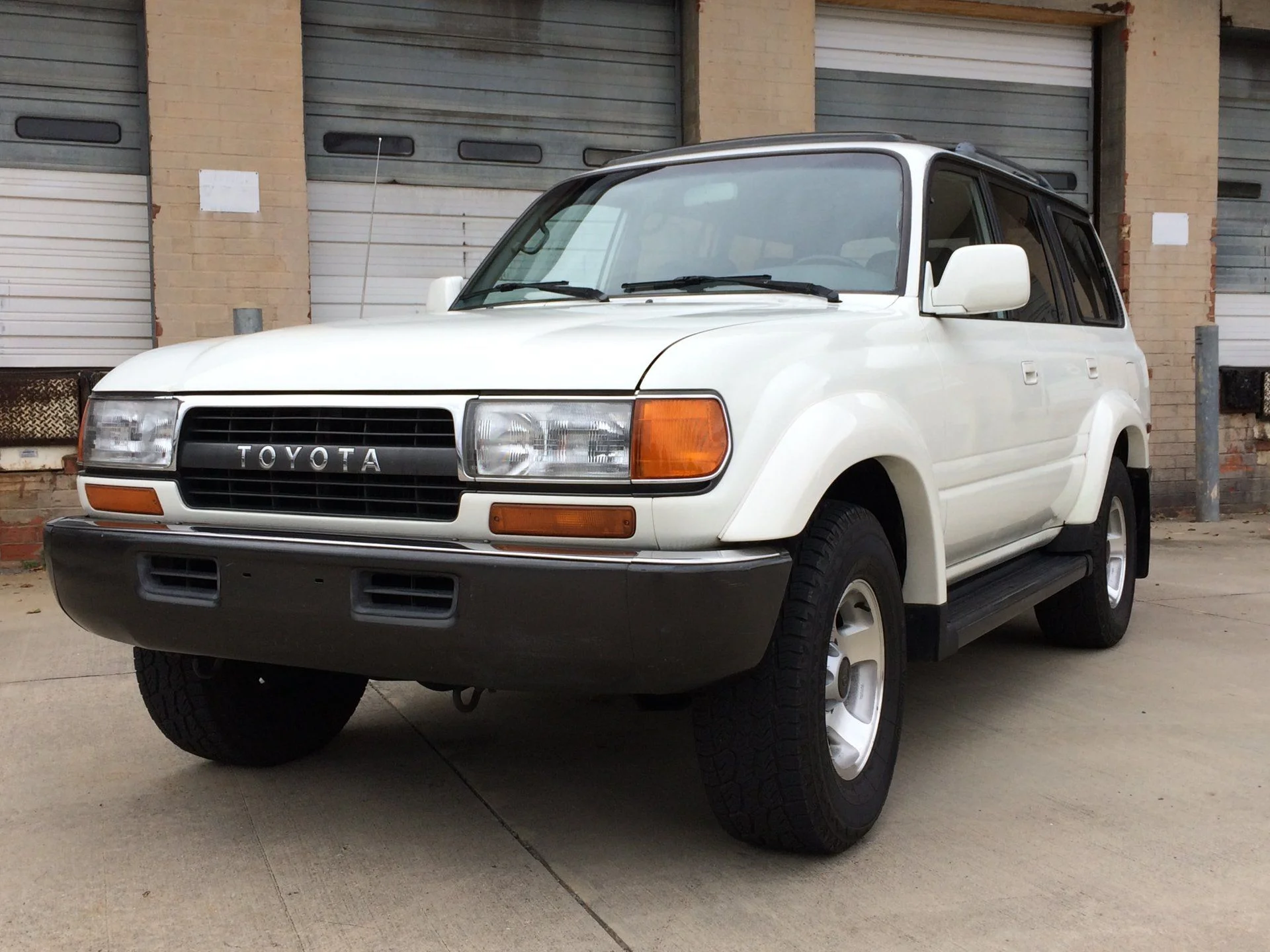

My affliction got the best of me once again. I just picked up this '94 FZJ80 here in Charlotte on Tuesday. It is an honest bone stock, no accidents, original paint, local, 1 owner truck. 180K miles. Sadly, no lockers. I'll be cleaning it up and working out the bugs in the days to come. Immediate plans are to give it a good cleaning and spit shine, throw on some seat covers and fix a couple of nagging issues like seat gears, inop windshield washers, etc. Full baseline to happen over the winter and as time and money allows, I'd like to do the normal 80 SWAG (lift, 35's, sliders, rack, bumpers, lockers). The goal for this truck is to have a "newer" mostly worry-free rig that can make longer trips. I love my 40 and 60 but taking long trips in them stresses me out. Here's the only pic I have right now and it's not great. More to come....

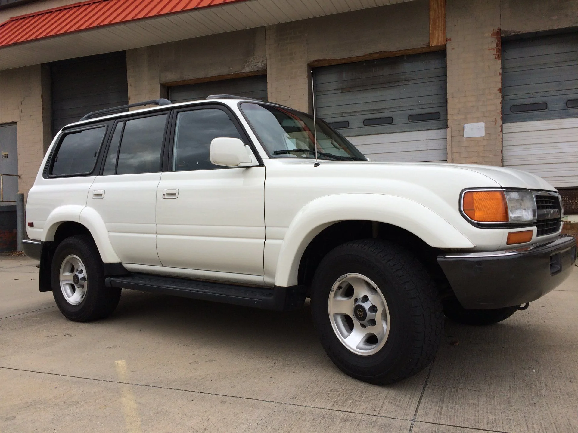

Here are a couple of more recent pics of Cotton all cleaned up. I did an overall cleaning and light paint correction to bring the shine back up to par. Removed the crudded-up rear fender rock protection film. Seat gears are done and working properly again with the Gamiviti gears and caps. Next on the to-do list is PCV valve and associated grommets and hoses and new intake hose. Oh, and seat covers. The driver's seat is pretty rough and duct taped at the moment. After that, brakes.

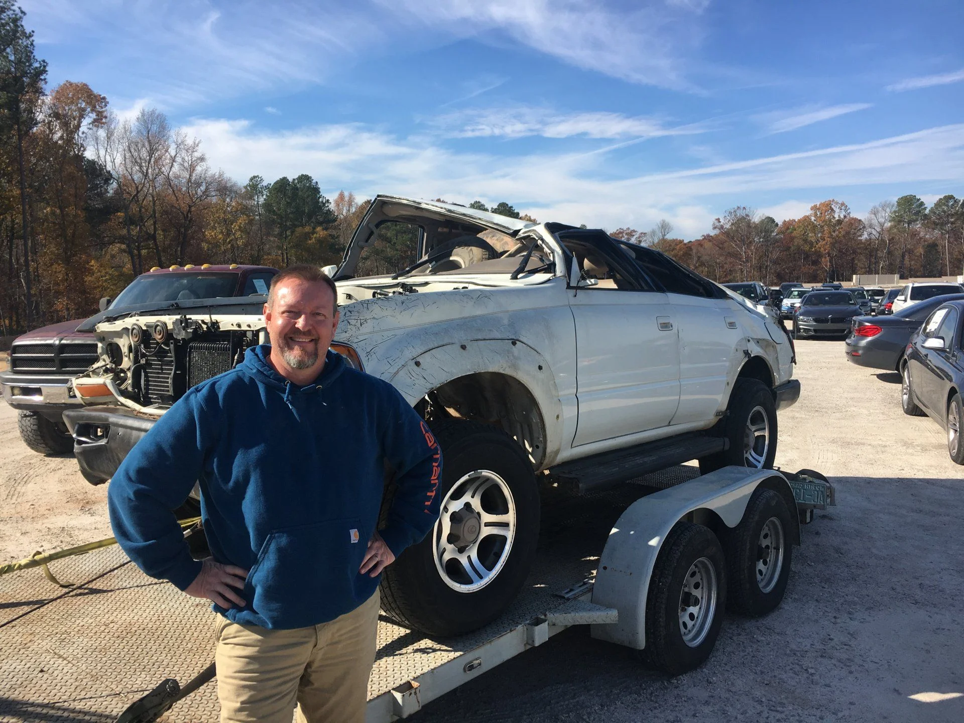

A couple of local club members hooked me up with the owner of a wrecked '97 80 series truck with the factory Elockers. I struck a deal with him for $500 and trailered it home. It will donate its locking axles to Cotton. The parts truck was involved in an off-road rollover and was featured in the "Whoops" section of an issue of 4wd Magazine. Whoops! Chop It? The engine has already been scavenged. None of the doors open. I'm pretty sure I will have to cut off the top to be able to access the interior goodies (if they aren't all too nasty to save). The owner said that he rebuilt the knuckles 200 miles before the accident so I am hoping to swap the front axle in as a complete unit and rock on. I may do the same for the rear, but I'm not sure.

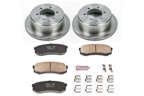

Cotton's rear brakes were toast. It had a great deal of brake pulsing and shudder when making even light stops. I determined that the rears were the culprit so I ordered Powerstop's OE replacement kit. The part number was KOE 1156.
The kit was $115 and came with ceramic pads, rotors and clips. I installed everything last Friday and, just like that, problem solved. The old pads were worn down within a gnat's hair of the backing plates and the old rotors were scored up really badly. I hated to put these new pads and rotors on an axle that I knew I would not use (I'll be swapping in a locked axle) but the brakes were so bad that I didn't feel comfortable driving it. Besides, I can always swap the new stuff over to the locked axle once I get that installed.

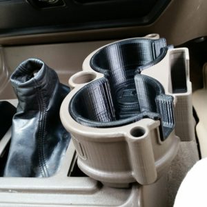

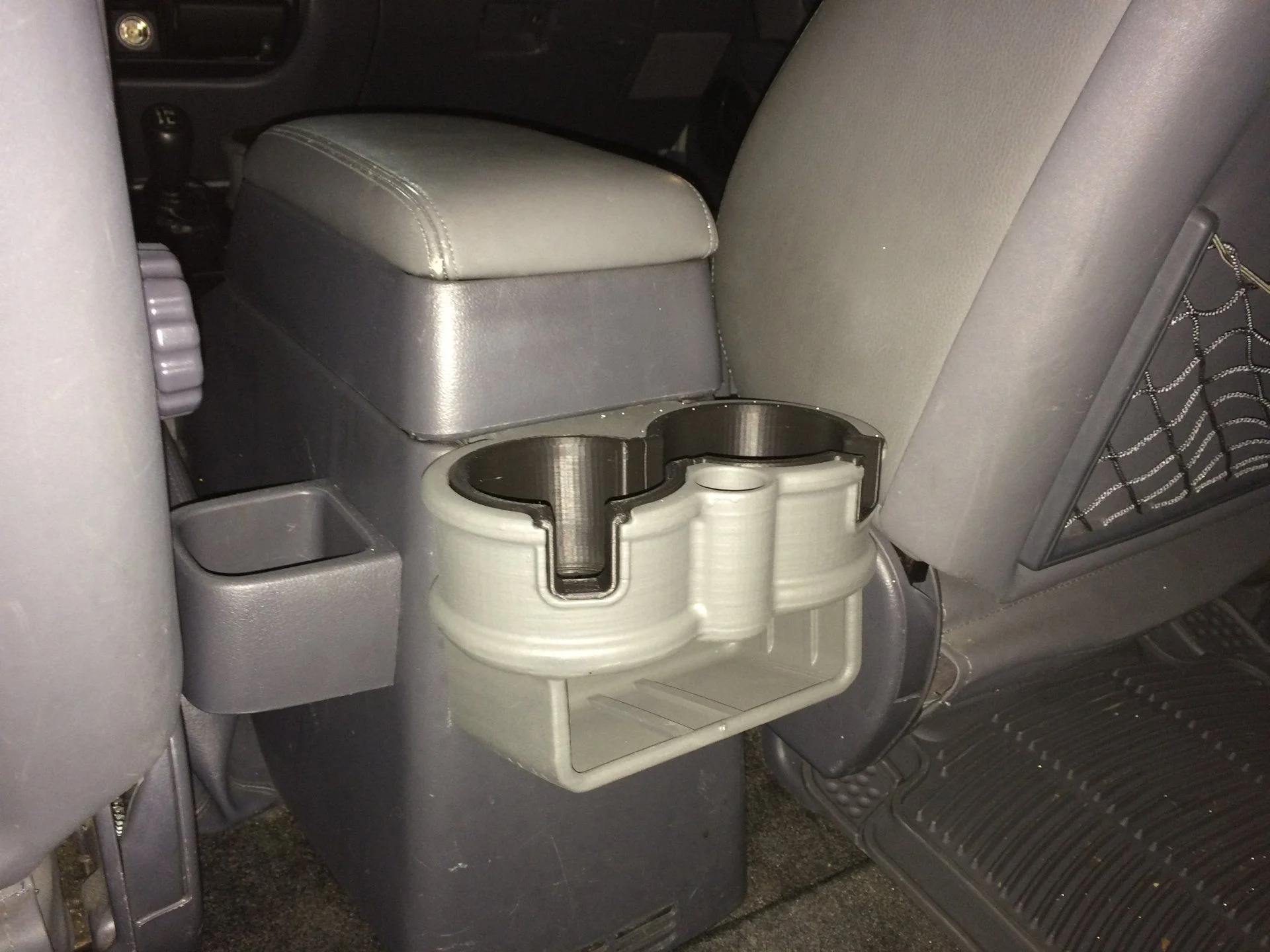

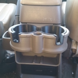

I guess Japanese folks drink out of tiny square-ish cups. I don't. I couldn't deal with the crappy factory cup holders so I splurged and bought new front and rear cup holders from BH3D Printing. Brad @bhicks is a MUD member and he turns out a quality product. BH3D Home - BH3D Printing
I got the double front

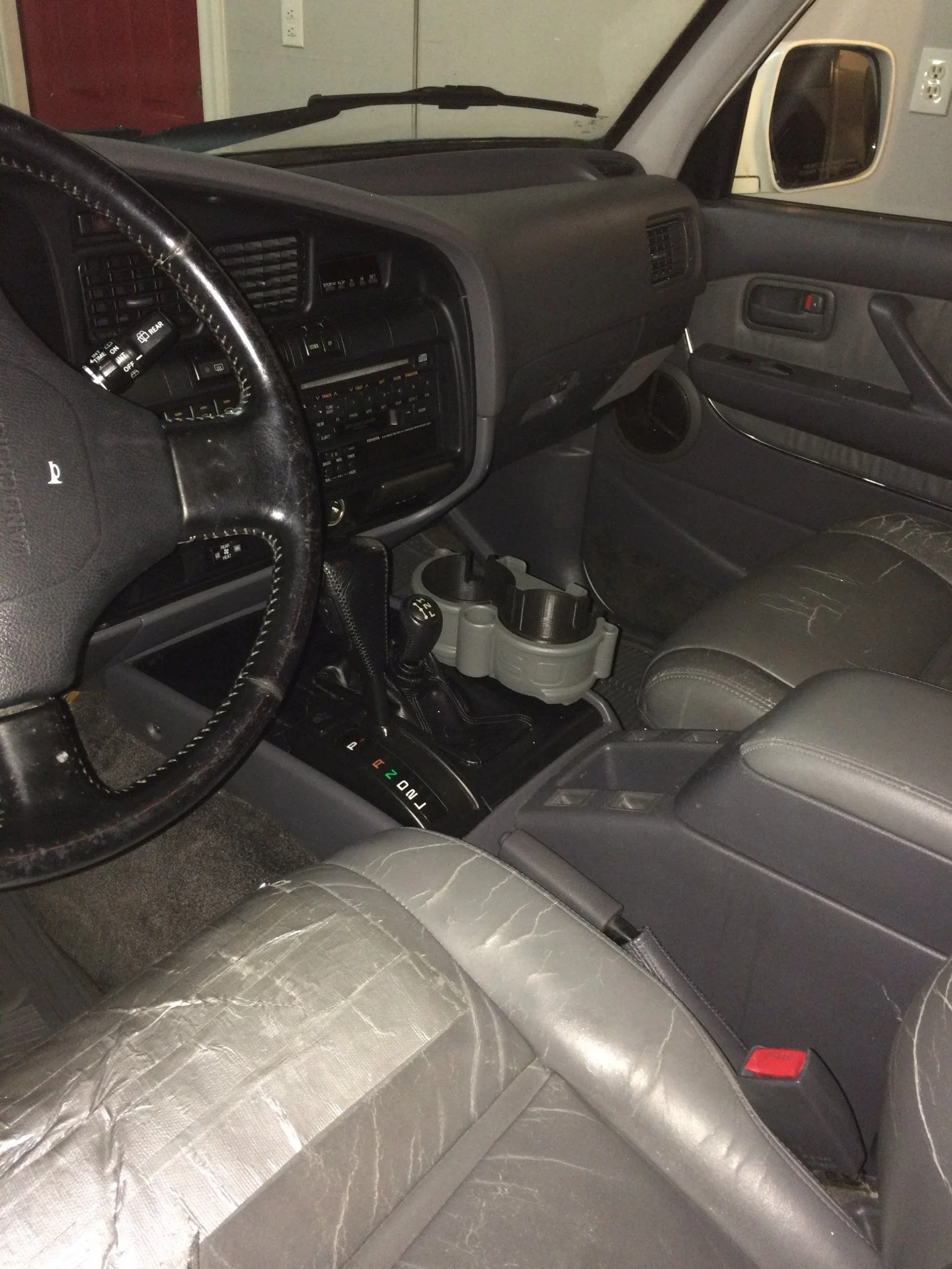

...and double rear.
Both in gray. Install took 5 minutes and they look fabtabulous (if I must say so myself). Below are the actual pics of my truck (crappy pics though) and you can clearly see the driver's seat PO duct tape disaster.

Nice find on the rotor/pad set.i just checked and they dont offer a set for the front, nor does Napa. Have you found any other sources for affordable rotors other than Slee's $180 a pop Kangaroo Paw rotors or Toyota?
Powerstop does indeed offer an OEM replacement rotor and ceramic pad kit for the 80 series fronts. It is PN KOE1154. I found that Summit Racing has a better price than Amazon. Summit has the KOE1154 for $115.97. Free shipping. I have used the Powerstop rotors and pads on the wife's LX470. They work well. I'd say they are just as good as OE pieces.
