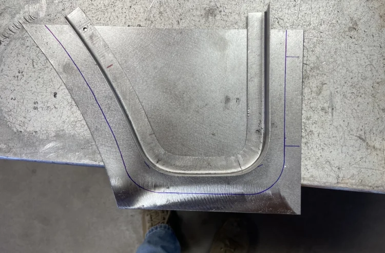

I have learned that metalworking on these old bodies takes a mountain of patience. I'm still a rookie but compared to when I started a few years ago it has become alot easier.
btw - you have now made me add a "power hammer" to the list of fantasy tools I want to own. :D Your shop did a great job keeping the panel flat while stretching the metal to put into those dual ribs. Love to know the "trick" to achieve that result.

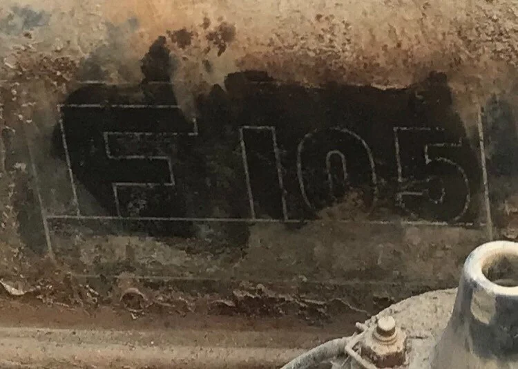

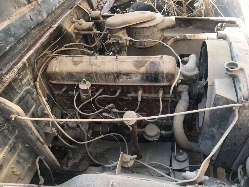

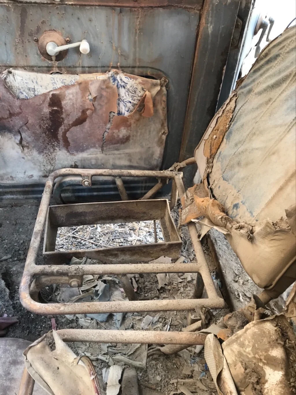

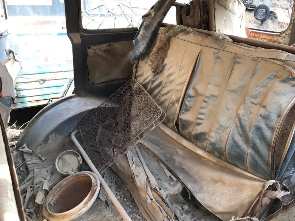

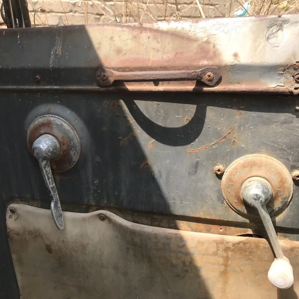

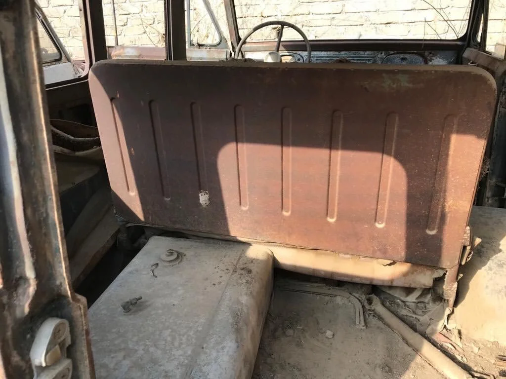

More photos of that Saudi 28L - it’s a 1958 with the F105. this thing is amazingly complete! Confirmed all the door hardware and internal door regulators should match the 45LV
I now know what the seating should look like too. Interesting that this front bench looks like it was made for a RHD. Also confirms that battery opening on the right side is OEM, and the interior body panels were upholstered. This guy has been incredibly helpful with a lot of info I would never have been able to find anywhere else.
Amazing.....what a great help those pics will be.

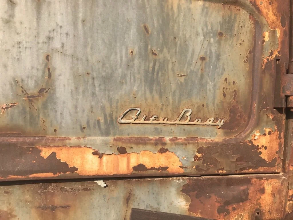

That Gifu badge is too cool....

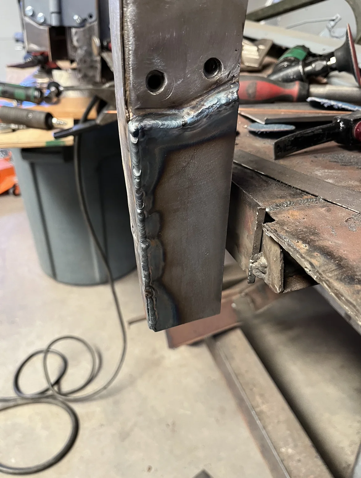

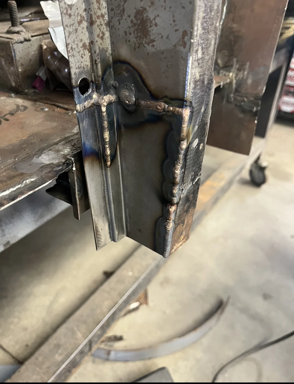

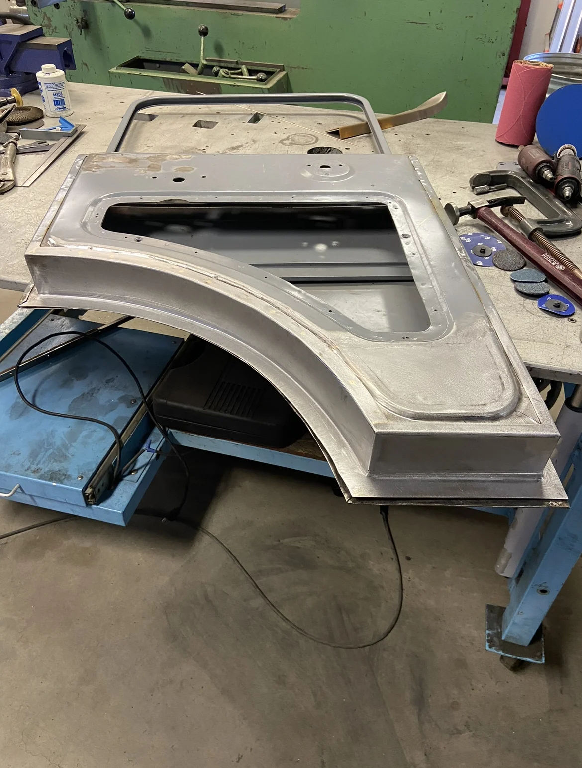

A few teaser photos of some of the progress. Again, a lot of this is just fixing the previous shop's work. Much of the bracing inside the doors had to be repaired as well as the door skins themselves.

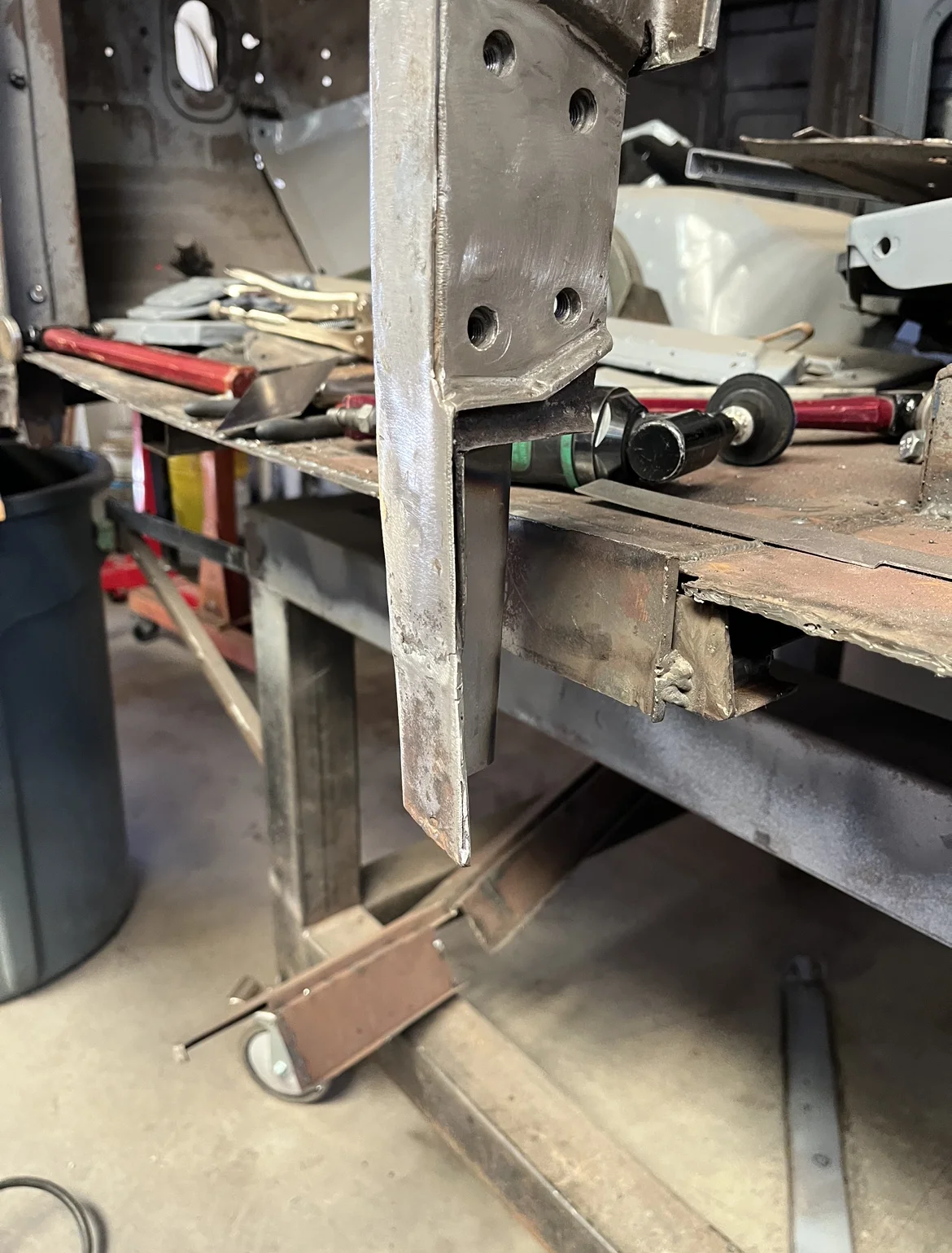

B pillar repair still in process. This is the kind of stuff that's frustrating but has to be done. At least half of the holes were completely stripped and had to be rebuilt and re-tapped. Several of the door hinges had to be remade, as well as the pins which turned out to be a completely different size from the LV doors and any other 40 series door.

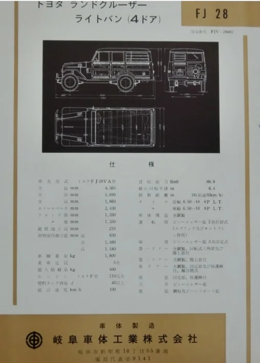

I did come across this this morning on instagram thanks to @red66toy. Apparently 30 year old photos, but as this thread is probably now the best thread on the FJ28 Gifu wagons I thought we better capture them. The couple of interesting things I noticed (aside from the snow plow!) was fender mounted turn signals and a lack of jail bars in the rear. Possible those were modifications though rather than factory specs.
Glad to hear that there's some real progress on your 28 Nathan. Looking forward to future pics and thanks for posting these of this 28. I hope you're all doing well brother.
