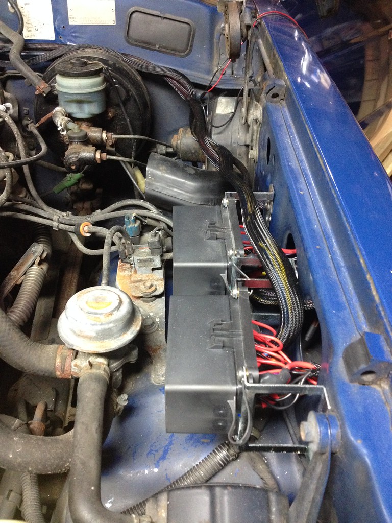

Installed Wired Wagon upgraded headlight system and a second auxiliary block for seat power and heat... and other goodies later. Wire layout is temporary:

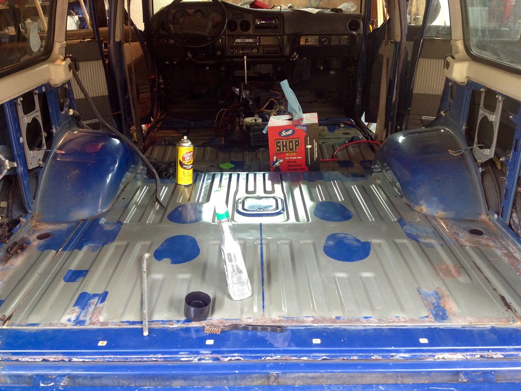

Stripped the interior floor and added Cruiser Crap sound deadening, foam and then mass loaded vinly in the summer heat (not the best call):

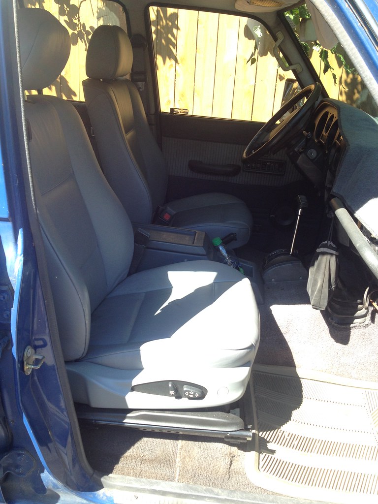

I restored the rear heater unit with a new resister and new OEM motor. Installed power BMW front seats using brackets from @torfab , heat seat wiring figured out but not fully installed until the complete interior redo project begins:
Heating BMW seats (using BMW parts)

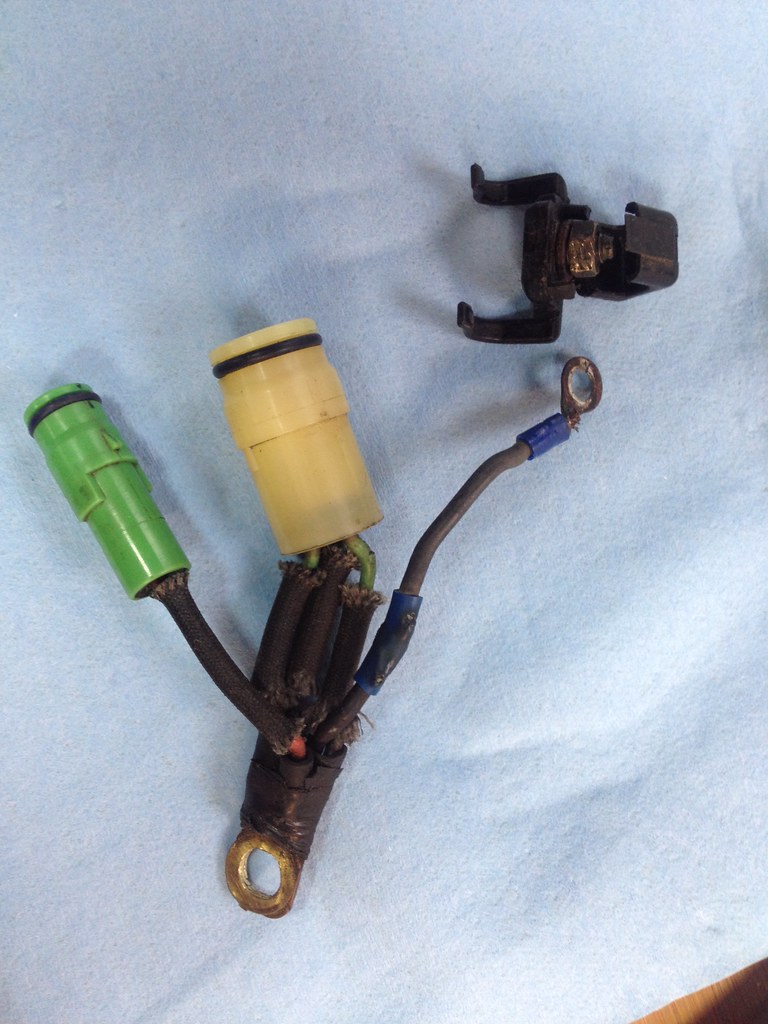

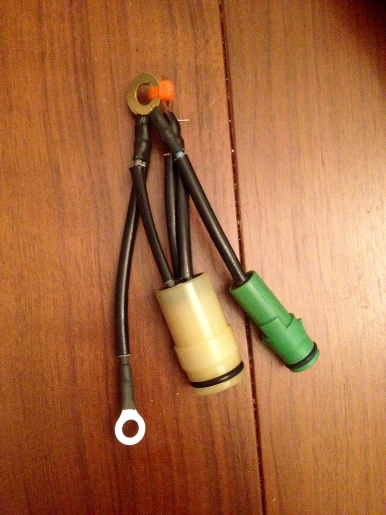

Got my fusible links restored by @Coolerman who did an impeccable job.
Before:
After:

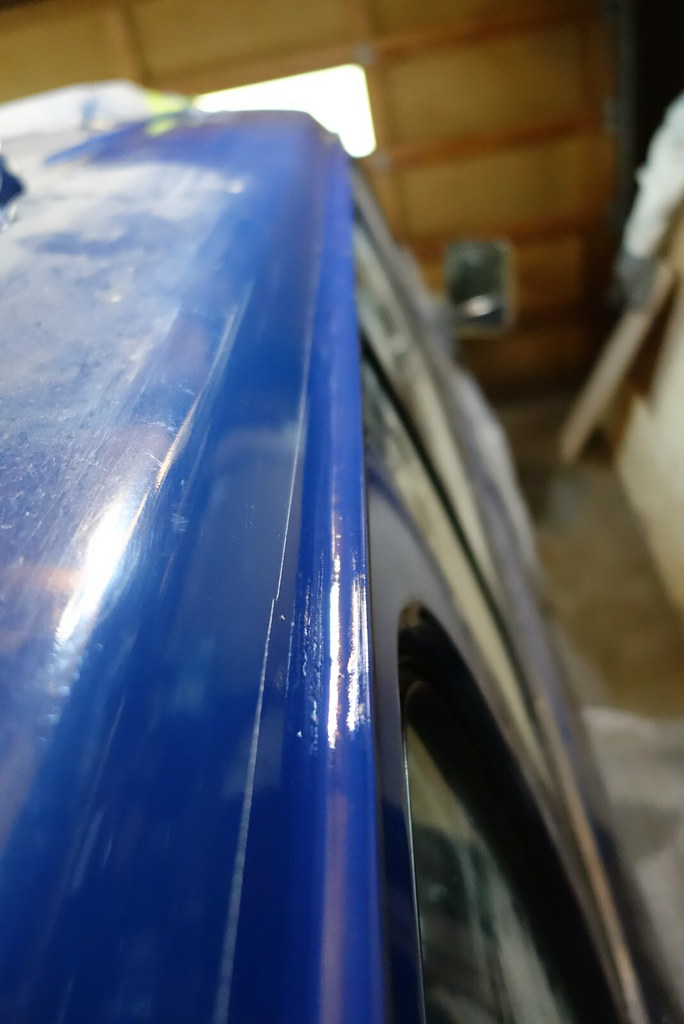

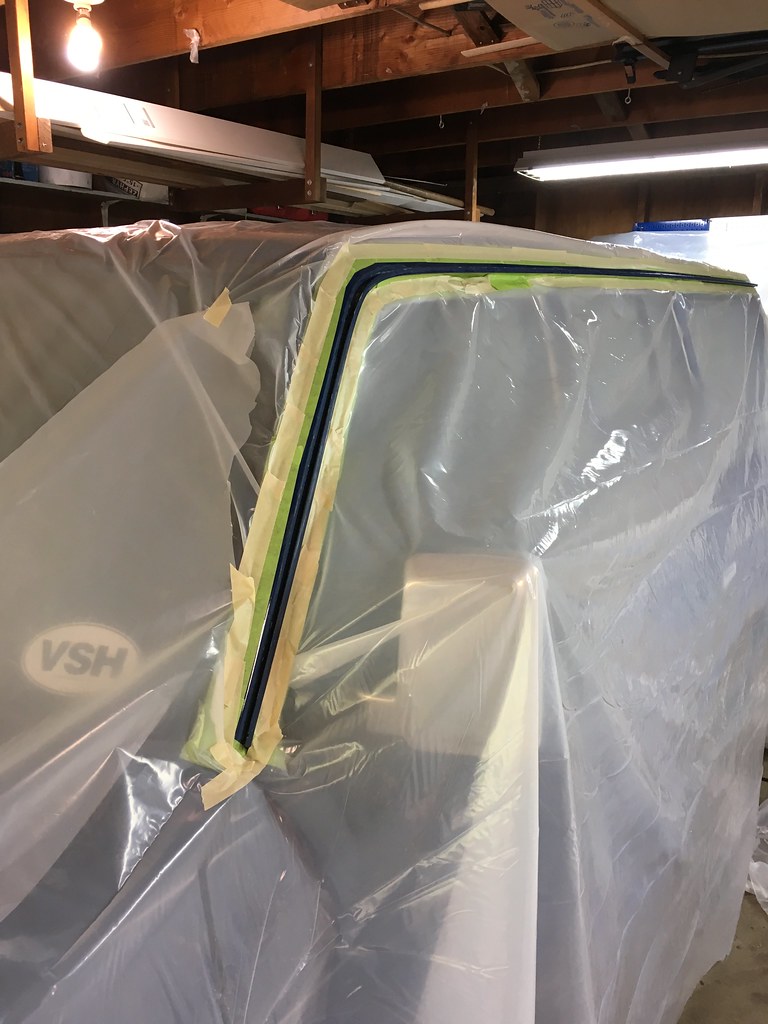

Resealed the gutters:
Then proceeded to test them out with an amazing new roof rack from Trail Tailor @reevesci

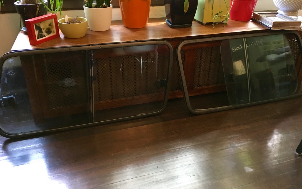

Currently teaming up with @NookShneer and @Rob Faucett to refurbish some sliding cargo windows for our 60s. Almost done and more to come on that later!

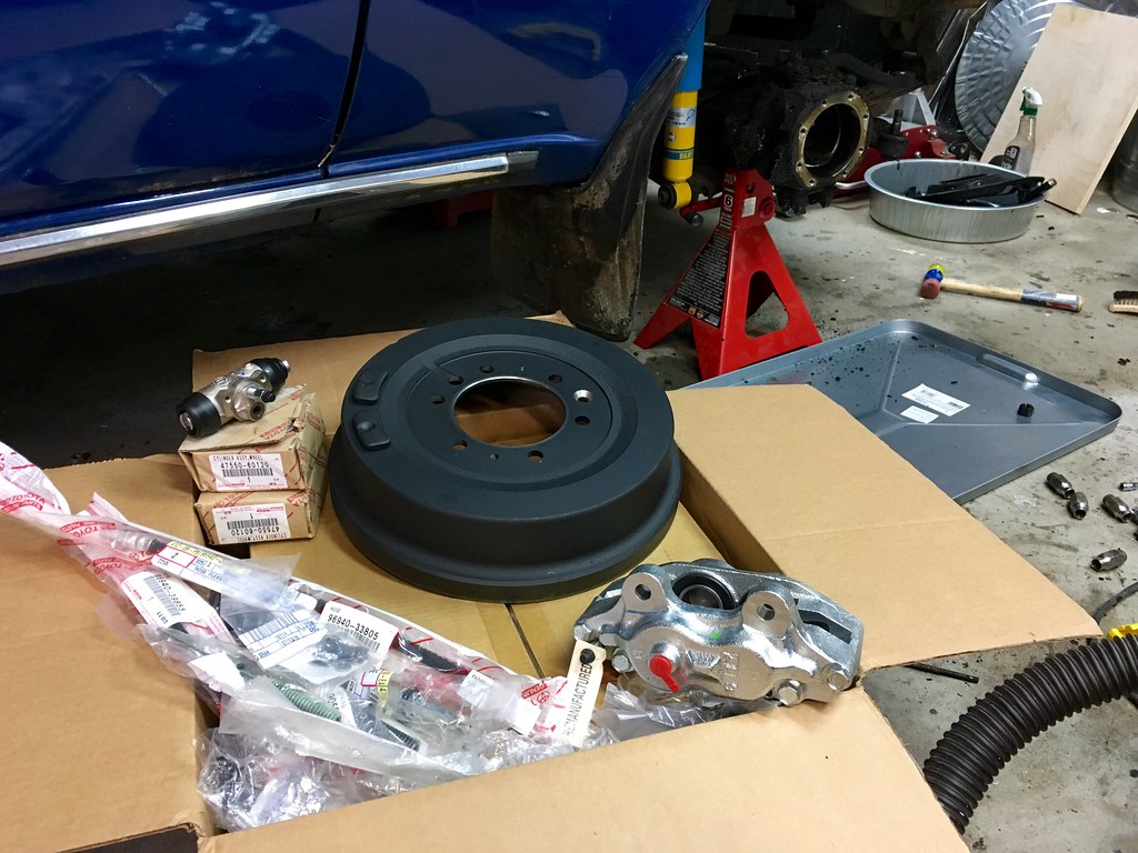

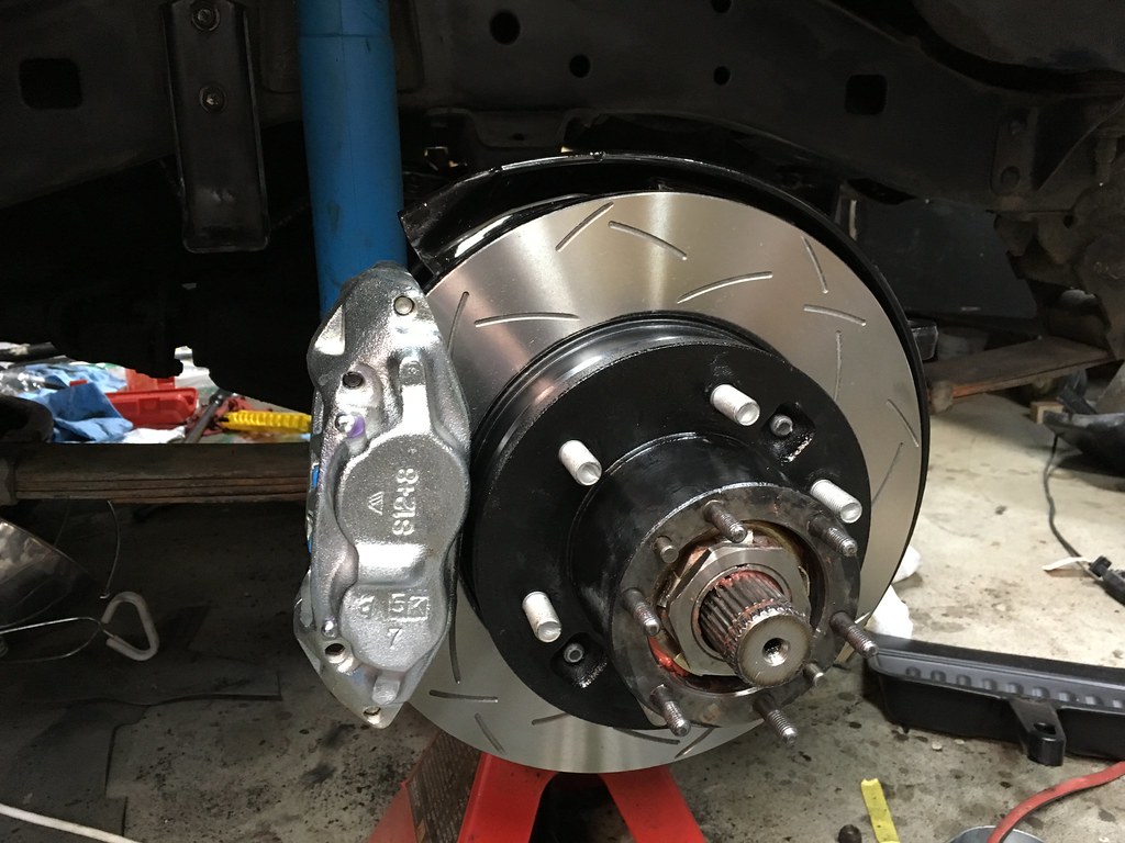

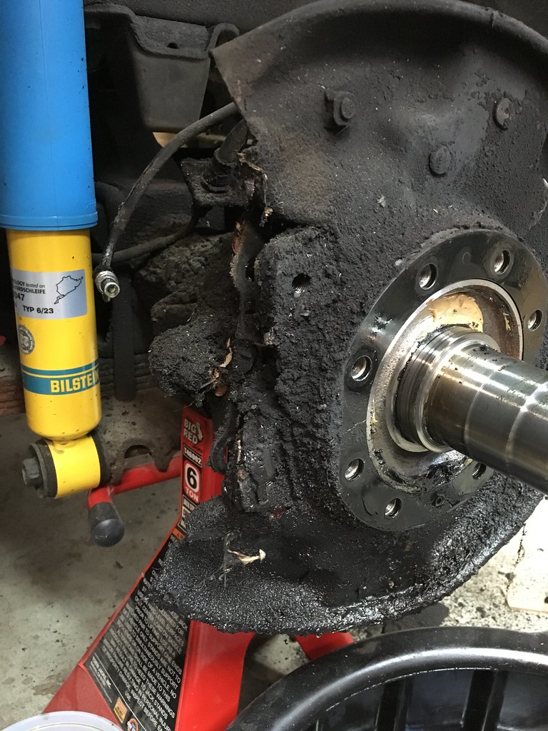

One of the big projects that is almost done was first completing the dreaded knuckle job which evolved into also redoing the steering and brake system:
Before:
All new brake parts from Onur:
After:

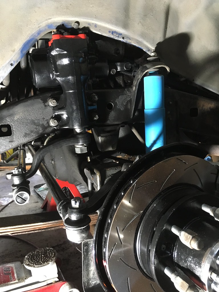

I used DBA rotors with OEM brake pads

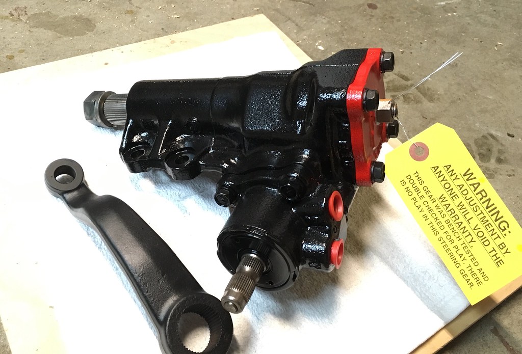

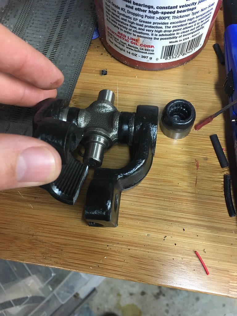

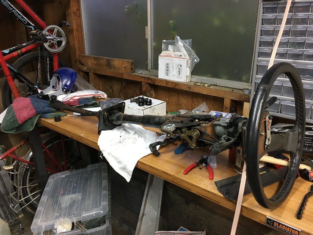

Had the steering box rebuilt and added new tie rod ends as well as replacing the u-joints in the steering shaft:
Learned the hard way about how to properly install a new U-joint in the steering shaft:
Box:
Installed:

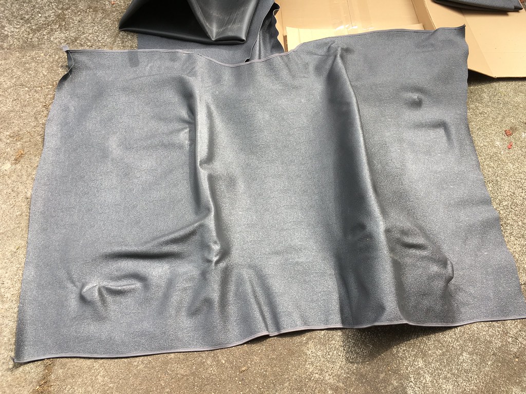

Plans for the interior after the rig is painted are to rip apart the dash and completely redo the HVAC system, install seat heat wiring formally, refresh tired window motors with new units (FJ62 Power window motors need replacing. Can I use ones from an old 4runner or will they not work?) install new vinyl flooring from Trail Tailor if it ever gets hot enough in Seattle:

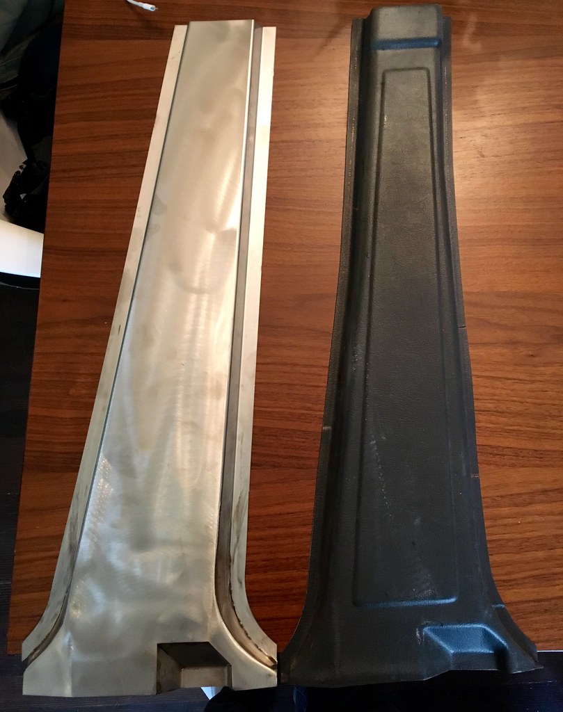

Which will coincide with new b-pillar covers also from Trail Tailor:

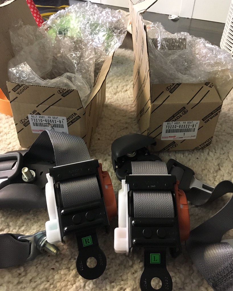

New 70 series Seat belts up front and new belts in the back:
New seatbelt alternative using 79-series belts

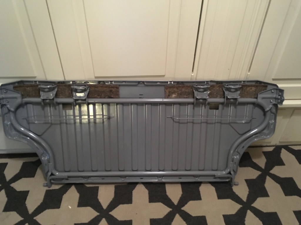

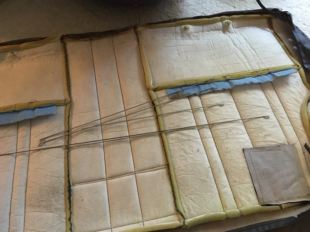

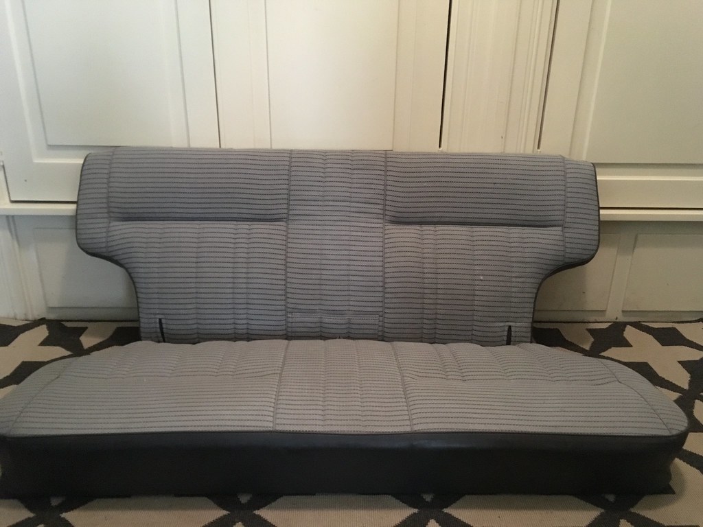

I refurbished the rear bench seat to get rid of the funk smell:

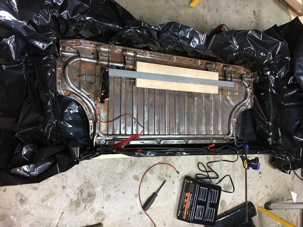

Electrolysis bath for the frame!
Painted:

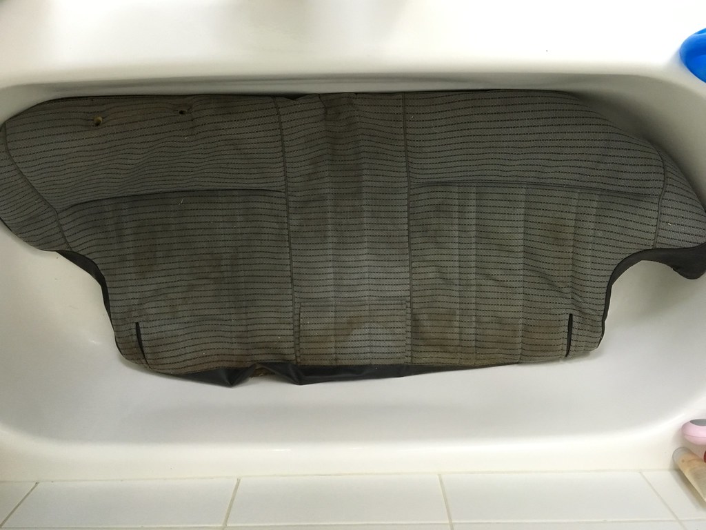

Cushions were soaked in the tub for a day with Oxyclean and then sun dried for several days.
New stainless form rods:
Both back and bottom cleaned and reassembled:

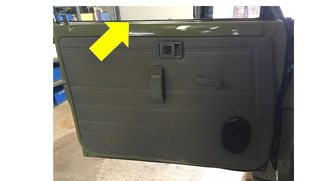

plans for the doors are to mimic this look using modified door cards and wipers from a 75 series. I love the more utilitarian look and exposed paint:
Wipers:

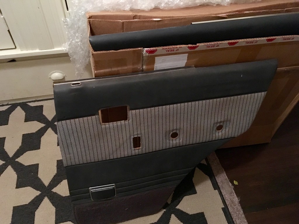

Extra set of door cards waiting to be modified. Going to basically chop the tops off and keep the rest looking stock:
