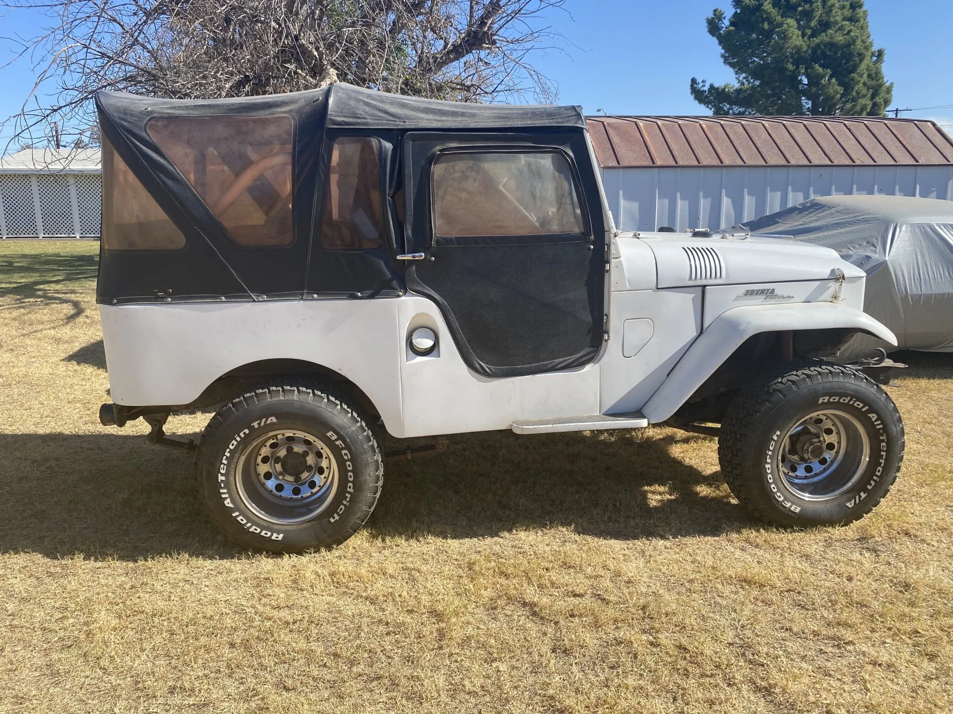

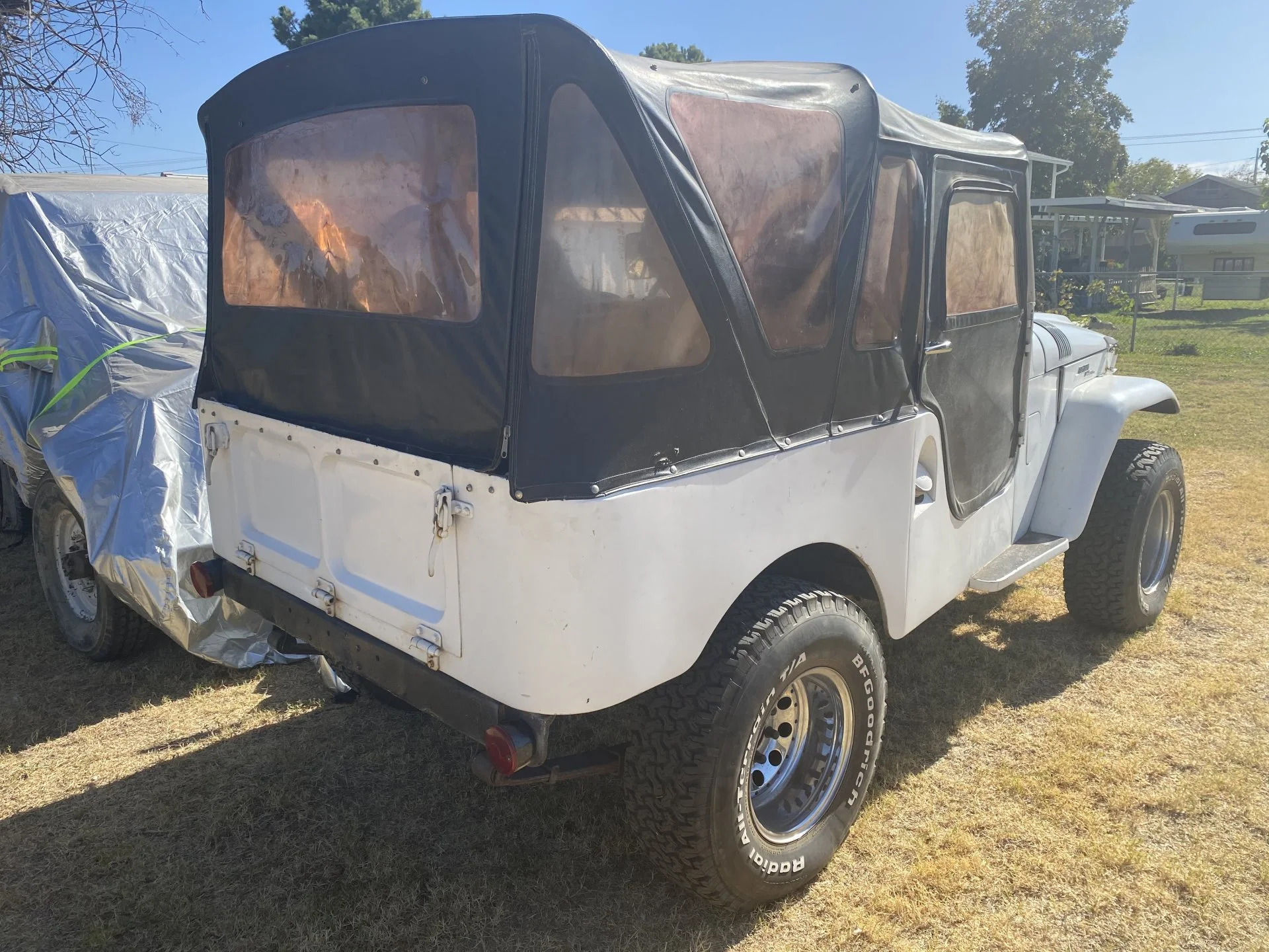

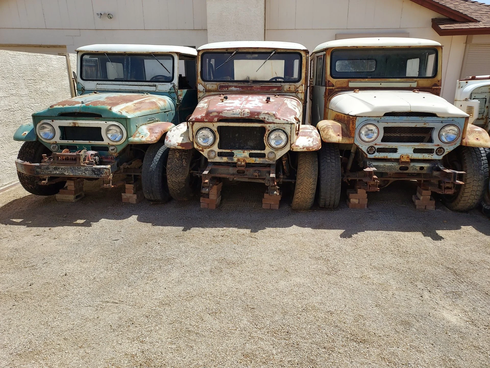

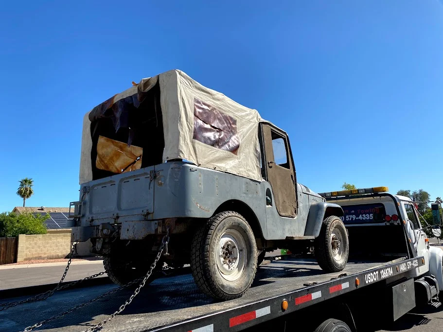

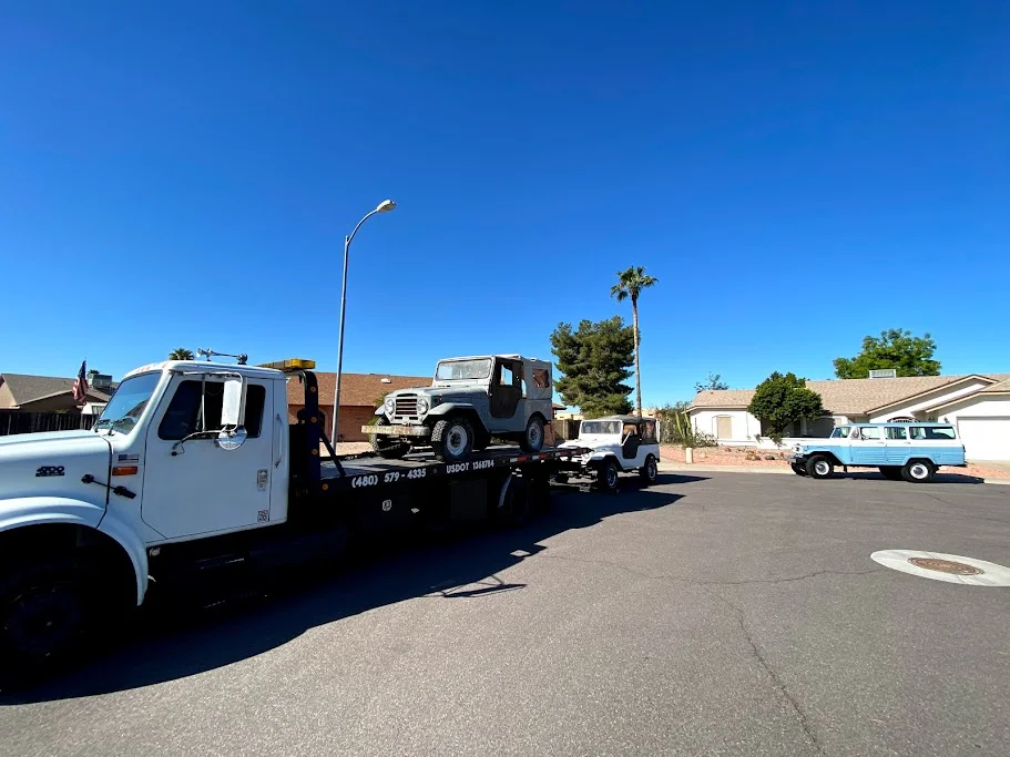

I bought John aka @Living in the Past pair of 1960 FJ25's shortly after I bought the FJ28 "Project Lara" truck a couple of years ago. Thought process at the time was that if I needed 20 series parts this was my best bet vs the painful search for individual parts. However, both trucks are so complete I haven't been able to bring myself to take a single part out of either of them so they've just been sitting. Over time I've also been able to secure most everything I think I need for the 28, and with that project taking the incredibly slow path to restoration I decided last week to get started getting these two back on the road, one at a time. Finally got a better garage space which makes all the difference. My kids are getting a little bigger (4 and 7 now) and like to help daddy in the garage too, so this will likely be a slow process but thankfully neither of the trucks needs the insane amount of body work the 28 needs so I'll just work on them as I have time over the next few years. Also have a retired friend that likes to stay busy and wants to help me out.
Photos from when I picked them up from John a couple years back before putting them in storage.

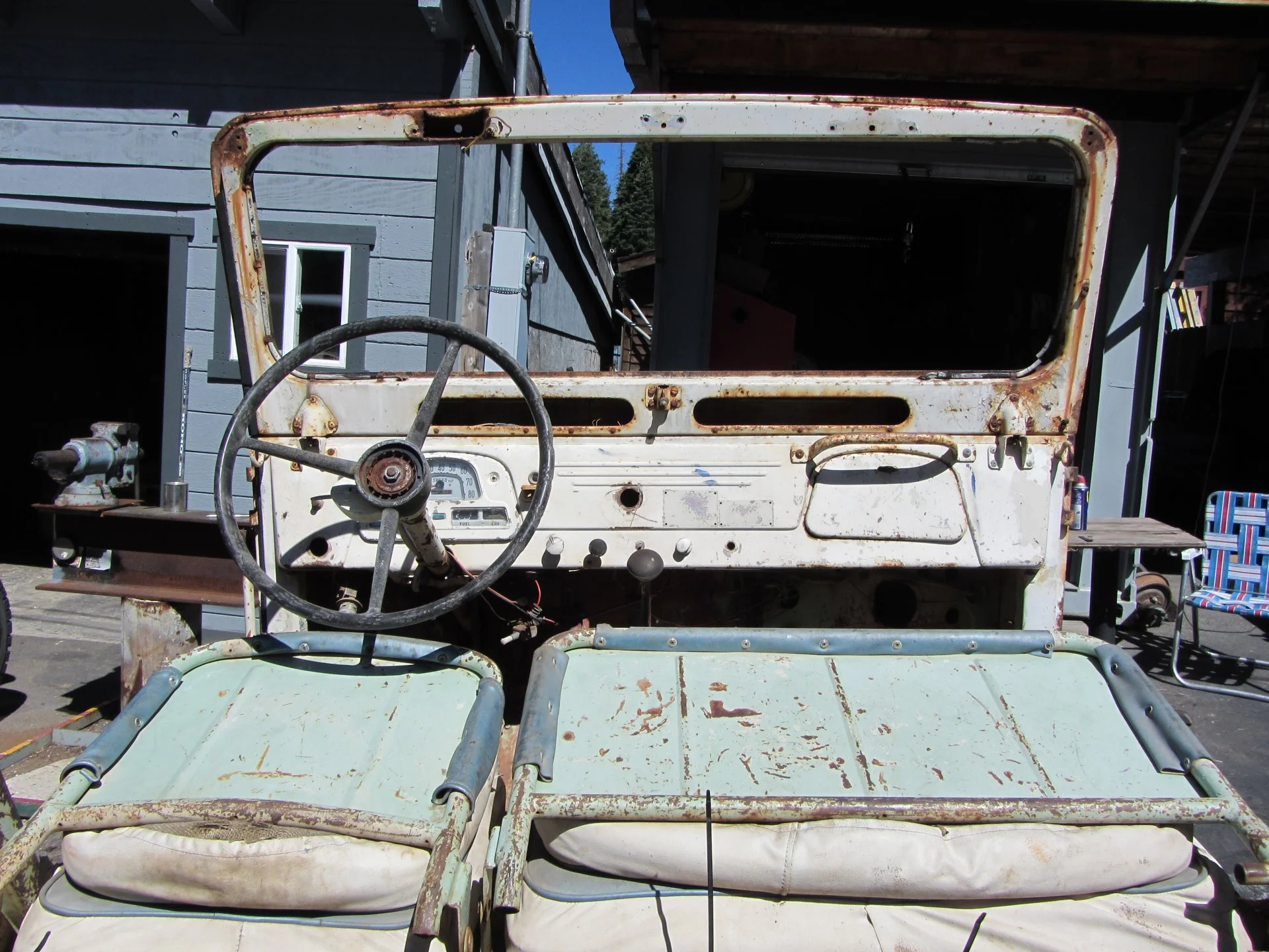

Body-wise Ivory is in far better condition, virtually zero rust the only issue being some big dents in the rear floor from a massive DIY rear bench that used to be in there. I'll have to fill those holes and try to get that all straightened out. Ebony has a lot of rust in the floors, and I will probably have the body guy currently working on the 28 make me new floors for that one when he finally finishes the 28 (who knows when that will be!)
Only Ebony has the original seating and FST bows. Not sure if I'll just make due with some 40 series seats for Ivory or if I'll try to find somebody to replicate the originals from Ebony.
Mechanically both are very complete, original drivetrains and don't really seem to be missing anything major. Both turn freely, but neither has run in many years.

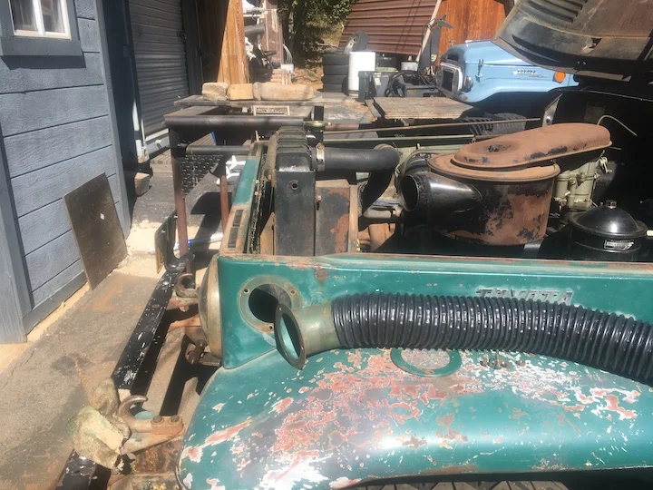

Photos of the engine bay for both. Ivory actually has a factory PTO, but I will probably put that into the 28 and swap the trans humps.

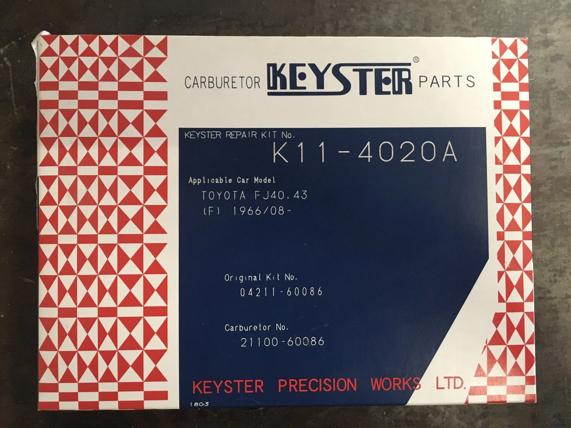

I am starting on Ivory first. This morning I drained the gas tank and put in a new battery. Working on reconnecting everything today to try to see if she will fire up. It has the original SD40, and rather than rebuild that I'm just going to swap in the SD40 I pulled out of my 45LV when I put the sniper kit in it. But I do probably need to get a couple of carbs rebuilt at some point since I'm just borrowing from one truck to the other. I don't see any rebuild kits anywhere though, if any of you know where to get them let me know.

I picked up kits from cruiserteq but dang looks like they’re out of stock
Maybe?
or?
I think the the kit is 04211-60086 for carb 21100-60086. I think. 😆

If you need a kit seems I bought one of the last non-solenoid kits from Cruiserteq.
However, if yours has a solenoid and you want a new unopened kit for free (bought the wrong one a year or so ago) I'd be happy to contribute. Only issue is it's in Africa and you'd have to ship from here.
Maybe I’ll reach out to them and see if they know where to find some more. Thanks for the heads up!

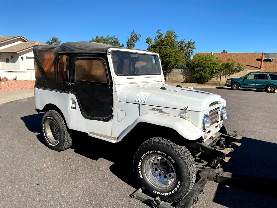

She’s alive!! Replaced the old delco fuel pump with the Kyosan hand primer pump, new fuel filter, battery and with surprisingly little effort (banged on the starter to wake it up for now) she fired right up. Going to replace the plugs & wires, and probably the distributor cap next. Looks like it’s got an auto zone dizzy, but @pardion found an OEM for me that's on the way.
In the meantime I’m going to take the seats from Ebony out and get them prepped for cushions and upholstery in the next few weeks. Those weird Recaro seats are pretty hideous. What have others done for cushions on these old seats? Any recommendations appreciated. Hopefully I can find the proper red colored vinyl too. How was the upholstery attached to the frames originally? Nothing left but frames right now so I can’t tell for sure…

The upholstery has extended flaps that screw into the frame.
