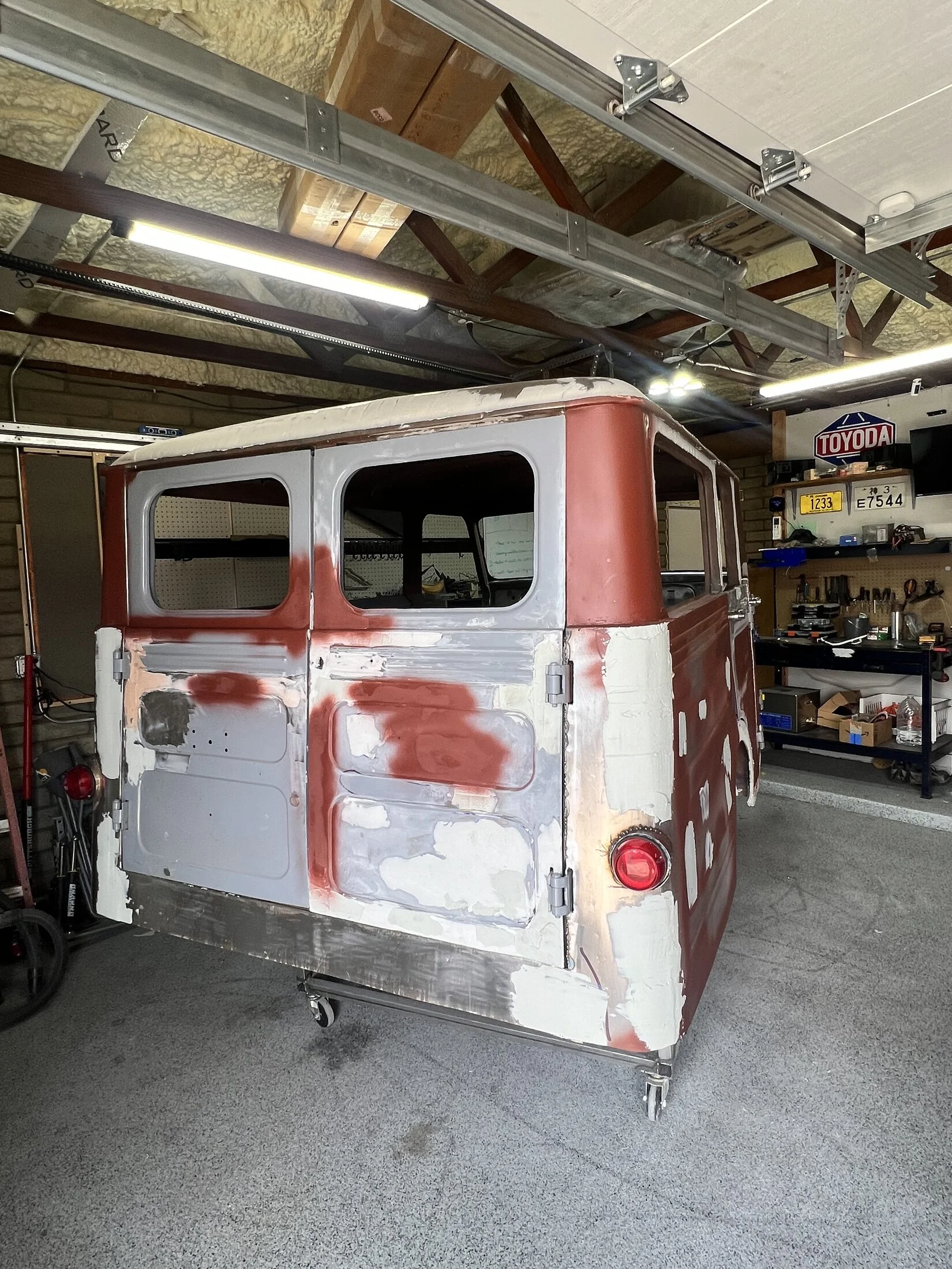

Quick teaser update - I have found someone willing to do the work at my garage, started recently and so far its going great. He's working quickly but doing great work. All fabrication is DONE! FINALLY! He has started doing the filler work prepping for paint. I will be visiting Phoenix on Friday to check on it and will try to start posting some photos next week. Some major hurdles now finally in the rearview. All the door hardware is there and working (thank you Gene @Land Cruiser Junky & Dan @crawlin cruiser !), I've seen the doors close and its a thing of beauty. If all goes well this project might actually finish this year! Feeling optimistic and grateful... stay tuned!

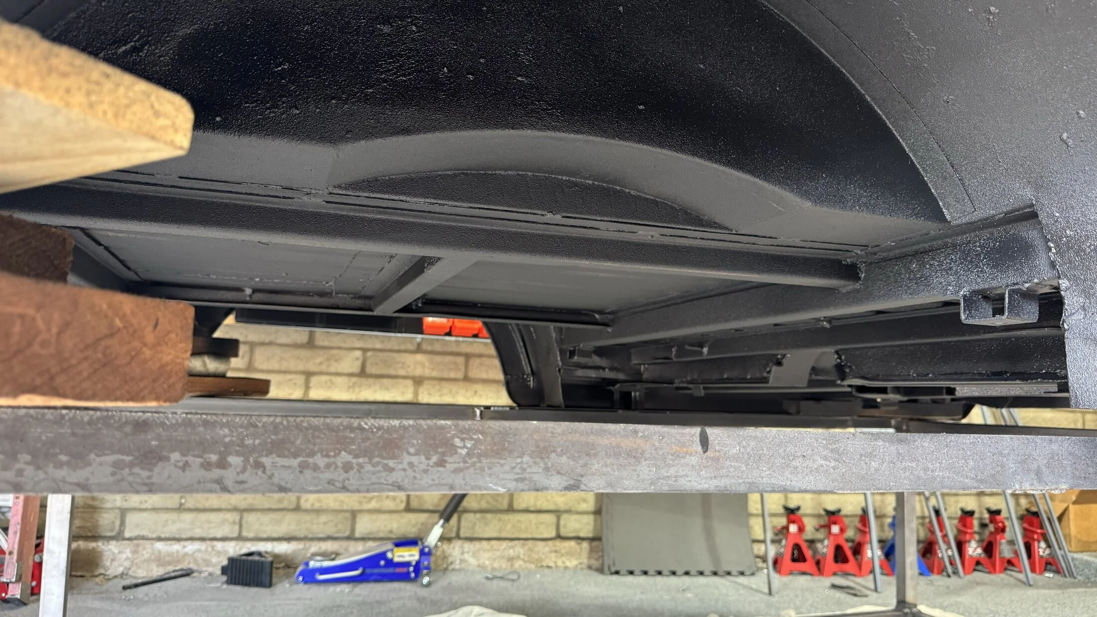

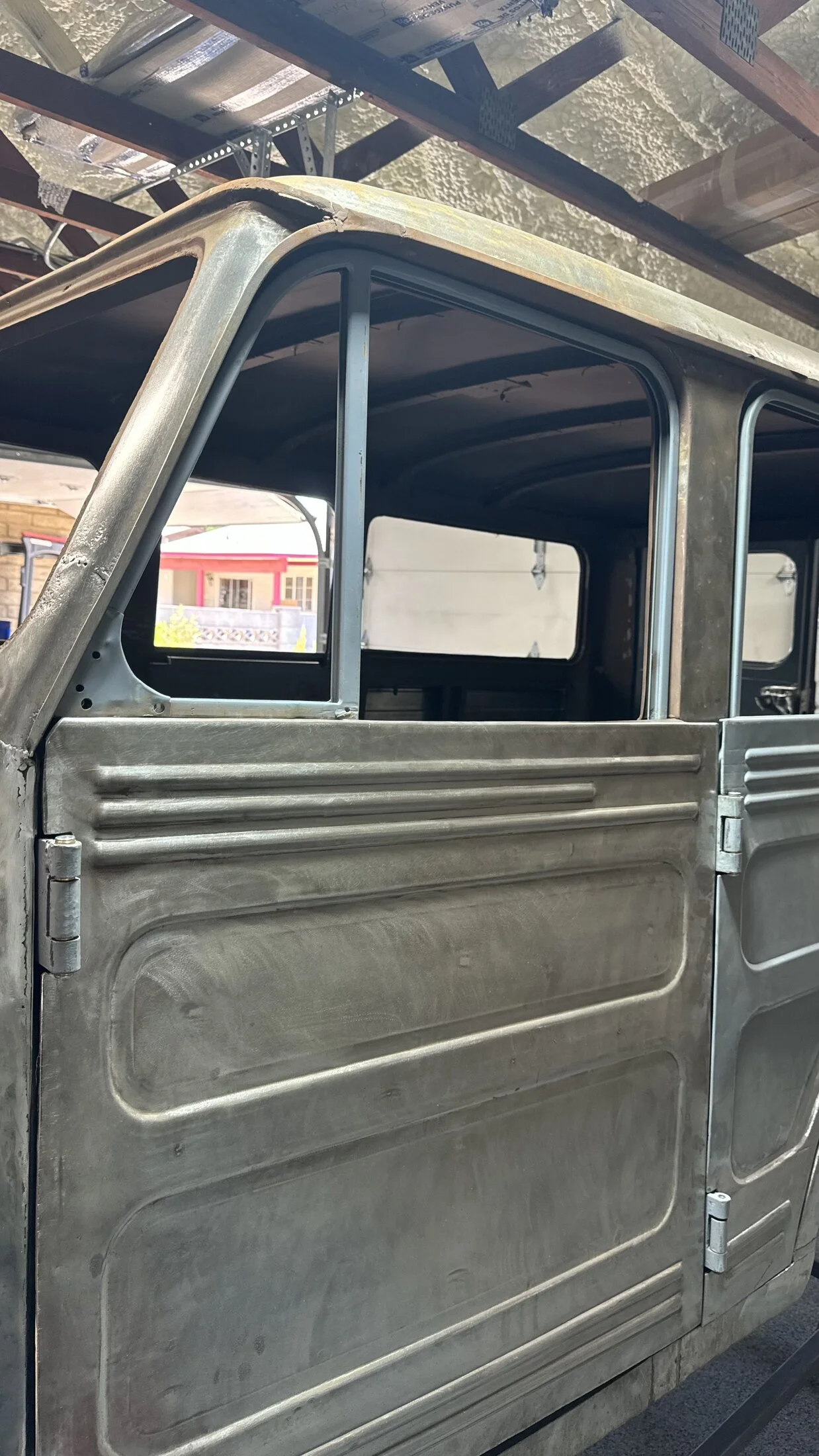

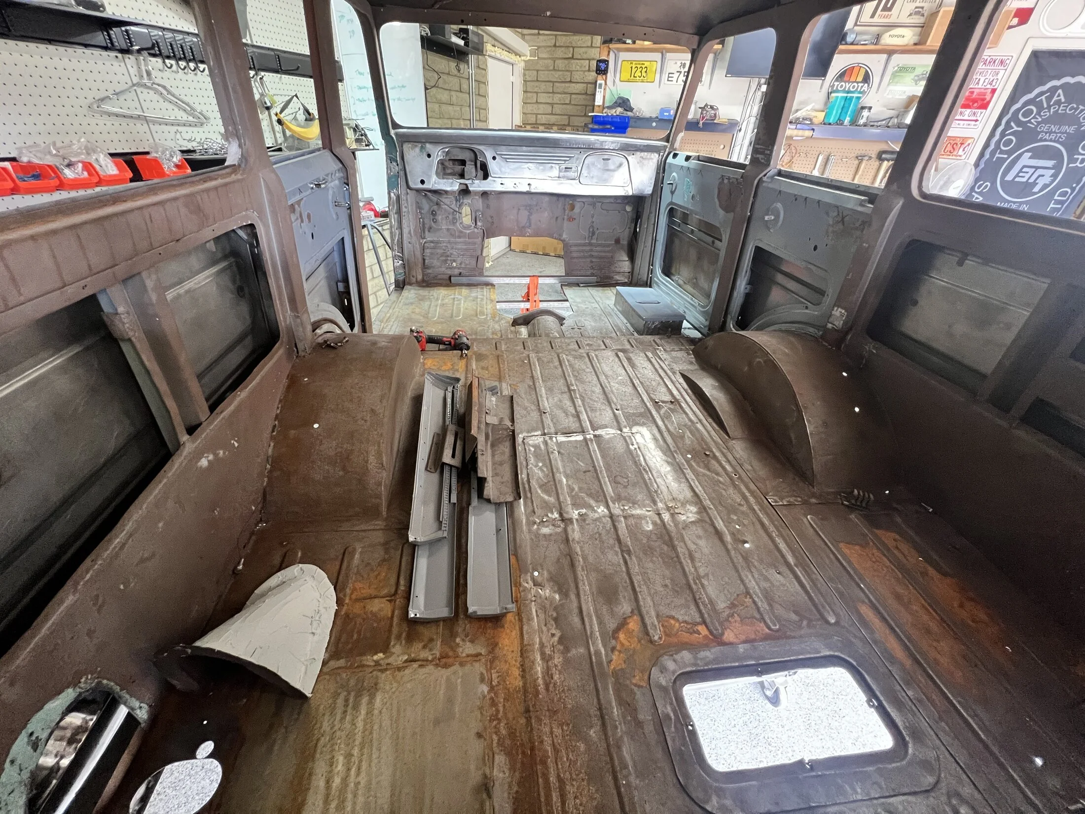

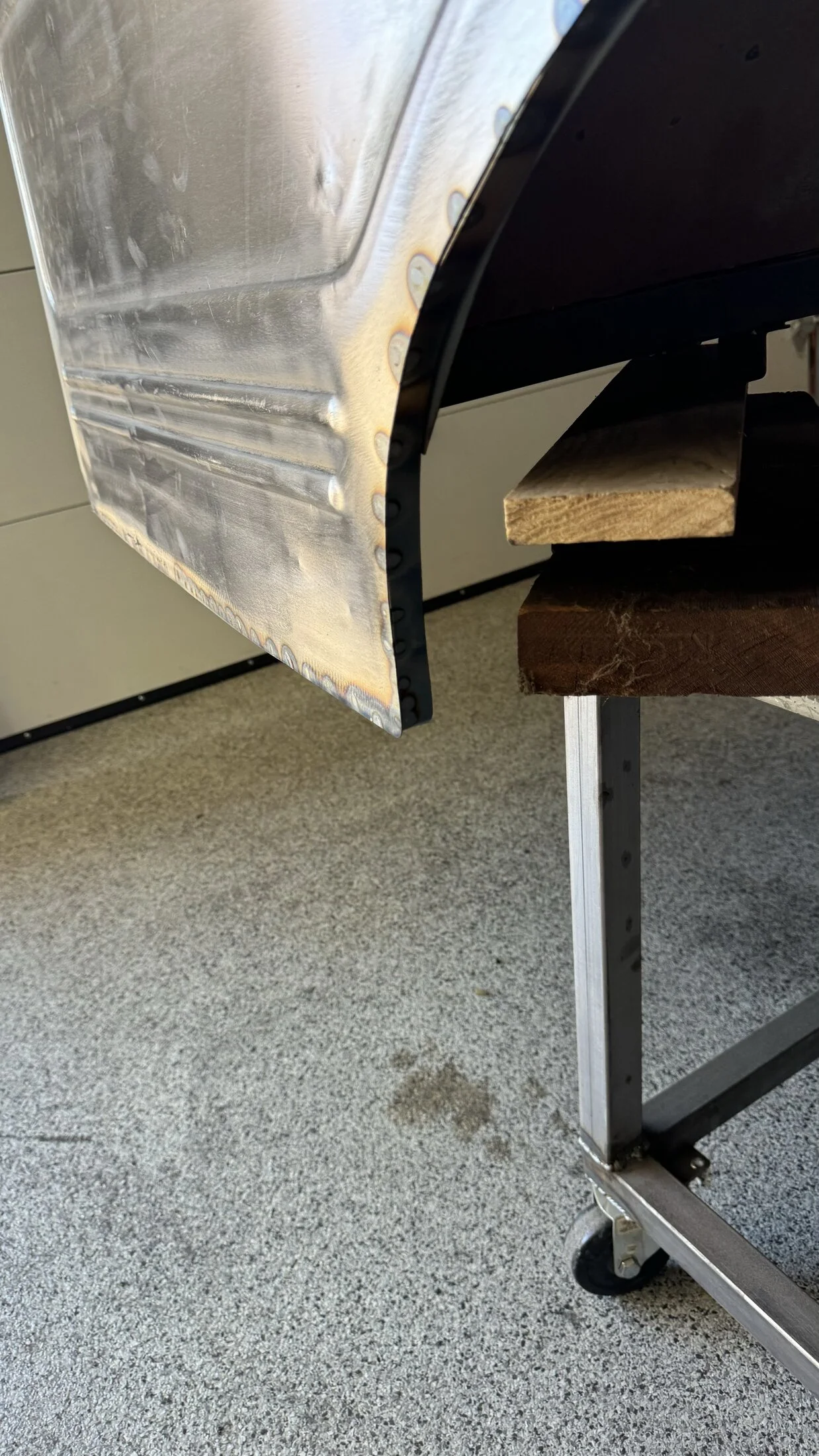

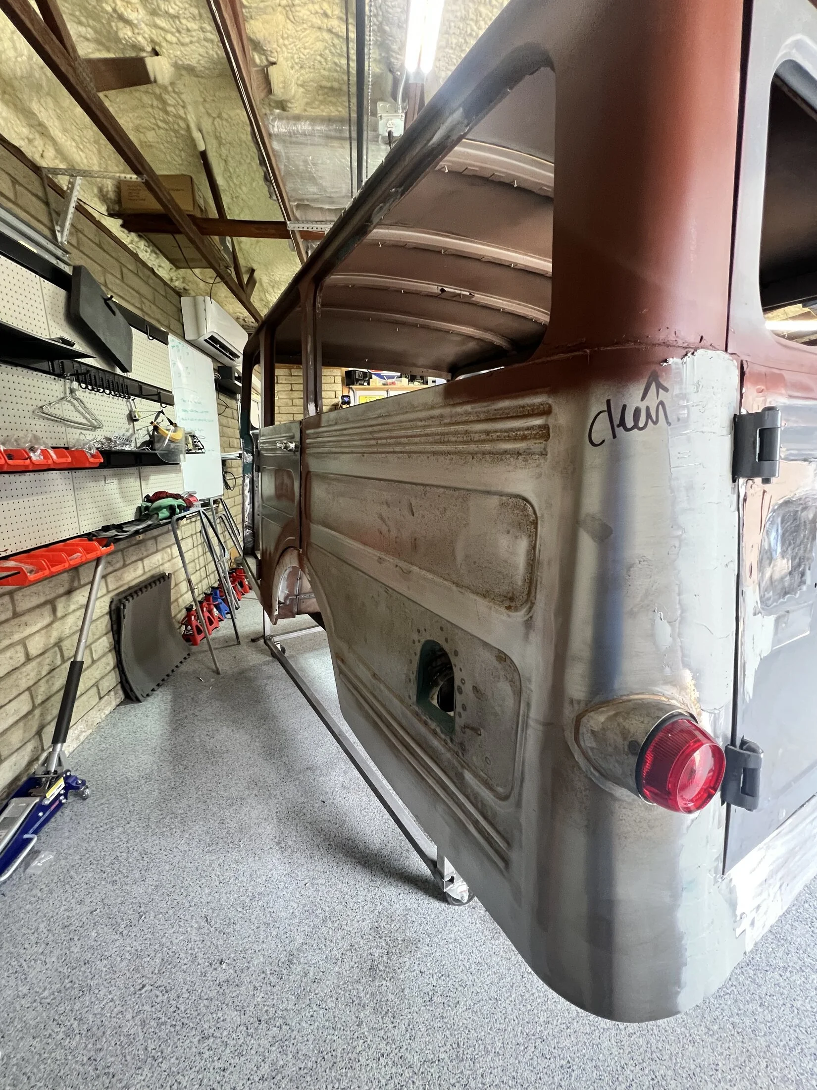

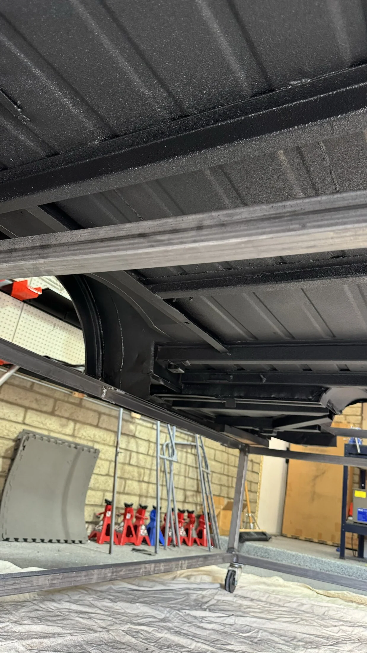

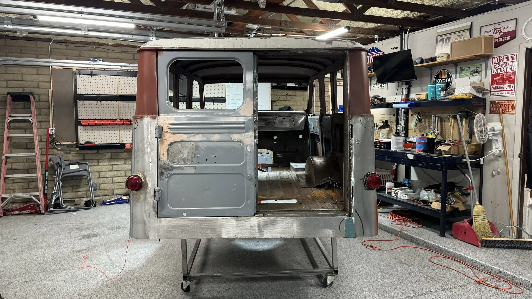

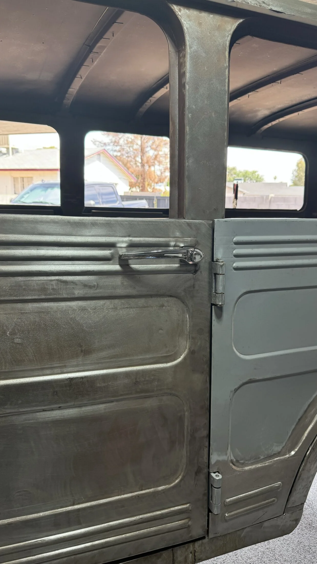

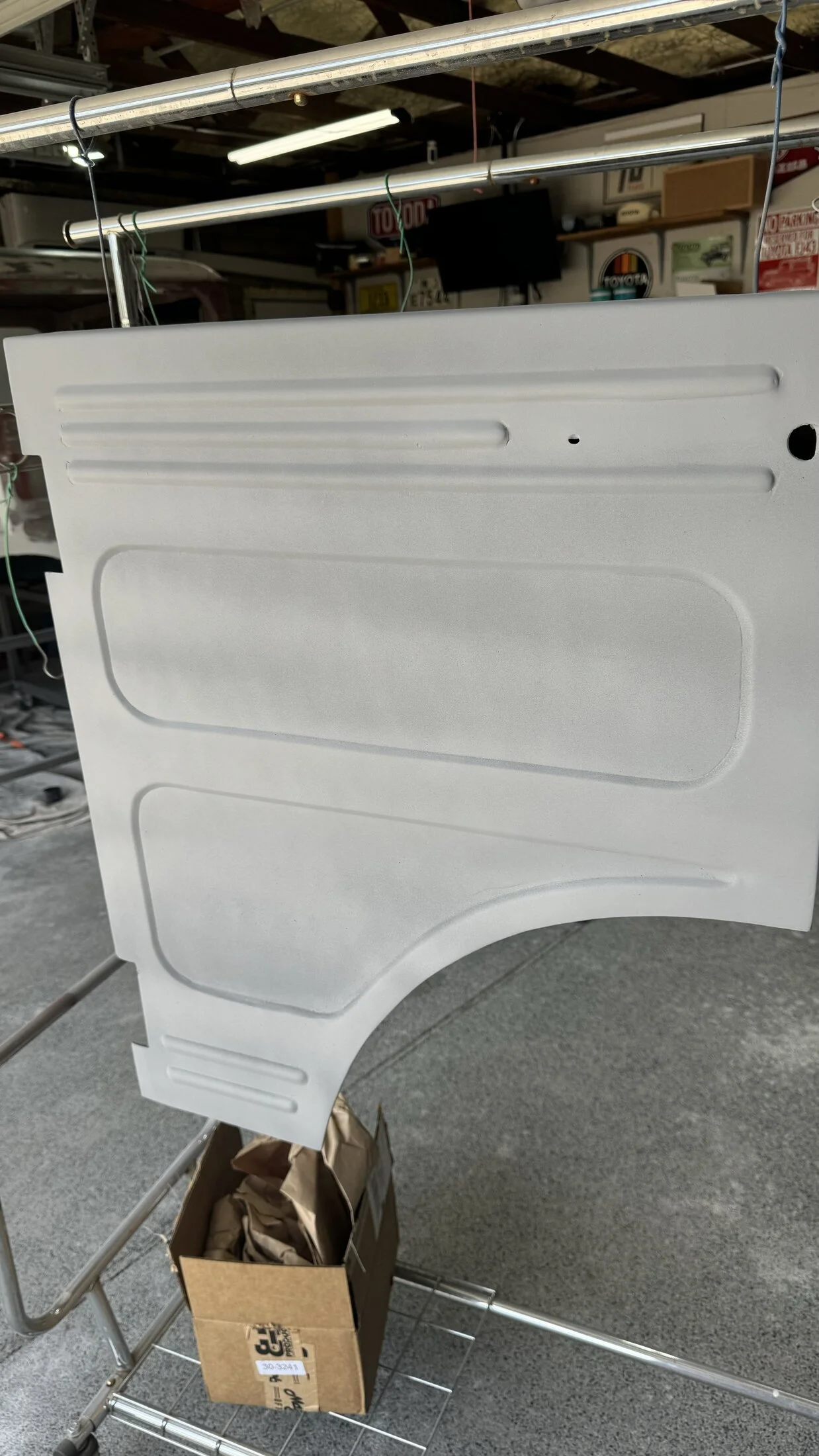

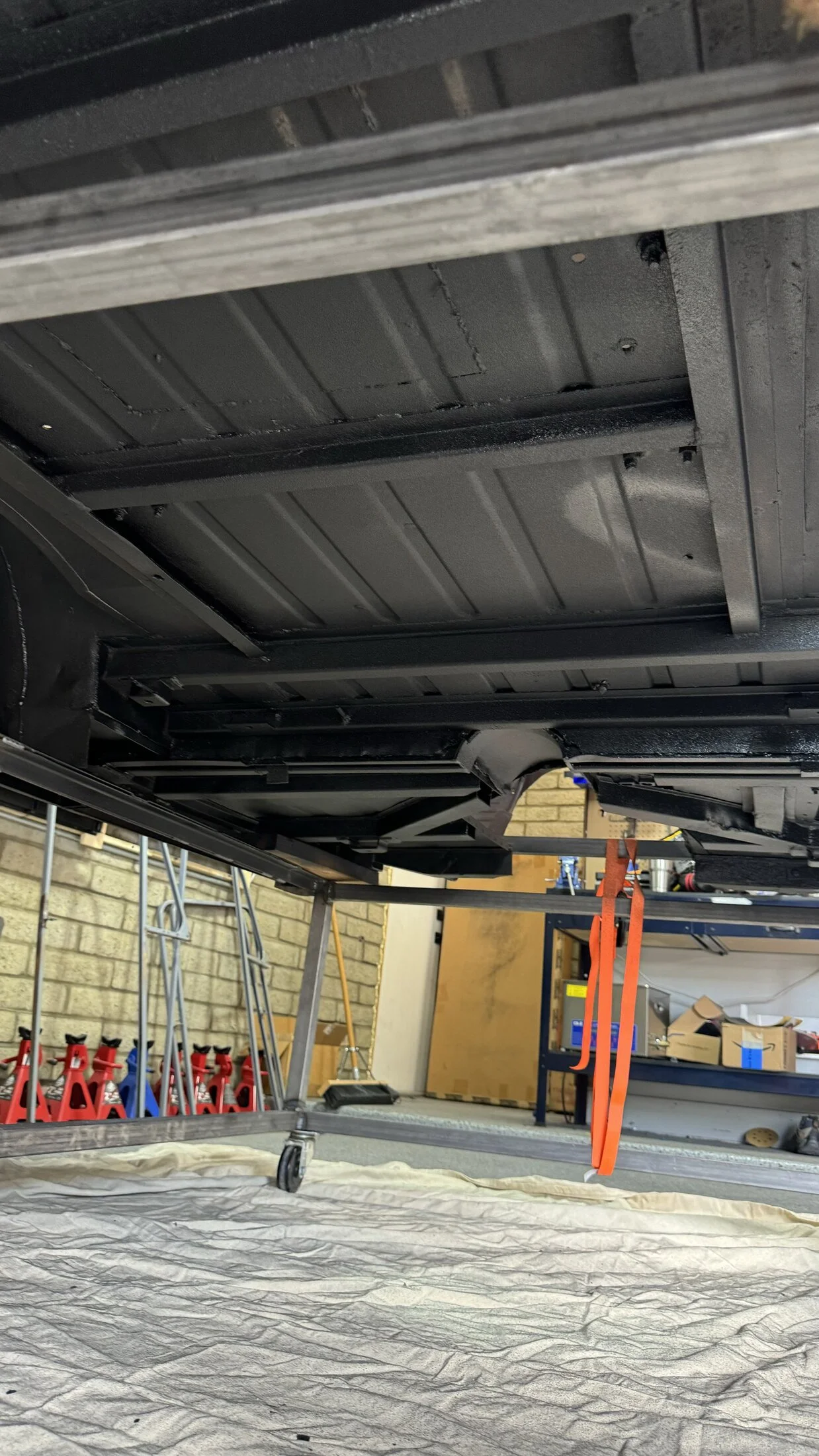

Great visit today checking out the progress in the heat here in Phoenix 🥵 don’t miss the summers! Starting to finally let myself get excited about this project again! I was geeking over it and chatting about it so much today I kinda forgot to take more photos to post, these are from a couple weeks ago. Doors are pretty straight now, close solid and spaced well. All lines on the sides line up. Prepping for paint now. All metal is solid. The rear floor isn’t going to be as perfect as I would have liked but decided being solid metal is good enough and it’s time to get this thing back together within a reasonable budget. Feel very blessed to finally have some momentum back. I’ll start to post more pictures as it gets through primer and hopefully onto paint in a couple months. I believe I also finally can confirm I have all the parts I need (hopefully!) to finish her! If I get moving early enough tomorrow I might swing back by and get some more current photos snapped.

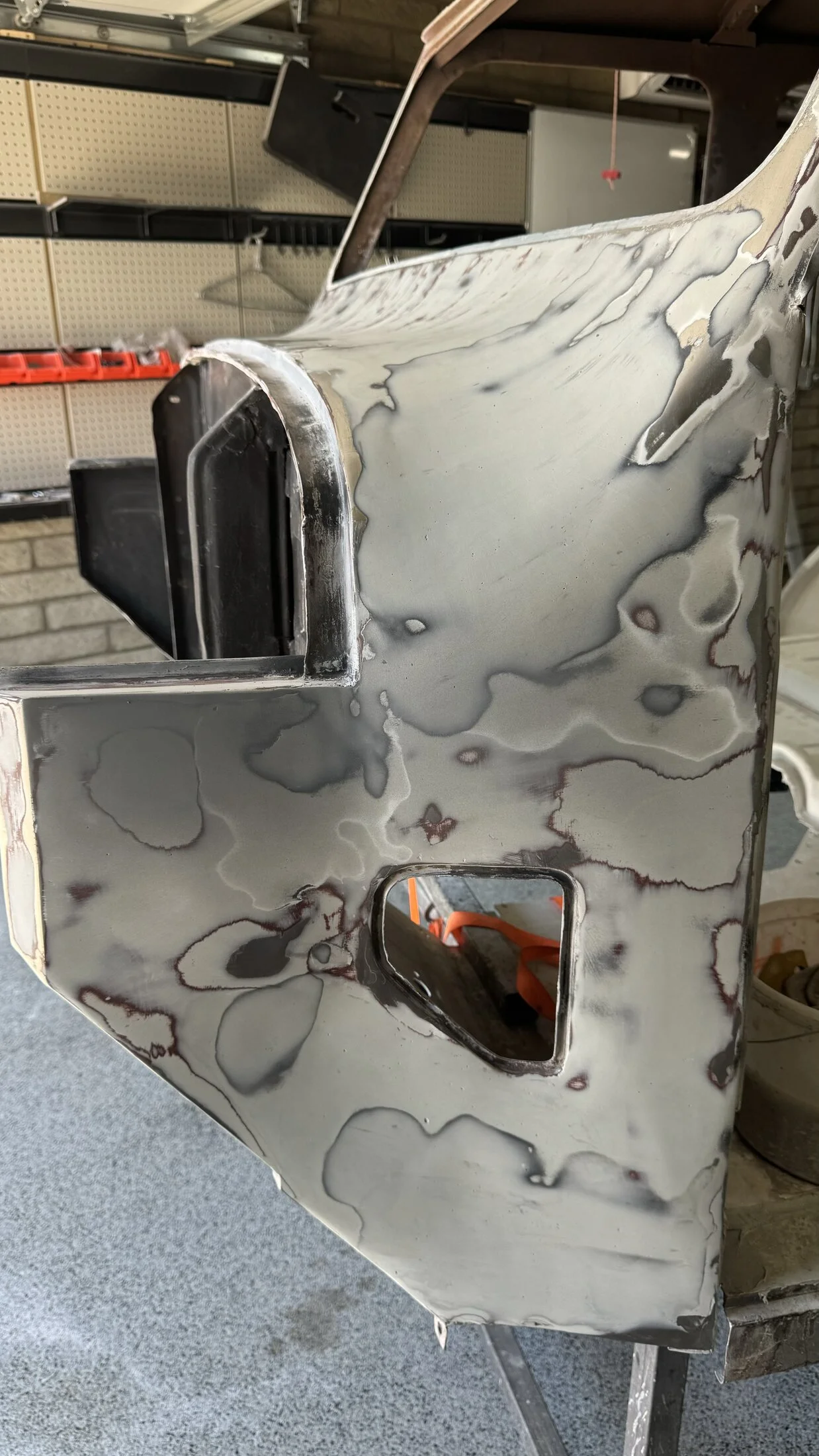

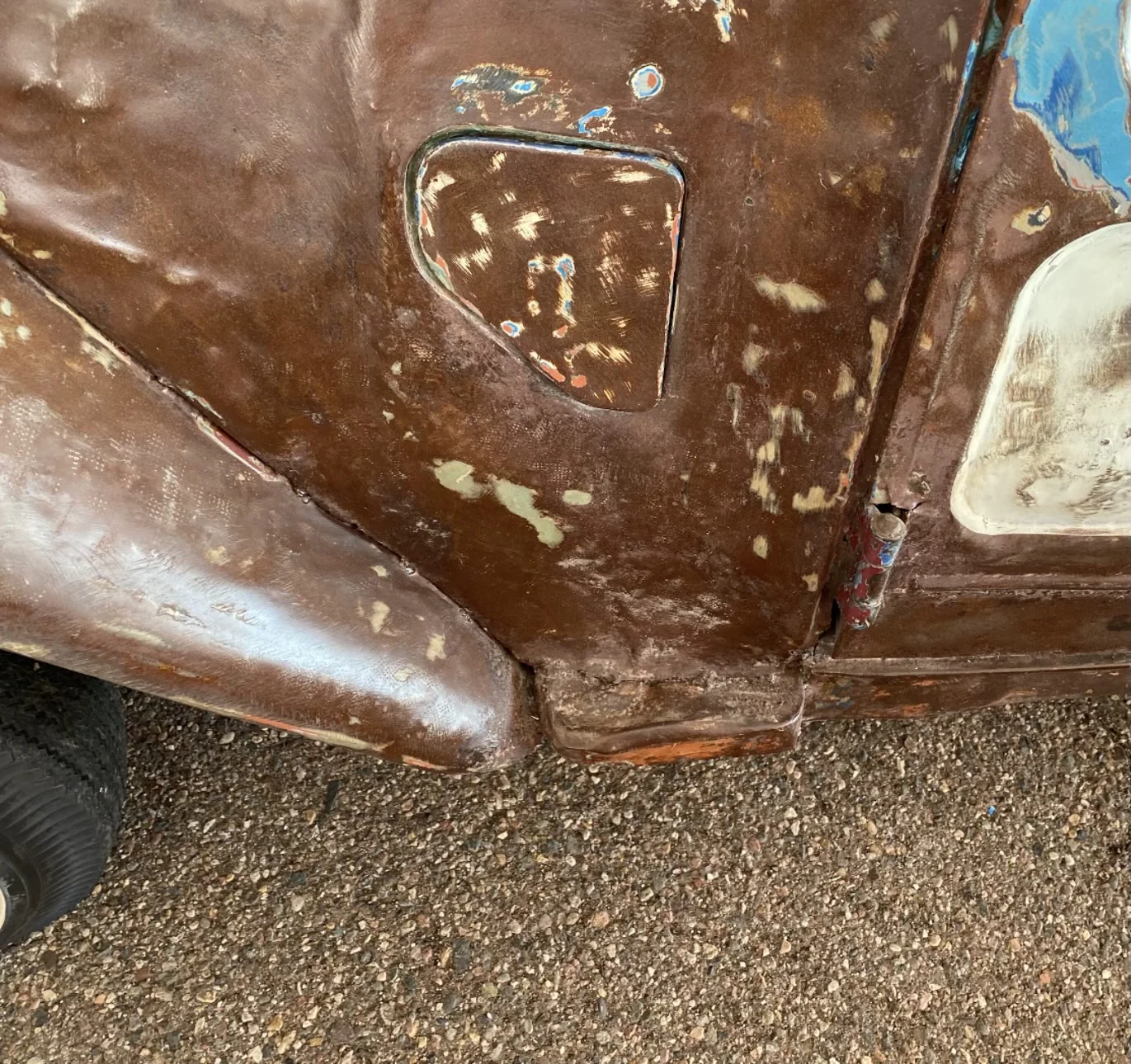

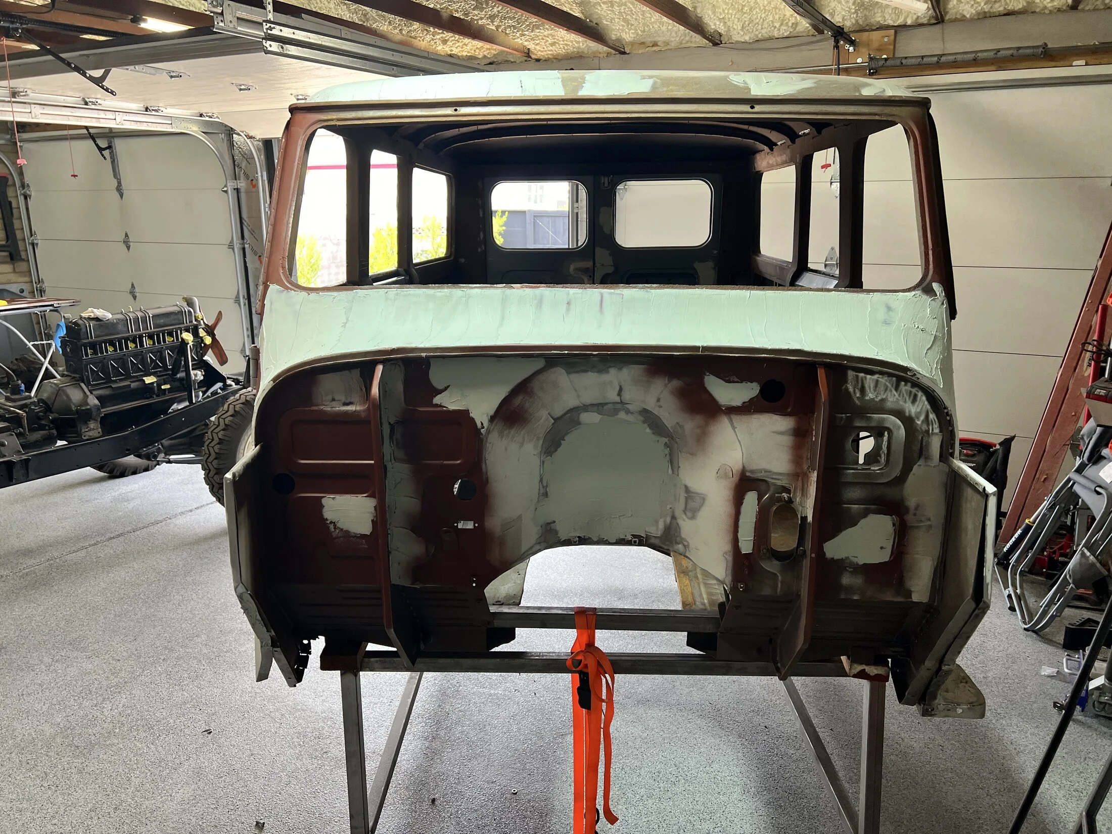

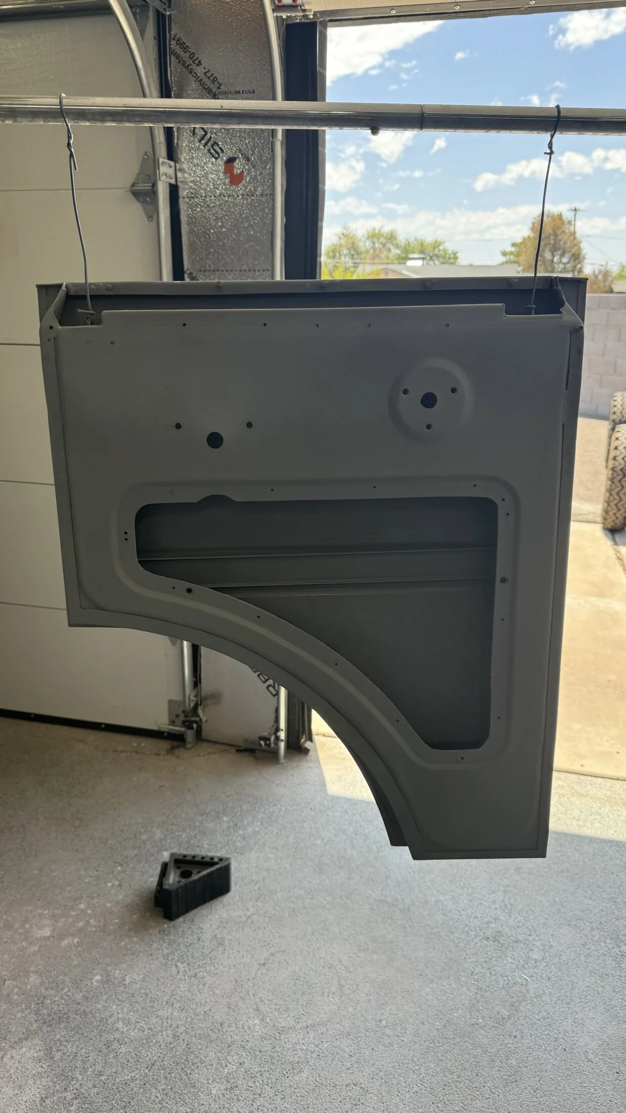

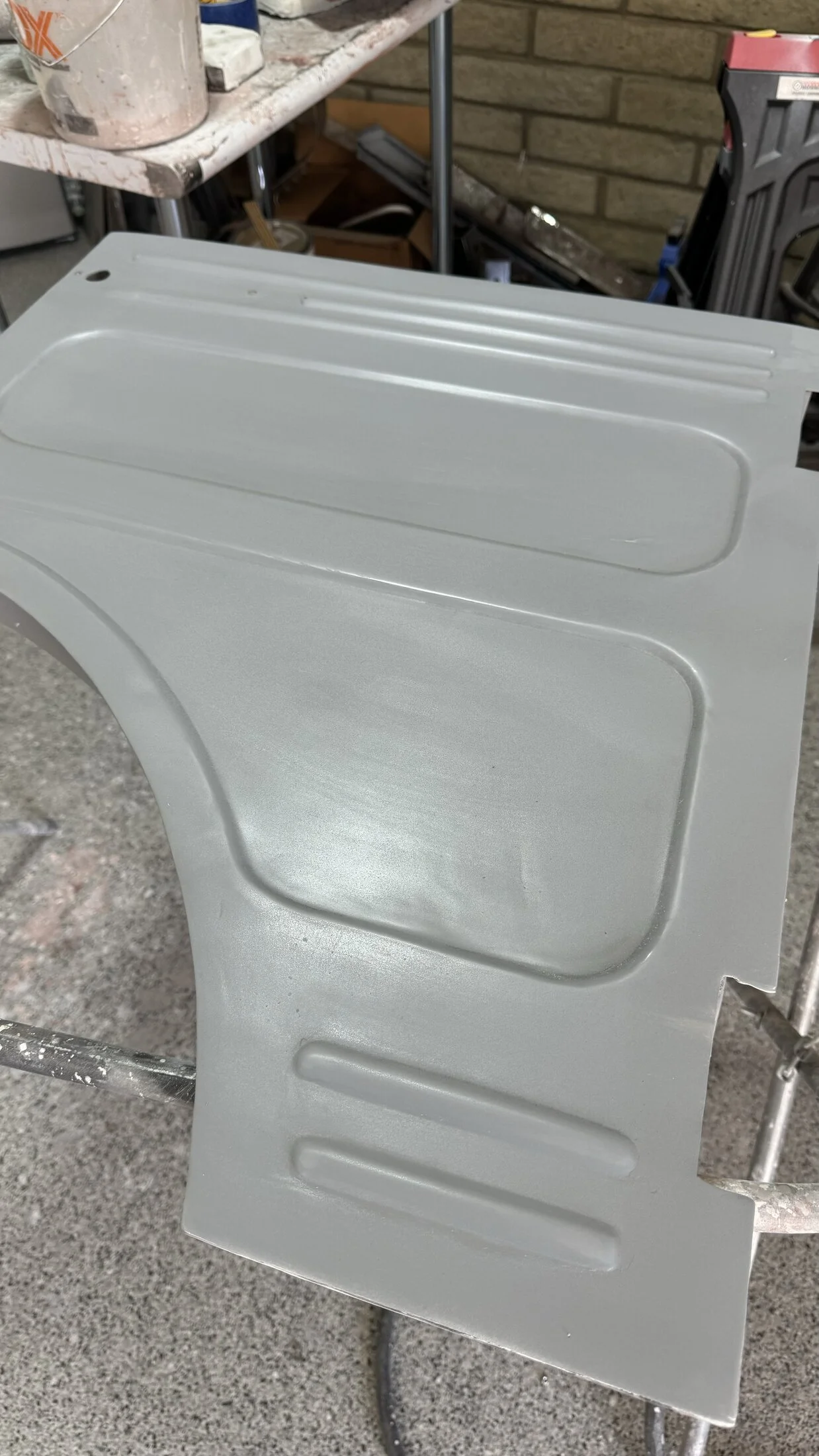

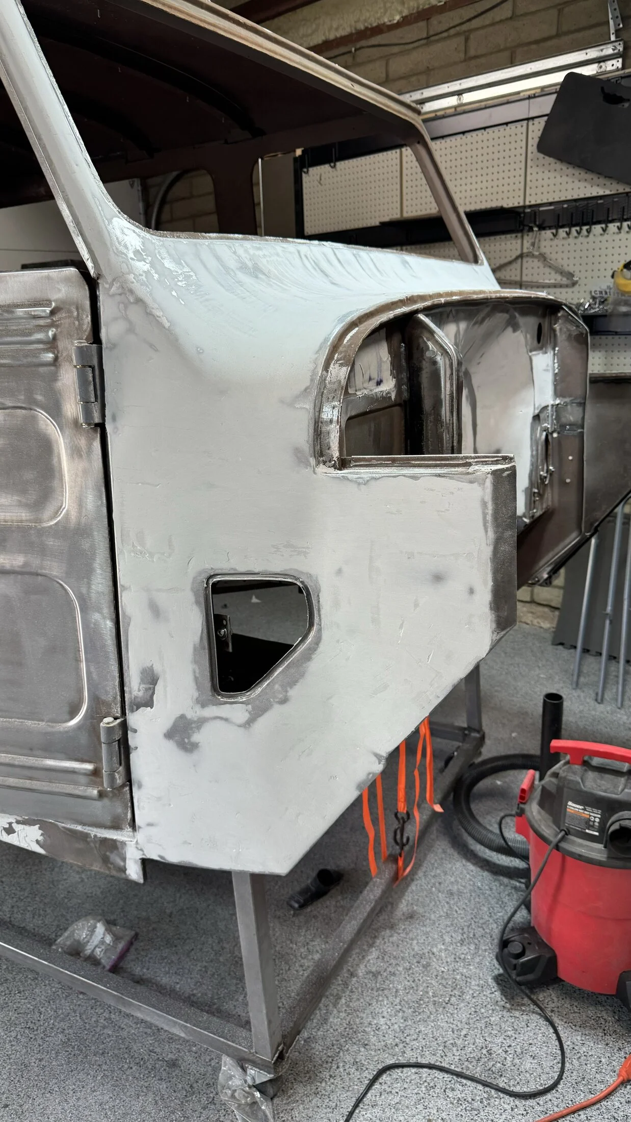

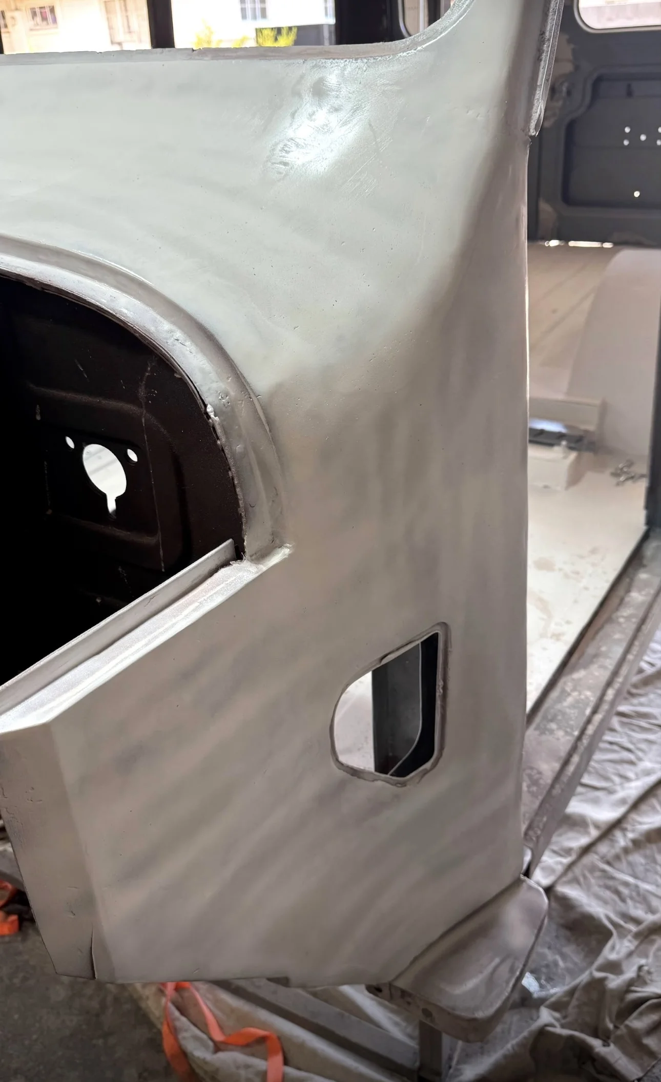

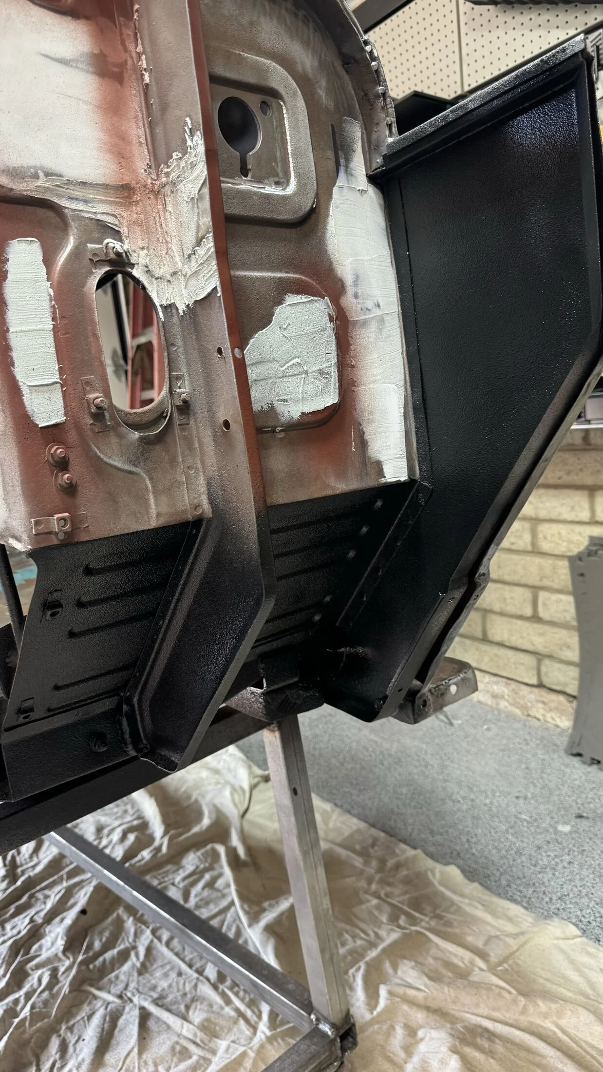

More body progress. It’s crazy to see how far it’s come, sometimes have to remind myself just how beat up this truck was. Every inch it seems has needed to be addressed. Some before and after photos of the drivers side cowl
Amazing resto work. Can’t imagine what caused original damage.
It seriously looked like kids used it for rock throwing games… every inch was beat up, and many of the body panels had been welded onto the frame. It’s come a long way! Still a ways to go but should be ready for paint fairly soon… need to find a good and reasonably priced paint shop in Phoenix if anyone has any leads…
