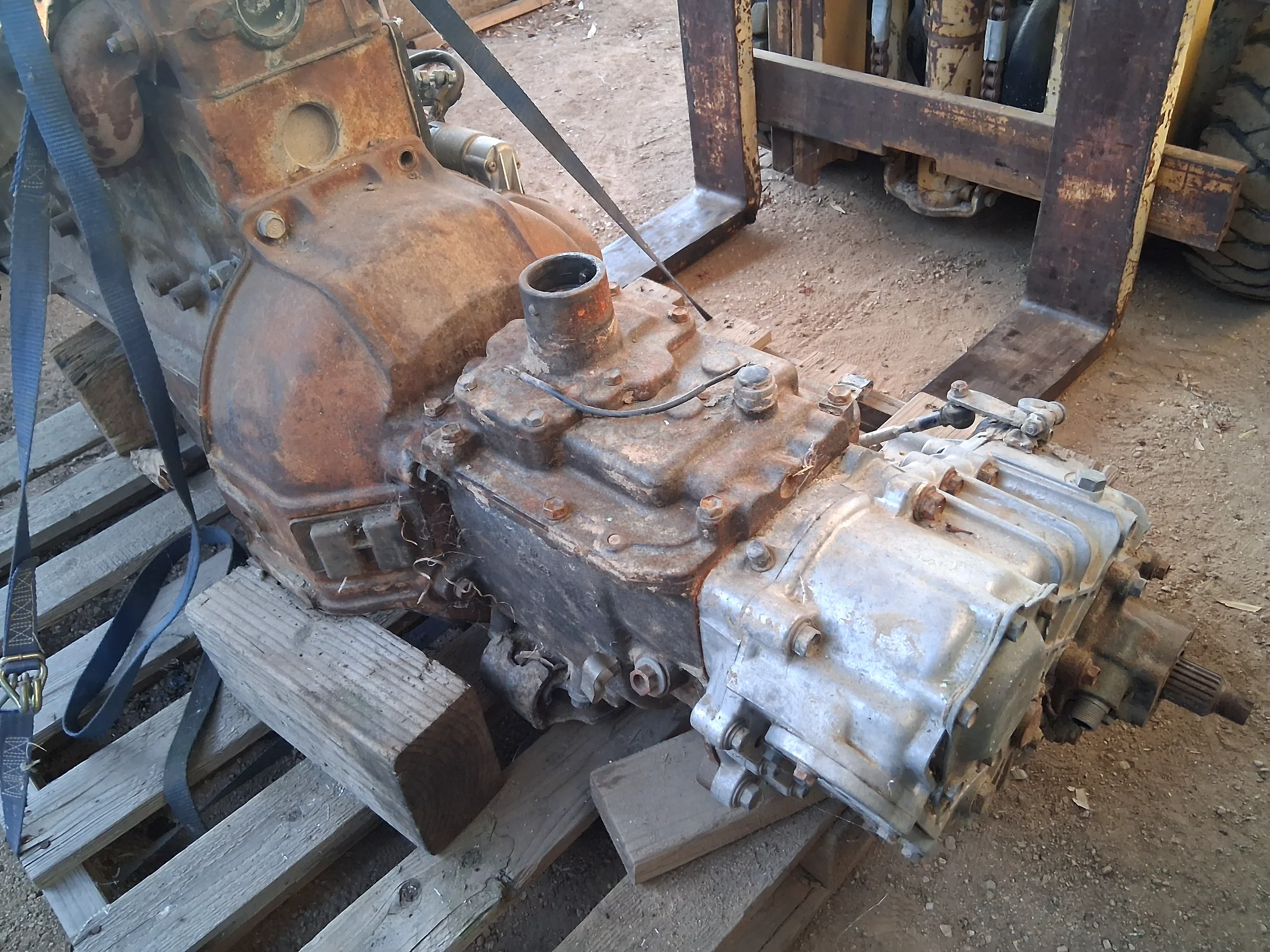

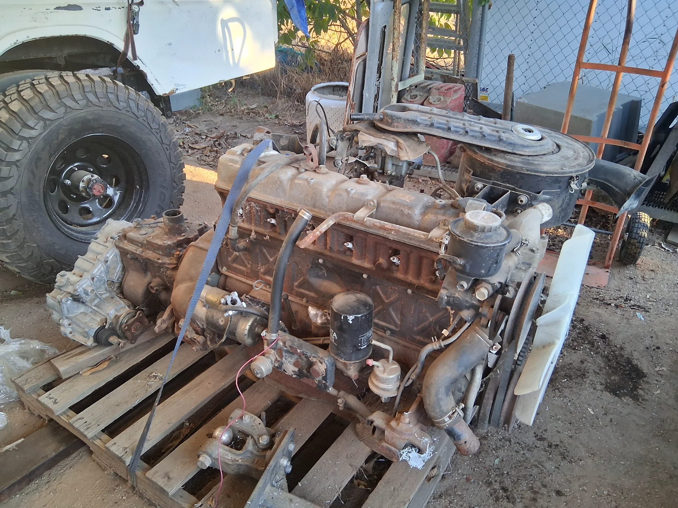

Dug out the new Heart going into the 25. I picked this up a few years ago. Its a late model 2F, H41 4 speed and split T case with an e brake drum. The story I got was It came in a parts haul from Marv Spector when he was importing stuff from Saudi Arabia. No Smog ports on the head, power steering pump and bracket, its has a really cool oil bath air cleaner. I Believe its a 1983 motor.

Fun day with Emma. Started breaking down the 1F for new gaskets and seals, dug out a nice 4 speed combo. Pulled more used parts out and have a few things ordered.
Just a warning if you haven't dropped this in for a test fit. Even though the crossmember looks like it won't be in the way, when you drop it in that parking brake drum will be smack up against it. So count on changing the crossmember. Not a problem for you, just found it funny as that was where the PO of one of mine quit on this exact setup.... and I was able to put the 25 back to stock with no fuss and use the drivetrain in a '74. Also you'd probably want to use a later offset rear axle and stock driveshaft to get rid of the funky angle and not have to deal with the weird flange and long FJ25 carrier.

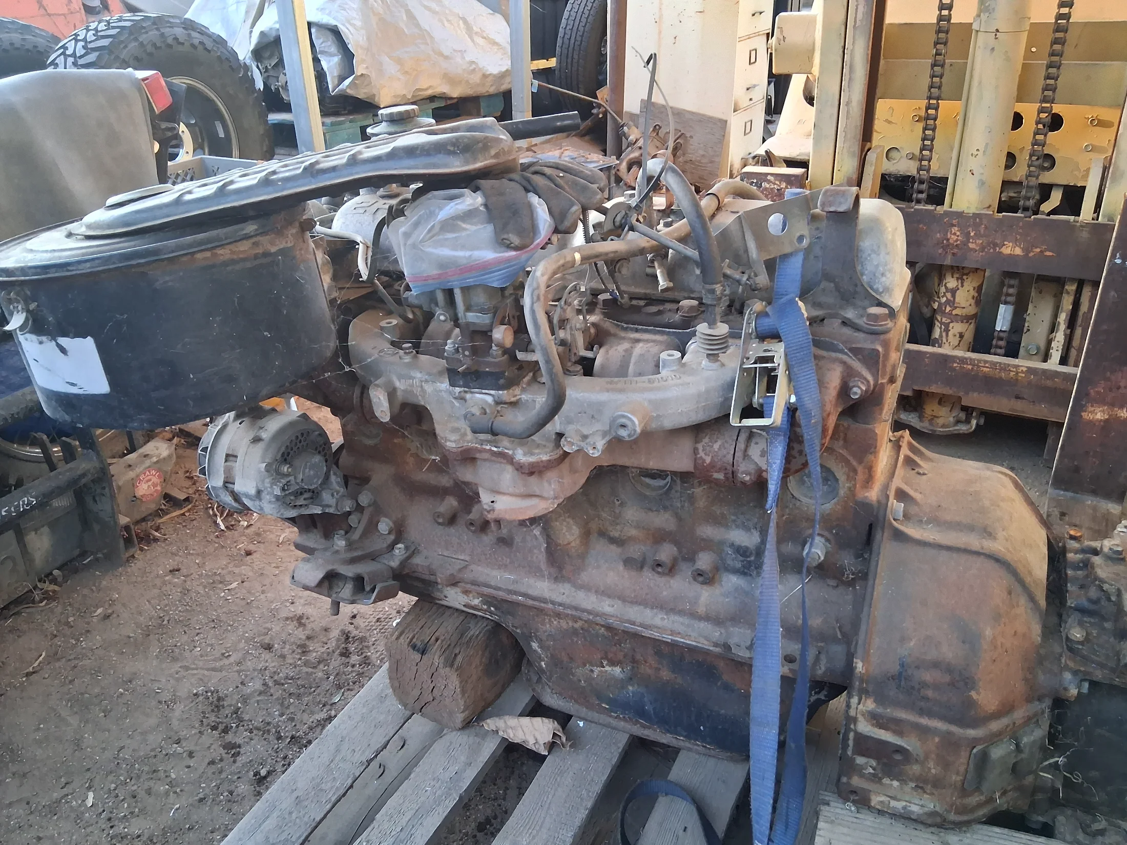

@Mungrol what a Great looking rig. That would be Great to see it back on the road. Like I said my plan is just get mine running and enjoy it. There are so few out on the road really getting driven. I will get some pictures today I was finishing up the gasket on the oil pan yesterday on the 500 dollar motor we are using and started going through the box of misc stuff that came with it. I believe I have the original side mirror.
Last few days I have been getting the motor cleaned up and prepped for new gaskets and seals. Finished the oil pan gasket yesterday. I have to say I really do enjoy bringing old motors back to life. Some fresh paint and were going to have a runner.
