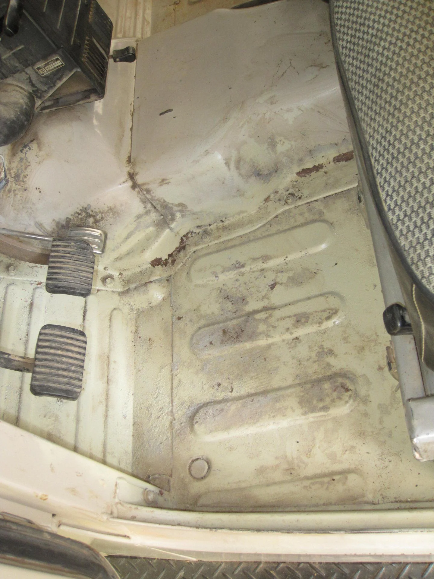

I'd like to invite you and others to post pictures of the floors, humps, and especially the footwell areas of earlier models, including FJ45s. I'm interested to see to what extent the variations may affect the fit of this reproduction floor mat. I don't want to hijack this thread, so feel free to post in the Unobtainium thread instead.

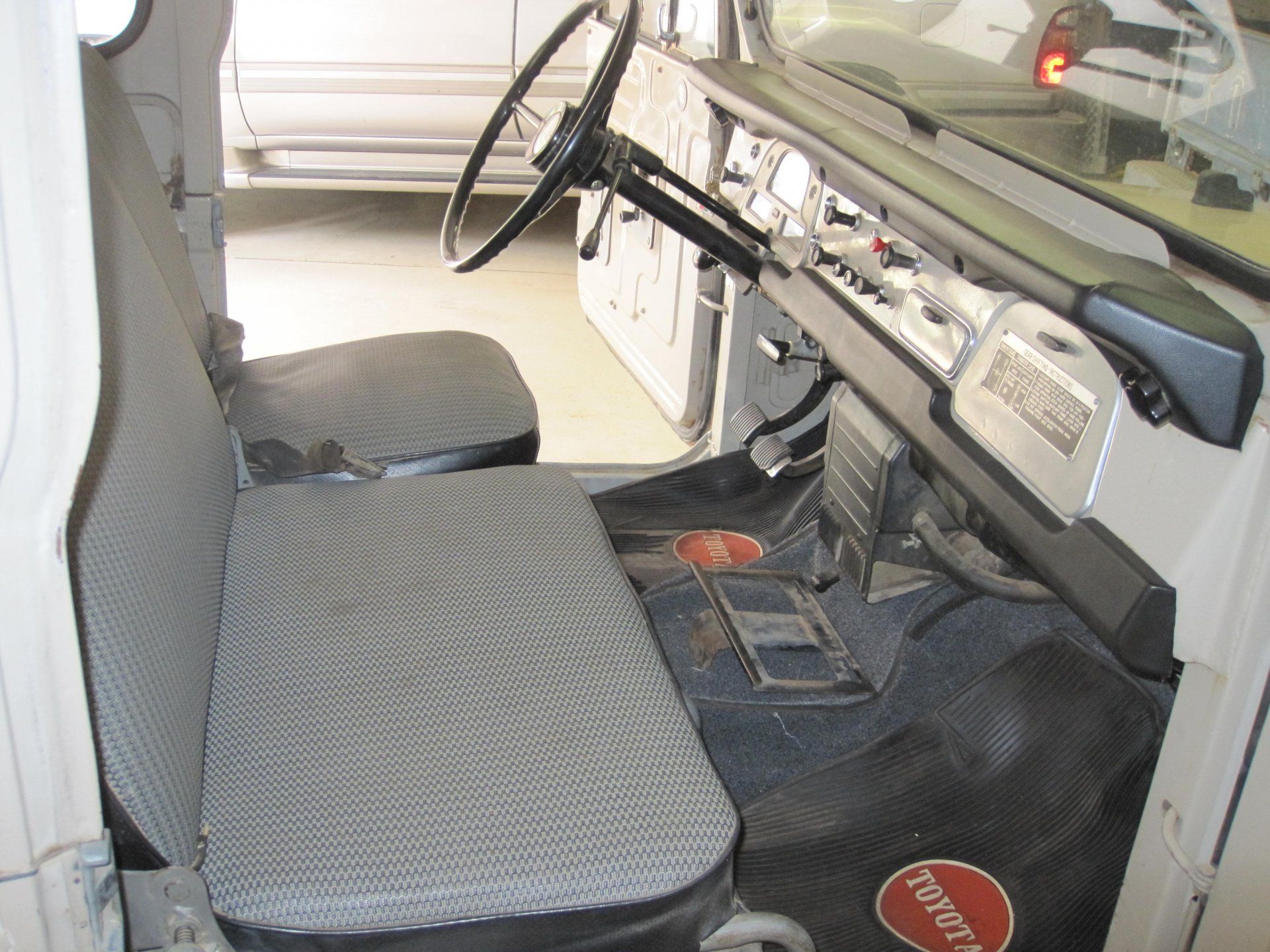

Not the best pictures of my 70 FJ40 but the best I can do right now.
I have used a 74-78 four speed mat in my 68 that wasn't in great shape. Trimmed the back where the tool box i on the driver's side. But I installed buckets from a 74 and modified a transmission hump from a 76.
View attachment 1389189 View attachment 1389190 View attachment 1389191 View attachment 1389194 View attachment 1389195
Thanks for the reply. Great thread on the different humps. After looking at the photos, it appears the floor mat should work for the earlier trucks as well. Maybe just some cutting of the tail section. Even the foot well looks the same, except I can't tell what the foot well looks like for cars with bench seat.
