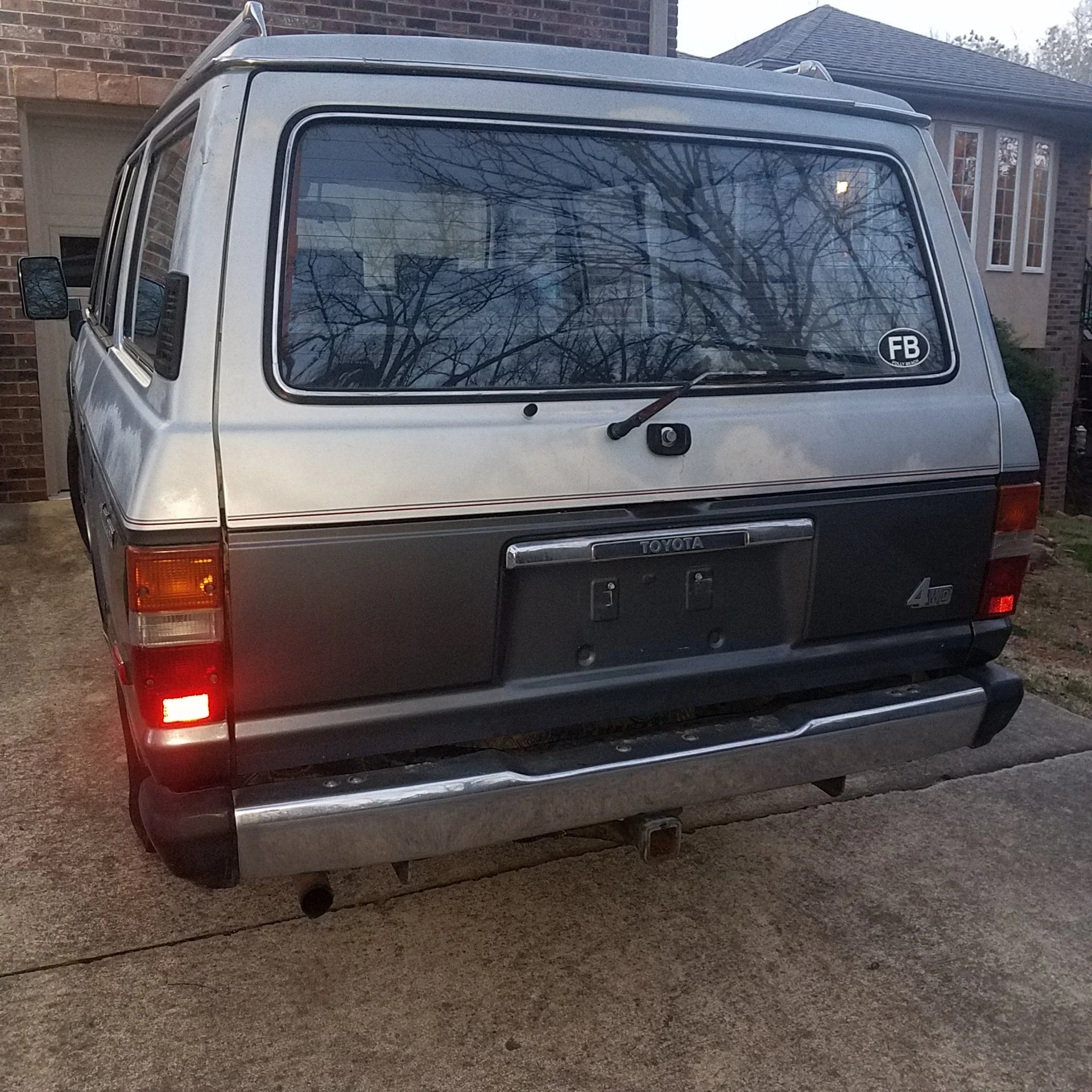

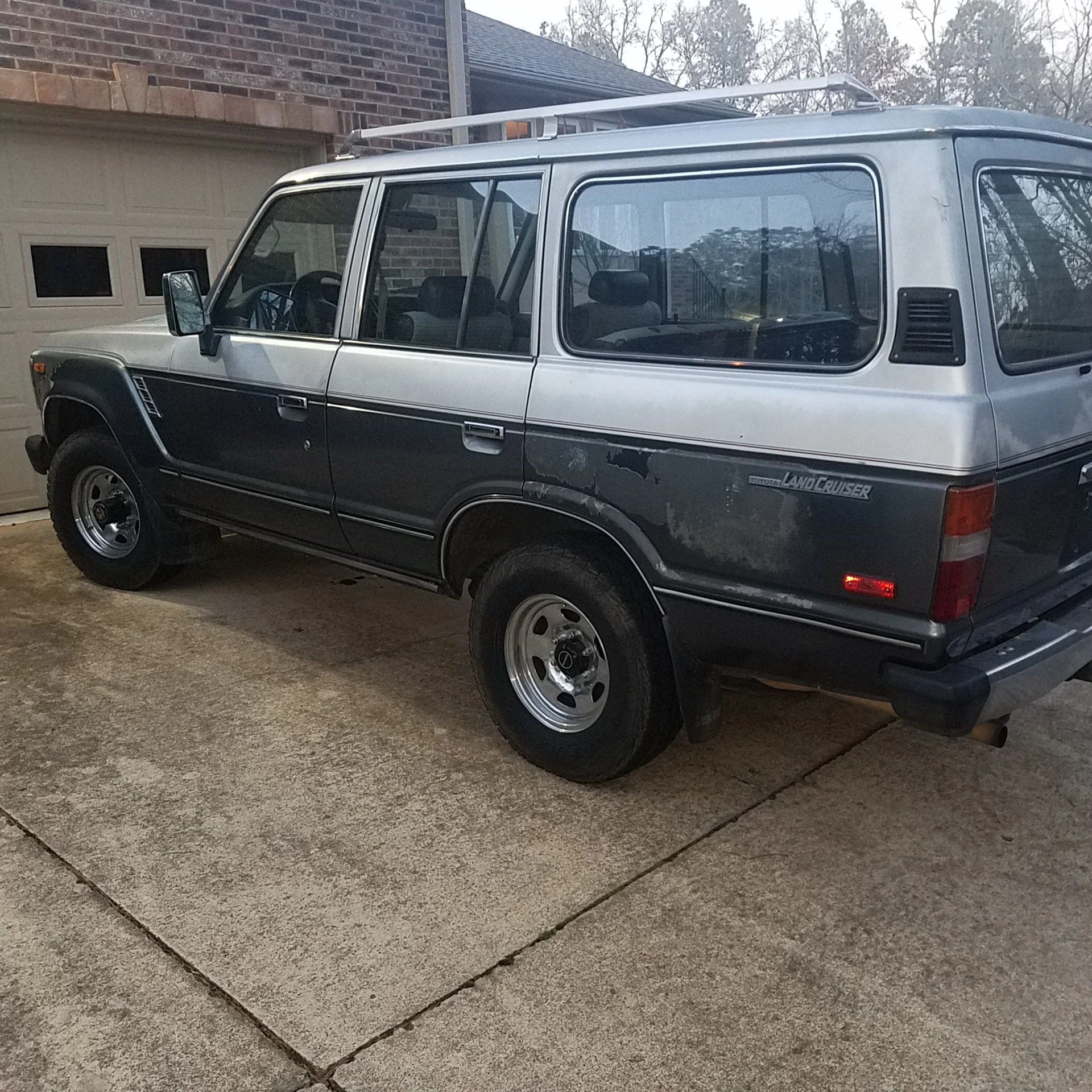

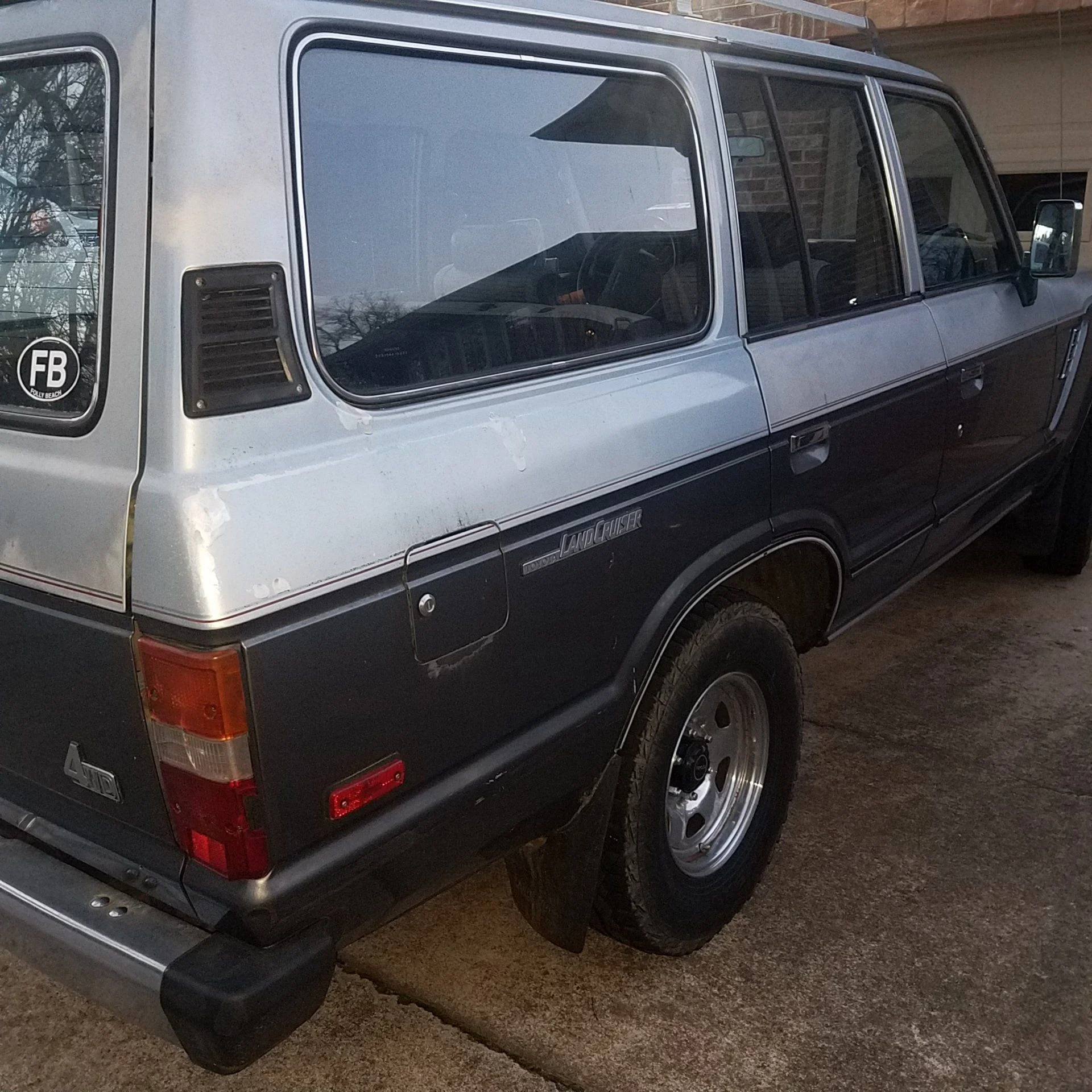

Well, I just couldn't pass it up. I bought this today and brought it home. I am coming over from an FJ40 restoration and got hooked into this. I really like it.

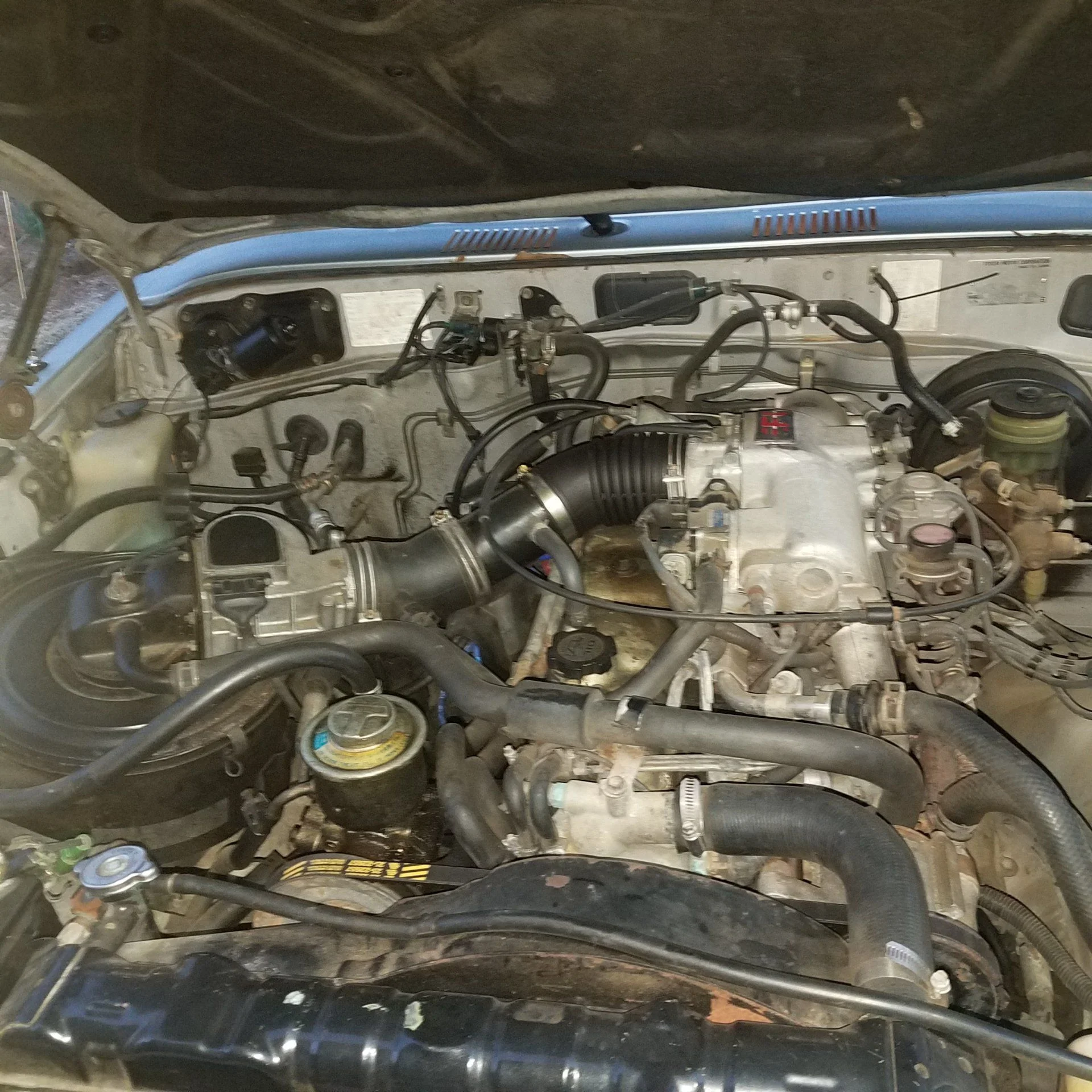

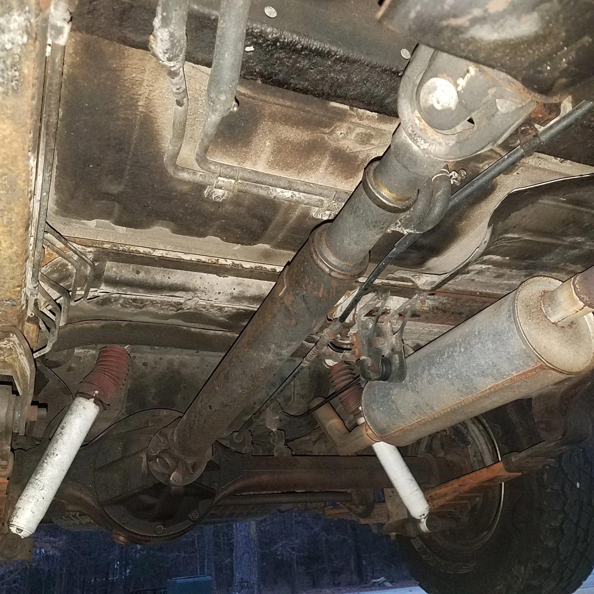

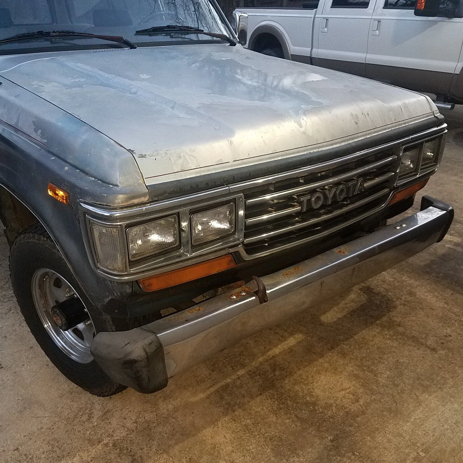

The good: It starts, runs drives and brakes very well. A/c works. It seems to be all original and not hacked up. It has 234K miles. Tranny shifts well, front end has been recently rebuilt. New shocks, new 4wd solenoids. All the smog stuff is still intact and has a new intake boot. One area on the top of the fender has some rust, but otherwise minor surface corrosion and overall I consider it rust free. All OEM glass except front windshield.
The bad: Front bumper bent, front grill a little wacked, needs paint, several oil leaks, dash cracked, front driver seat torn, radio doesnt work (he said he disconnected it because it wouldn't turn off), shifter very sloppy, carpet worn, etc.

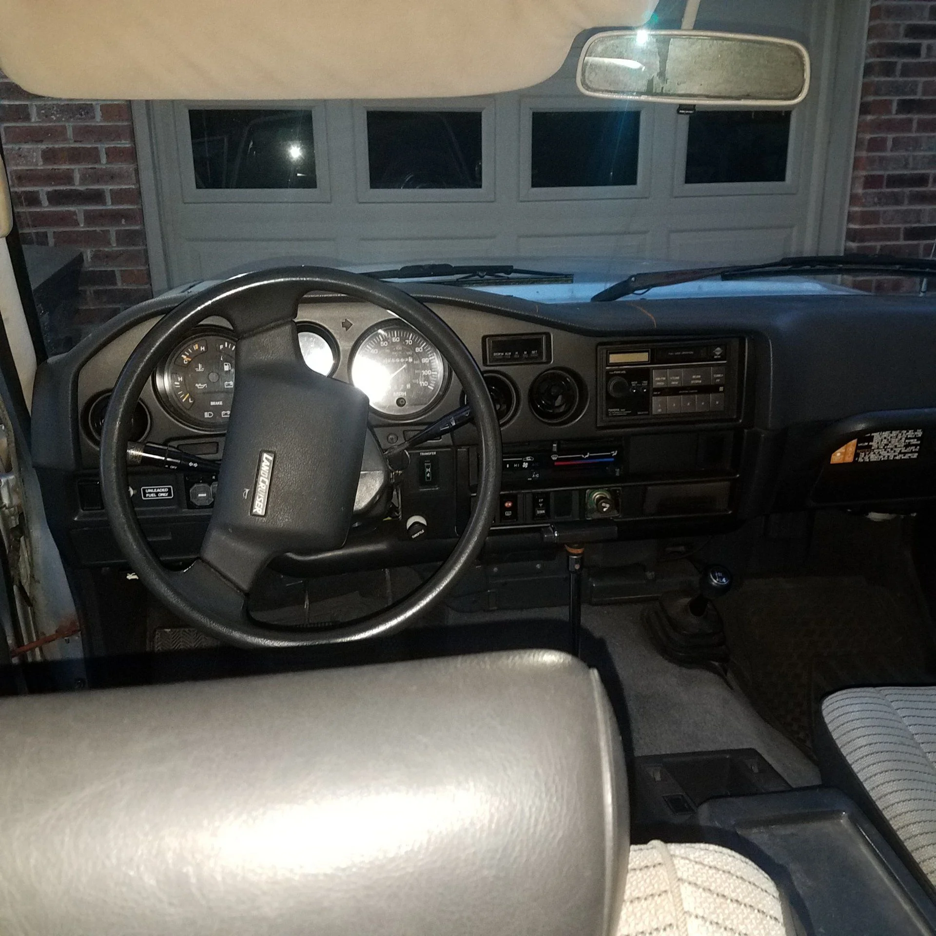

Is it supposed to have an electric antenna?
Here are some pictures....being an FJ62 newbie, I hope I didnt miss something like an upside down bezel!

Two tone! :clap: In my neck of the woods not sure it would meet the rust free designation but where you are I think things are a little different. Looks like a great find enjoy
two tone is awesome! congrats.
pretty sure the electric antenna was standard. welcome to the fancy life of up/down.
and torn driver seat is a required feature. if you find a 62 without a torn driver seat, run away! I looked at a 128k mile 62 a while back with the torn seat. i think they tear around 100k miles even if you don't sit on the seat. japanese easter egg.
looks like the antennae switch is right next to the cig lighter. supposed to be electric if you have power windows and mirrors
Two tone! Best color on a 62, congrats. I'm not well versed on a 62, but I do remember looking at one and an electric antenna is correct. My suggestion would be a "baseline" and go from there
Thanks guys. Pictures make the rust look worse than it really is. Nothing more than surface underneath and a couple of areas around the windshield and fender. I cant see any evidence of a respray, just crappy cover up. Hopefully nothing too scary hiding underneath. My plan is to put it up on the lift and give it a good look over. At first glance it looked like the some of the oil was coming from the hose on the oil cooler. I think it is an oil cooler?? It is something covered in oil! I will probably degrease everything and see where all the leaks are. I guess oil pan front and rear seals, rear tranny seal. Get a list together and give @beno some business. He was great to me on the 40.
I am thinking a refurbishment over a complete restoration. Fix everything broken, get it tip top mechanically, and a good factory correct paint job.

The bezel IS upside down. ;-)
Nice truck - lots of potential and it would look so sharp with fresh paint.
Nice truck. Ut has an electric antenna but its a common failure. The toggle switch is on the dash by the cigarette lighter. Replacing them is not too difficult.

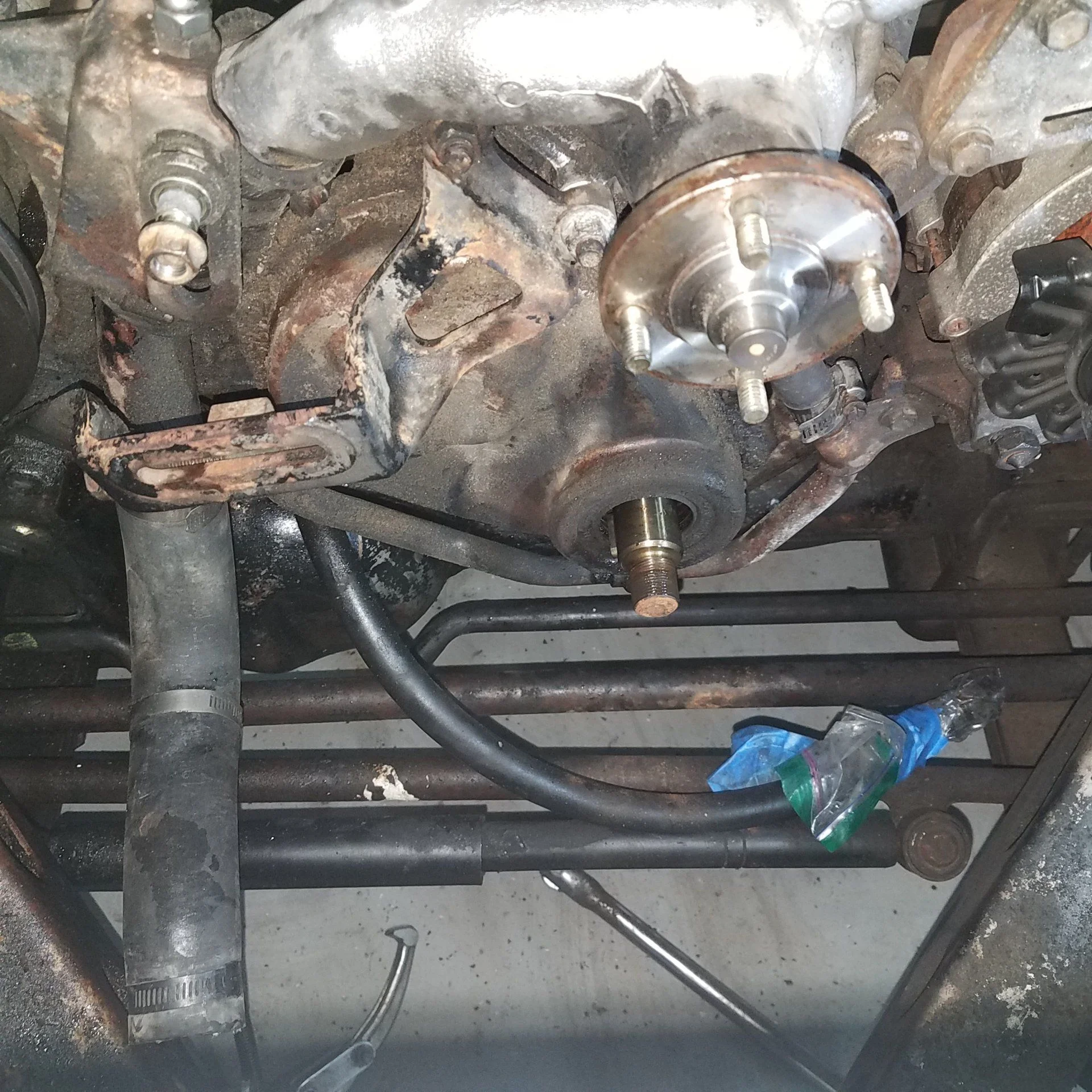

I had the day off and got some time to start digging in. After about three hours, a case of brake parts cleaner, a couple of cans of degreaser, and a pressure washer I have the the oil and grease cleaned up. What a mess. I drove it around a bit to see if I could see any leaks.
Power steering pump is one place for sure. I also degreased the idler pulley enough to notice it had a lot of play and became noisy. I took of the PS pump, and removed both idler pulleys. I have some bearings and a seal kit ordered for the PS pump.
I quickly realized that the 62 is harder to wrench on than the 40!
Good looking 62 and congratulations!

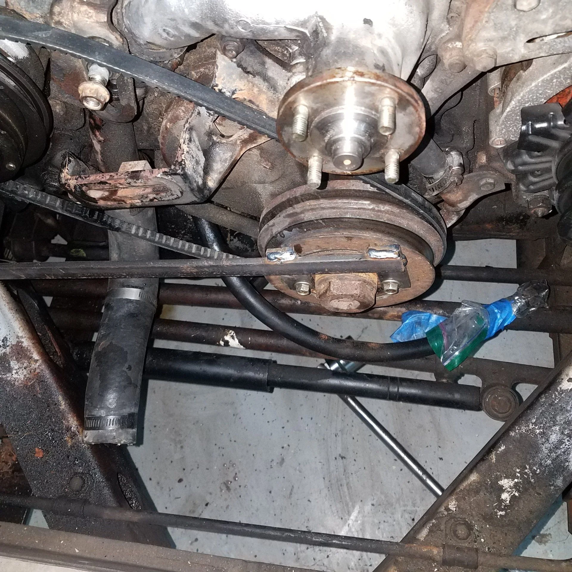

I have been doing a good bit of reading and searching over the last week. I tore down the front engine area to replace the idler bearings, rebuild the PS pump, new front seal, new timing cover seal. I have decided to replace the water pump all the hoses, including the tranny hoses. They are NLA but a local shop is making them. Radiator is getting cleaned out and checked. It had some crusting around the top of the core, where it looked like it may have been leaking.
I was a little worried about removing the crank nut, but I made a pulley holding tool and the nut came off easily. That was way easier than removing than shroud!

My homemade tool and other shots:
