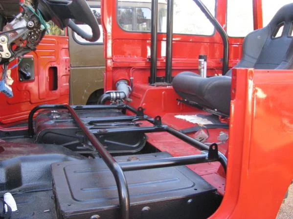

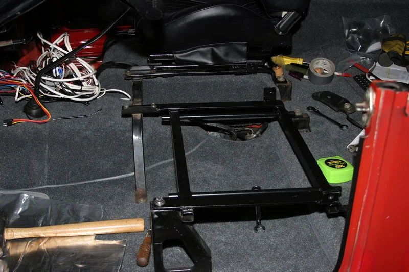

    I just installed some Scat pro car seats. I got them from summit racing, and bought the seat brackets as well. The seat brackets/sliders attaches directly to the FJ40 OEM seat mounts. It was a :wrench: job.
    The only thing I don't like is that I sit up about a inch higher, but they sure are comfortable! :)
    [​IMG]

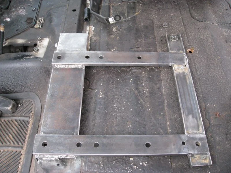

    I put some Jeep TJ seats in mine. If you own a welder and a grinder, grab some scrap steel and make some brackets. TJ seats are pretty comfy for the price, I picked mine up for $100.

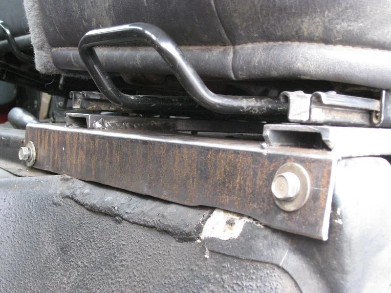

    '97 and up should all be the same. The later ones may be different, I would say '97-'03 would work.
    Here are some pics of the bracket I made (sorry don't have any pictures of the seats):

    wow.. great info.. thanks! You are using the jeep seat tracks then, right?

    N. Van, BC / WA
    Sure am. They unbolt from the stock bracket (4 studs). I ended up cutting off one stud on each seat, the rear most, because it was keeping the rear of my seat track from tightening down to the bracket.

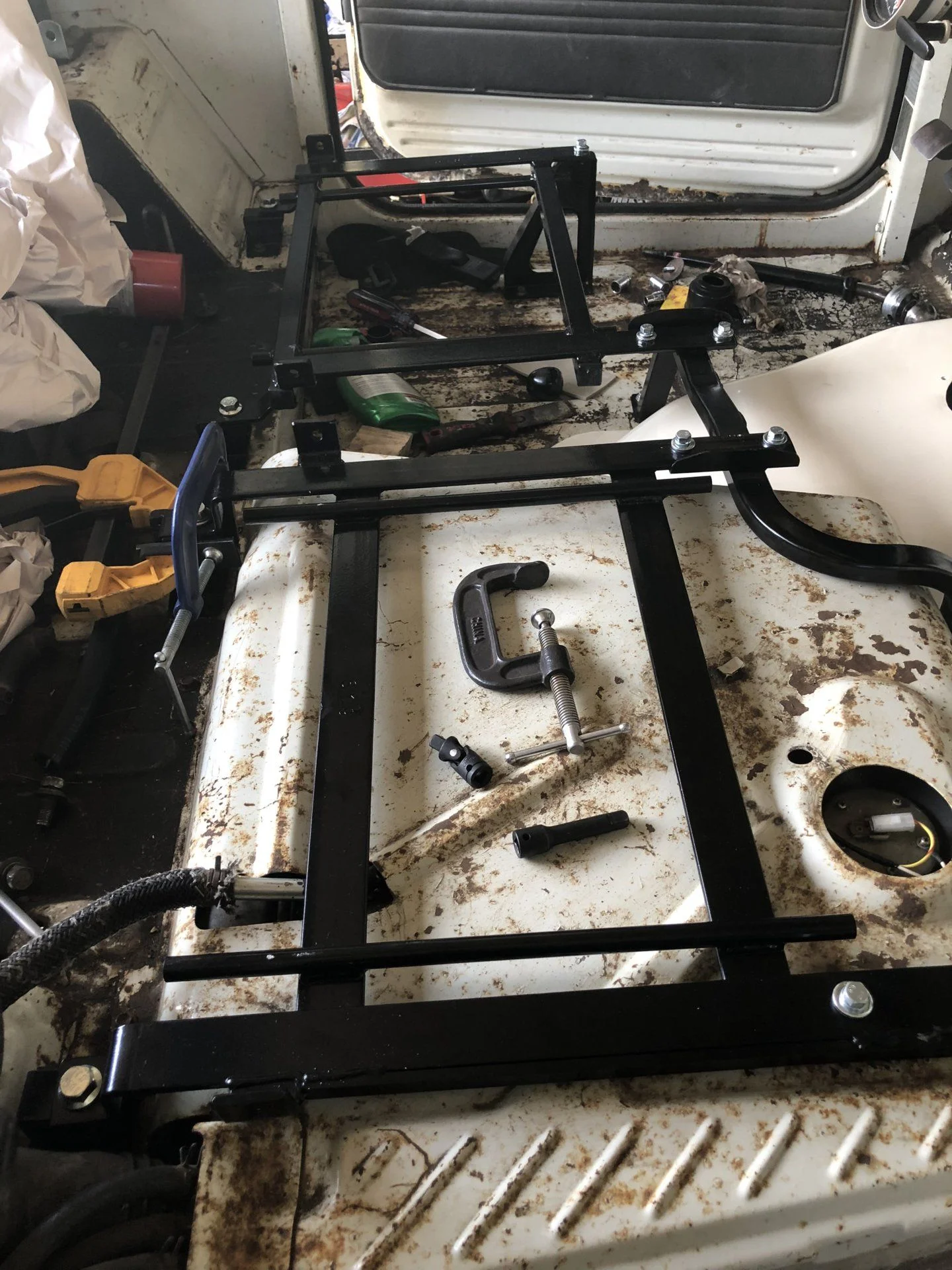

    Here is another option, this is a kit for those of you with a welder or a buddy with one. $175.00 plus actual shipping cost.
    These seats are from Kragen, about $100.00 ea. new.
    PM me if interested, PayPay accepted.
