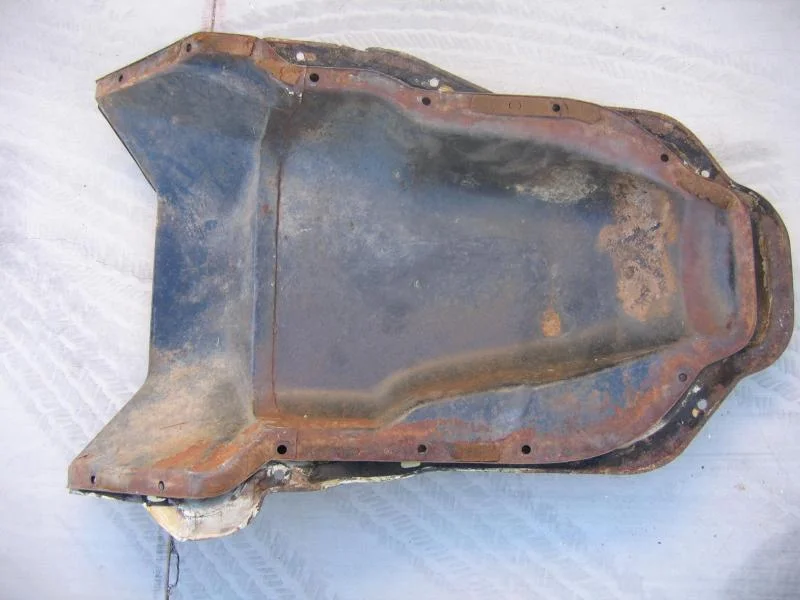

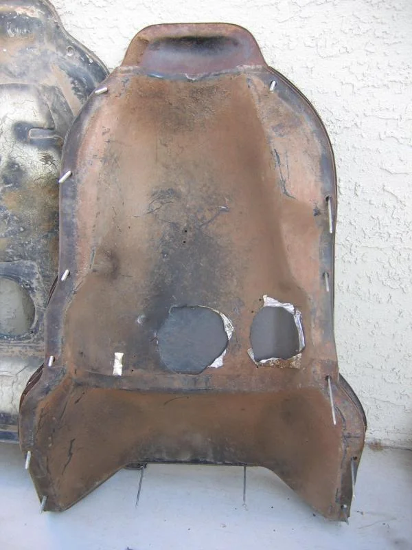

Three speed tranny humps

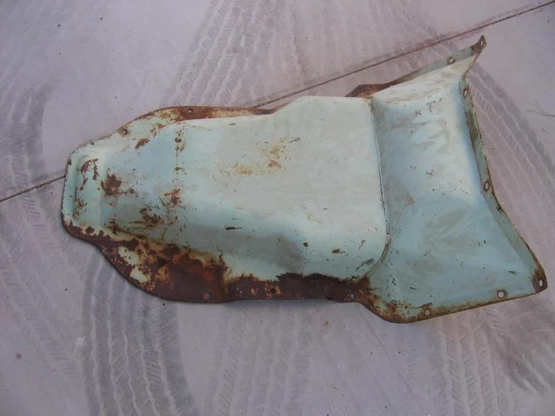

Here are a couple of pictures of some three speed tranny humps. The screw holes for the FJ45 LPB and FJ40 match. The 45 is off an 1965. While the two 40s are a 68 and 72. The 45 hump is just a little longer and the area around vacuum shifter. Nothing that can't be reformed.
Four speed tranny humps

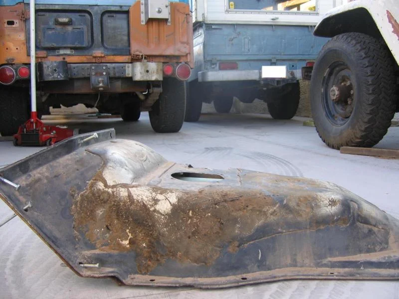

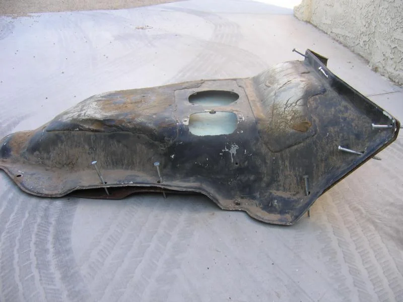

Here's the 65 FJ45 tranny hump compared to the 74-78 FJ40 tranny hump. The 40 hump will cover all the opening of the 65 FJ45 plus a little more. You will notice the 40 cover is taller than 45 cover, giving more clearance for taller transmissions. The only holes that match are the holes on the angled part and two above the vacuum shifter. New fixed nuts would have to be added on the flat part of the floor. Also the area above the vacuum shifter would have to be reworked to match.

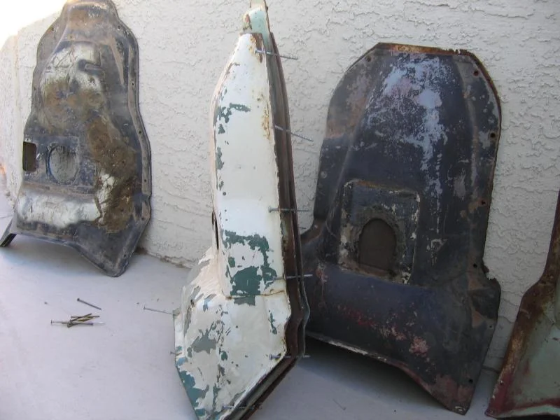

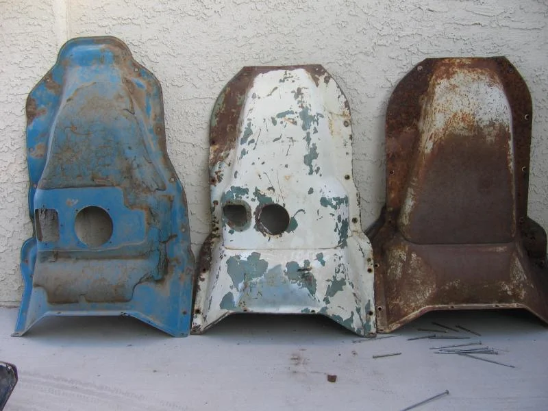

Three different FJ40 humps. The one on the right is from a 61-63. The center picture is of a 65-72, not sure which the 64 has but my guess is the 65 or later. The last is the 74-78. The 73 matches the floor pattern of the 74-78, just not sure if it's taller like the four speed.

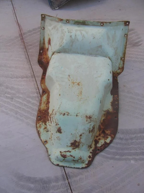

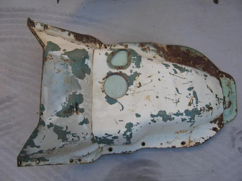

Last two pictures are of the uncut FJ45 tranny hump.
