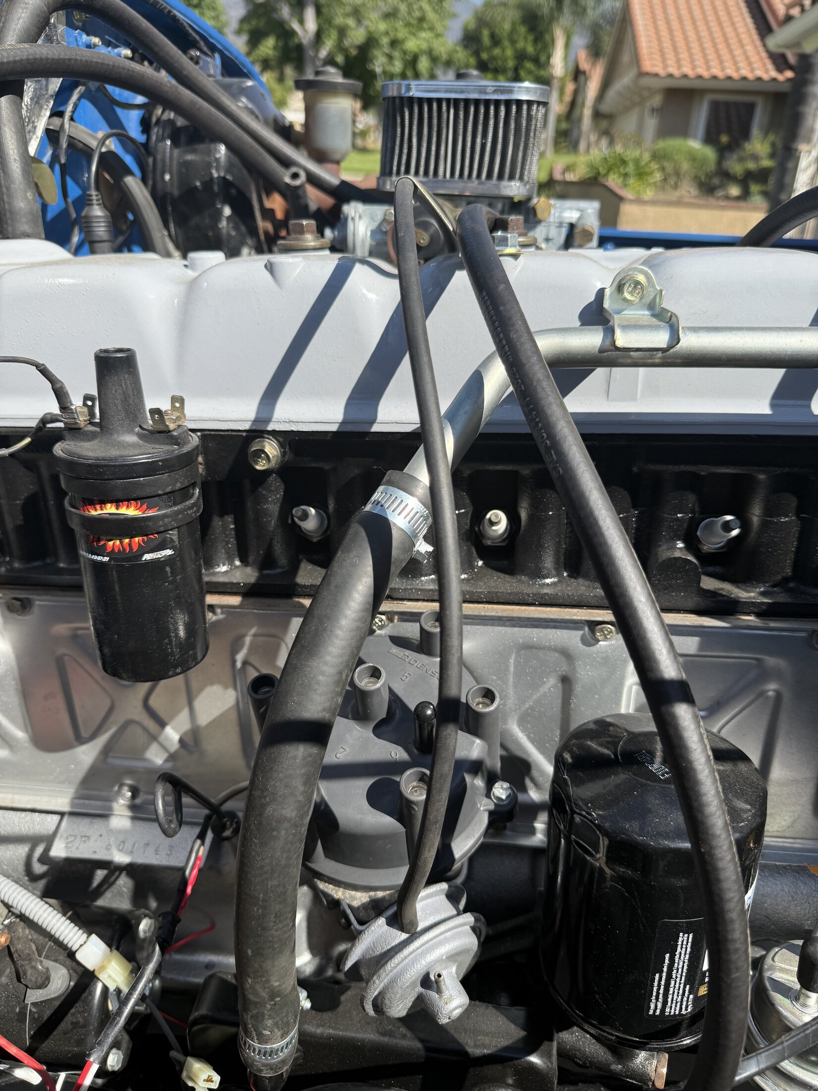

Yes, for sure if it is at least a 1979 igniter. '79 is the year that Toyota changed to an electronic distributor for U.S. market 40's. I am running an FJ60 big-cap distributor on my 12/79 FJ40, with the stock coil and igniter. If I have time later, I will take a photo of it like @Pighead did of his.

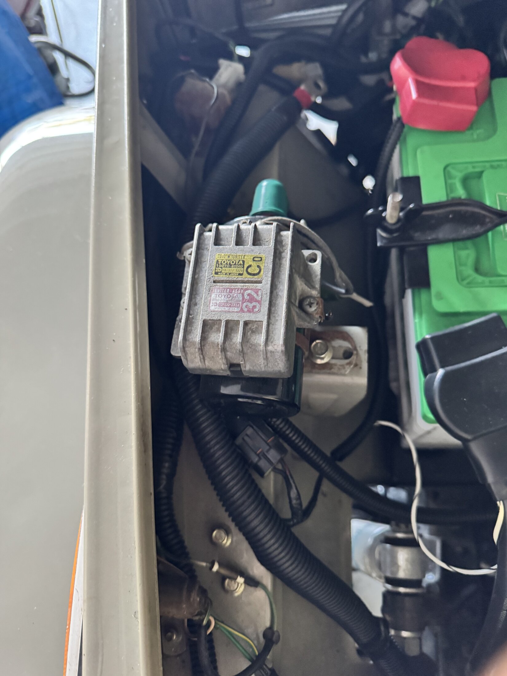

When I put the 87 2F into my 74, I kept the stock 74 coil location. You can see I had to drill one hole in the bracket. I was lucky and just used the igniter that was already on the 87 engine.

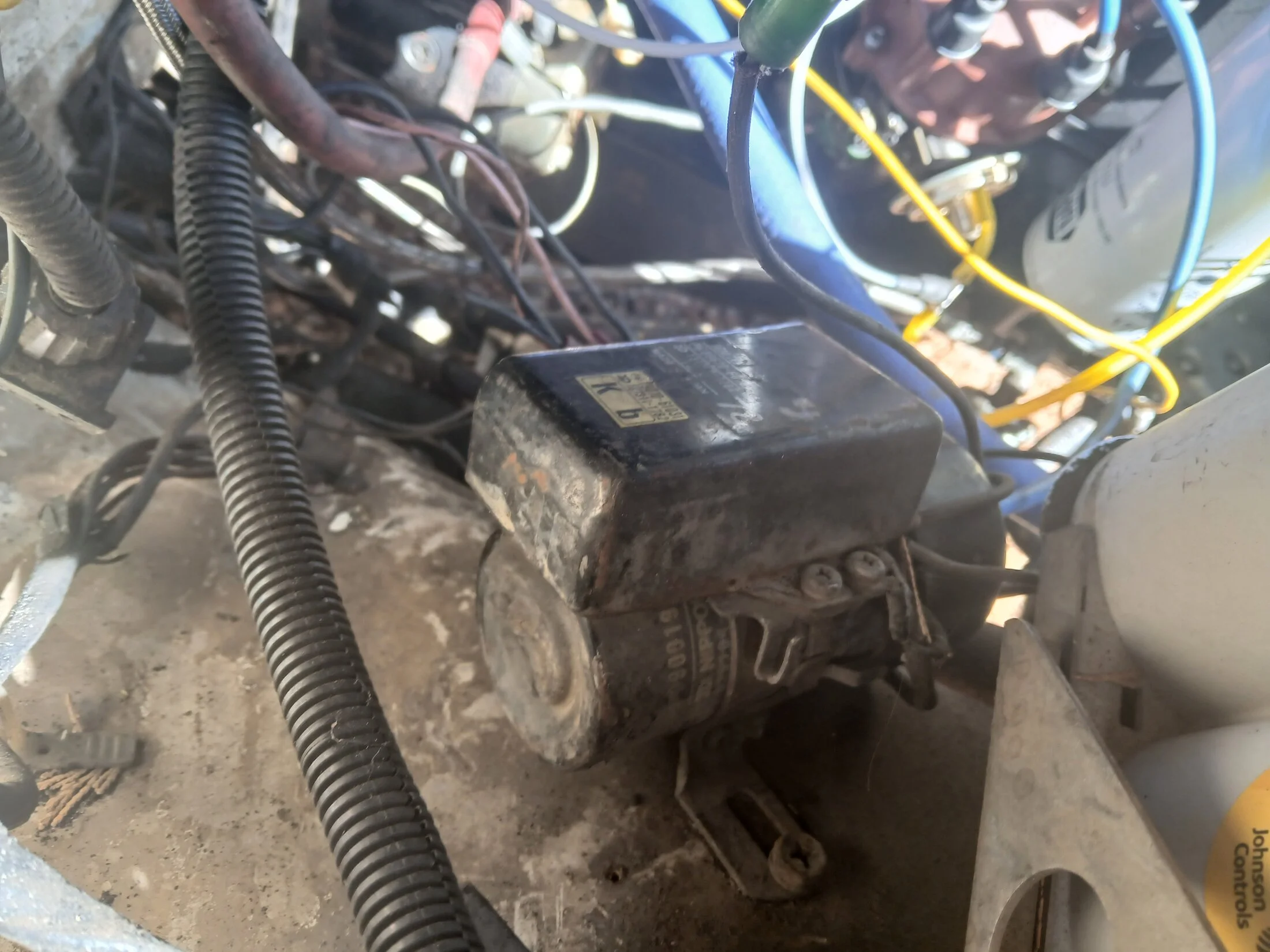

I'm showing this part number good for 9/77-7/80 2F in the FJ40. 1/79-7/80 shows a sub . I've had my 3/79 FJ40 for twenty seven years a d know the history back to 1993. Interesting it has an igniter with 78 on but the correct original part number for 79.
