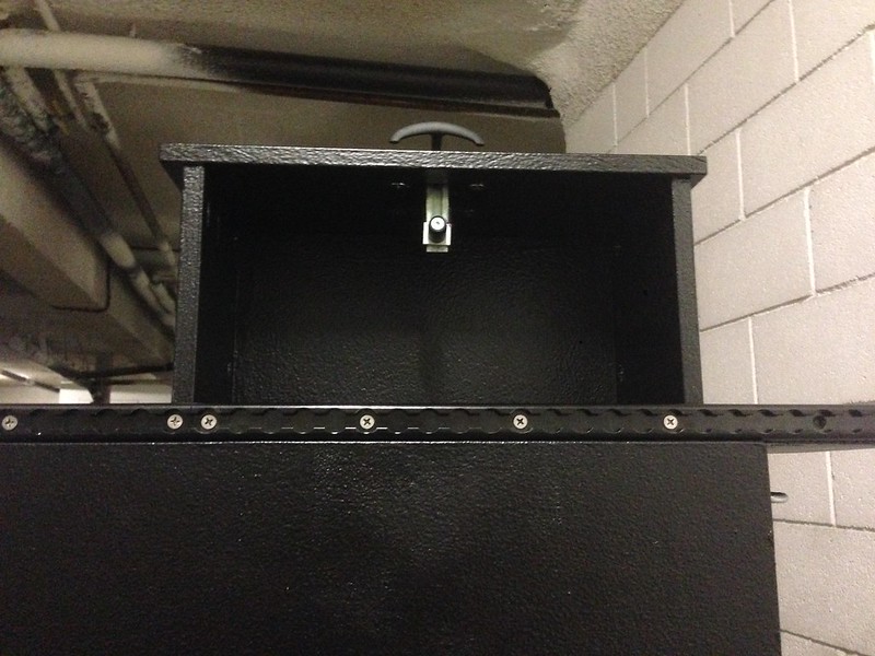

That is true. I'm at about $550 before any additional tools I needed. But it's taken me countless hours. If you've seen his build threads, when AATLAS1X says that building your own drawers is too much work, it definitely is.
I started the project back in January. Even if you could commit 3 entire weekends in a row, it'd still be tough since you really have to go one step at a time with assembly, wood filler touch ups, sanding, painting, bed-lining, hardware installation, etc. And because of that, it's hard to keep the wood straight while sitting during the week. Luckily my wife has been very patient with me.
Using screws instead of countersunk T-nuts and bolts would save a lot of time. Not using flush mounted Logic Track rails, and not sanding anything would save a lot of time too.

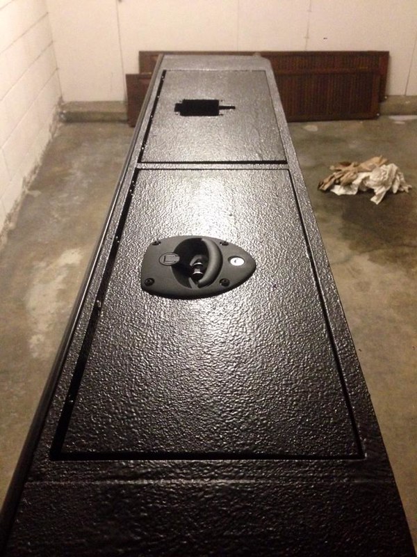

I too underestimated the effort involved in making my own metal drawer system similar to the ARB Outback product with roller bearings and an integrated fridge slide. I now understand why they cost close to $2K. I put a ton of hours into mine and it turned out OK, but I couldn't source the slam latches or locking hardware used to keep the slides open that ARB uses. If I was to do it again, I would just purchase the Outback system. Writing a big check is so much easier than spending countless hours building your own.
The positive about making your own is that you can configure it to your needs.
I'm really enjoying making my own, but it does take lots of time and cost a lot of money in materials!

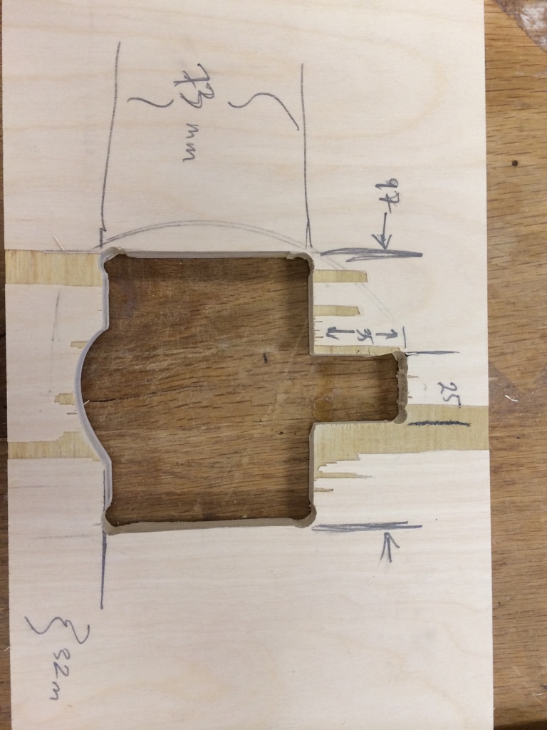

I might muster up the energy to do a comprehensive write up on my build, which would save folks a ton of time. I've spent a lot of time and mental energy figuring out how to do everything and assembling all the hardware and parts.
For example, having this little template available or at least the dimensions would've saved me an hour of work and another hour of searching mud looking for one and another hour trying to decipher the crazy Allegis included diagram!
Nice work, I really like the way you recessed the slides, that was a lot of extra work but looks clean and well done
