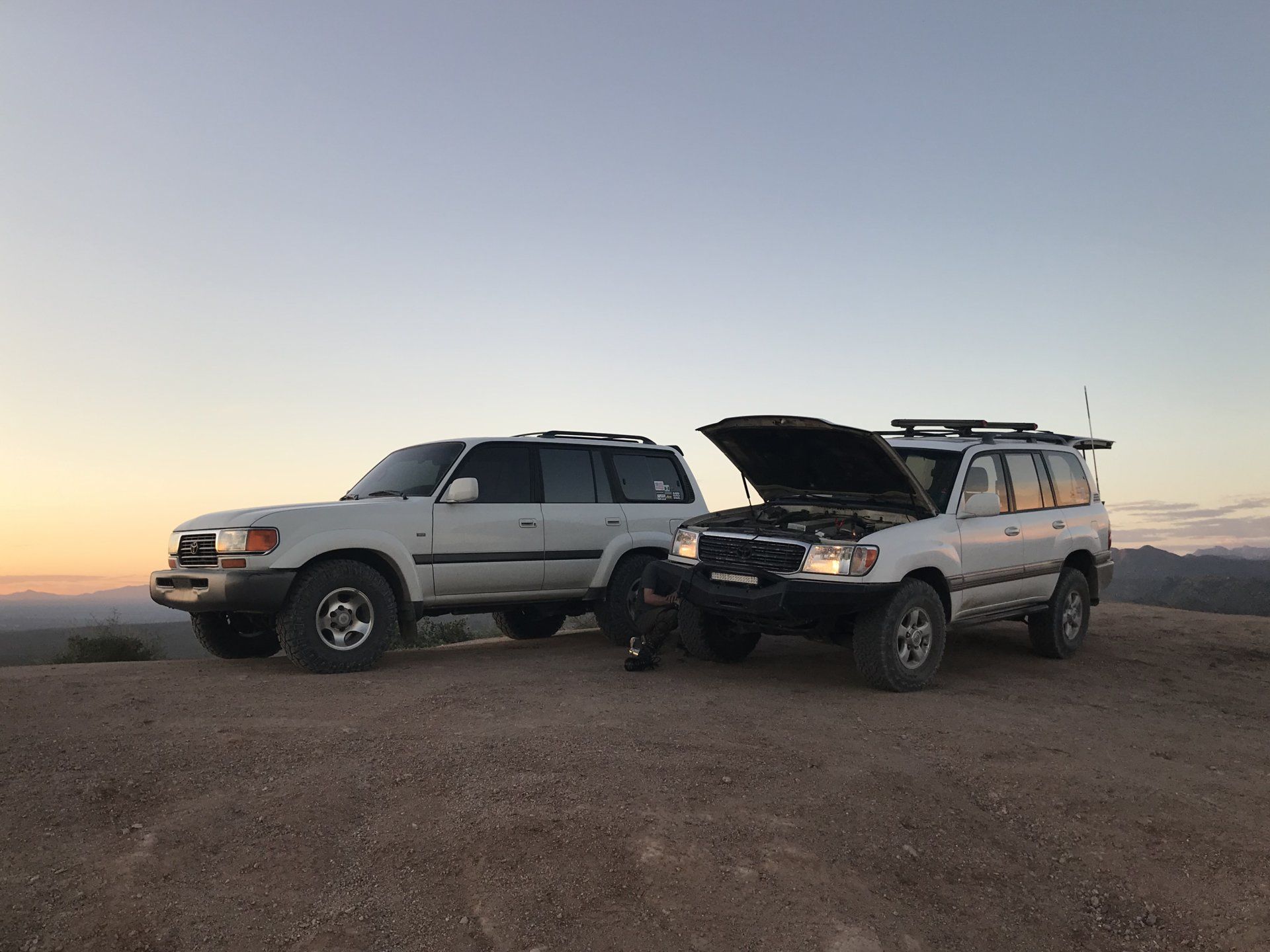

The fleet

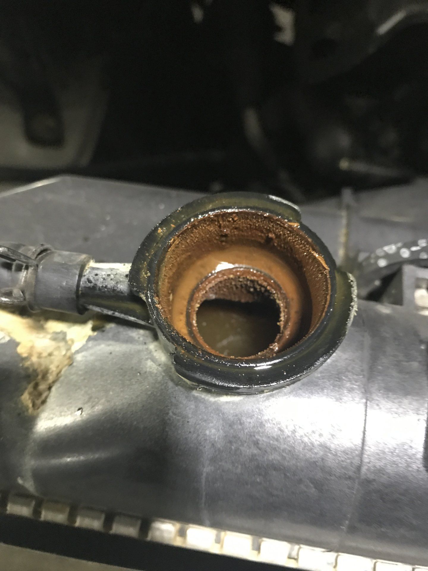

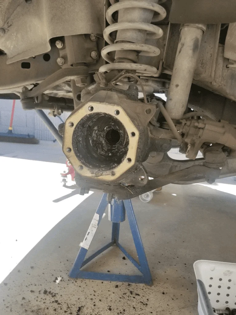

Birf Rebuild, not too bad, but the wheel bearings on the pass side were destroyed

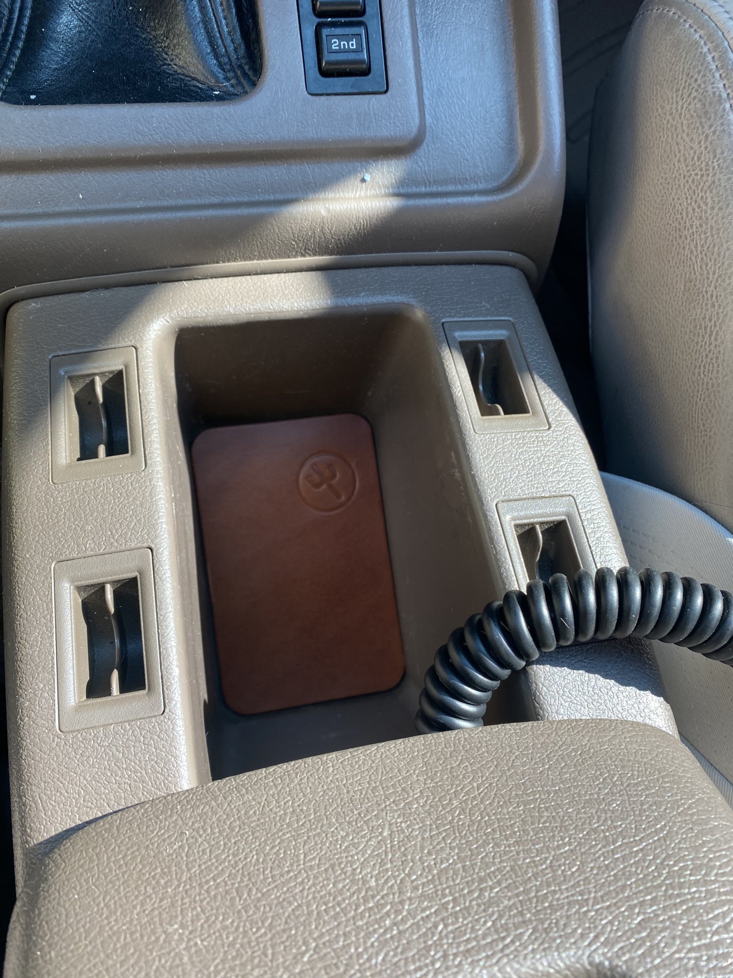

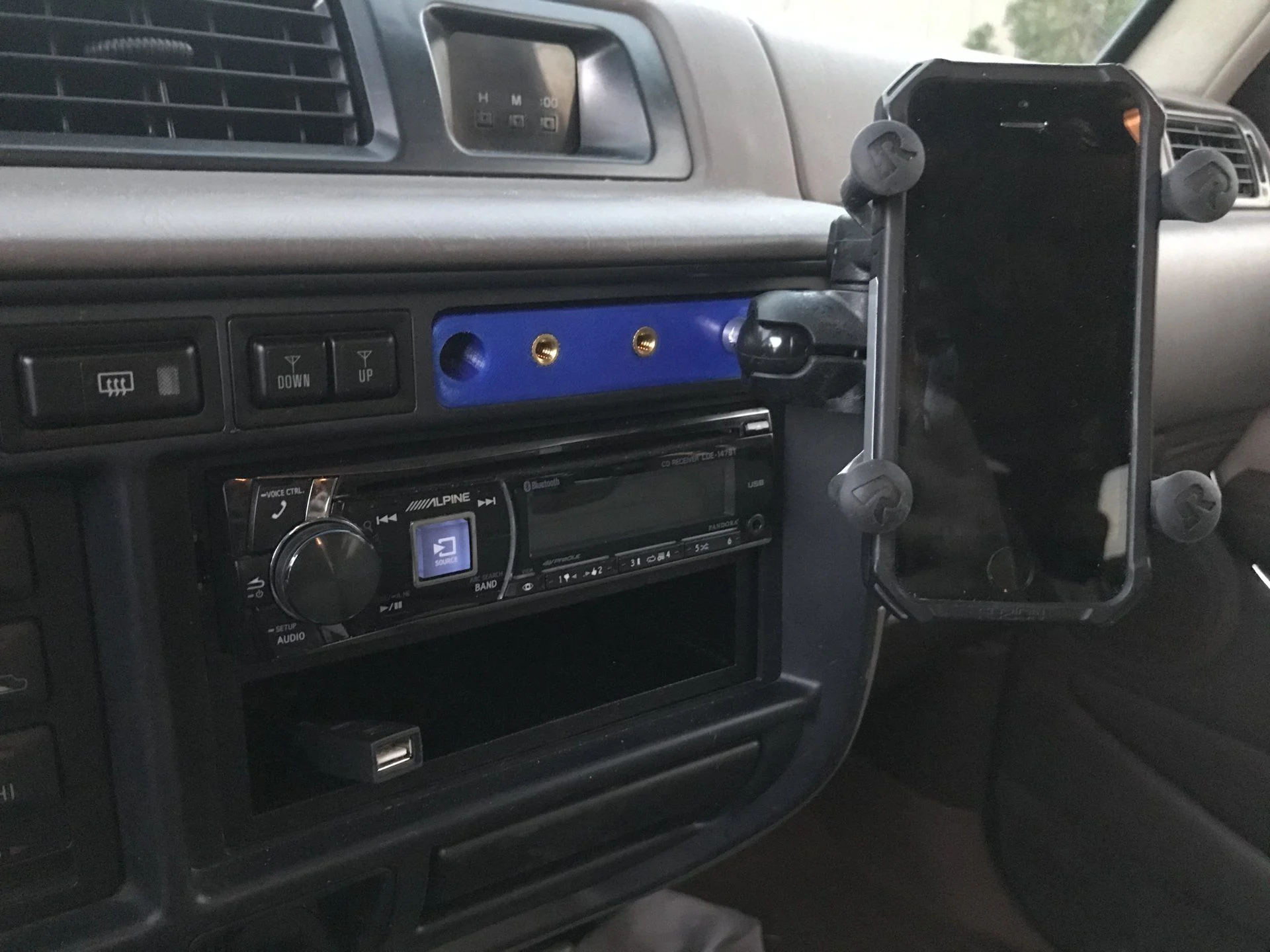

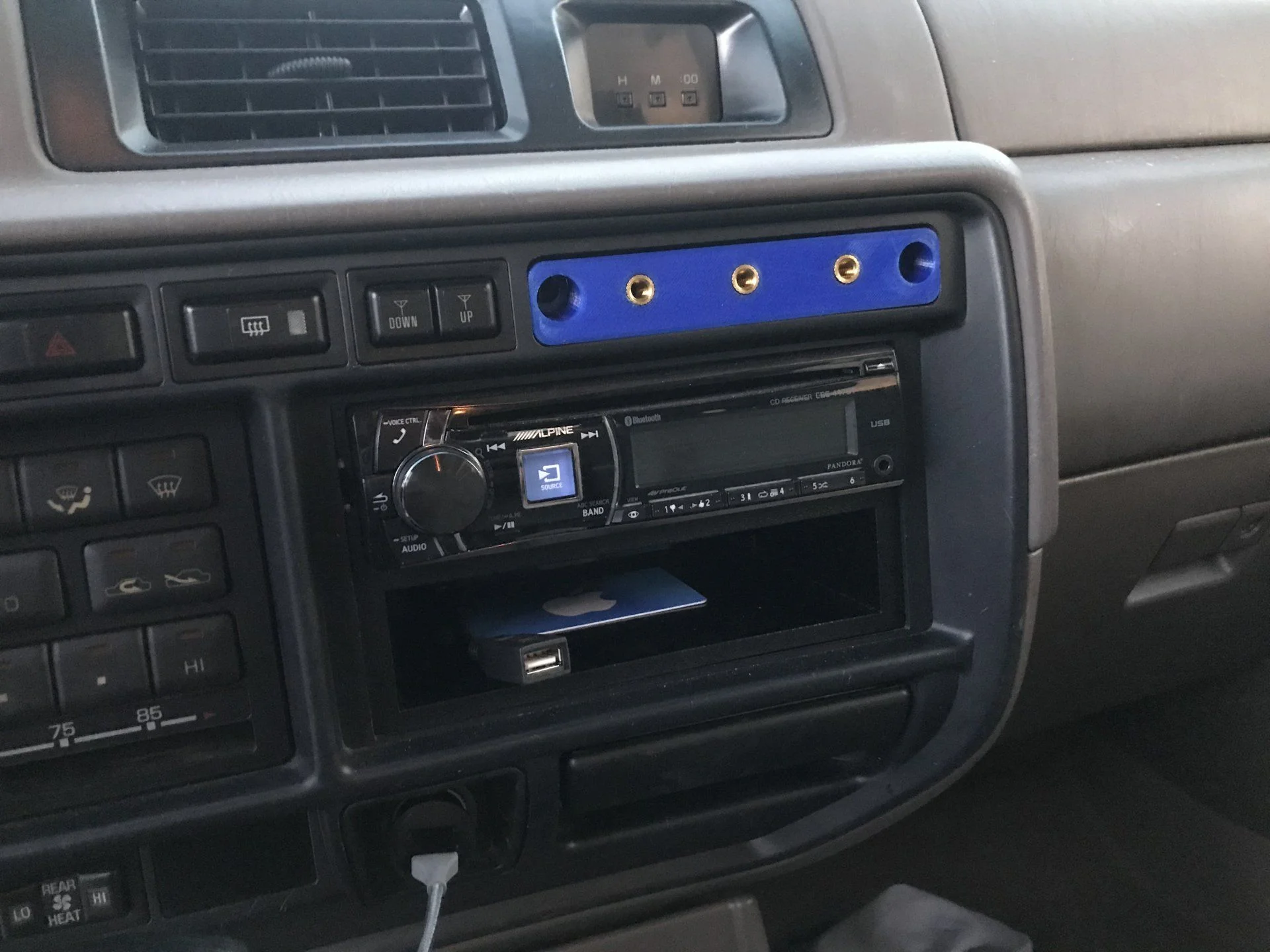

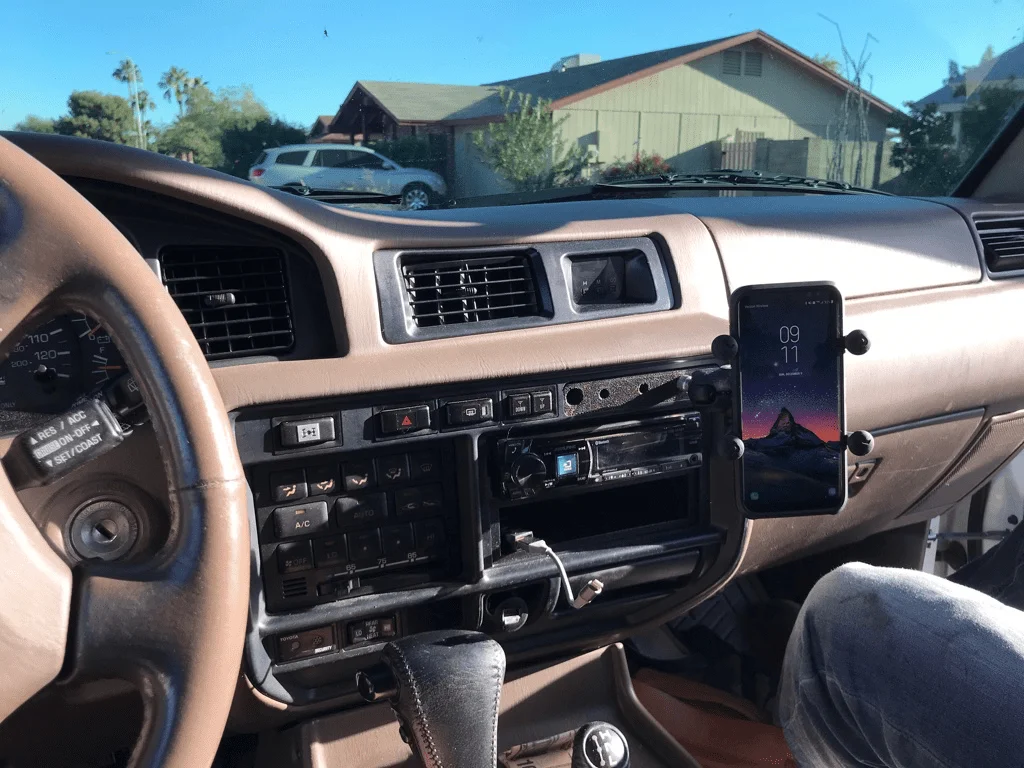

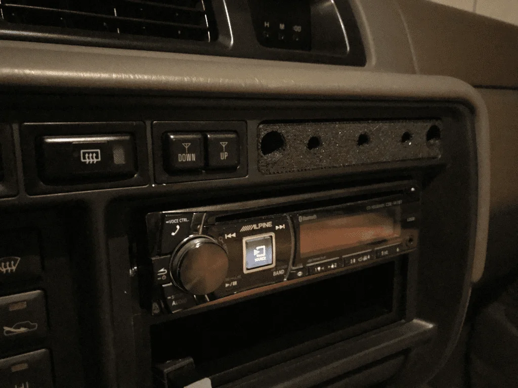

I'm interested in your Alpine radio set-up. If you can, please list all that you used (including the mounting / storage pocket). Thanks!
Nice clean truck!
Thanks sir, I have really been enjoying it.

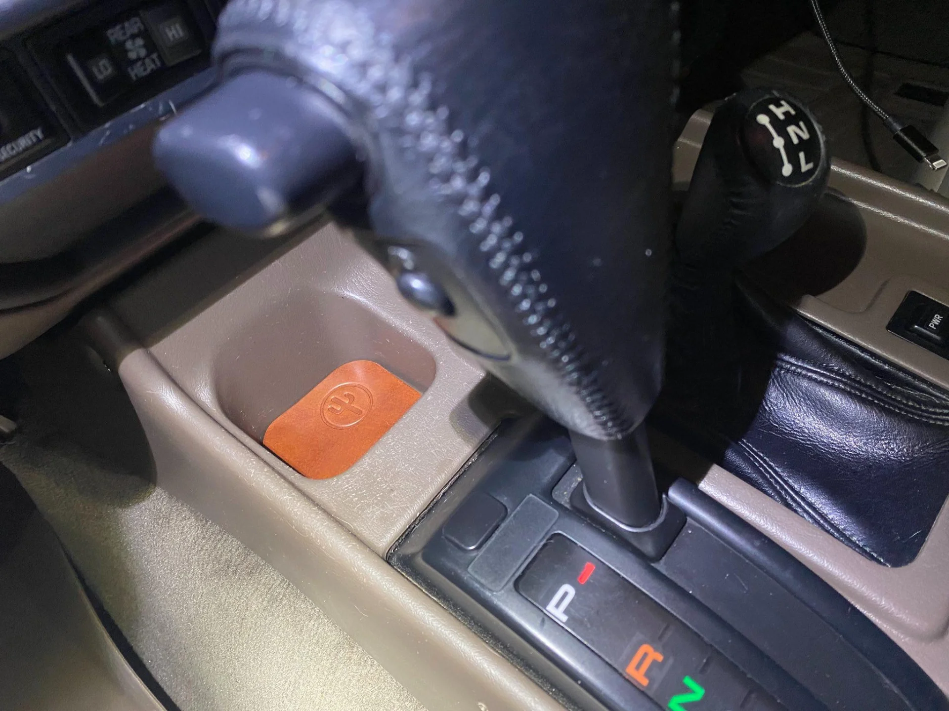

Once you've picked out a headunit you like (i think mine is a CDE-143BT, it's a few years old), you'll need a single UPT900 dash kit (linked below) and a Metra 70-1761 harness (also linked below) if you want to bypass the amp (I bypassed because I couldn't stand the whine/interference and the bypass is super easy, you just plug into the unused grey plugs behind the dash and disconnect the harness at the factory amp).
Dash kit (storage pocket) you will mount this to the headunit (top or bottom, your choice) with the factory brackets, then those brackets mount to the dash:
American International UPT900 Dash Kit
Harness to bypass amp:
Metra 70-1761 Receiver Wiring Harness
If you order the headunit you like from crutchfield and enter your vehicle info, they will send you instructions, the harness, and the dash kit for free. I always buy my stereo gear from them, their tech support is hands down the best I have ever dealt with. They are based in the US and will go open up and install product to help you trouble shoot if you need.

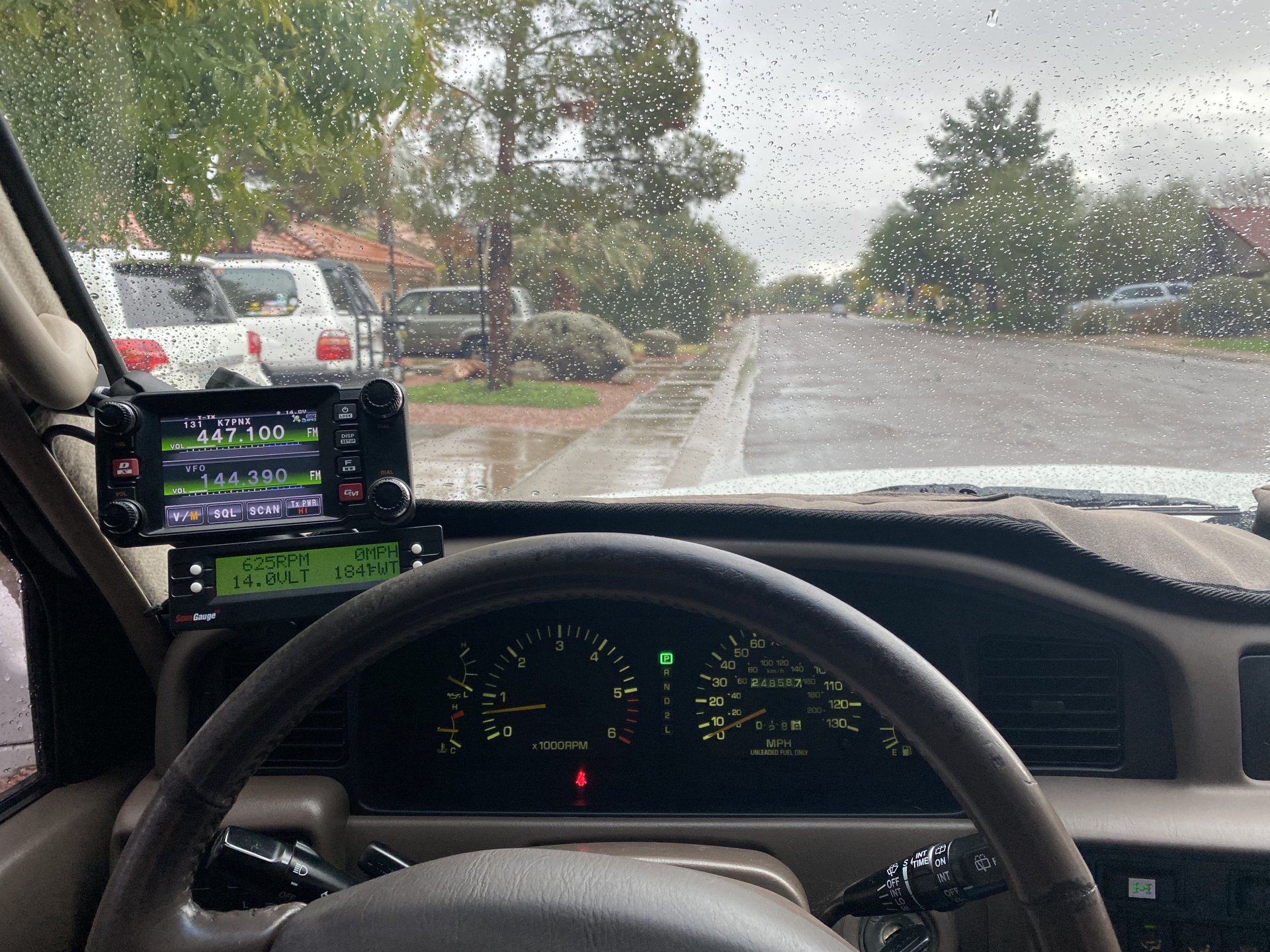

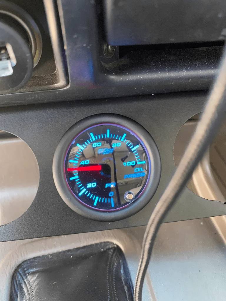

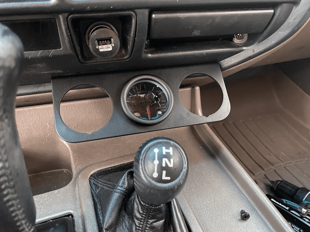

After a bit of an oil pressure scare... I determined that the factory oil pressure sending unit on the dash was going, and indicating low when heat soaked.
So, I installed this badboy:
It's got a lot of fancy colors:

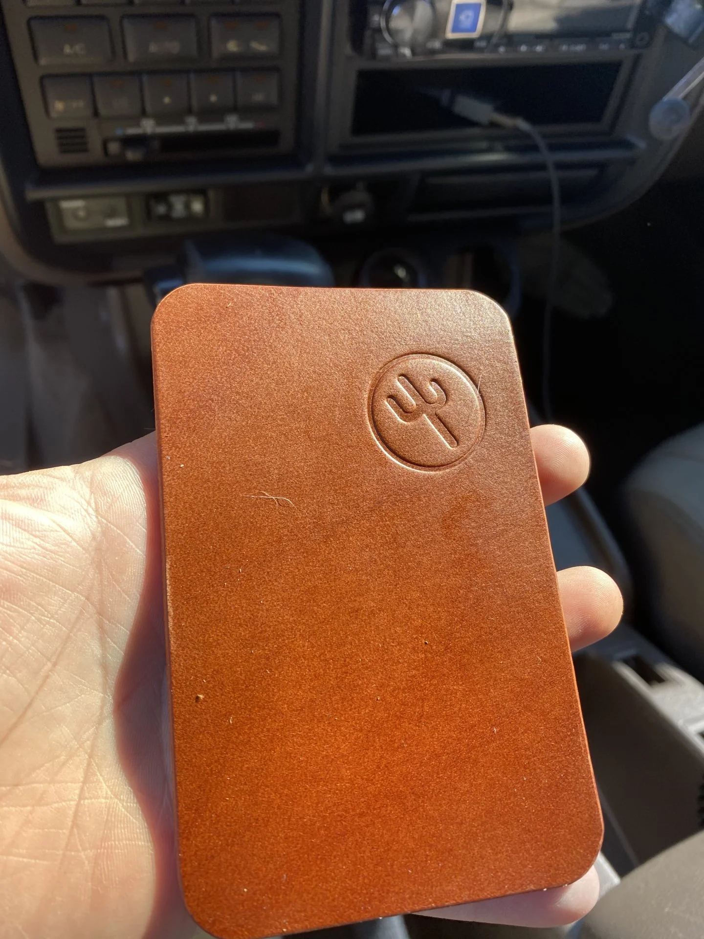

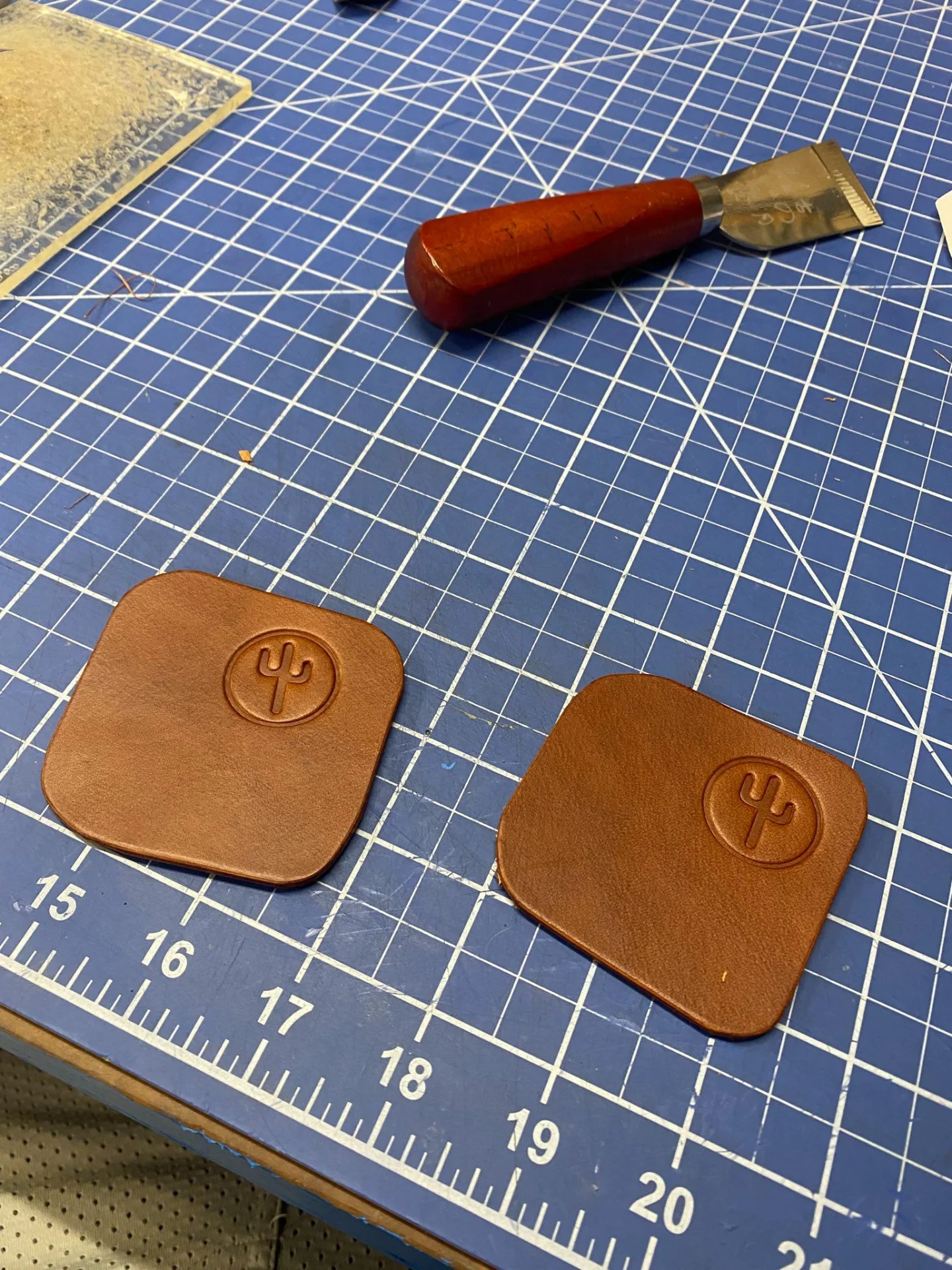

More leather stuff (I do this as my other hobby, found a neat way to have some cross over)

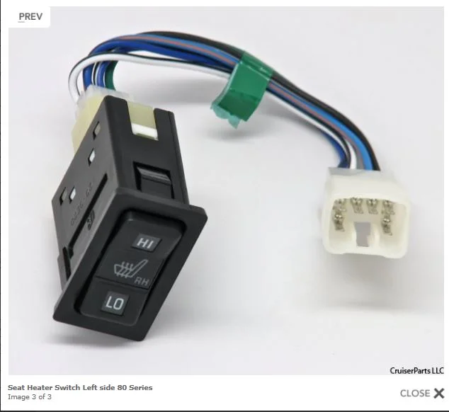

I ordered all the parts to do heated seats with factory plugs when i replace the front leather, here are the parts I ordered with sources and some notes.
Leather Skins + Seat Heaters
Front SkinLseats, Bisque1$ 378.00Ordered 12/8/21https://www.lseat.com/products/1990-1997-toyota-land-cruiser-j80-custom-real-leather-seat-covers-front.html
https://forum.ih8mud.com/threads/97-seat-heater-install-with-factory-switches.1234843/
IBHS1Seat Heater Element2$ 62.98Ordered 12/8/21https://www.newegg.com/metra-ibhs1/p/1J9-005Z-00009?Item=9SIA33D2C93177
84751-60020Seat Heater Switch - Vertical - Left1$ 79.99Ordered 12/8/21
84751-60010Seat Heater Switch - Vertical - Right1$ 79.99Ordered 12/8/21
090IIU-SKT2Female Pin20$ 0.16Ordered 12/8/21
20-16 AWG
090IIU-PIN2Male Pin20$ 0.16Ordered 12/8/21
20-16 AWG
Diode2Needed for some heating elements, not sure when or what kind yet

After a bit of an oil pressure scare... I determined that the factory oil pressure sending unit...was...indicating low when heat soaked.
So I installed this bad boy.
In that knowledge, why do anything?
Your leather goods are on point, btw. 👍
Definitely didn’t need to do anything, but I liked doing it :)
