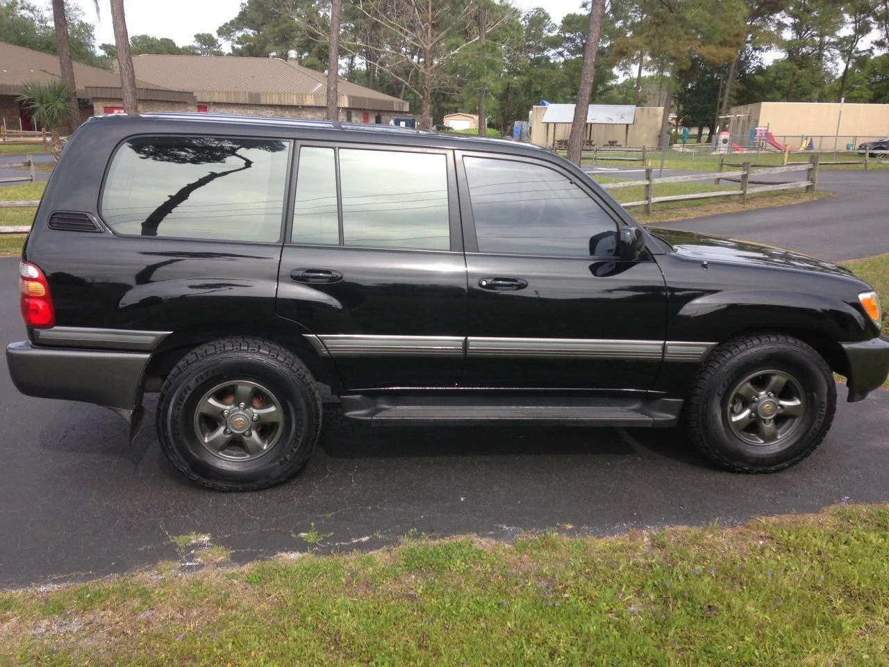

Well, I got rid of my Cummins powered 80 series and bought this a couple of weeks ago. It's a 1999 that was babied by the PO. Anyway, I installed some rear OME 866 springs I got off of craigslist for $40 and cranked up the stock t-bars. I'm not going to go nuts on this one (unlike my old 2000 100 series), but it will get a front bumper and some 275/70r18 AT type tires.

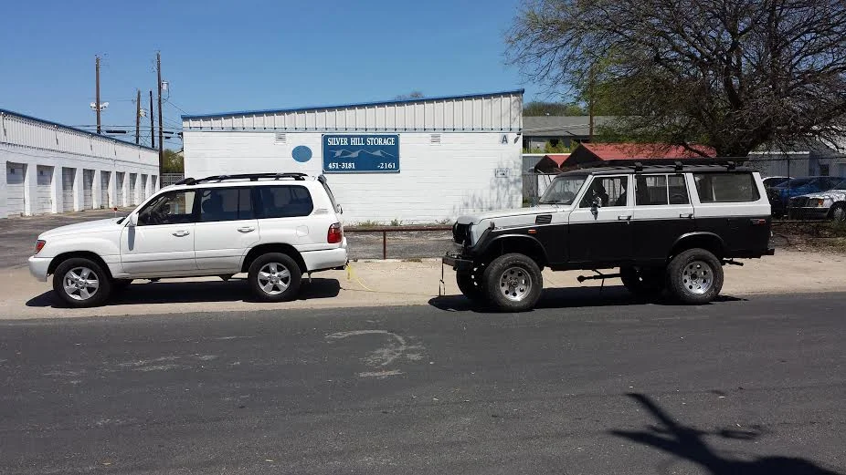

Here she is towing my OM617 powered FJ55.

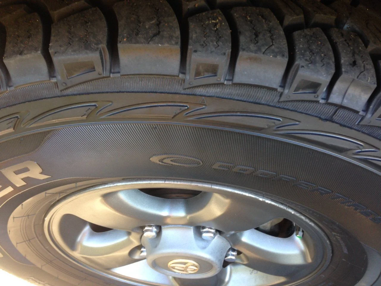

Performed a 5 wheel tire rotation.
Installed SHAGGY101's 10mm front wheel spacers.

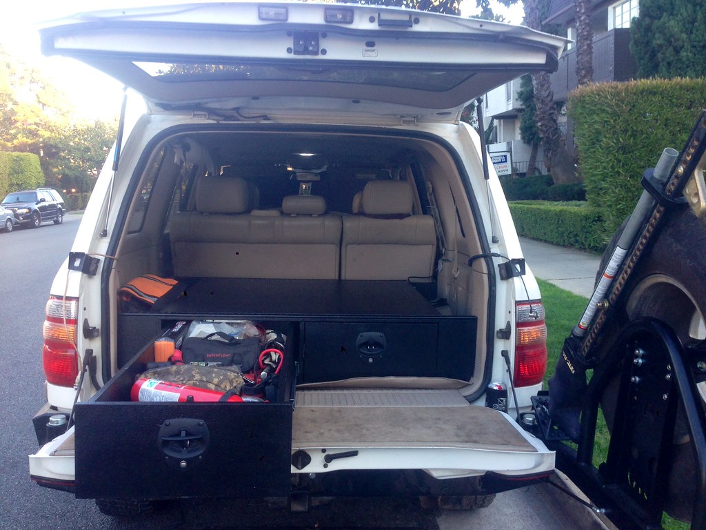

And finally installed the drawers I've been building for months. My wife was so happy to get them out of the living room and garage that she demanded I pose for a picture with them.

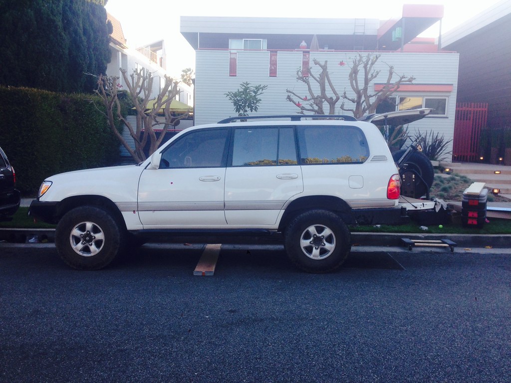

863 Stink Bugging. Actually not bad. The tire comes about an inch above the rear frame. SPC front UCA and torsion bar tweaking are next.
3/4" Monstaliner coated plywood, 36" full extension 250lb TCH drawer slides, recessed stainless steel T-nuts galore, Joints are all glued and Kreg Jointed, Lockable Aegis handles, Logic tie down tracks recessed into the 1" thick top. And of course a PBR in public to finish things off.
I still need to cut and mount the trim panels, install the hold open ball catches, and install my 2.0 fridge slide design.

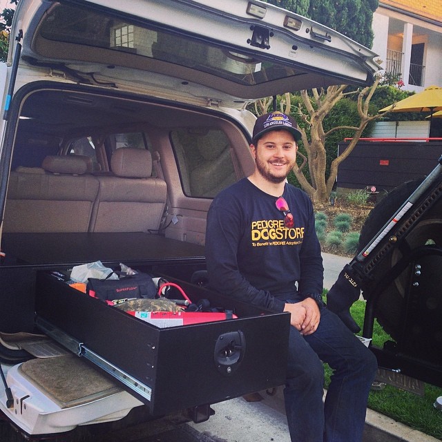

The wife's social media picture. Free Pedigree shirts from my old agency = the go to wrenching-wear.
Those look great! Nice work Klaus, but I always assumed you were a German Shepherd... o_O
Plot twist: he actually is a German Shepherd, that's his pet in the picture.

That's some twilight zone s*** right there... MIND. BLOWN.

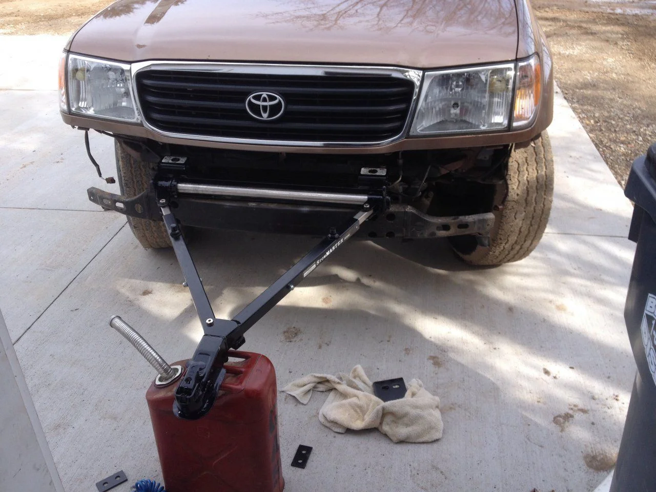

Installed a tow bar stowmaster 5000 so I can drag the 100 behind our tour coach.
