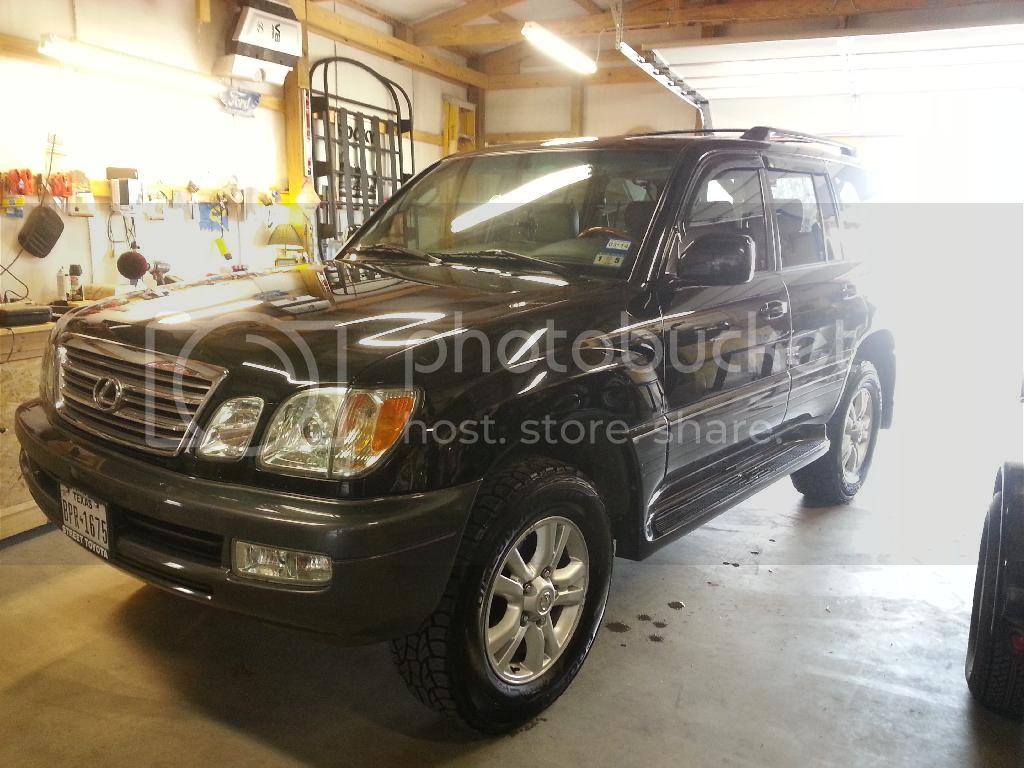

Plasti-dip'd front and rear chrome pieces in anthracite gray. Close match and something other than black.
