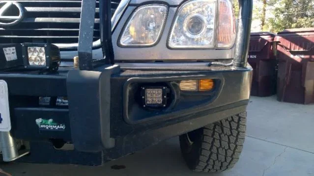

Removed the Iron Man round halogen fog lights that came in my bumper. I am replacing with Rigid Dually D2 in a wide pattern. The factory fog switch and factory wiring will control the Rigid wiring harness. I cut a tiny piece of plastic at the back of the bezel and test fitted the mounting position. I just need to get shorter 5/16 carriage bolts to wrap up.
Pic? I put HID bulbs in mine and haven't been thrilled with the light using the Iron Man housings.
This is an installed shot. I will try to grab a light output shot later.

Here are a few shots of the finished work.
Note, you will need to cut a little plastic off of the top backside of the bezel as the Rigid bracket hits otherwise. It's quick and easy and you can't see it from the front.
Kirk, Can you adjust the lights? Also, are these flood type? Can you "legally" use the leds pods as fog lights? Wondering if they are too bright for incoming traffic.
Frank
Are those the same lights as you have on top of the bumper? If so why did you choose to run them in both locations?
Frank
Yes, they are adjustable. They are Rigid Dually D2 in a Wide beam pattern. (30 degree wide pattern)
They are not DOT approved, but neither are the OEM ones in the Iron Man bumper. I have them aimed low for fill half way in between the front of the truck and the low beam aiming point. I used them this am for 45 miles on the way to work this morning and didn't get flashed once. I'm very happy so far.

Nope, they are not. The ones on top are Dually D2 in a driving beam pattern. The ones in the bumper are Dually D2 in a wide pattern aimed low, half way in between the front of truck and the low beams aiming point. I like a nice amber light for severe fog and or white out snow conditions which is why I bought the snap on amber covers for these, I tried the covers this am and they do a great job. I prefer the whiter output of these without covers for normal driving.
