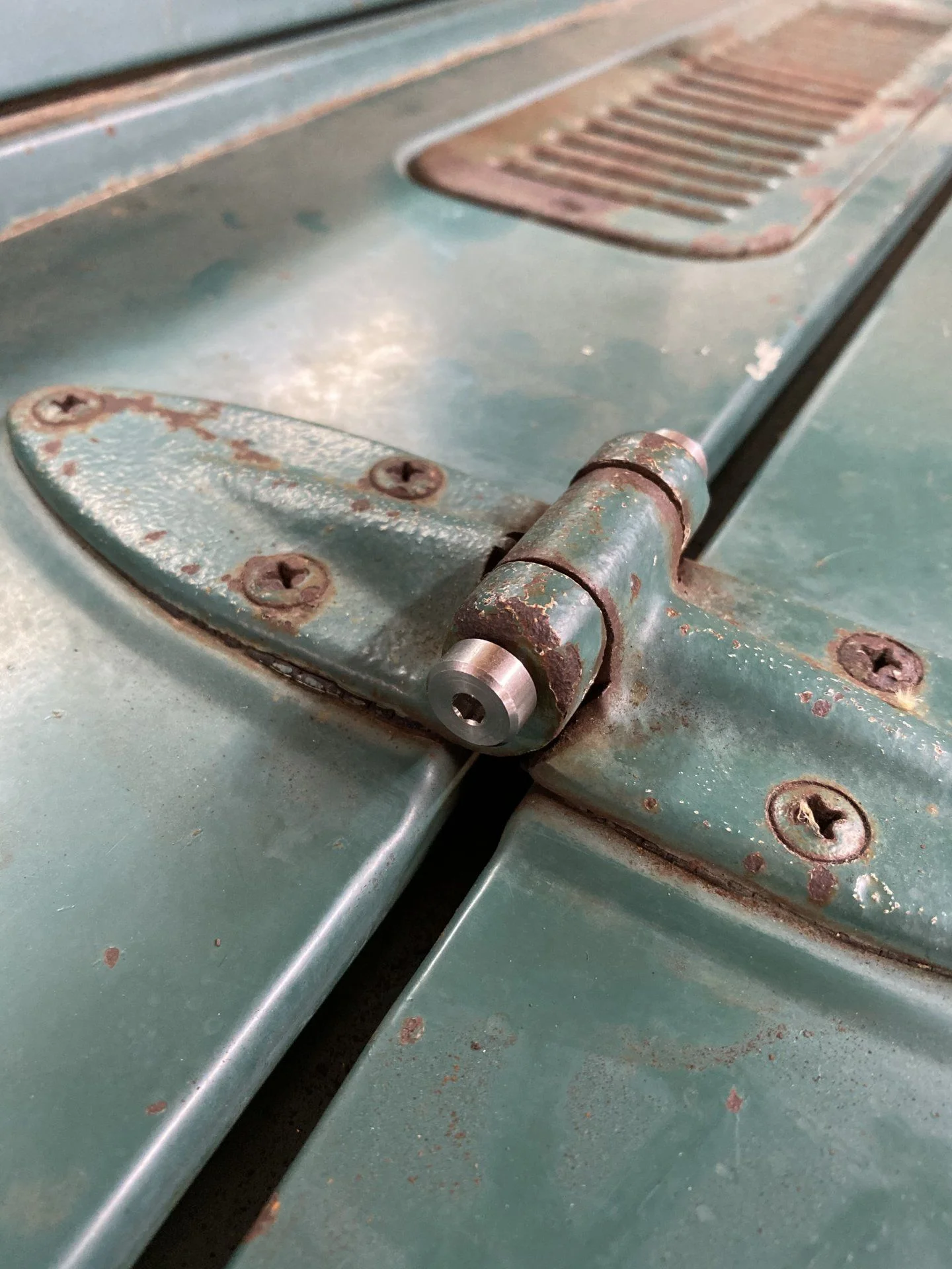

@SMG hood pins.....
I installed them without removing the hinges this time. Just put a pointed tip on my air hammer and they popped right out.

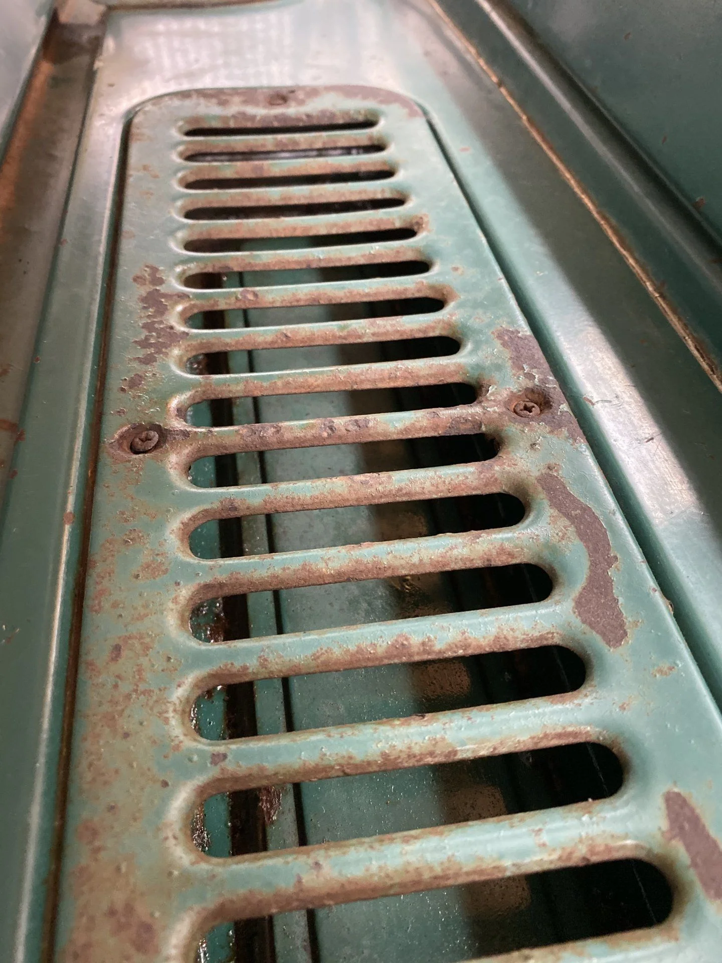

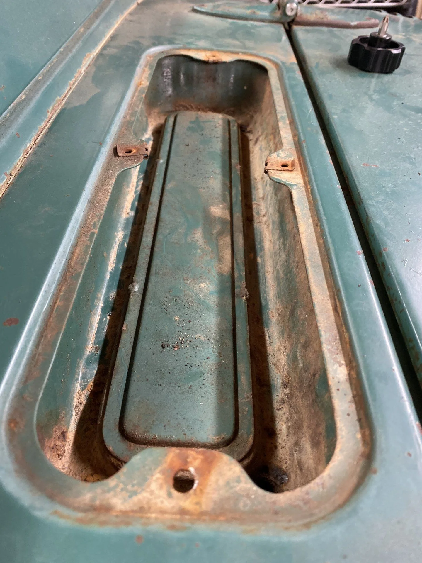

Next I used my air screw hammer and got the tiny OEM screws loose on the vent and cleaned it out, added rust converter and of course some Fluid Film.

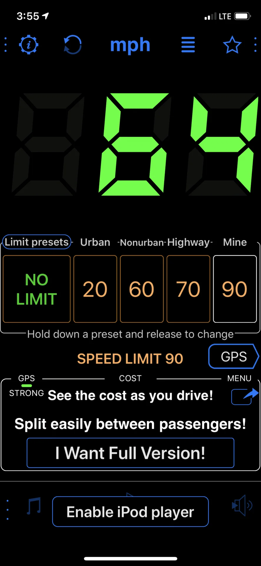

But hey, you guys don’t care about all that....., you want to know how it drives.
Good.
In fact, I’ll go damn good......65 mph uphill with one finger on the wheel good .....

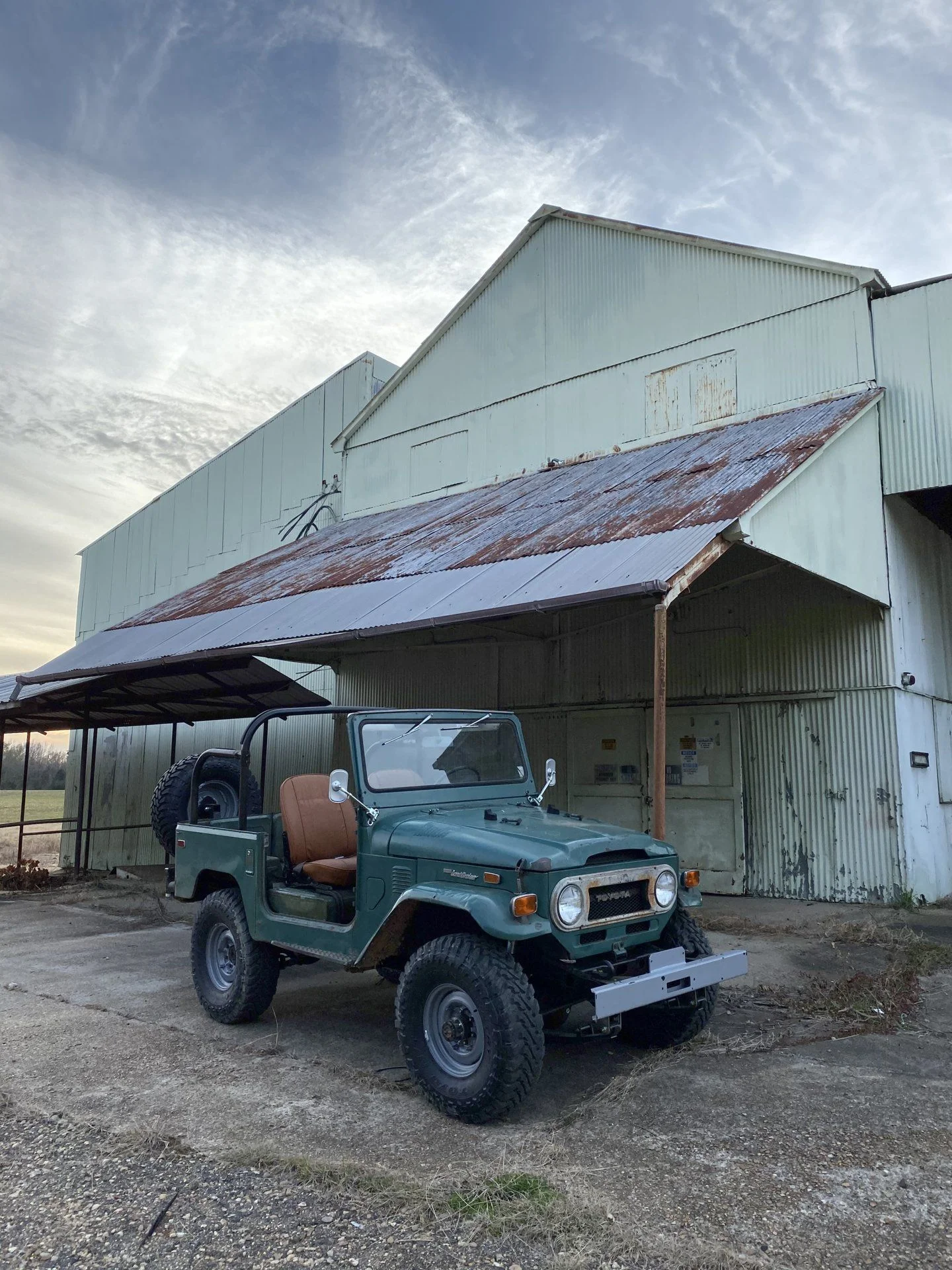

Awesome ride. 22 miles and back home and nothing is leaking except the damn exhaust.

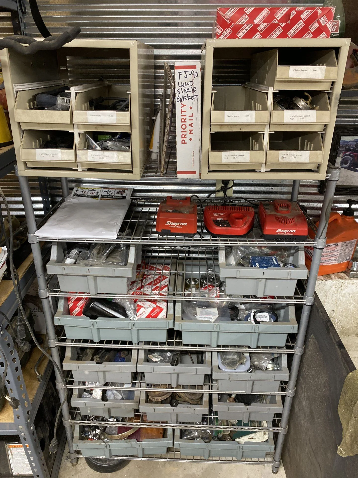

Today I decided to clean it all up and get organized a bit instead of working on Weenie 3 after work

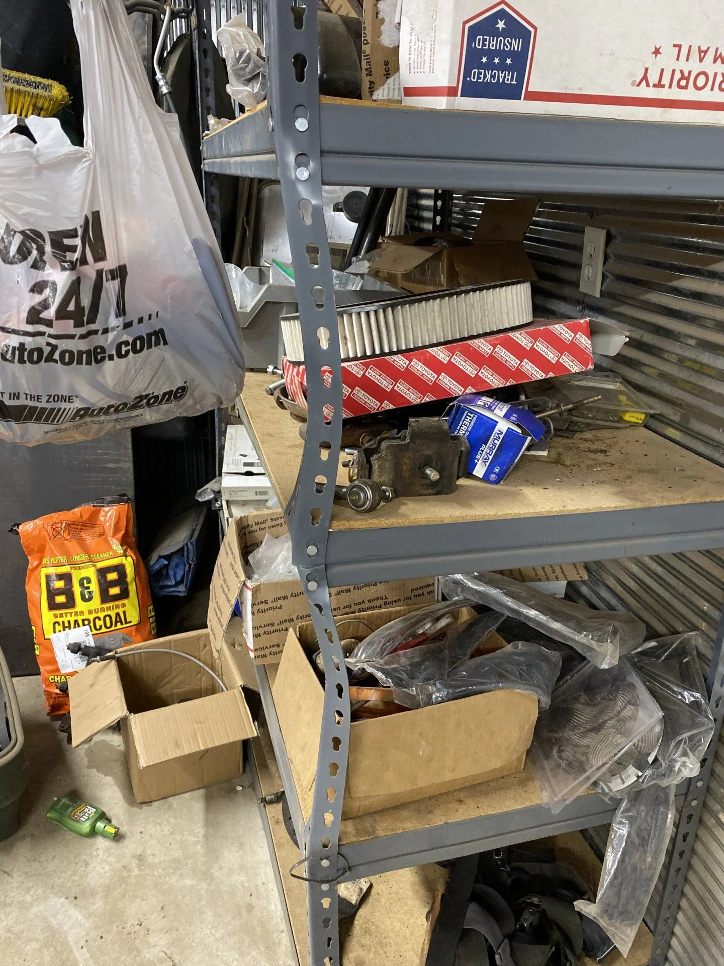

I bought a bunch of random 40/55/60 stuff from @Onur and had to organize it
The best thing is the entire Long Wheelbase FJ45 full of crap I’m taking to the dump tomorrow

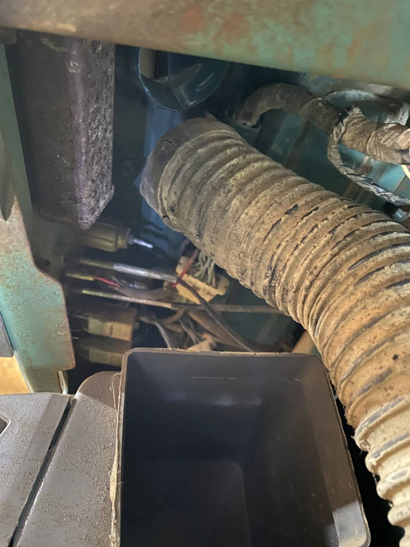

I was digging around under the dash getting the 12v to work and realized the defrost hoses did not go all the way to the top. Is Specter the only
CCOT makes These inner light guards out of ABS. They fit tighter than the metal ones so they might just keep mud out.

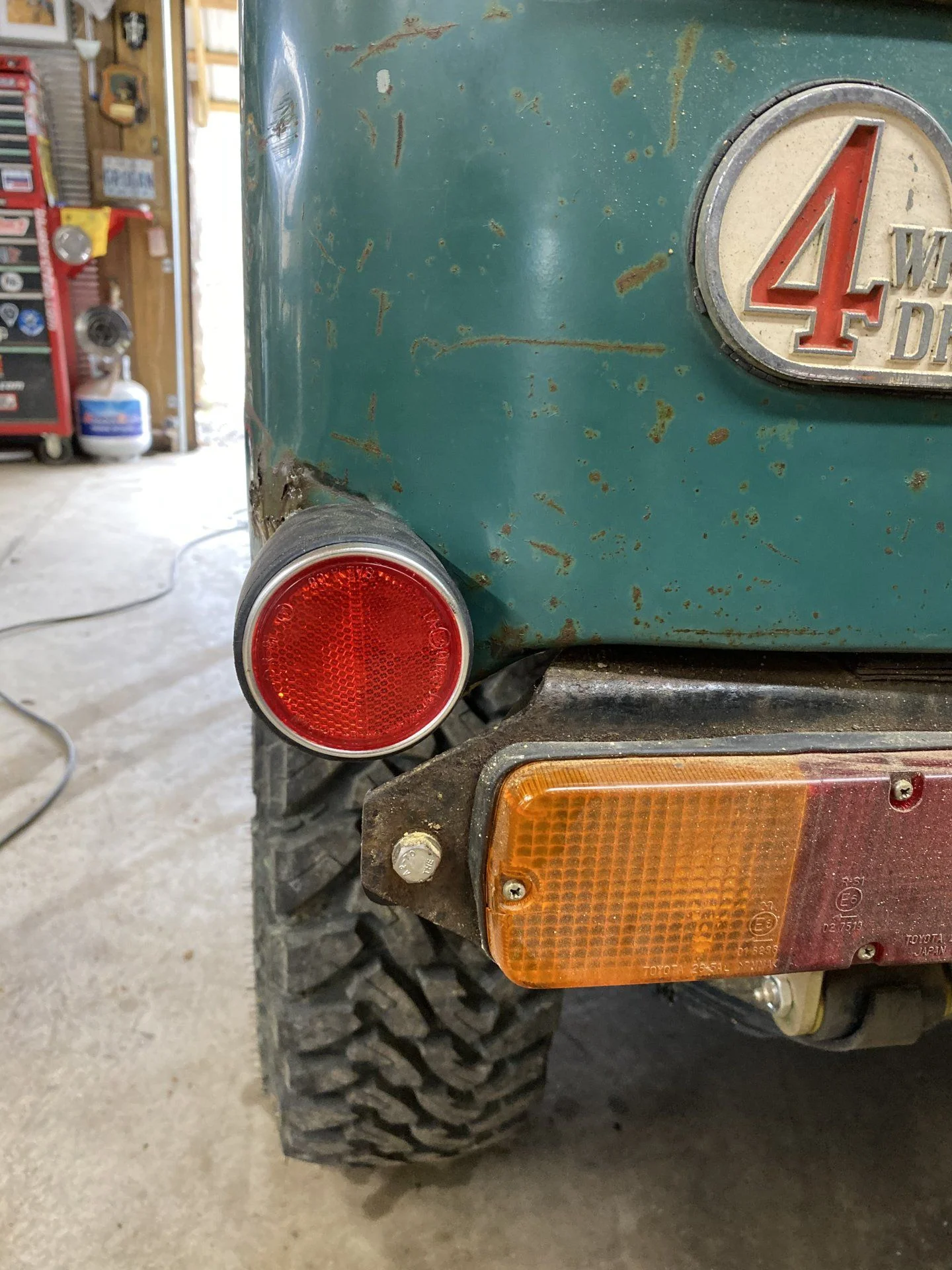

The drivers side reflector was bad so we got a new one
Finally, the passenger side blinker stopped blinking. 9 times out of 10 adding a jump/ground wire to the metal on the inside of the housing will fix it.After testing that a good ground made it blink I fished a new ground through the post and it’s all good now.

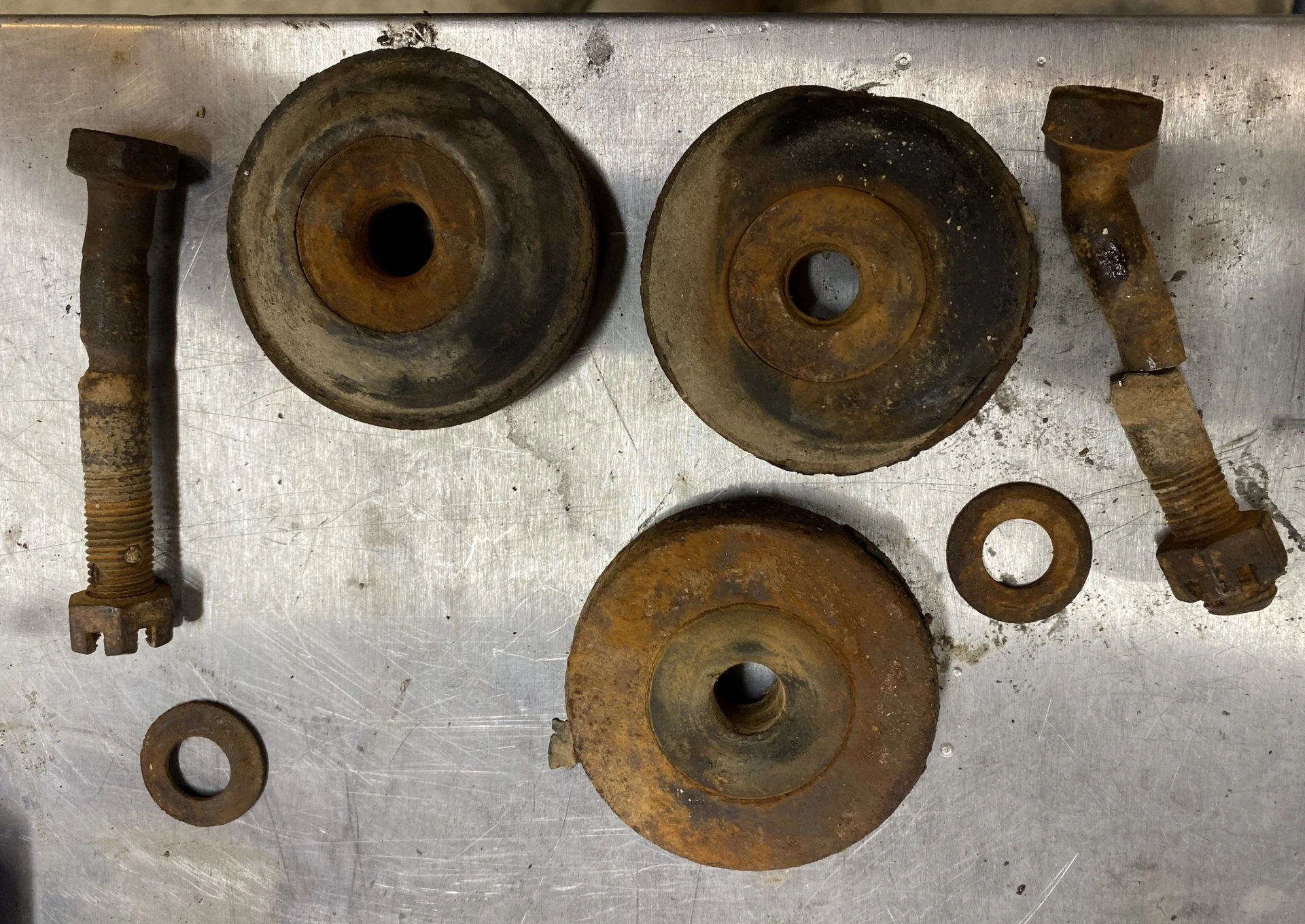

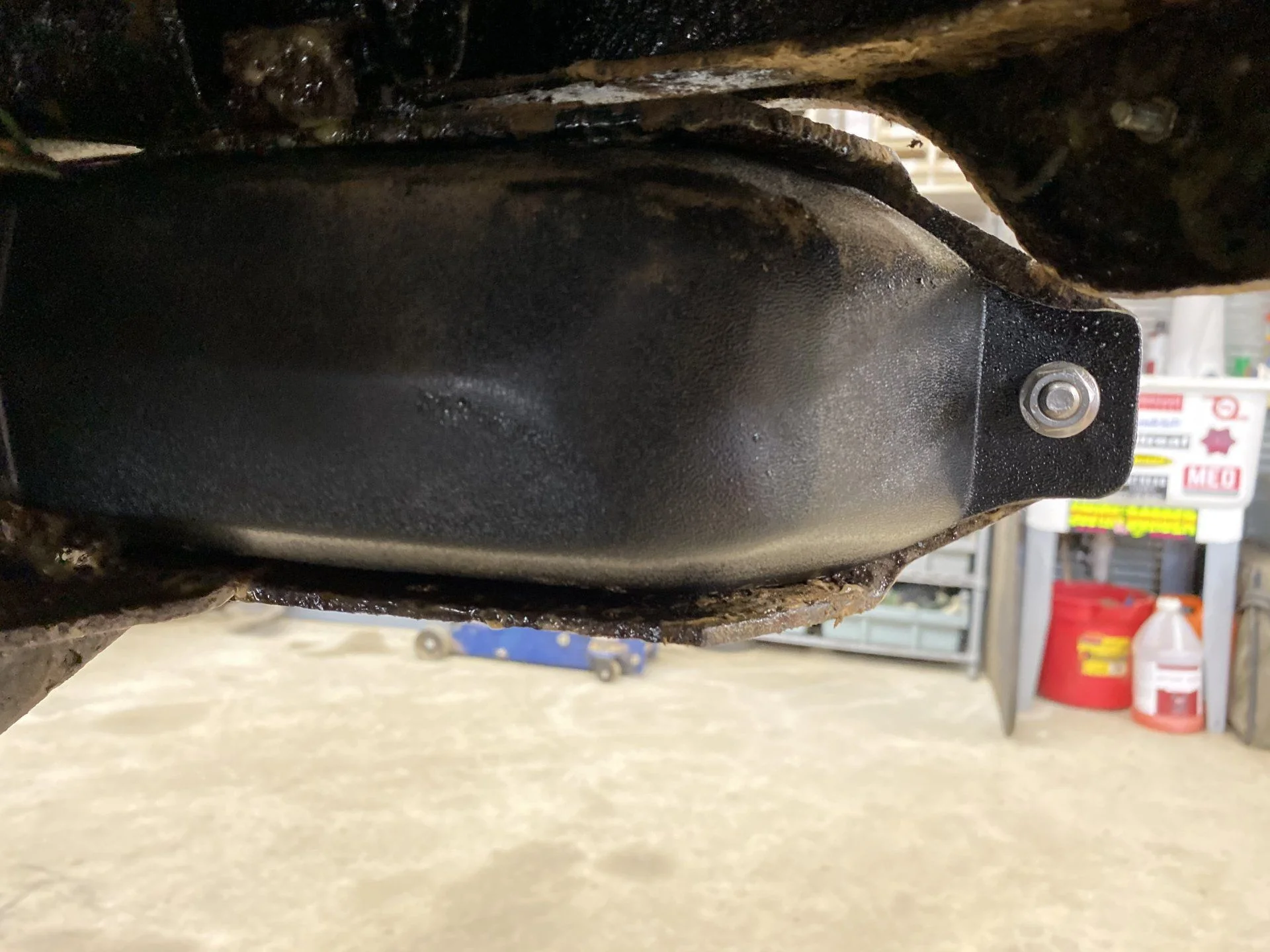

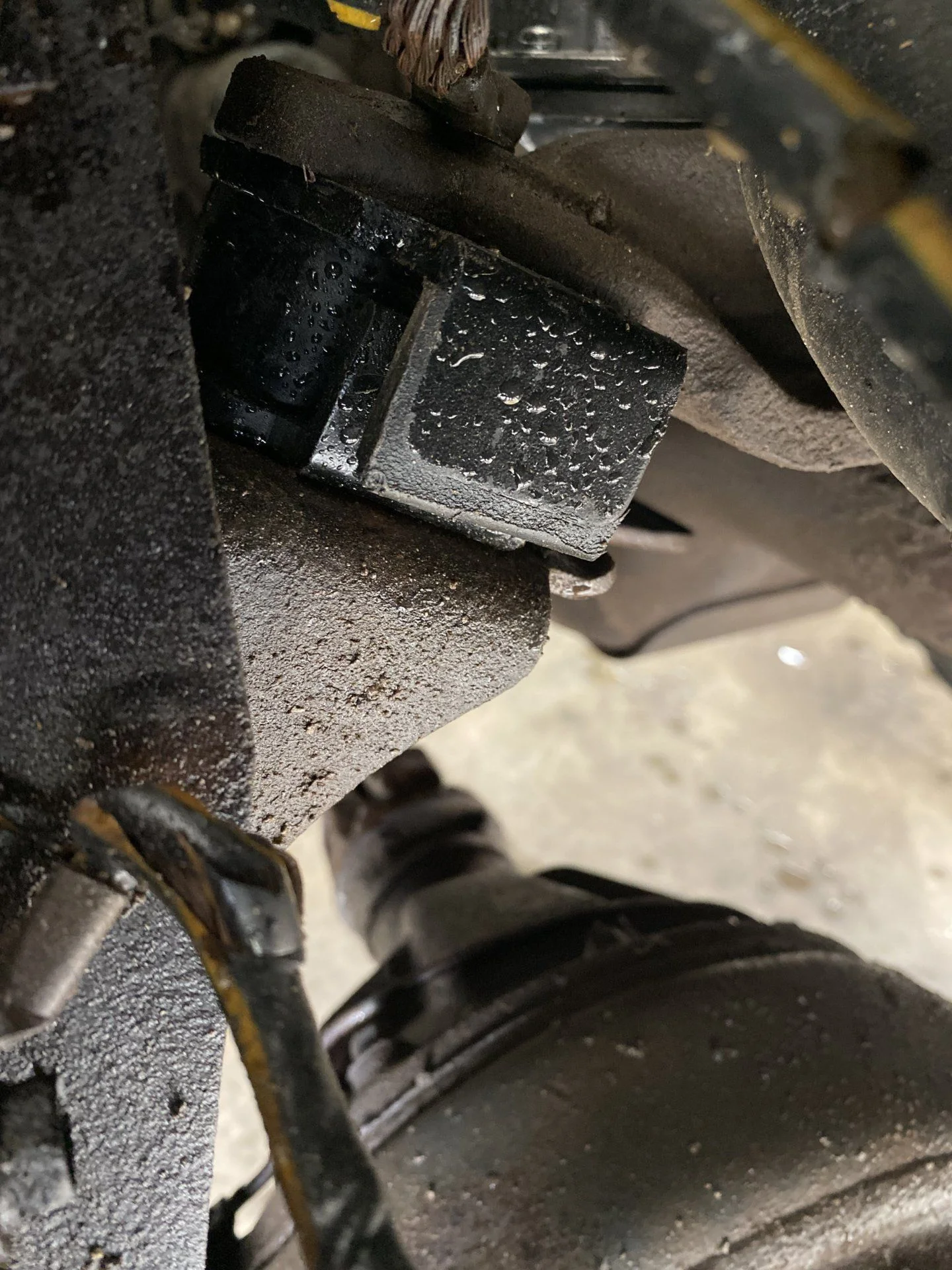

One thing many people overlook on FJ40s is the rear motor mounts. I rarely see people change them at the same time they do the fronts.
I knew this truck had the fronts replaced at some point because the metal fan/shroud clue.....you can always tell that they jacked up the motor without loosening the shroud.
The rear motor mounts and bolts were hammered.
I went ahead and changed the fronts while it was getting fresh stuff.

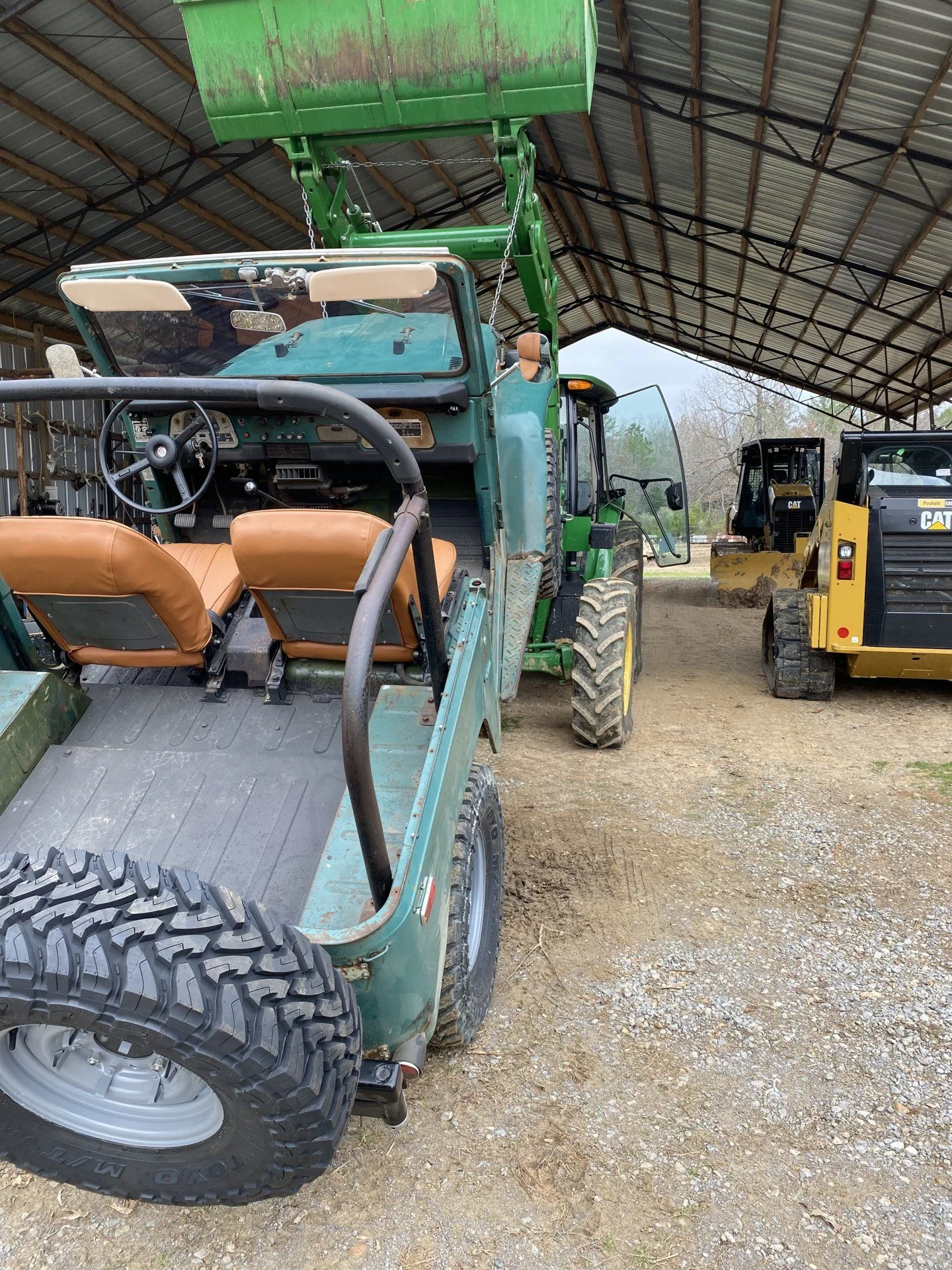

Then I took it for a spin before taking it to the equipment shed and blasting the underside good for the upcoming Lizard Skin/Fluid Film bath.
This truck is not tall but it does sit about 2” taller in the front and 4” in the back of my truck. Tires are about 1” bigger and I have a hard top on so I’m saying it got a good 2” overall lift. Perfect IMO
