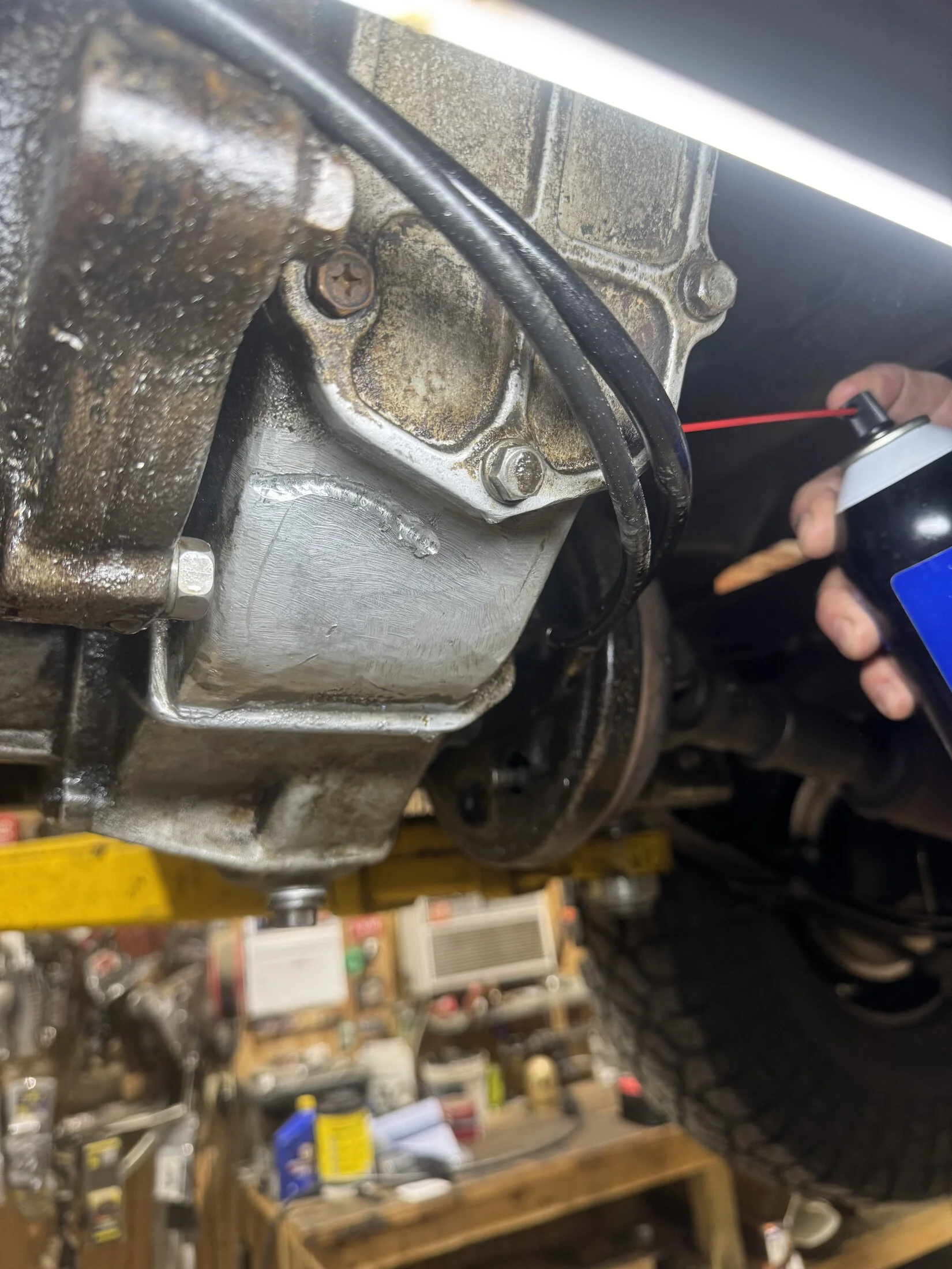

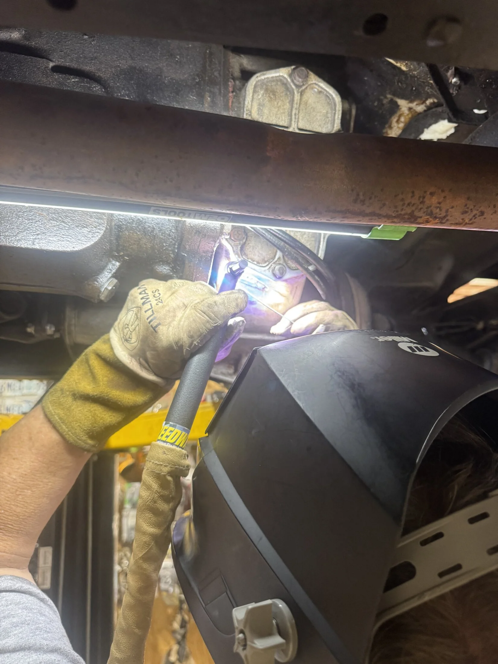

The Wizard is going to weld up this leak later in the week and then it's getting loaded up for home

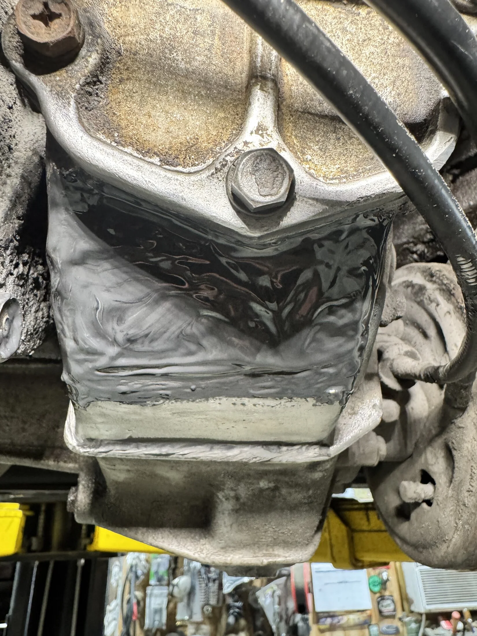

Update on the crack in the Tcase repair.
We drained the case. Cleaned it good and the Wizard laid down some heat on it.
Problem was, this welding made the repaired section spring another leak.
Greg decided this was gonna be a bigger mess and we decided to try to put the final seal on with some Marine-X epoxy I had here.
Let it sit overnight and I took it for a drive.
Still leaking.
So I ground all that Marine X off and just laid on a thick patch of JB weld.
I'll see how that works tomorrow.
Fingers crossed.
You have spent twice the time it would've taken to swap in another case......
Just pointing out the obvious...
Not true. If you
A) don't have one
B) it's a 4 speed in a 1970 and the torque tube is in the way so the motor has to be dropped in the rear
Not true. If you
A) don't have one
B is a trivial step that everyone seems to blow up into some big scary thing that its not
how much $$$ have you spent on the band aid that 100% will fail at the worst possible time?
I've had this one out 2 times. I'm well aware of what it cost my customer in time.
I've spent $20 in band aids.
