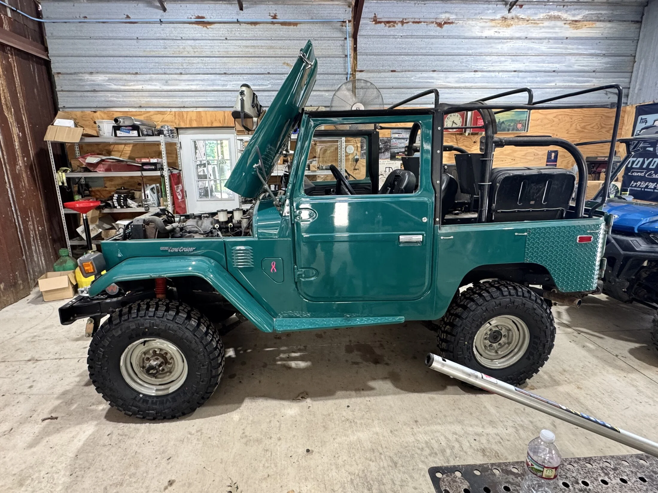

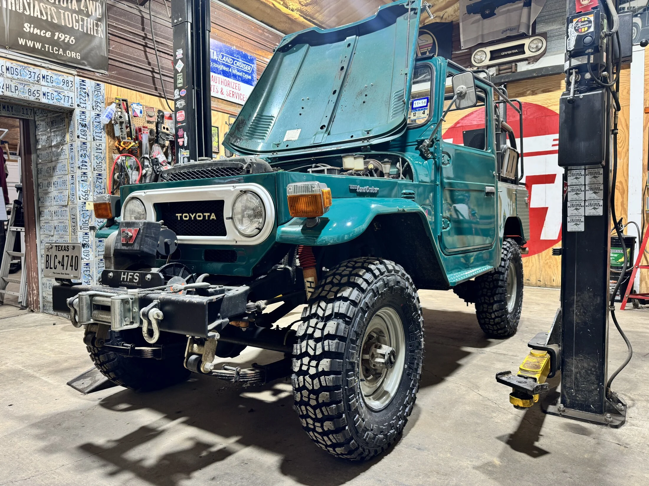

A few years ago I was in a hotel parking lot hauling Powda Blue back from Houston. Bryan and his girlfriend swung by and we talked about Cruisers. He apparently had a pile of them and he wanted me to possibly work on one in the future.
Fast forward to last month and I realized I was going to have a gap in my projects due to some bad shipping I have going on out of Saudi Arabia so I posted on my @89nolder page on Instagram that I needed a project.
Bryan jumped in line and we finally got our schedules together on Sunday and he dropped it off.
He's got all kind of toys over there

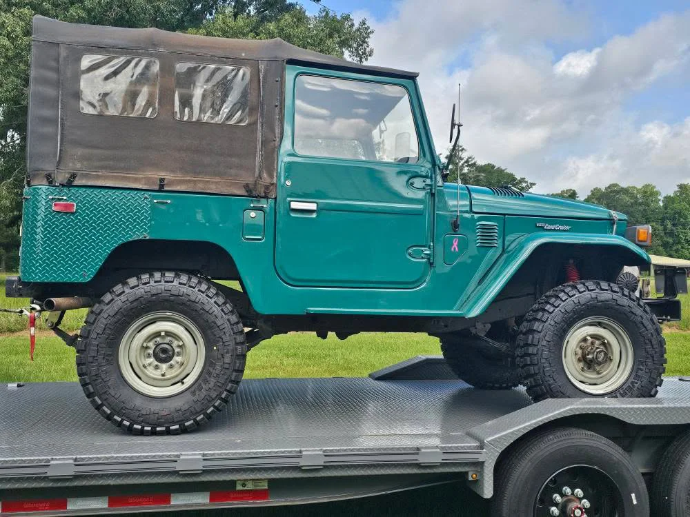

The inspection sticker reads 2014 ... this thing has set up a while.

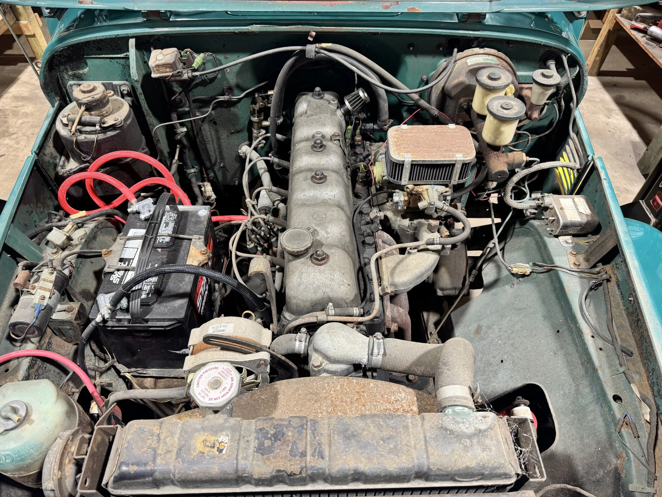

From the looks of it, someone about 20 years ago did a refresh on the paint and added some CCOT goodies.
Here are the "before" photos.

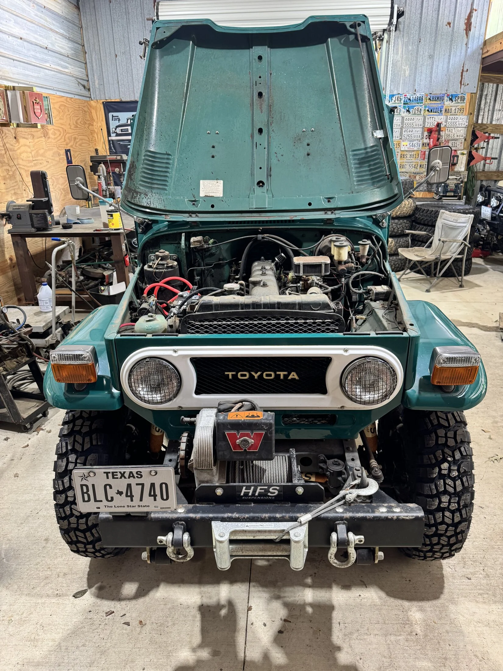

I spent Day 1 with Higgens ordering and arranging about $10,000 in parts and starting disassembly
First things first. Flip that bezel.

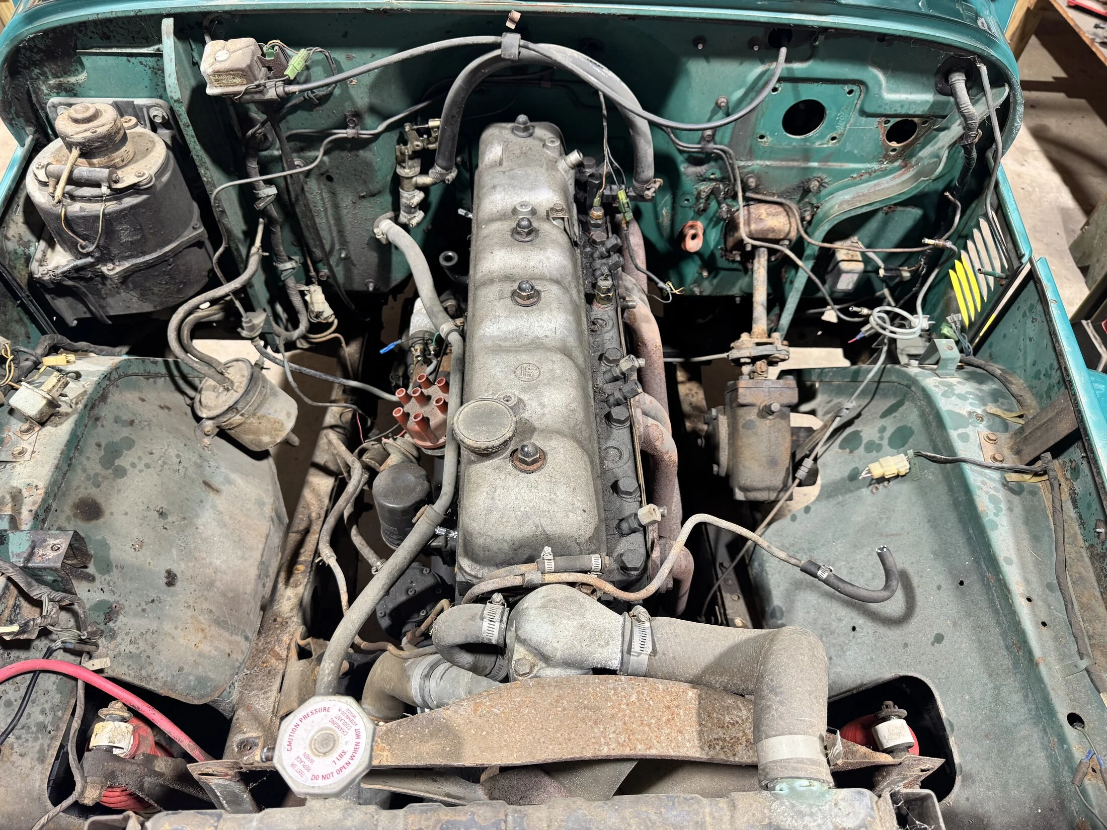

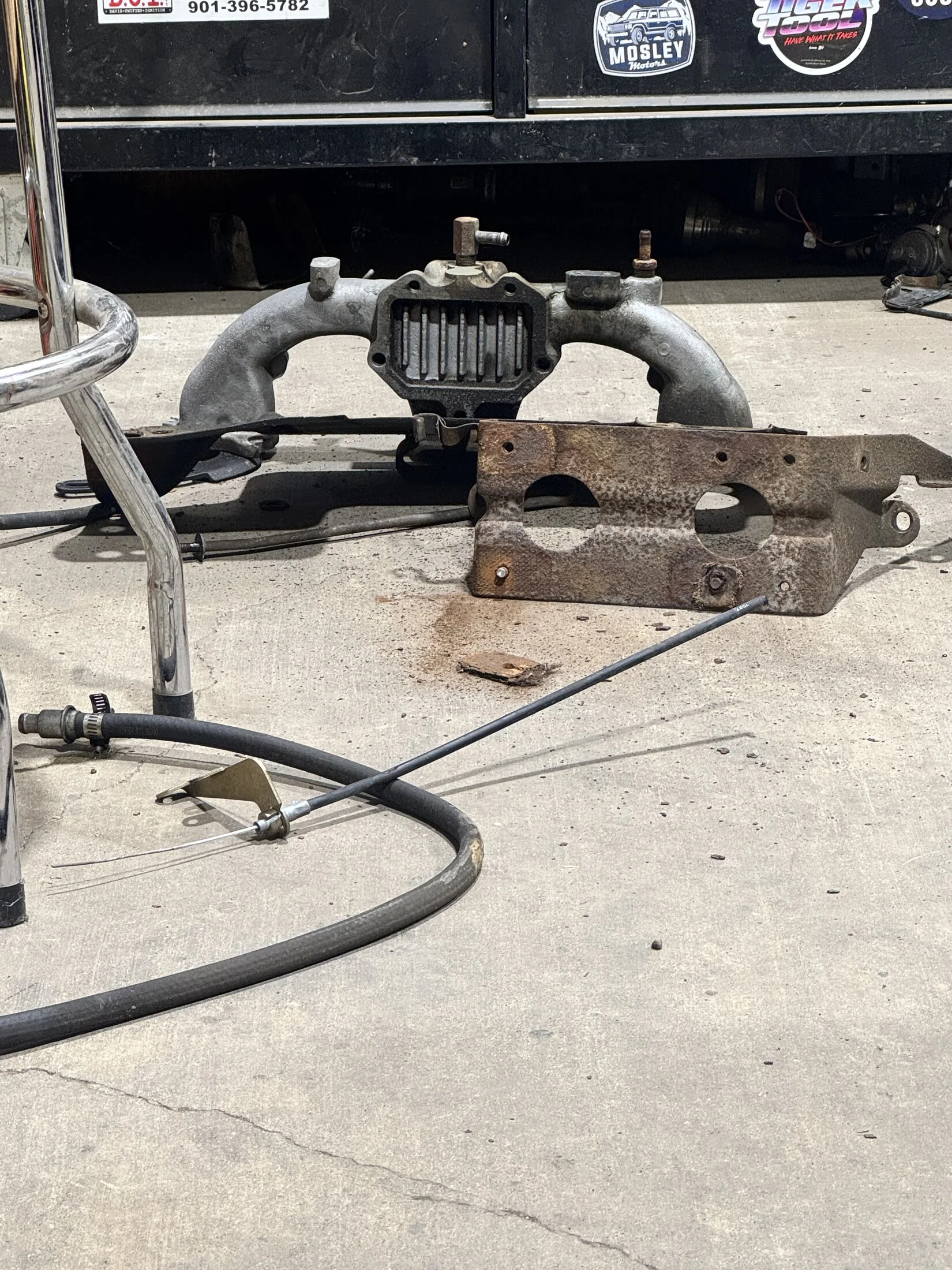

Disassembly has begun. More to come.

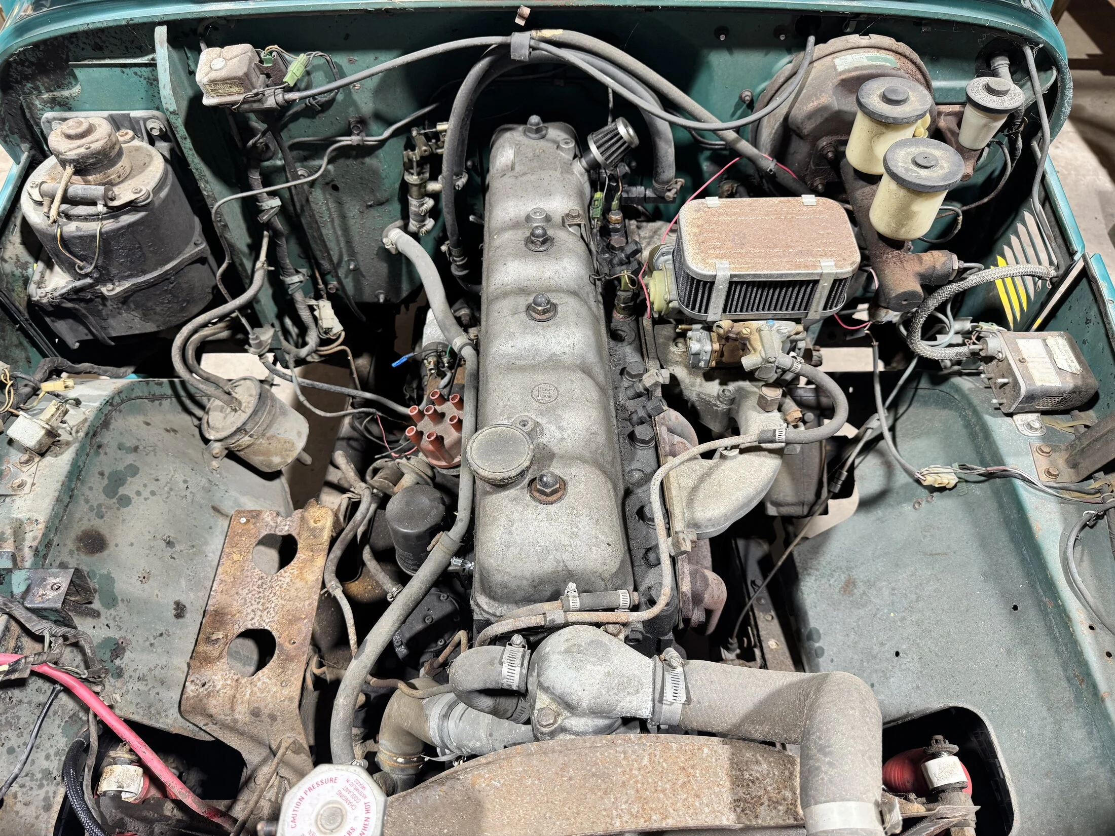

The stripping continues. I'm about to roll it out and drain the coolant and pressure wash the engine and engine bay
Making a powder pile
Damn it's hot out there.
Fluids all drained and 11 years or dust and dirt are blasted out. Need to remove a few more parts for powder

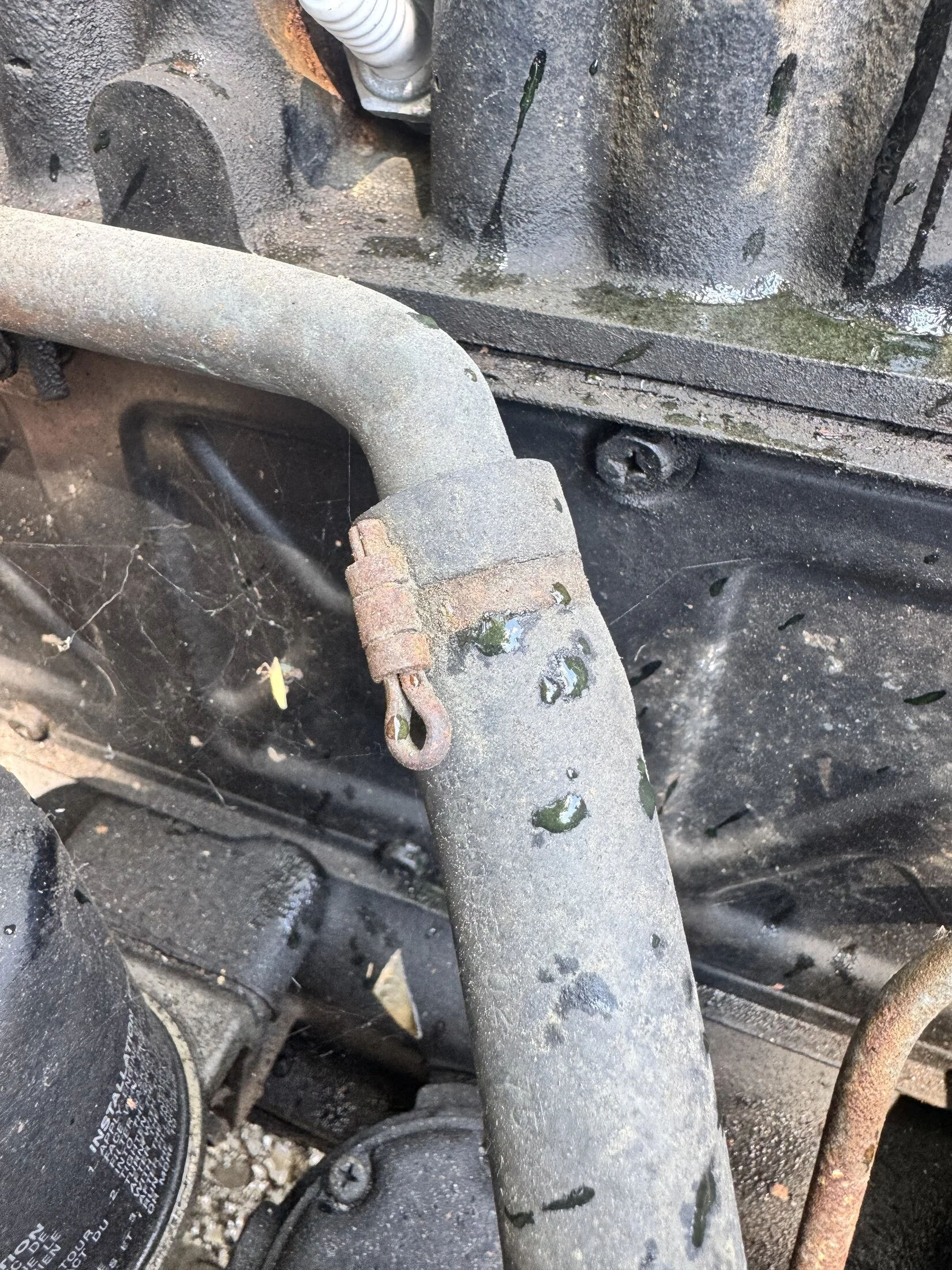

It's wild when Cruisers still have original hose clamps
:popcorn:
Interested to see if you'll bypass/remove the EGR service indicator box or leave it as is. I've thought about pulling mine to simplify things, but the speedo still works so my attention goes elsewhere.
I don't mess with them if they still work.

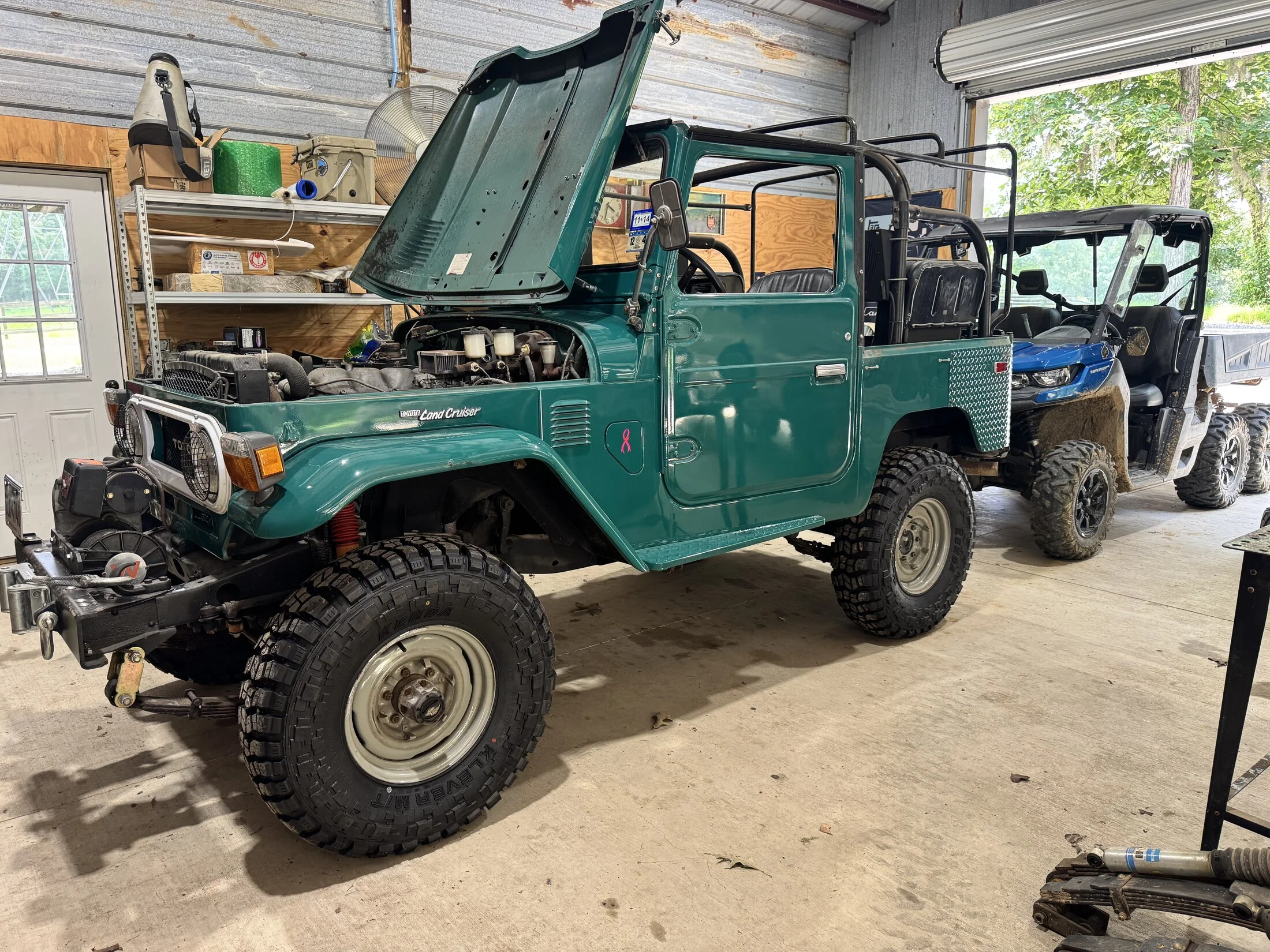

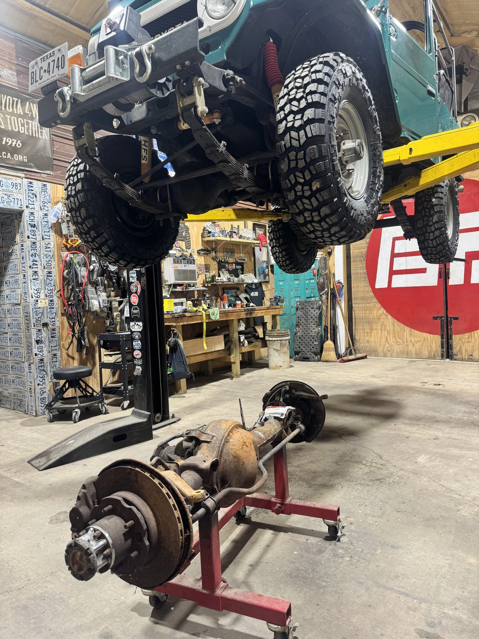

Took all the parts to Powder Keg yesterday and then I worked on another guys truck.
Today, since I'm waiting on parts I'm tearing down an FJ60 axle I bought for the knuckles and 3.70s.....this truck is getting the knuckles and another Mud member is getting the 3.70s in August
The 1975 is the first year of the 2F but the last year of the horrible front drums (in the US)

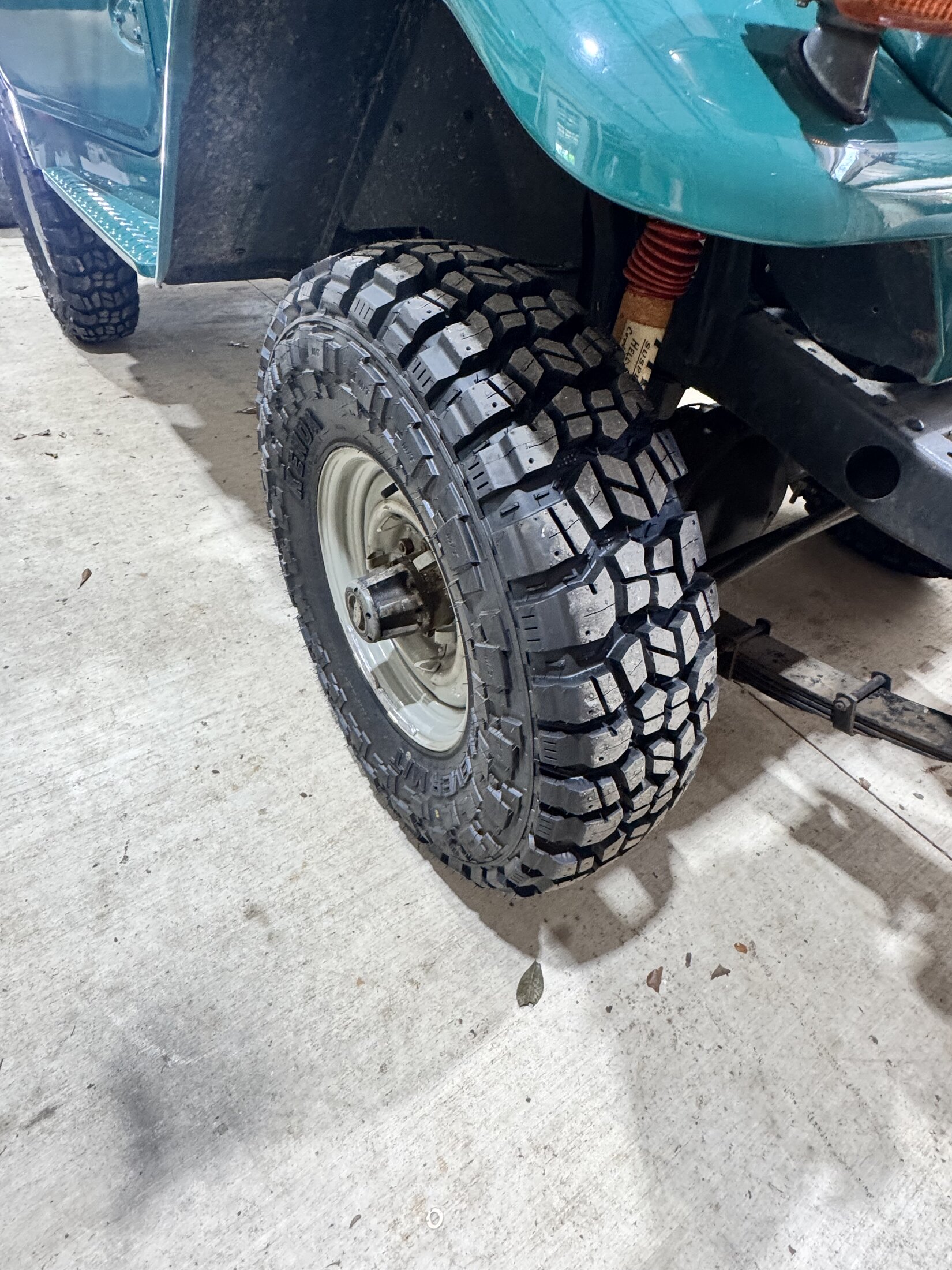

puts on nice new tires (33x9.5?) before going to the shop! thats a nice owner
what color were those wheels painted? it works with the green
No idea but I agree

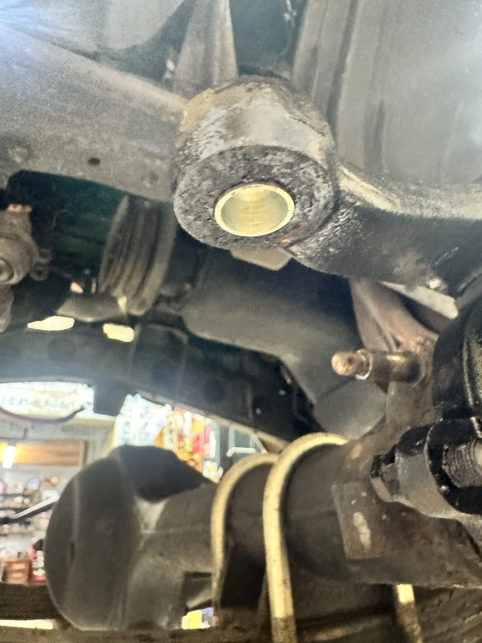

Built back knuckles today.

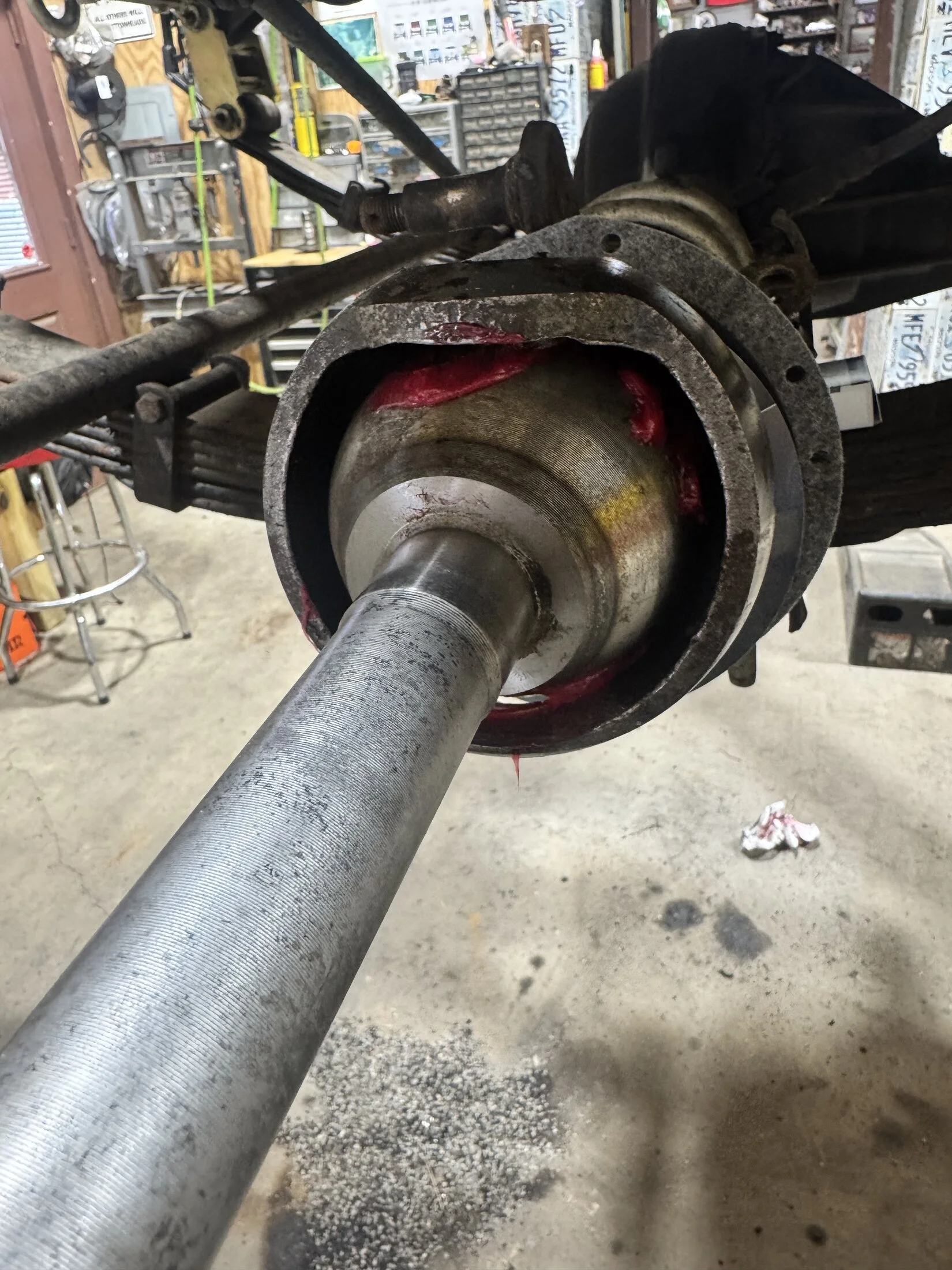

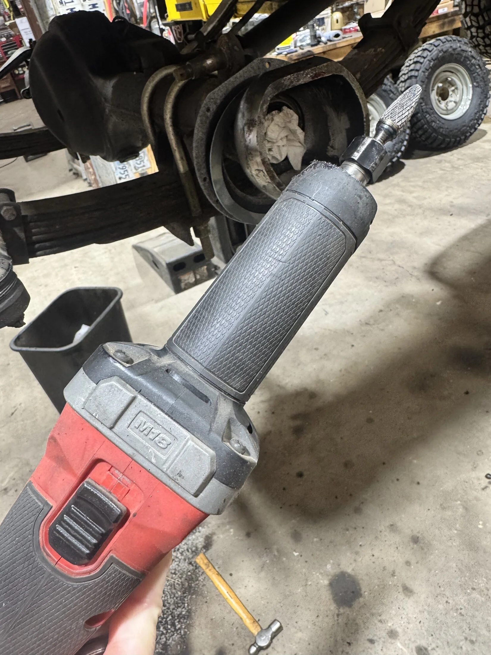

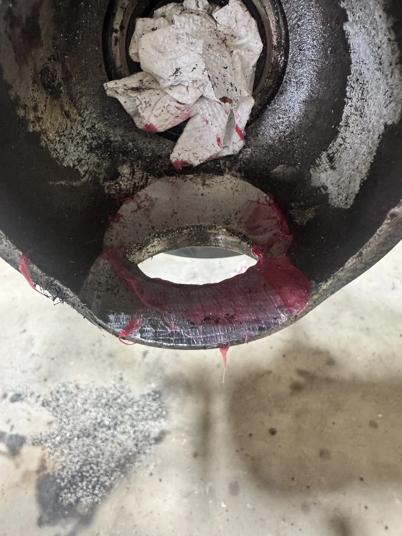

When swapping from a pre 78 axle housing, in order to use the larger 60 series birfields you have to open up the top and bottom of the axle housing
The carbide bit is the best tool for this work
Test fit your larger birf until it fits easily
Here is what you grind. Top and bottom

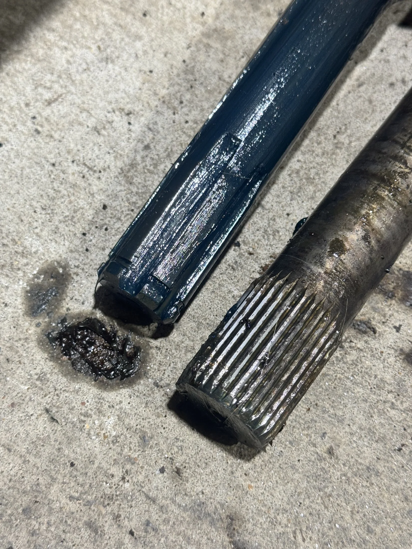

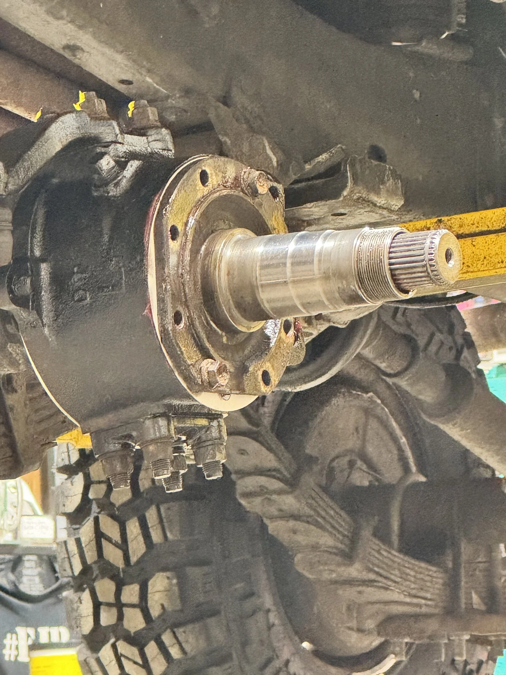

The 1968-1975 birf is a small weak 10 spline deal.
On the short side, you can use the 60 Birf and inner axle. On the long side you must use the 68-75 inner axle and mate it to the 60 birfield.

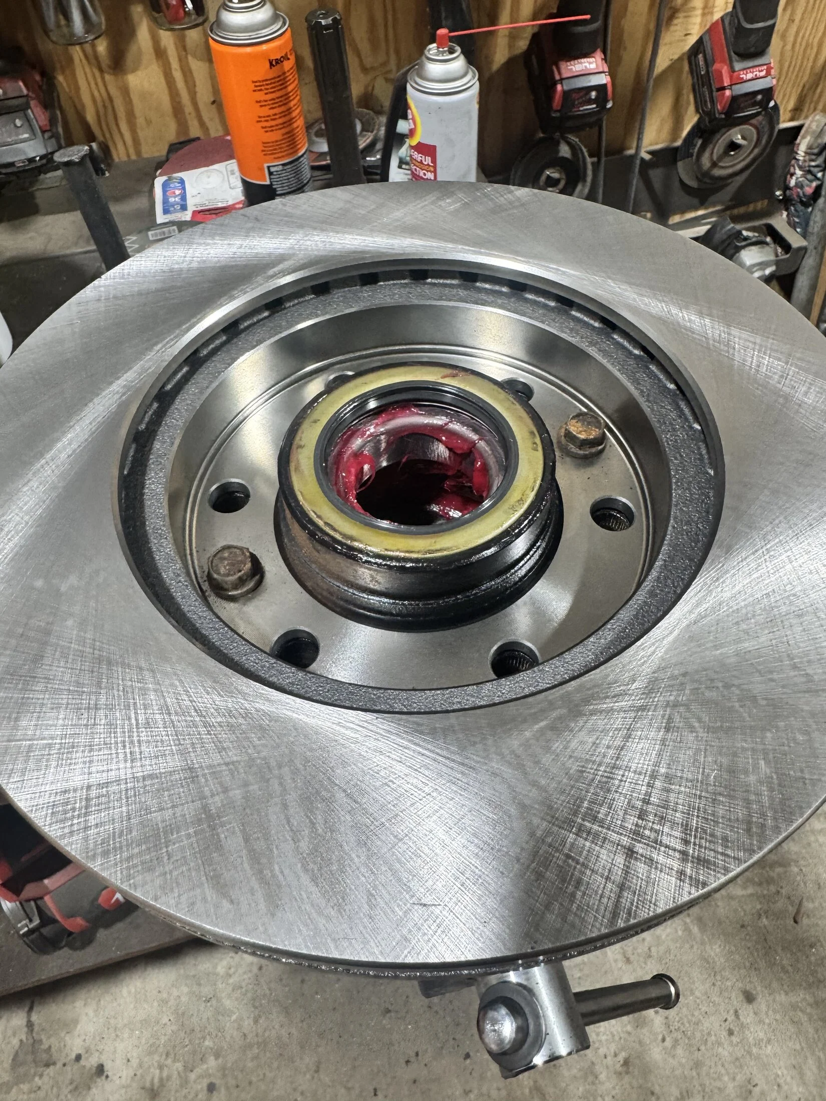

Waiting on a set of backing plate eliminator spacers from Valley Hybrids to finish out the knuckles

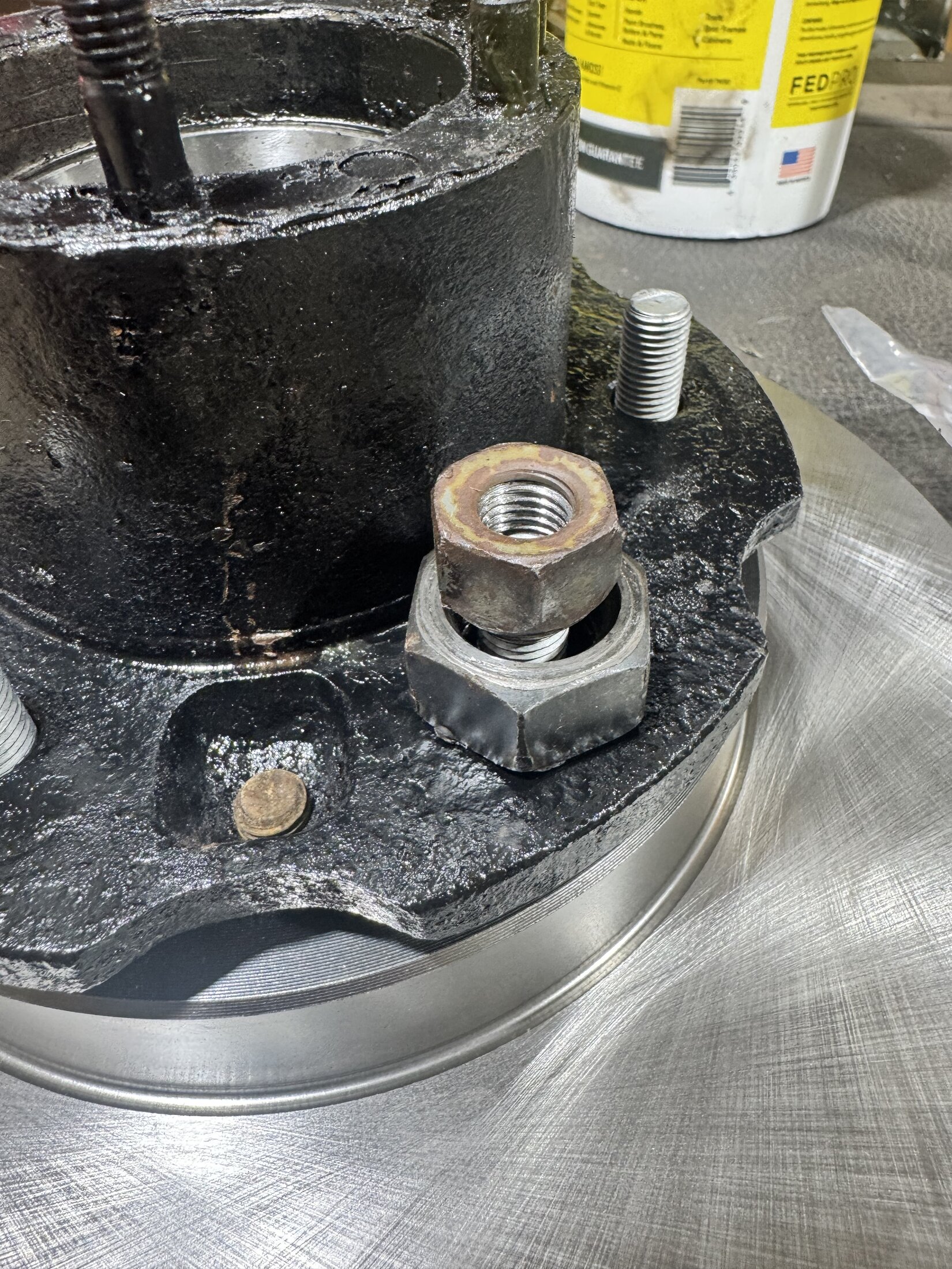

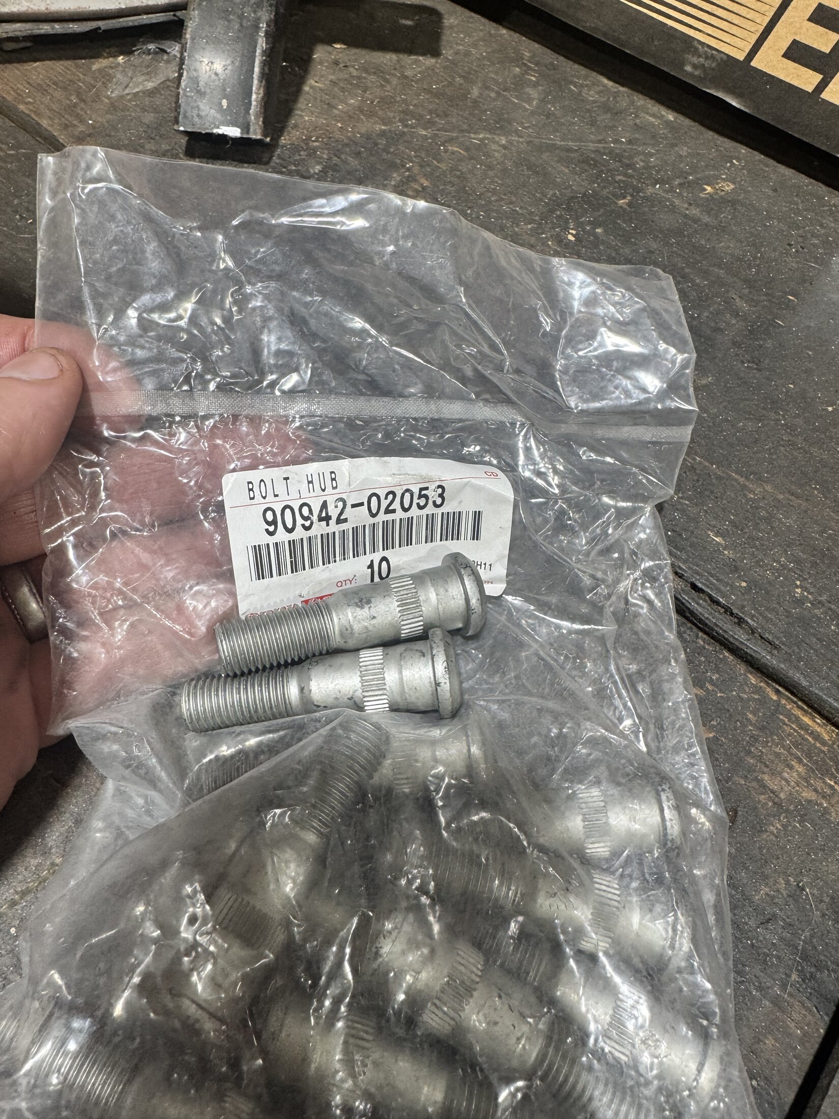

Putting the new rotors on with OEM wheel studs.

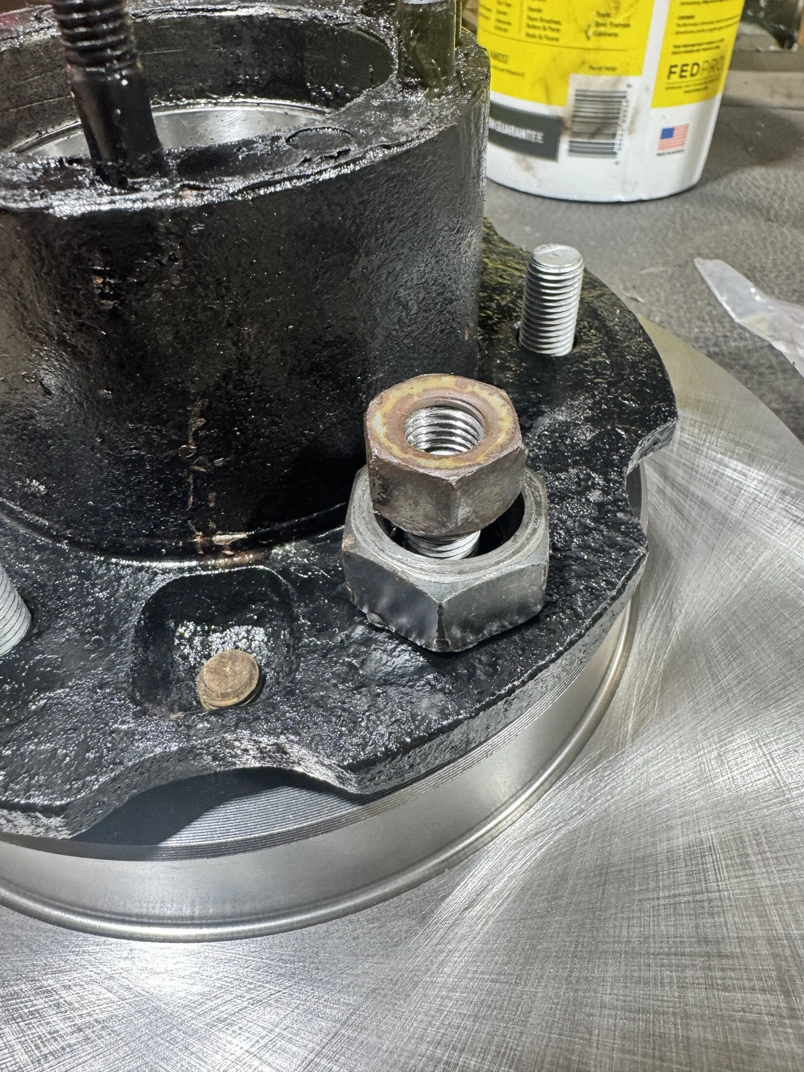

After a light tap with a ball peen I use a large nut to allow the lug nut to pull the new wheel studs through.
