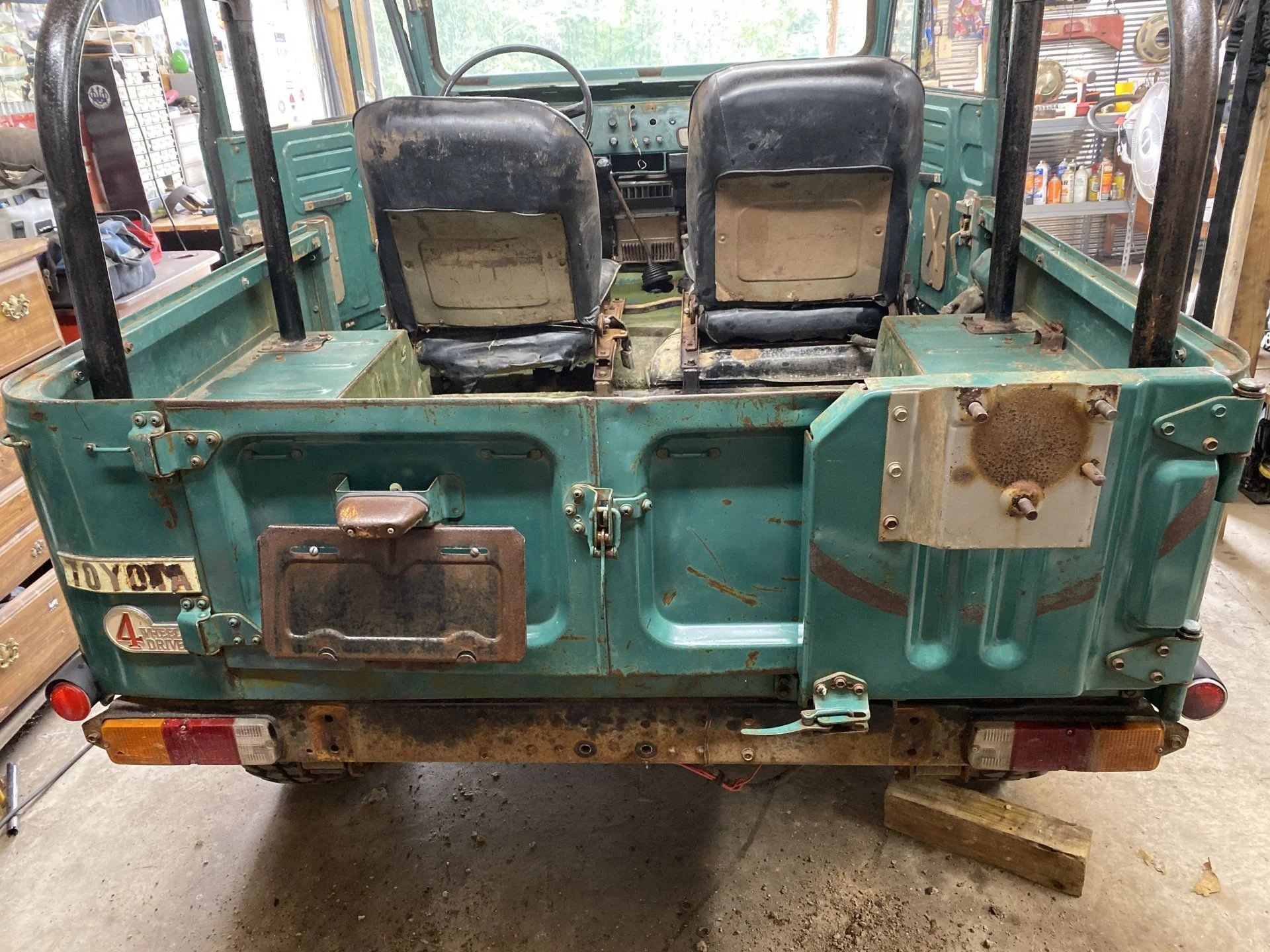

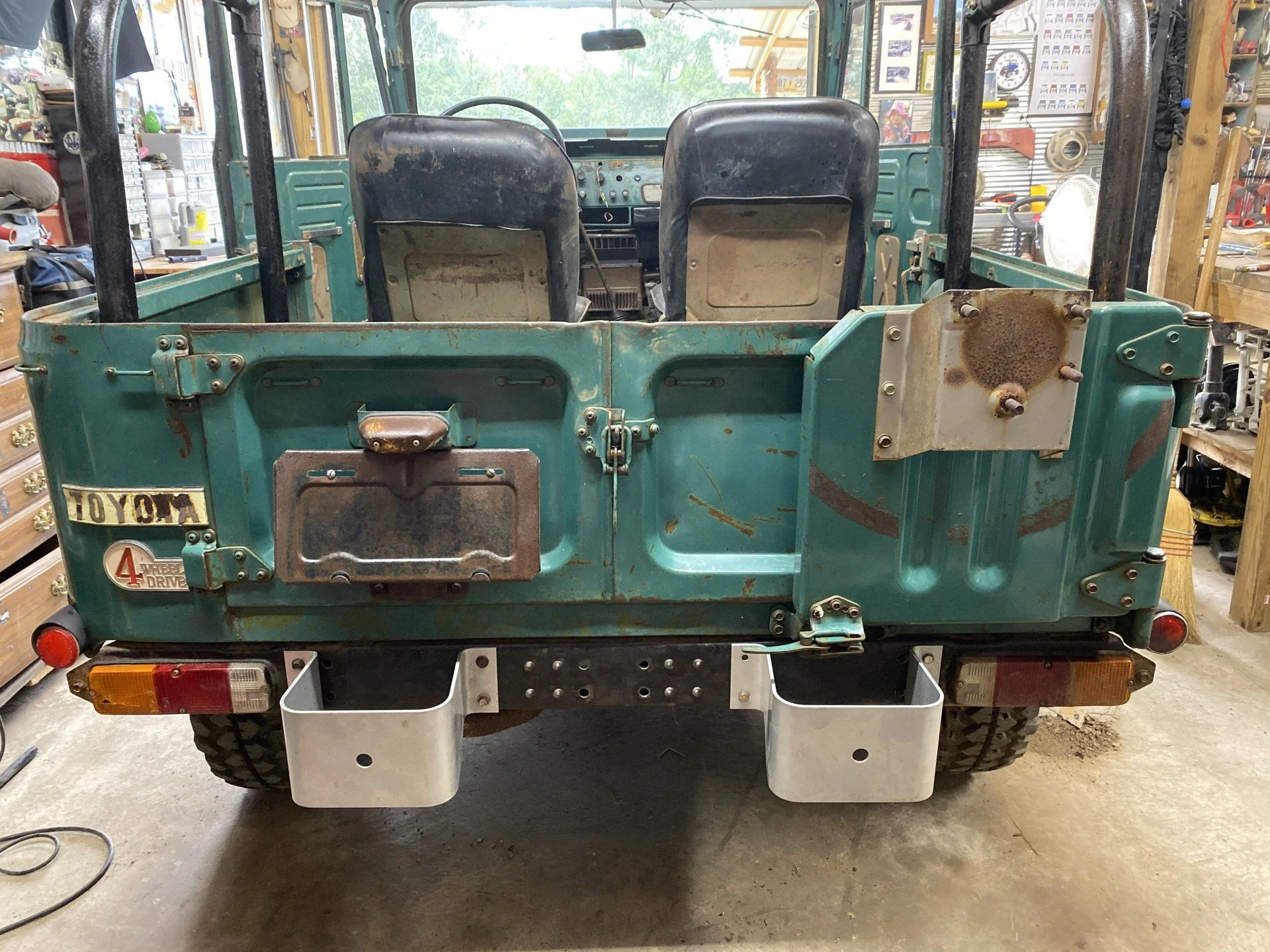

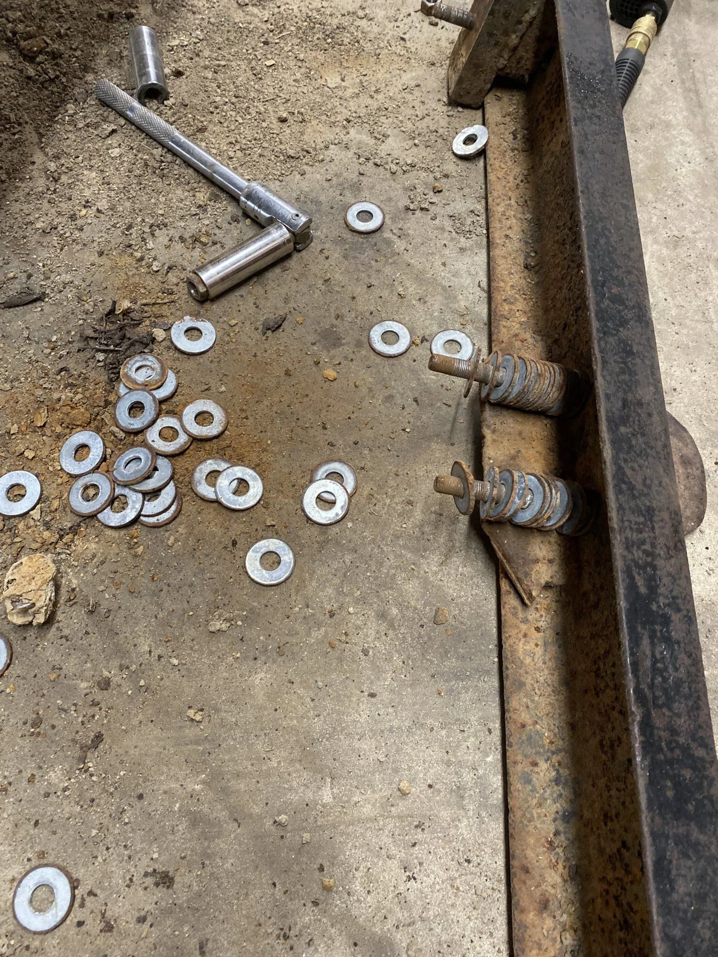

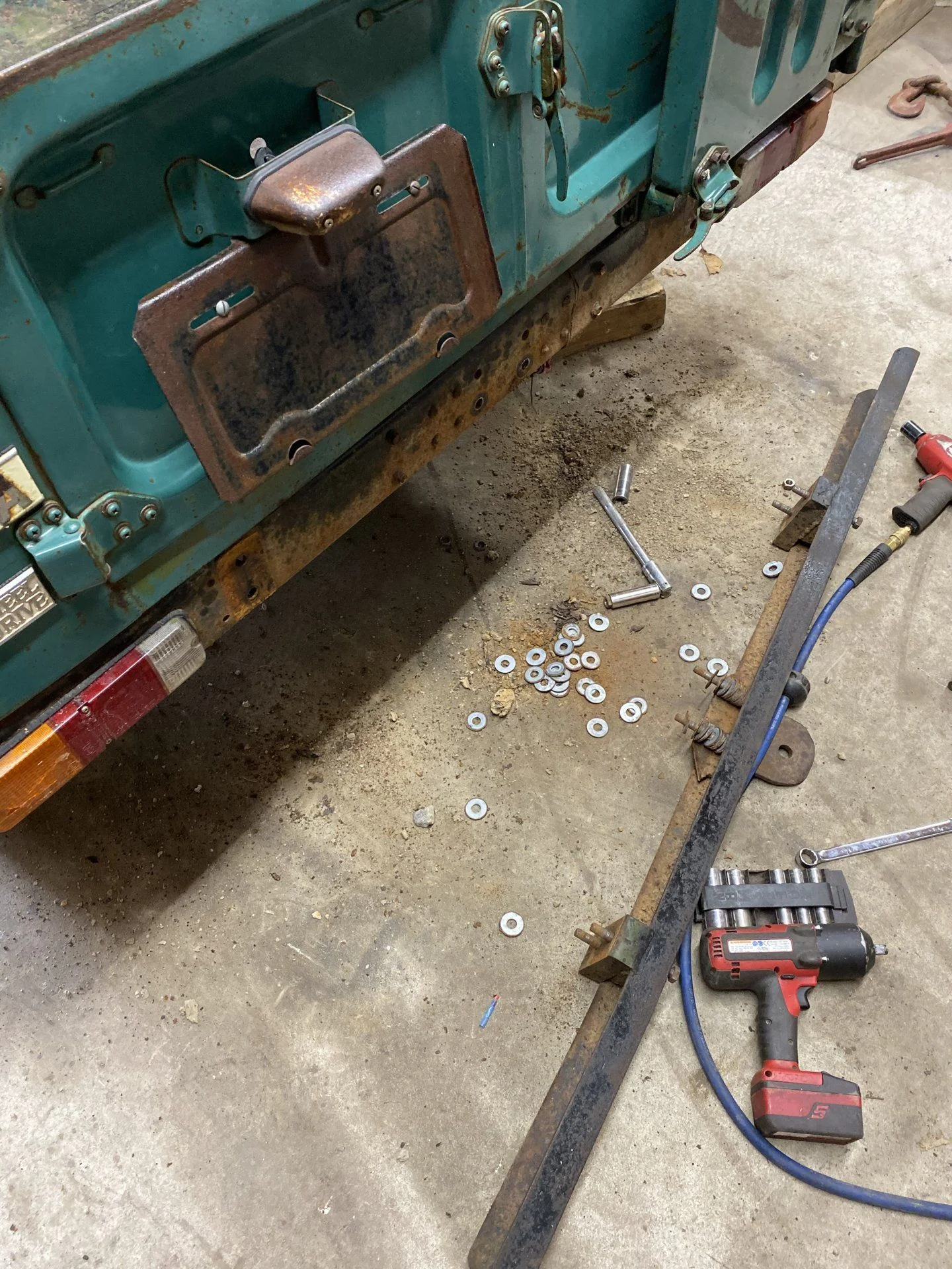

Got a couple of hours to mess it this afternoon. I wanted to get this homemade rear C channel bumper off and get some nice new bumperettes on.
not sure how long this thing has been on but it took lots of mojo to get it off. Check out the 30 washers they used for spacers!
Put in a bit of time with the wire wheel and cleaned up the frame
I only broke a couple of the old bolts to reinstall the bumperettes. Drilling those out was not fun
Looks so much better.
