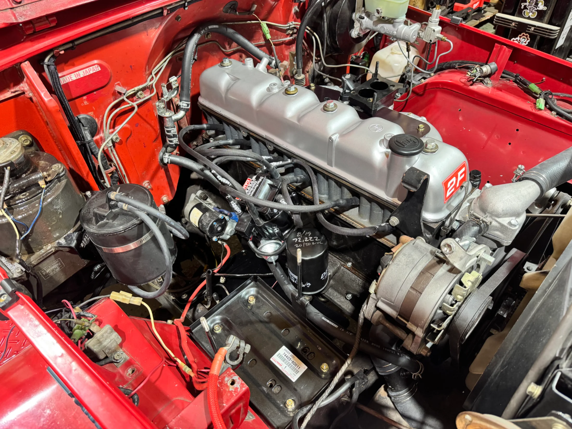

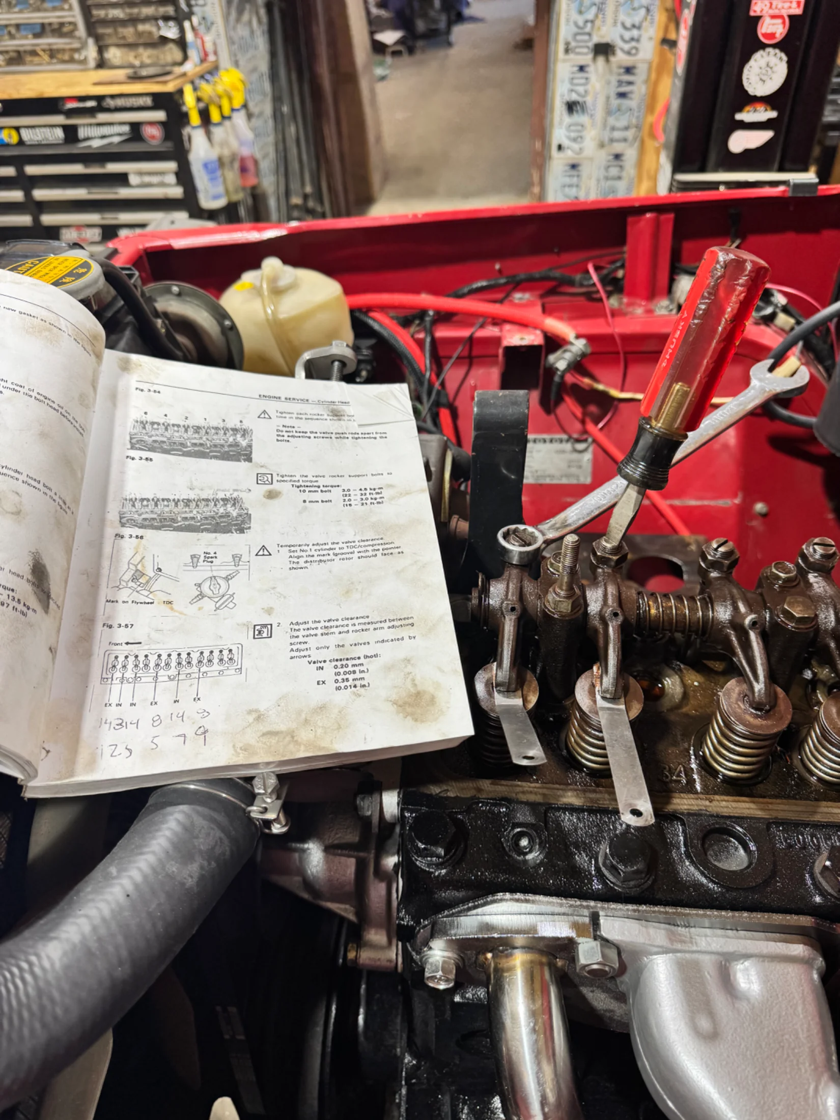

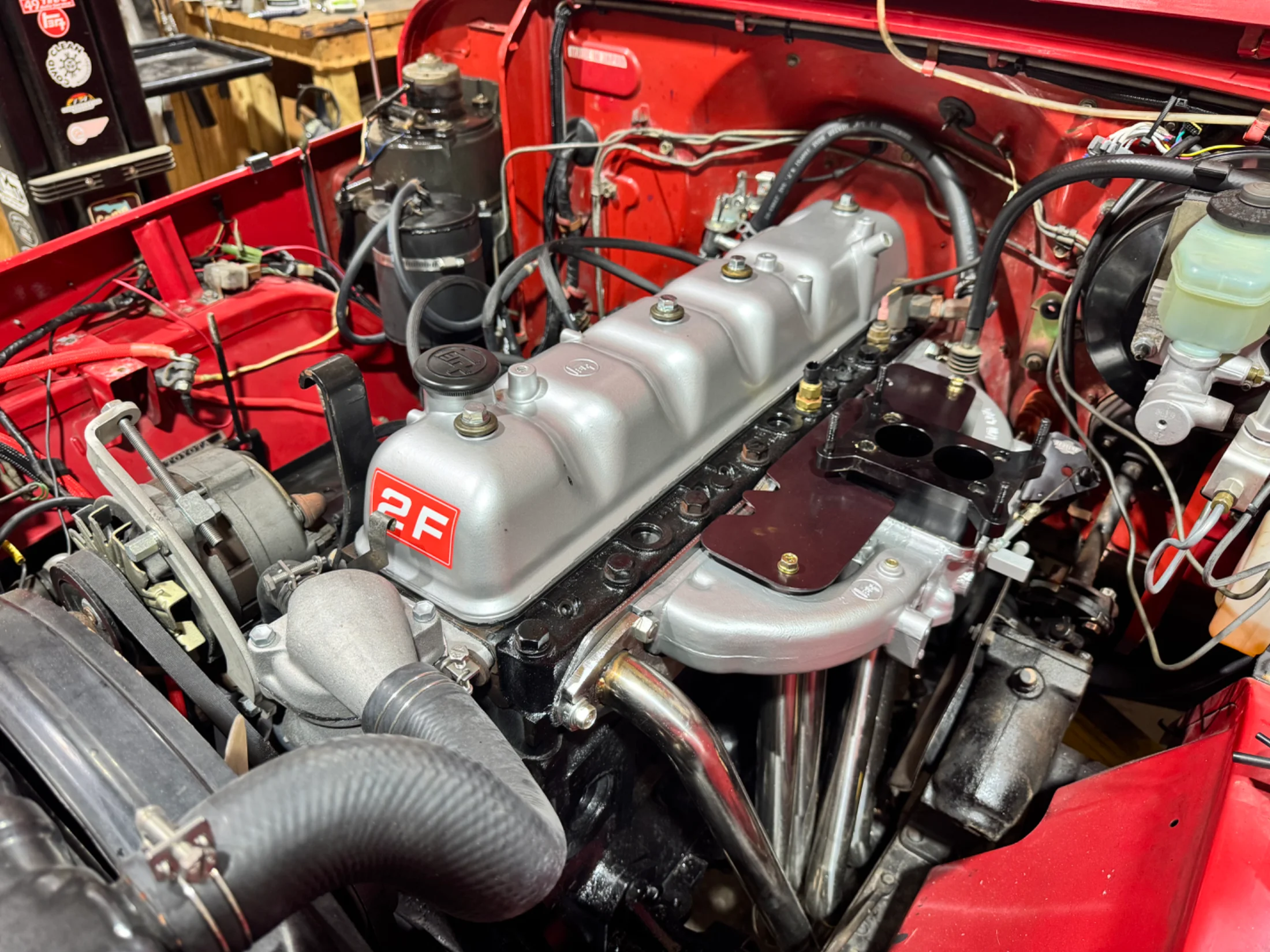

After lunch while listening to Arch Manning choke I am getting this engine bay built back
Most of the valves were close but one was way way loose. I think this thing will cook off much quieter than when it arrived.
DUI and Livewires in place
Red 2F sticker and all new Valve cover hardware
Alright. We are in business. All the engine noise is gone with the valve adjustment.

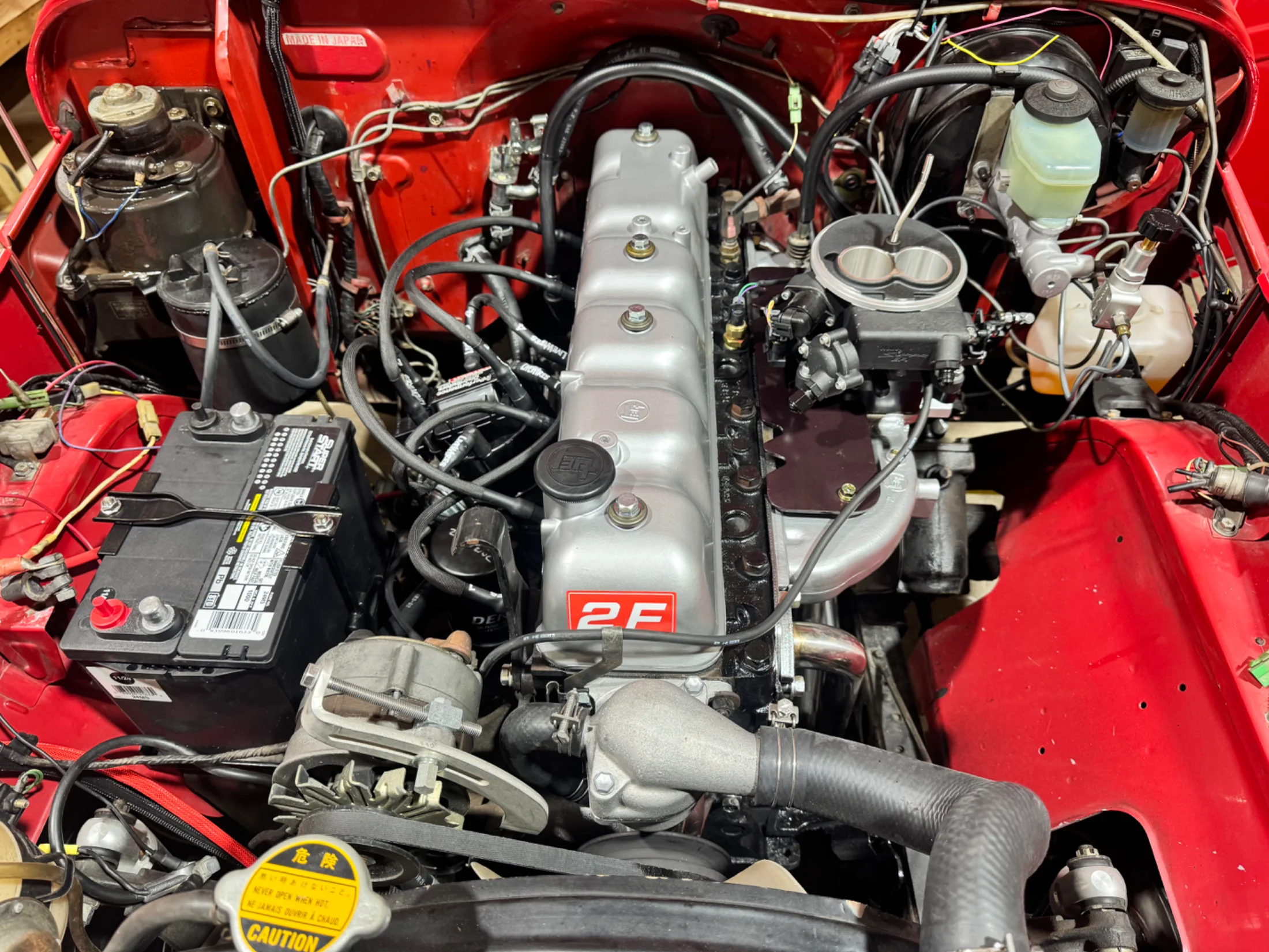

I need to pull the dissy and clock it back one notch as I can't get it to show up on the timing light.
Getting close .....
PS...it would not start at first but I reran the wizard and it fired right up. I'm assuming the old MSD ignition and PowerSurge had something off.

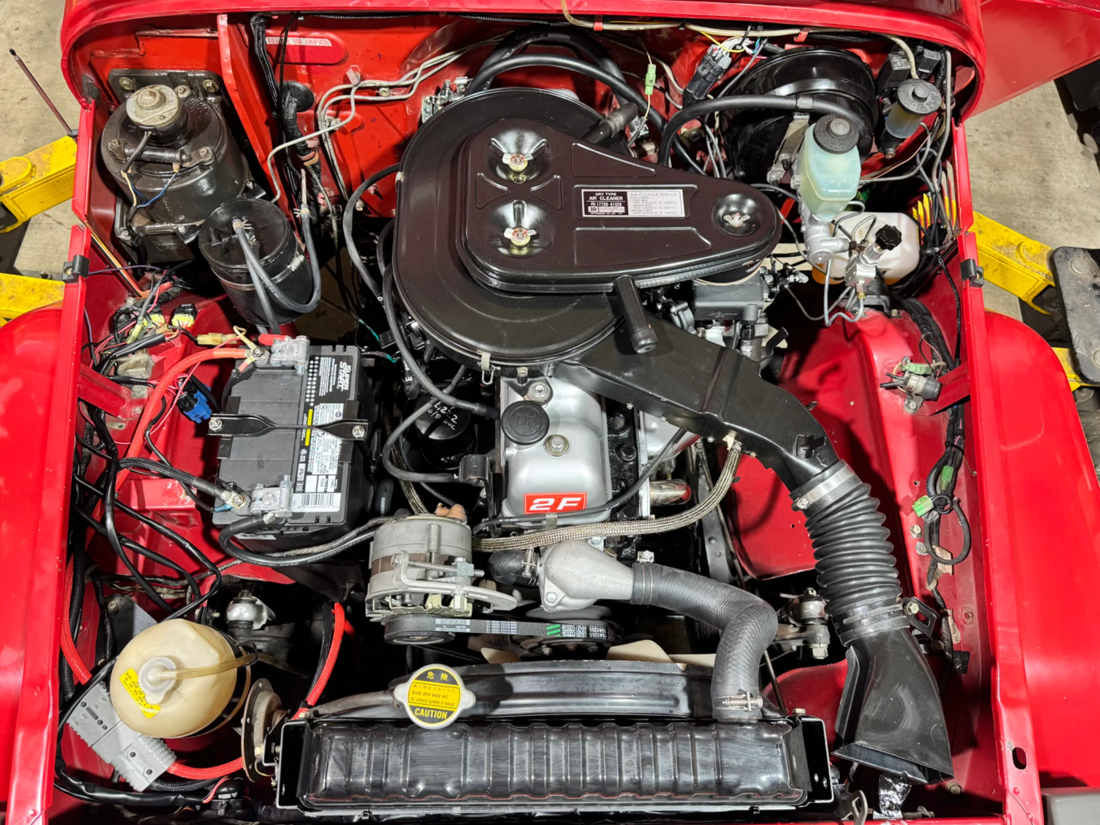

I didn't get a good pic of the before...was in too much of a hurry that day I guess
But the after is much cleaner. Not only the powder but the passenger fender losing all that MSD nonsense
Got the timing adjusted, IAC dialed in. Running great so I added a new OEM air filter and buttoned it up.

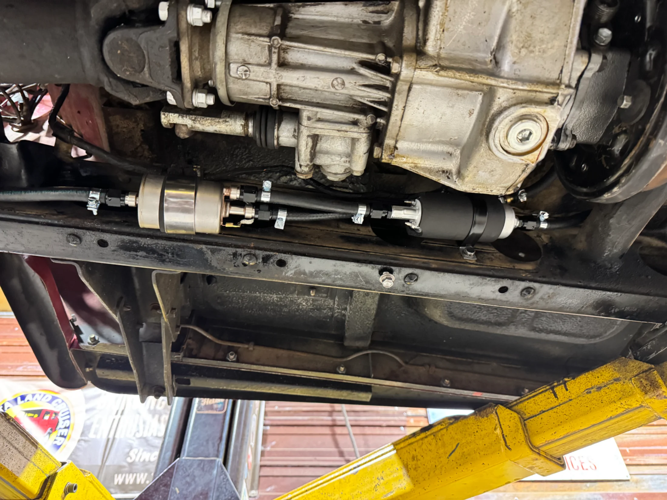

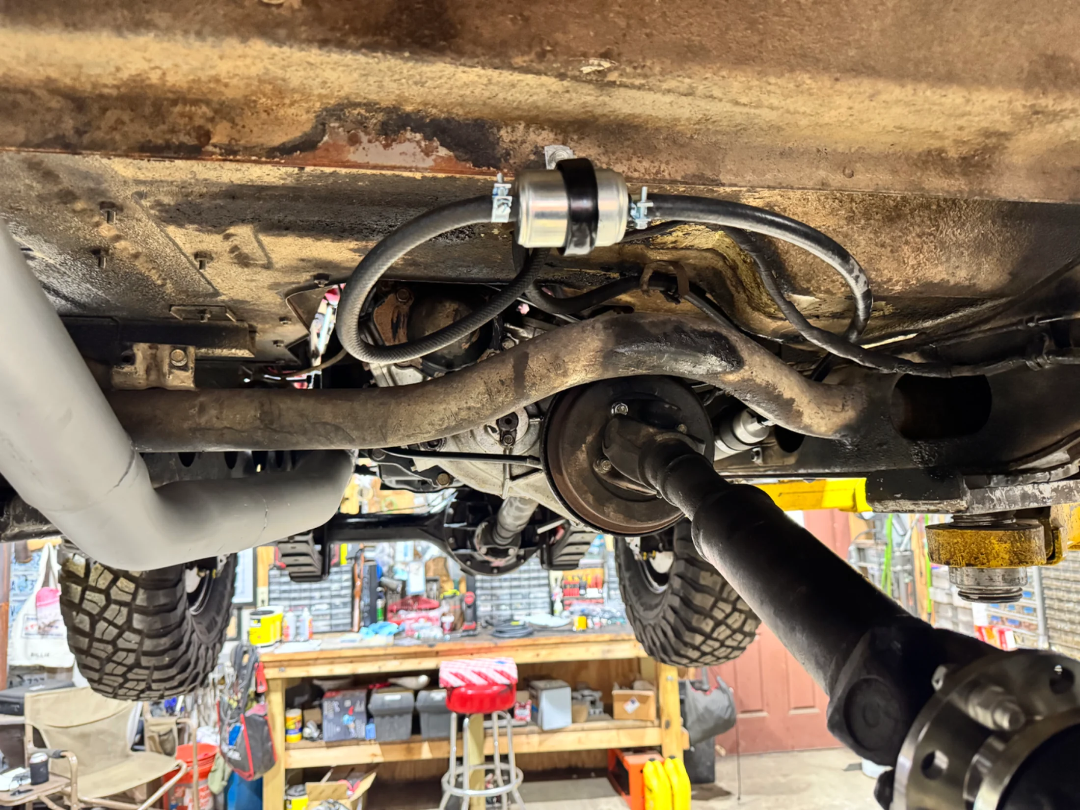

Exact pics I needed for my sniper fuel filter/ pump runs in my build. Many thanks!
Just know the "in" on the corvette filter is the barb on the side.

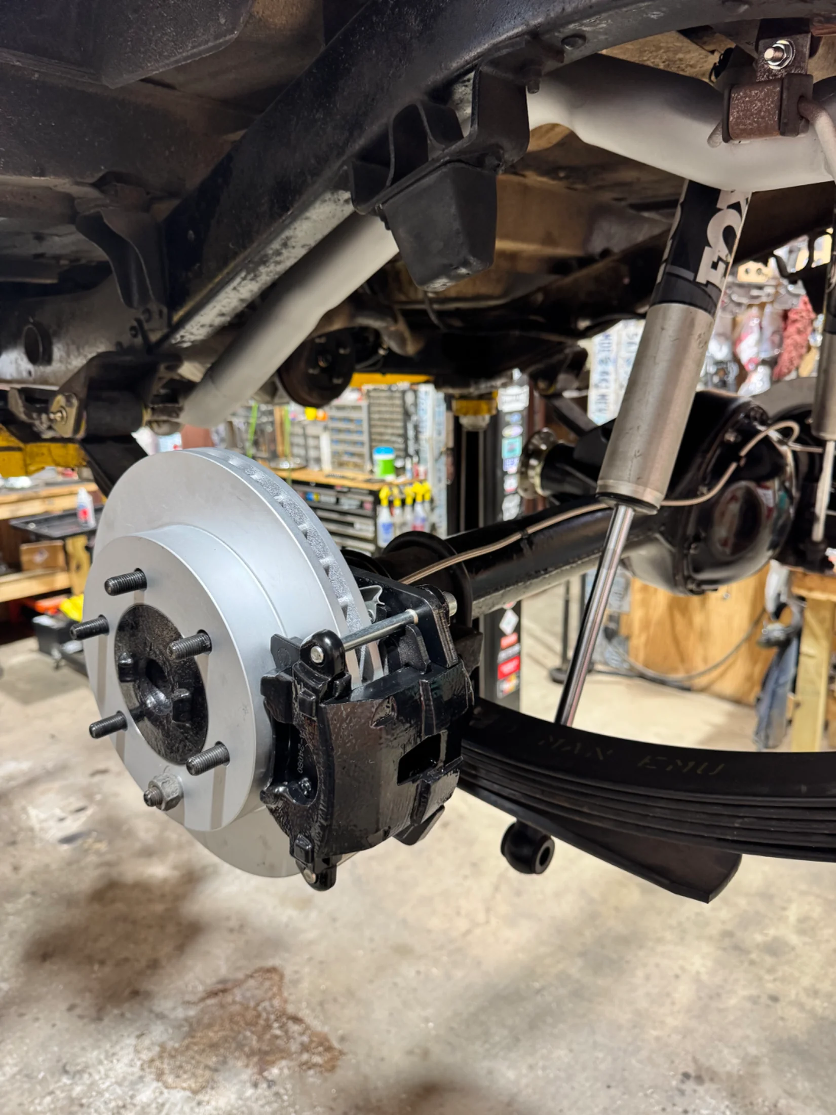

The rear flip kit arrived. The speedometer cable arrived.
Tomorrow it gets a City Racer E PS kit.

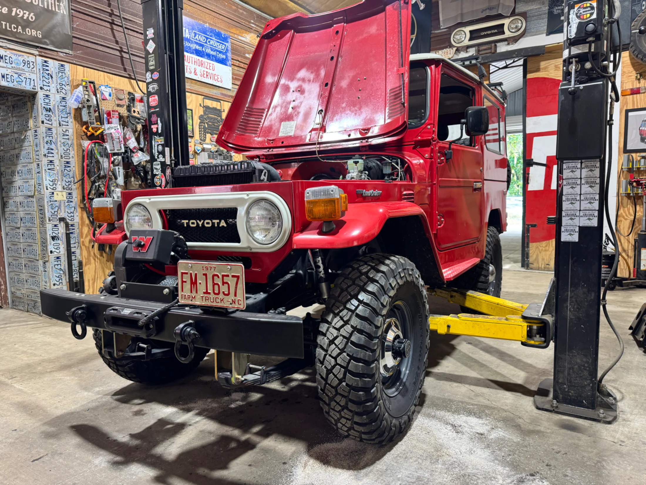

Back on it for the final push.
