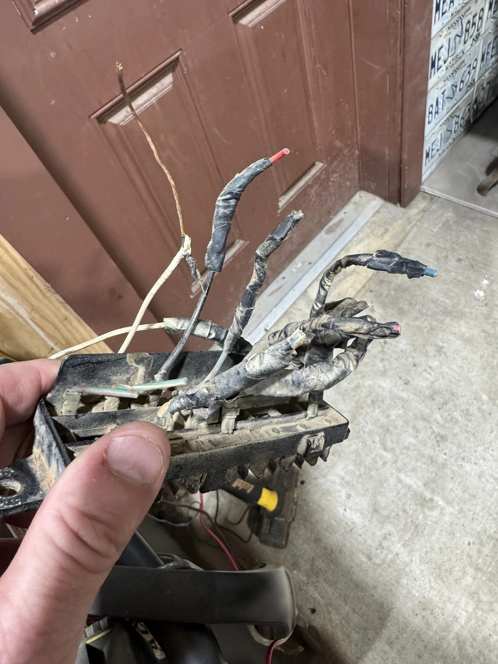

So I start trying to figure out what the hell it is now and I think...this fuse box is shot
Gotta get a new one.

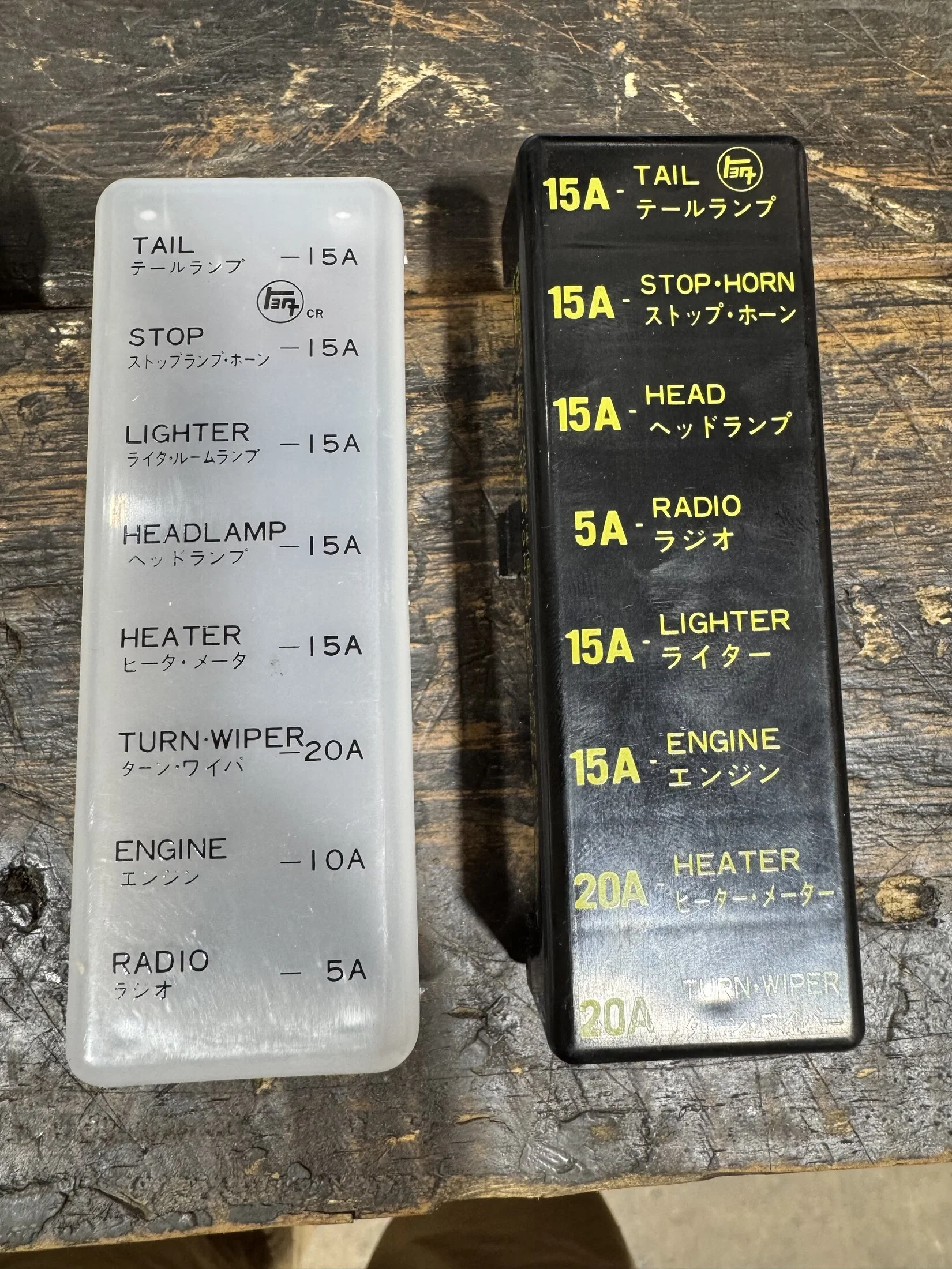

Got home and realized I had a City Racer fuse box on the shelf and got busy.
This is what you have to compare. As you can see, they don't add up side to side exactly but it's close.
Someone had already been in here twisting wires.

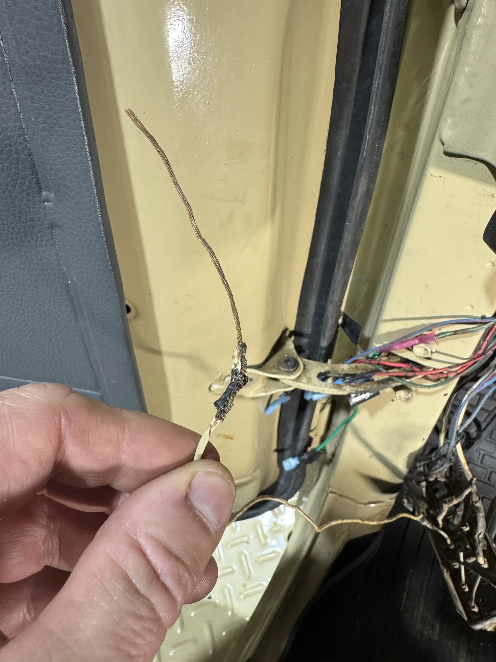

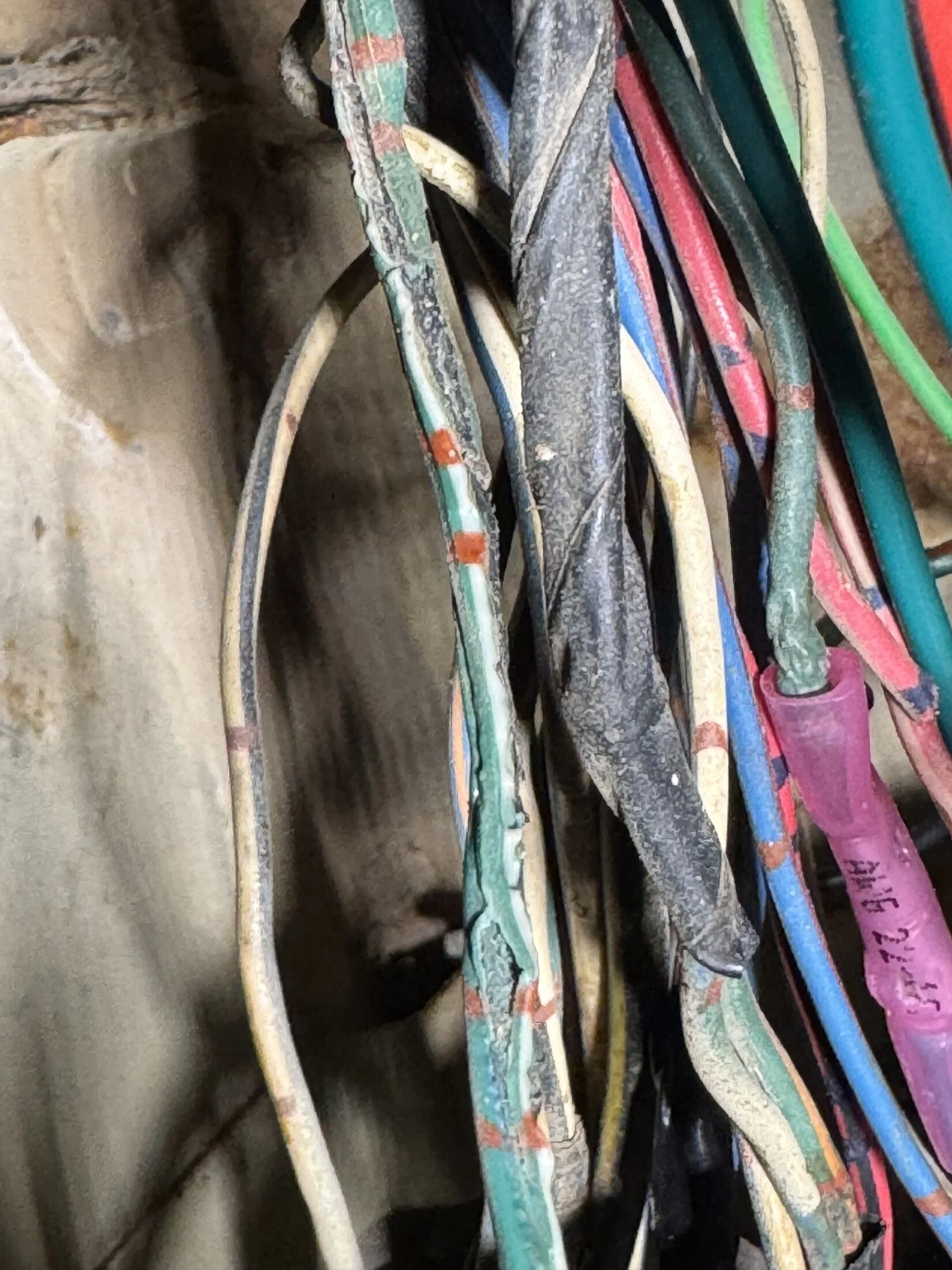

Most of the wires in the loom were OK but I found the ENGINE wire was likely the culprit for the melt down. Thank God I was able to pull the cluster and open the harness far enough to get fresh wire
This is the old guy. Total s*** show.
This should fix the old girl up.

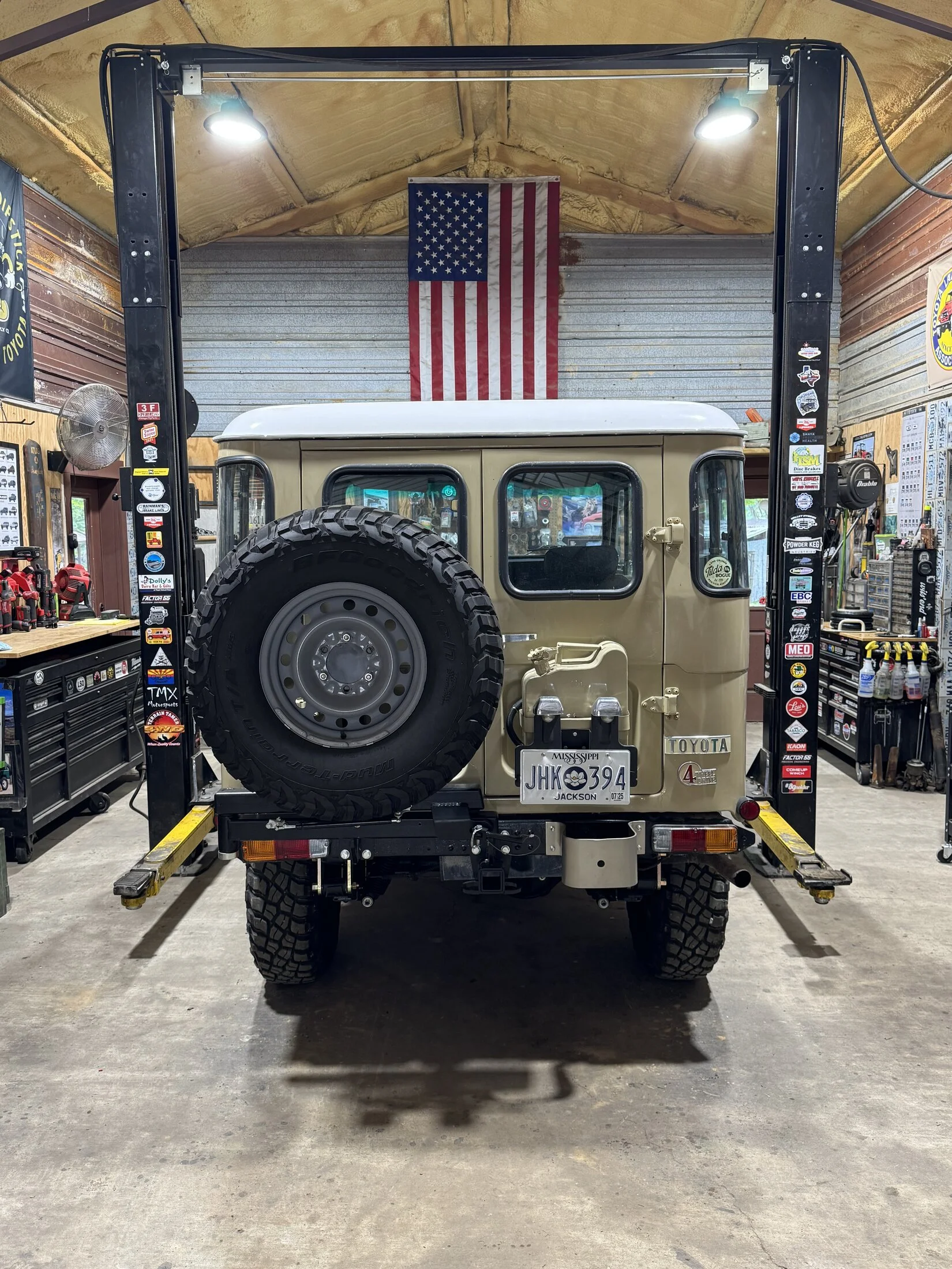

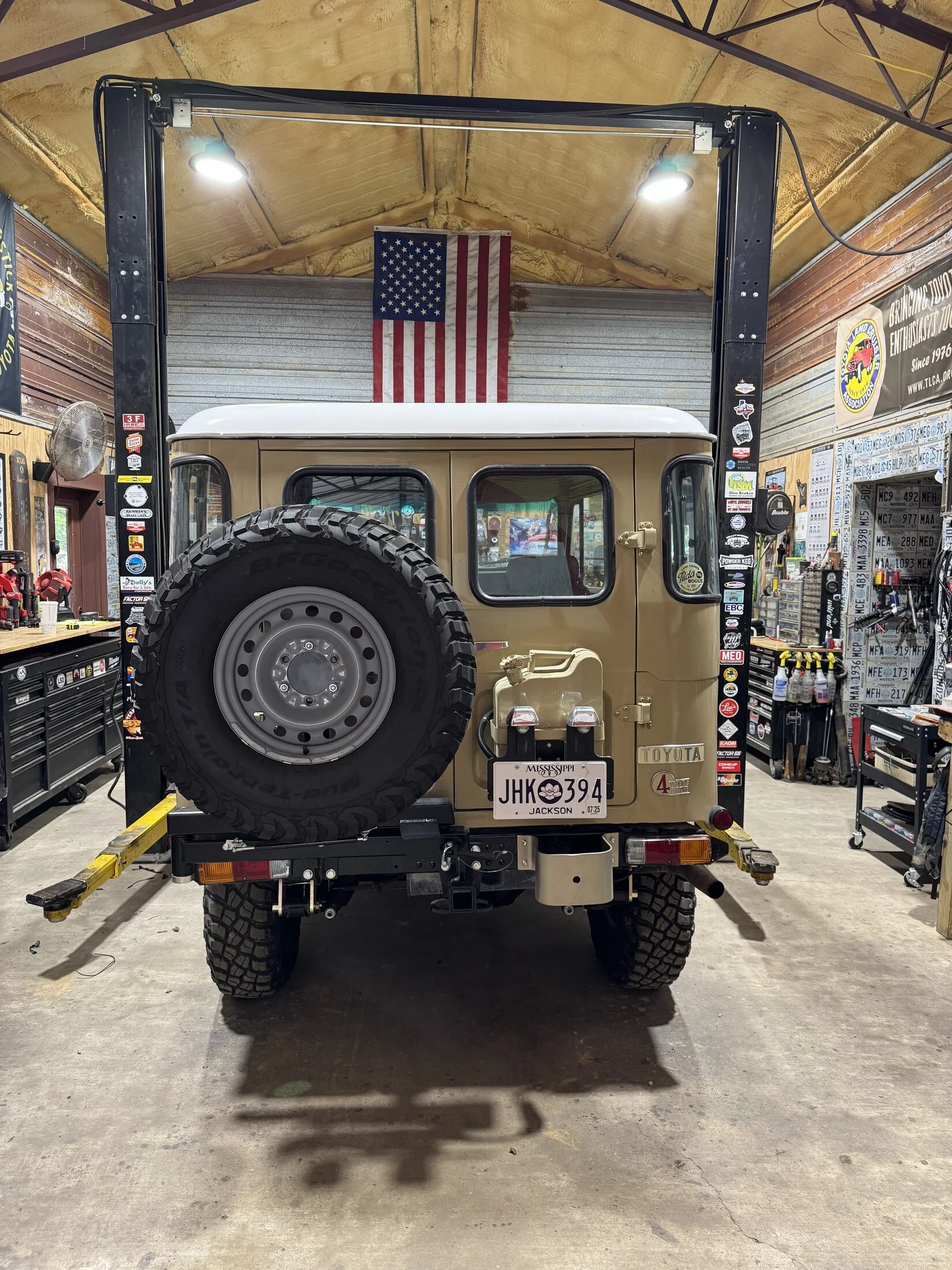

Last thing I wanted to do on this one was put a "level block" on the right rear to get some of the Cruiser lean out.
It was 1.5" too high on the passenger side.
After the block it's about 1/2" high now. Much better.
