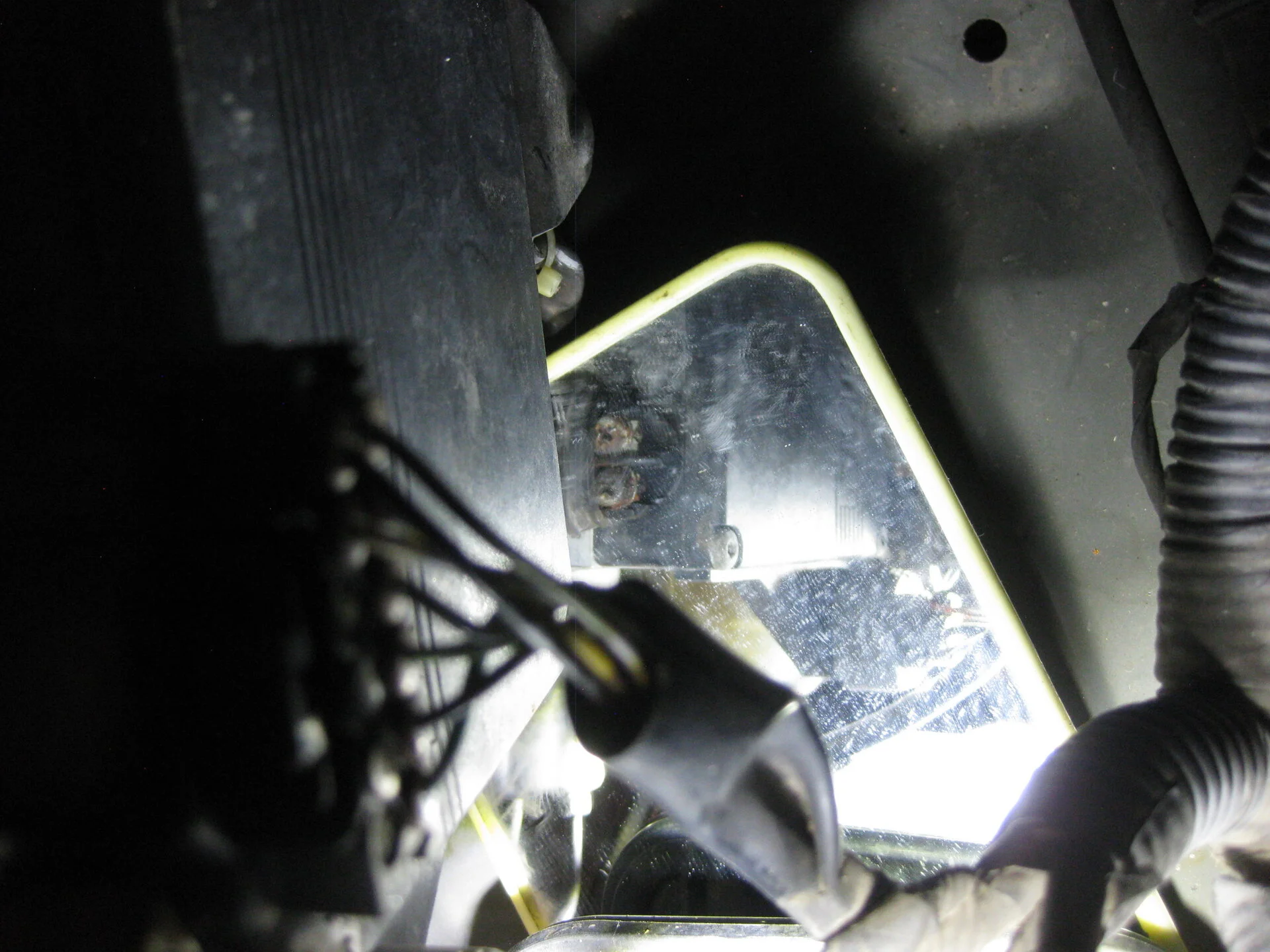

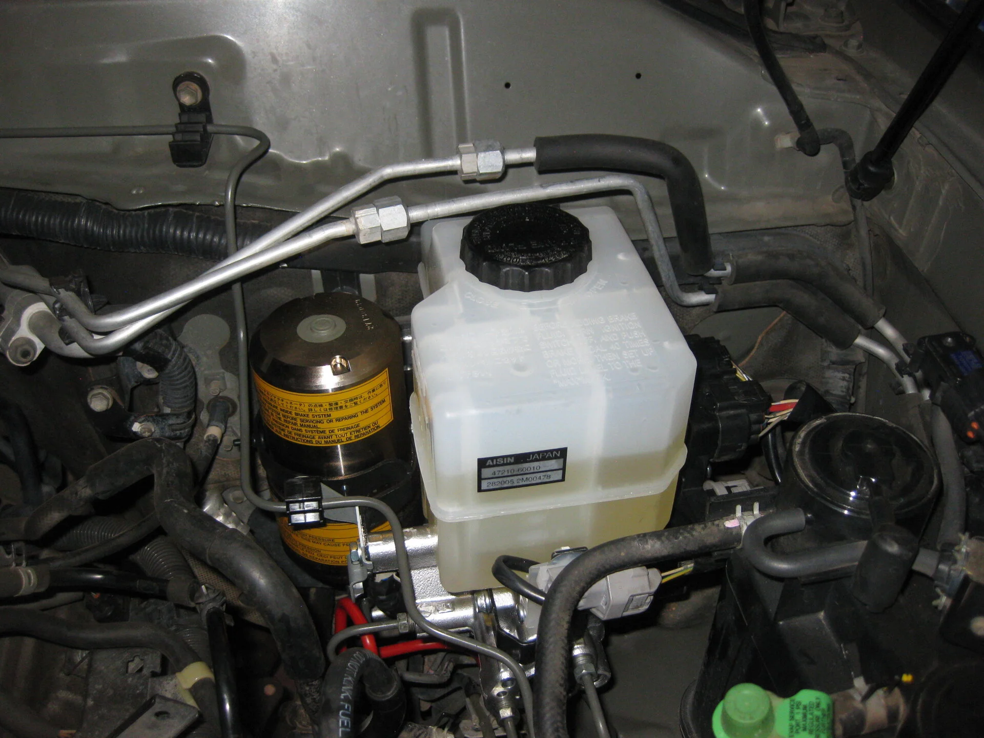

Had to happen to somebody - the brake MC died without warning at 310,042 miles. I tested the system weeks earlier and the pump ran quietly for 42 seconds to recharge the accumulator. I never got 'dying pump or motor sounds'. Then last week, the horn went off in the dash, the brake and ABS lights came on, and I lost all boost after 15-ish more brake applications. I just pumped up the pedal (like you'd do with a bad MC on any normal vehicle) and drove carefully home. I never truly 'lost all brakes'.
I had the 'rusty motor screws' situation (see pix in mirror below) and test-probed that. I later removed the MC and tried to power the motor separately to no avail. I will tear down the motor at some point and look inside.
Observations:
  • I ordered a new replacement from my Toyota (not Lexus) dealer, who mostly matched the lowest Internet price. ~$1345 + tax for the P/N 47050-60010.
  • I watched the Timmy the Toolman MC replacement YouTube video, which was excellent, but there is no need to take the dash apart - all the bolts and the clevis are easy to reach from underneath.
  • I bled the system using my wife pushing on the pedal for the fronts, and she and the pump for the rears. I did not re-bleed after a test drive using the ABS, nor did I use Techstream at any point. The pedal is high and firm and I can stand the truck on end with the brakes. Maybe when I rotate the tires, I'll do one more bleed.
  • R+R of the MC took 2 hrs. and bleeding took another 1 hour - not a difficult or time-consuming job.
Steve

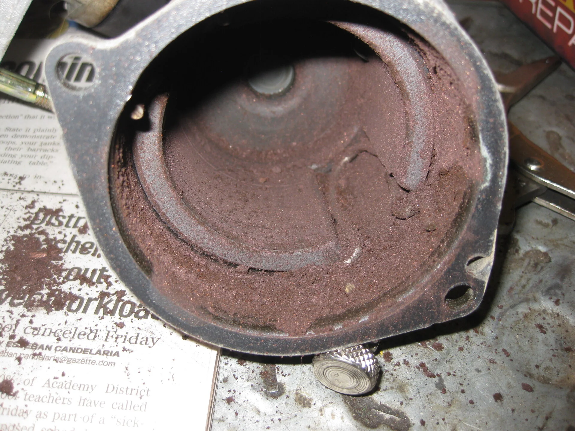

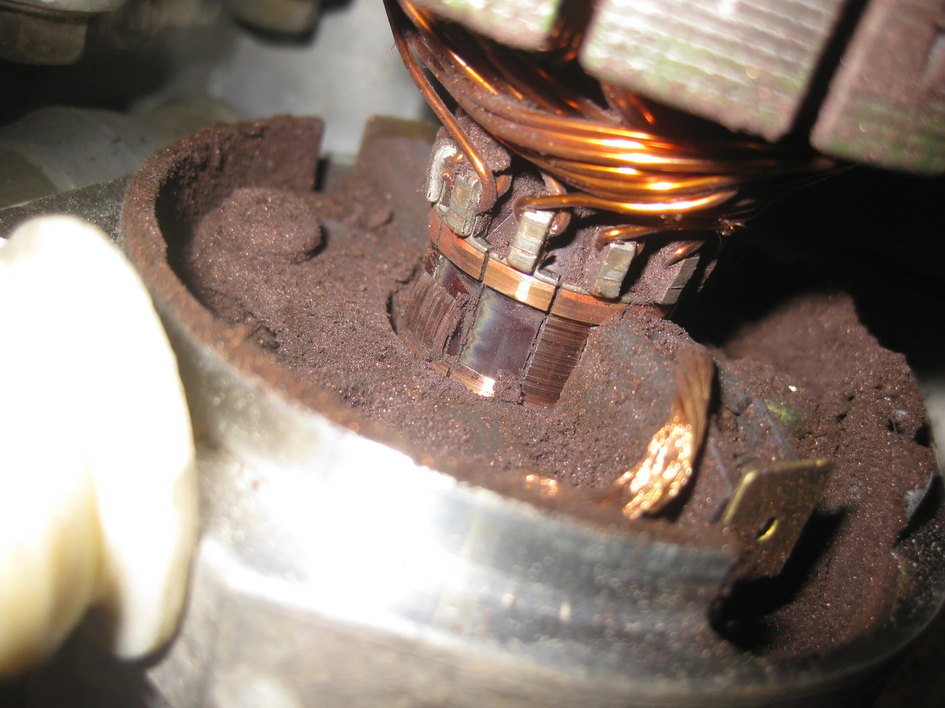

Took apart the old ABS motor tonight - totally worn out inside. The brushes wore out and took out the commutator on the motor. A motor rebuild might have saved this unit, but who knows what may have failed next.
