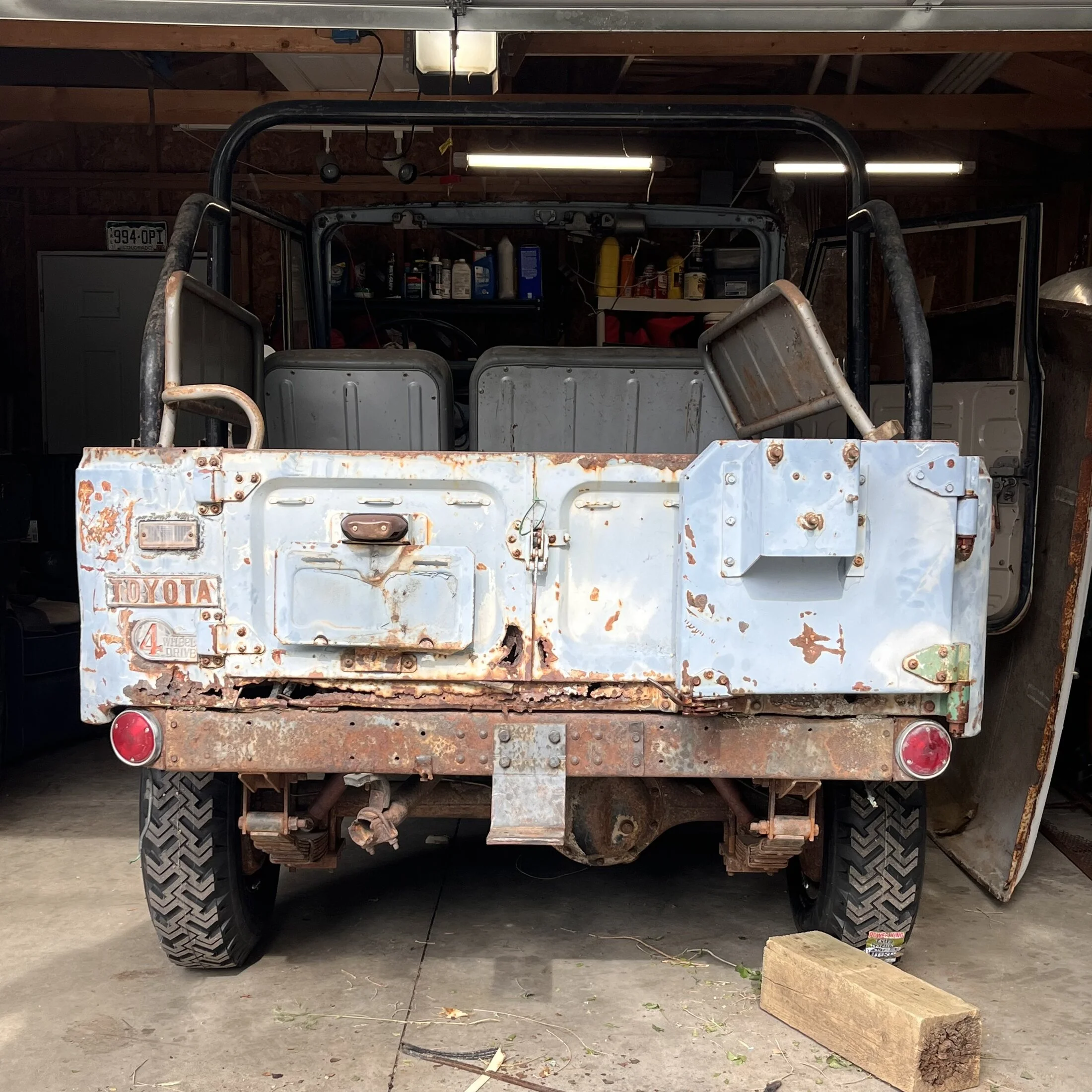

Arrived with no wheels. I had some ready to go.

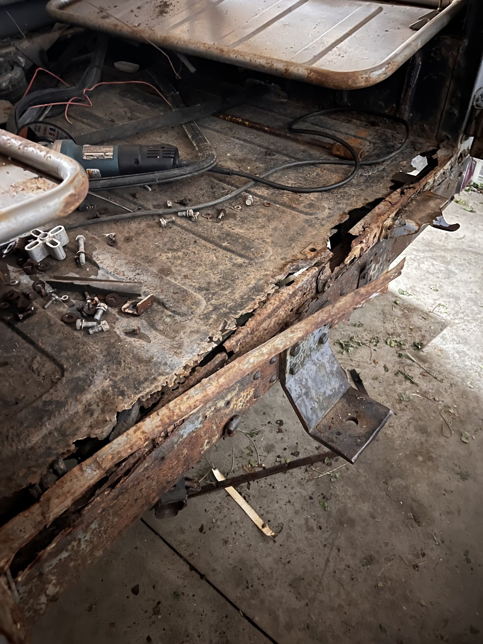

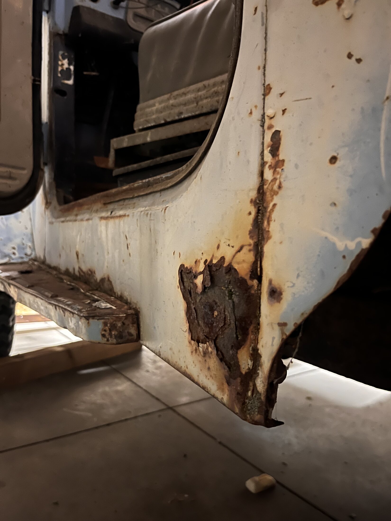

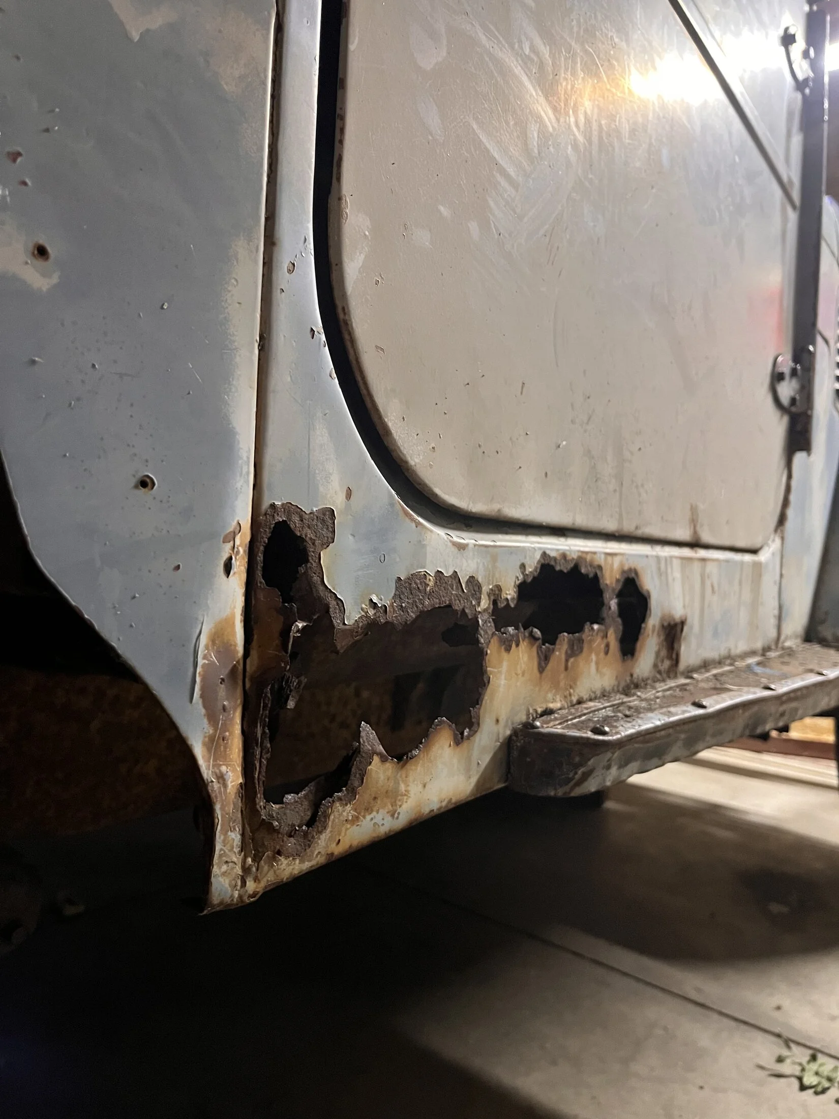

Classic rear sill and swing out door rot.

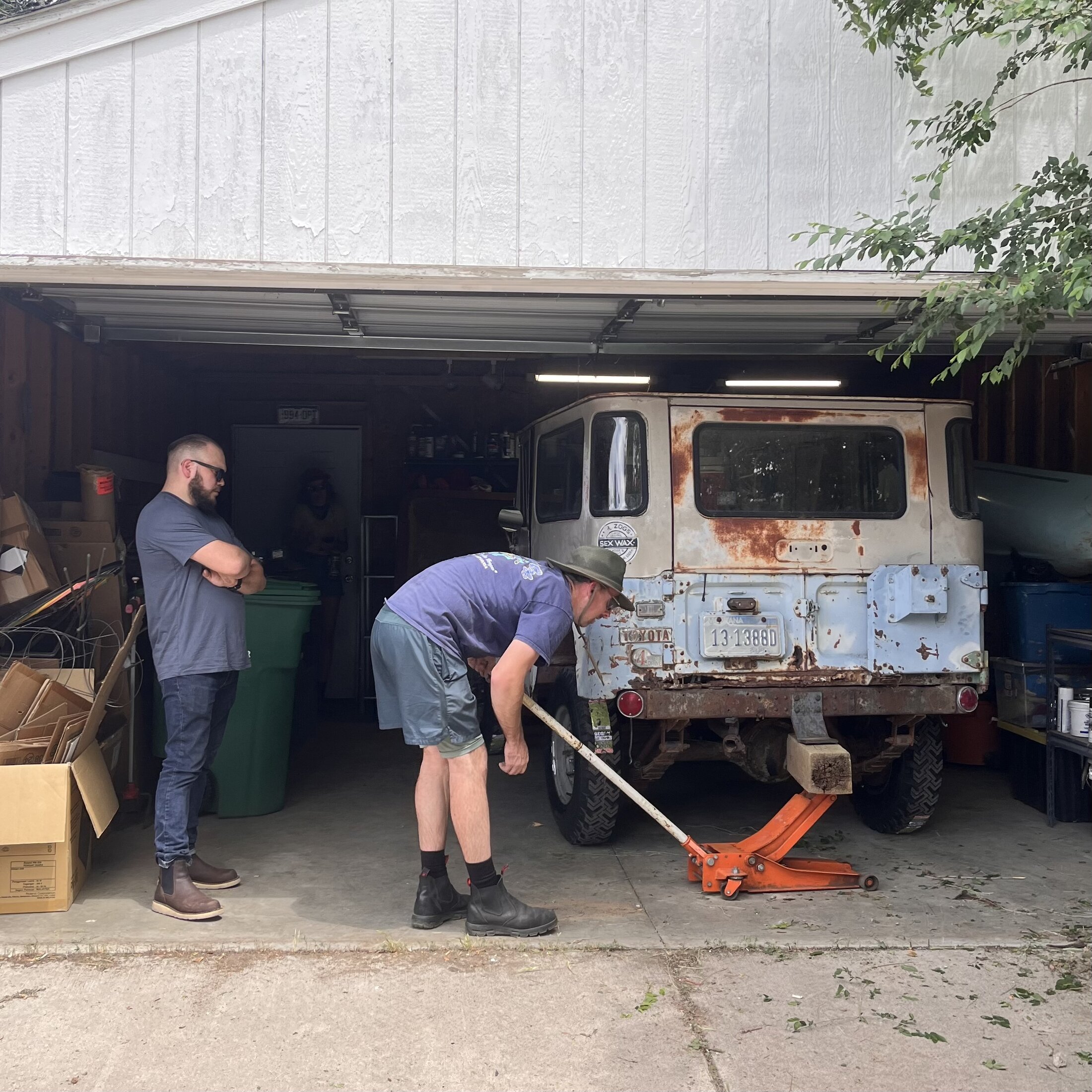

In addition to Joe’s huge help acquiring and delivering this damn thing, @HemiAlex accidentally ended up in town and came over to supervise Joe. Gotta watch that guy.

There’s a fine line between patina and rot though. So like any good cruiser owner I’m going to ignore the rot for now.

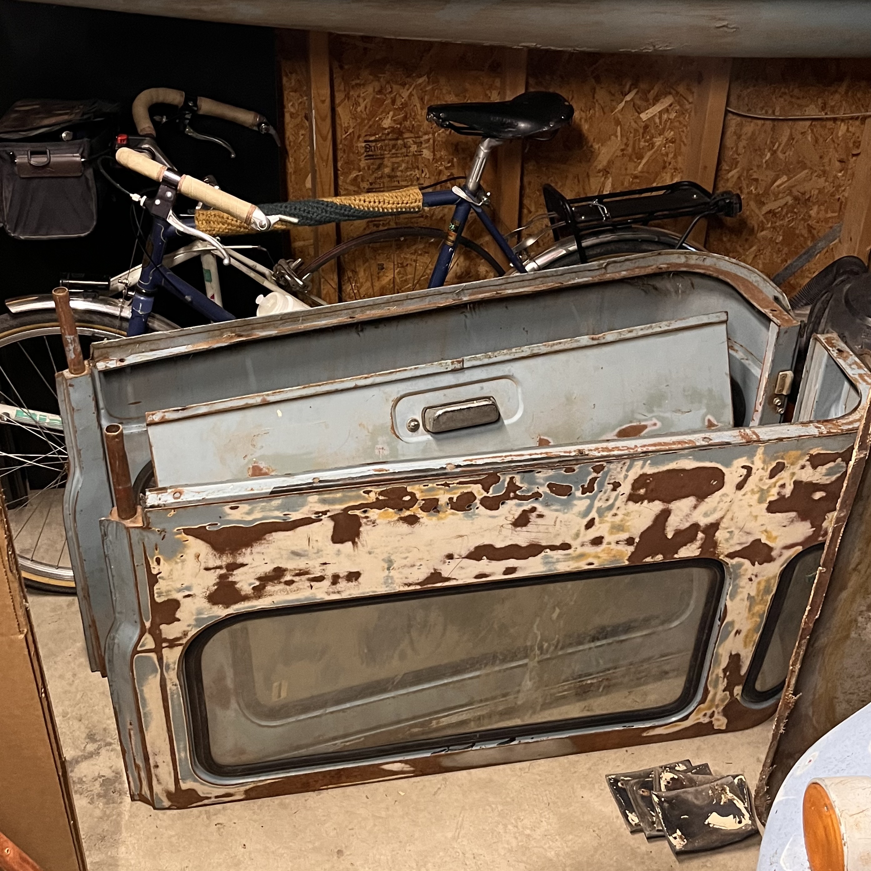

The Capri Blue 40 came with Dune Beige hard top and no cap, but we were able to find a matching patina Capri Blue top and decent cap, as well. I found a local guy who wanted the beige top and he took it off my hands about an hour after we unloaded.

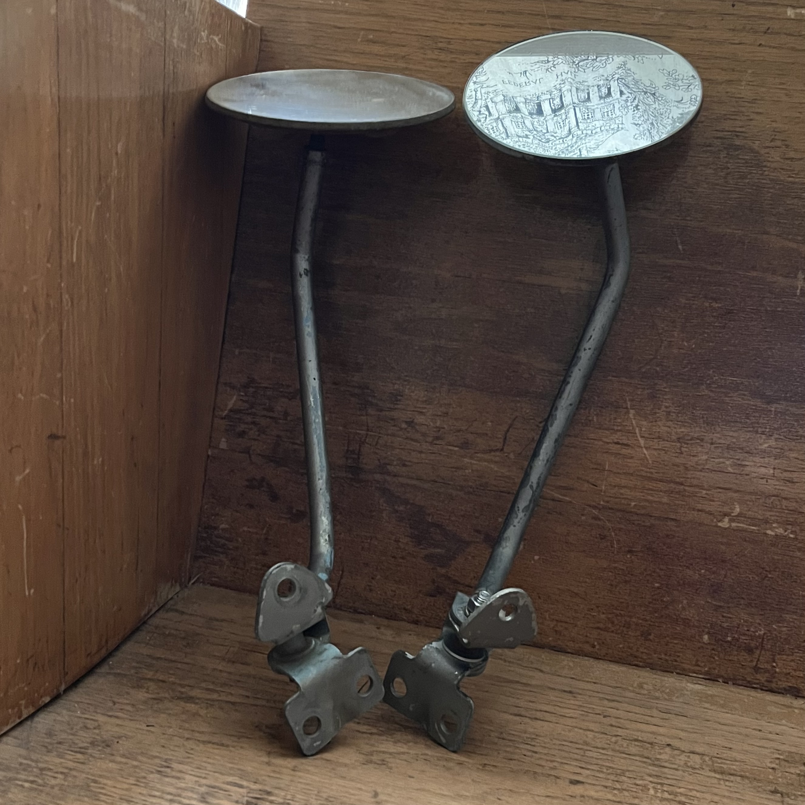

Mark A in California sent me some decent side mirrors.

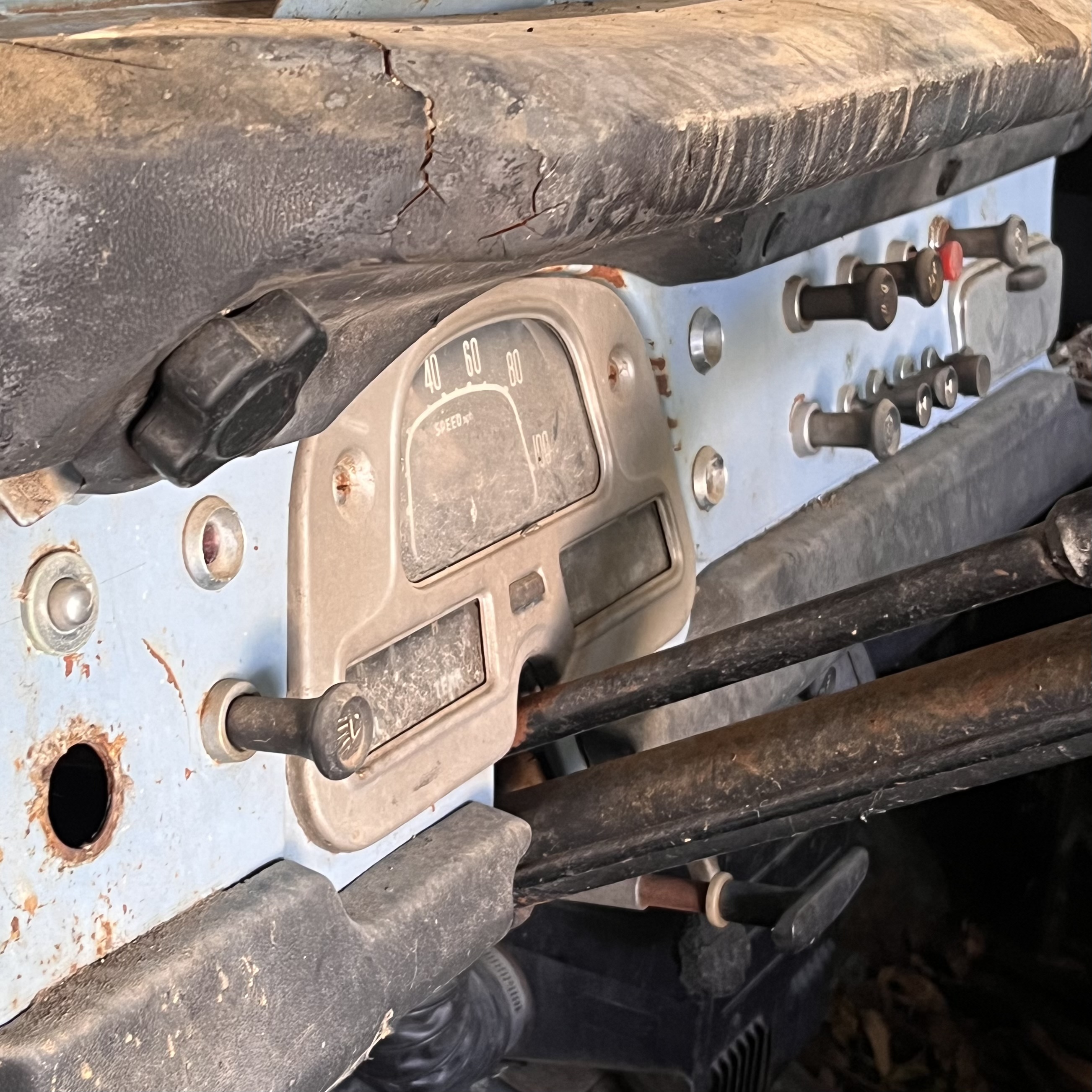

Key cylinder/starter switch was missing but there was a NOS one in the glove box … missing the key though. I wonder if I can pull a code off the cylinder and have Toyota cut it. Doubtful.
Rot. I’ve been told there are a few outfits in Australia making patch panels for early 40s, including floor sections. Or I can make them from scratch like diesellibrarian.
[/QUOTE]
Toyota locks of that era were not real picky about what would turn them. You might try a similar key, or a pocketknife blade, or a small slot screwdriver or just about anything...

The rear quarters were cut for larger tires and at some point flares were added. I may eventually get some patch panels to bring the wheel opening back to the right size. The original size tires look pretty goofy in the big opening.
They’re on backwards here, we were throwing tires on and hustling to get it off the trailer. I’ll correct them eventually.
