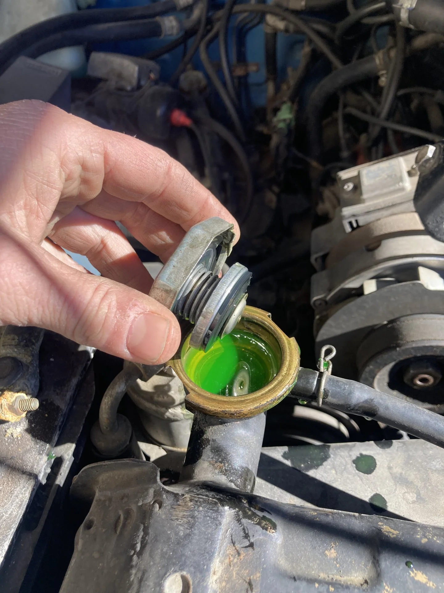

Well, I the motor turns over with jumpers from my tomato truck, but it’s not happy about it. Coolant was full and oil was topped off (only 2qts of oil in it to start!), I cleaned the battery terminals, etc. Nothing strange in the coolant at the filler neck.
A couple things about that:
First wasn’t turning over enough to do a proper compression test so that didn’t happen. Second, the float bowl isn’t filling. There’s fuel in the fuel filter - which has a TEQ stamp and says Kyosan on it. Possibly original to the vehicle?? I have a spare fuel pump at home that I’ll take to the shop.

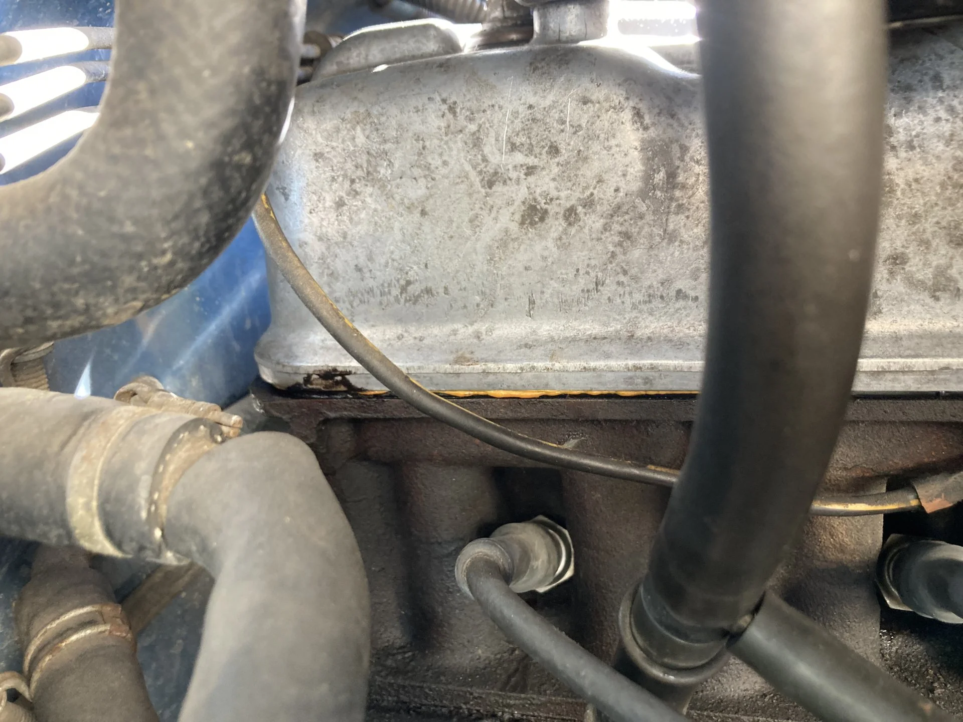

I decided to do some more in-depth poking around. Removed valve cover and the rockers and such look pretty clean. Both valve cover and exhaust manifold are slathered in sealant pretty good.

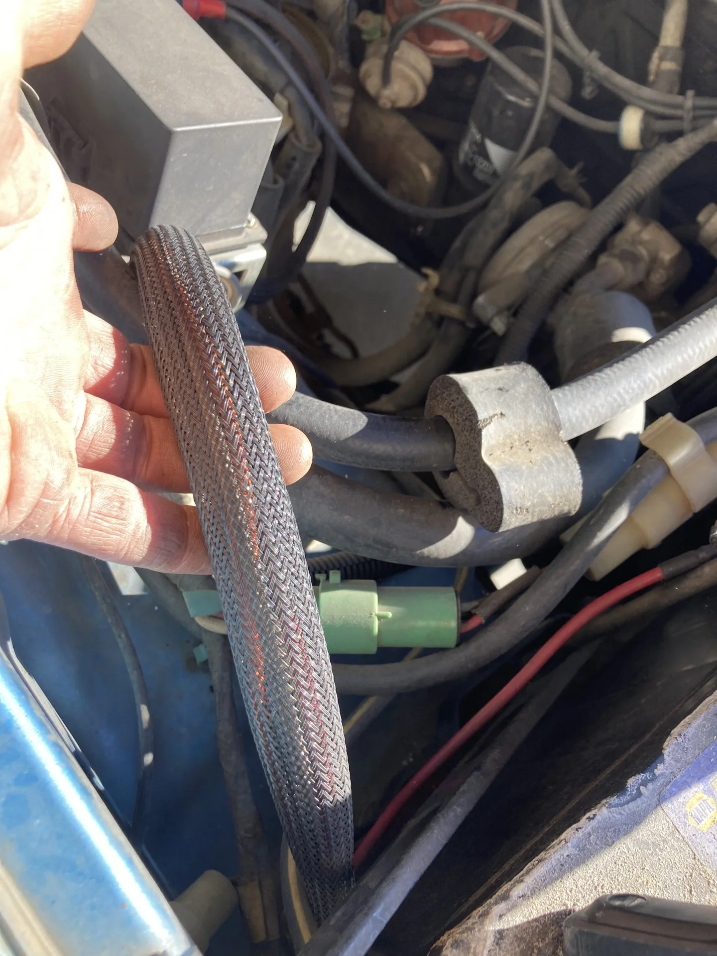

Looked at the oddball wiring harness some more. It seems to feed the lights. I’ll probably rip it out since a Koito harness and light housings are about $60.

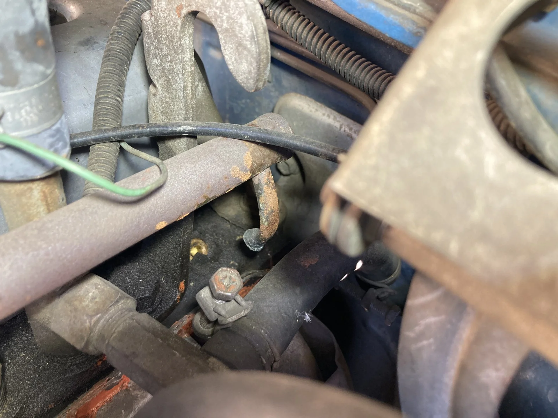

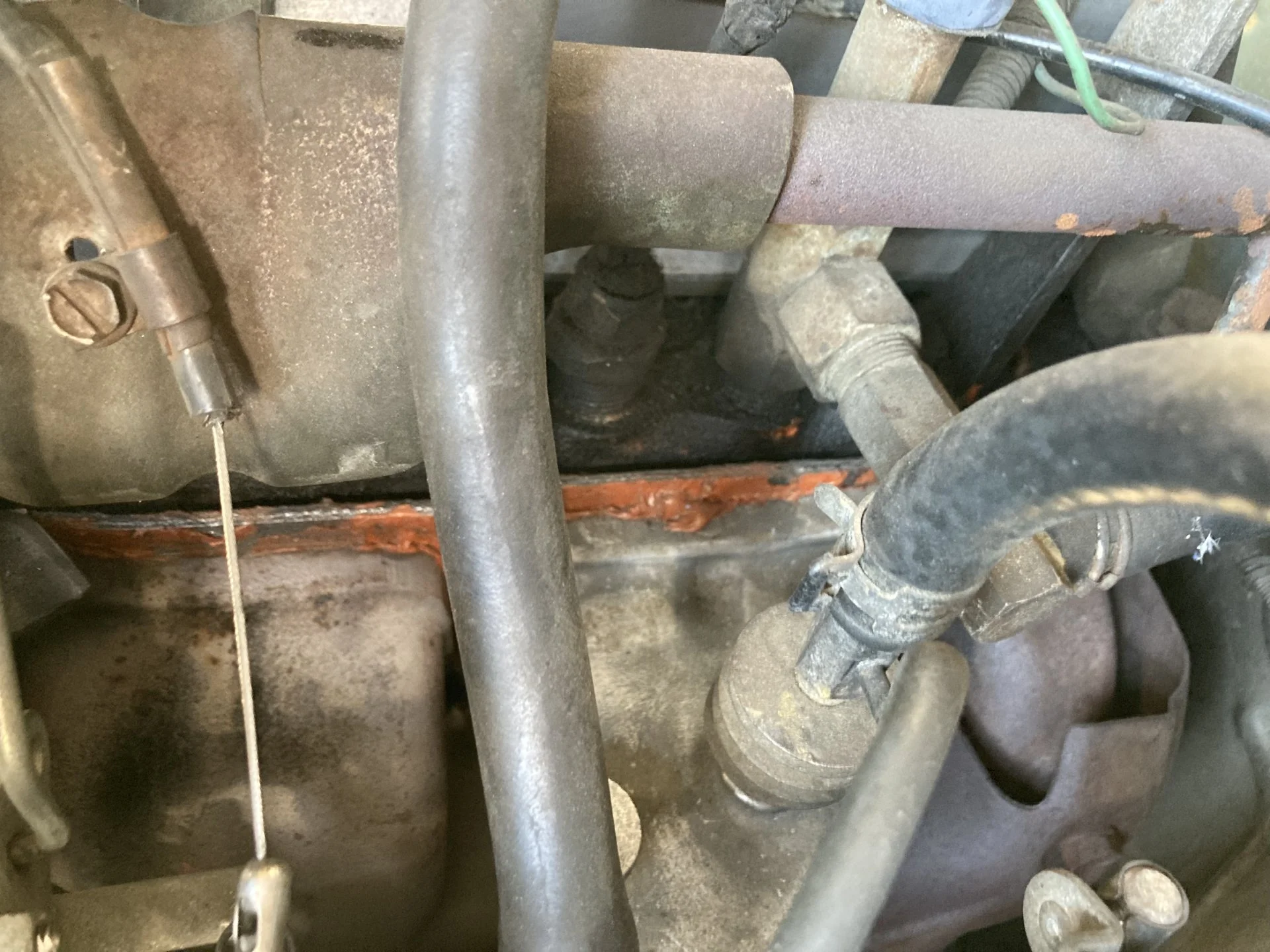

Other things I noticed… oil galley plug is good. Air rail to cylinder 6 - yes the same cylinder near which the block is supposedly cracked - has been clipped and the hole in the head plugged. All the other parts of the air rail are intact.

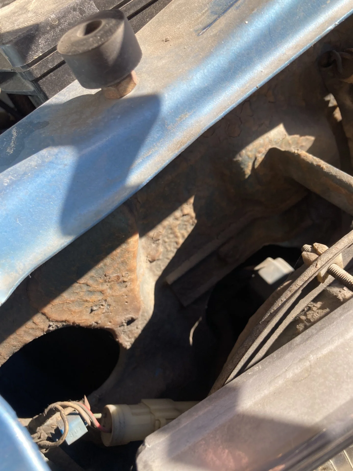

The area behind the grill looks like it was coated with cosmoline. Hey, no rust! It’s dry and waxy and scrapes off with a fingernail if you really dig at it.

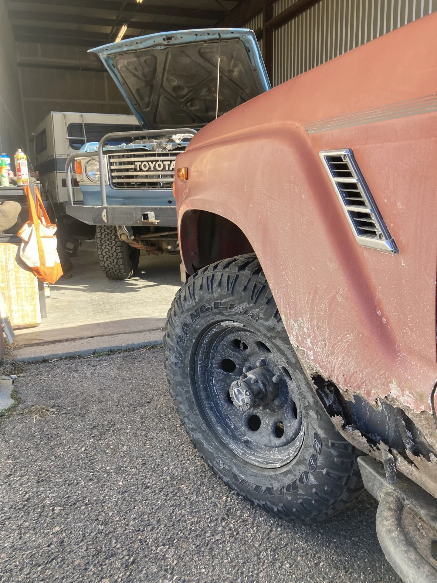

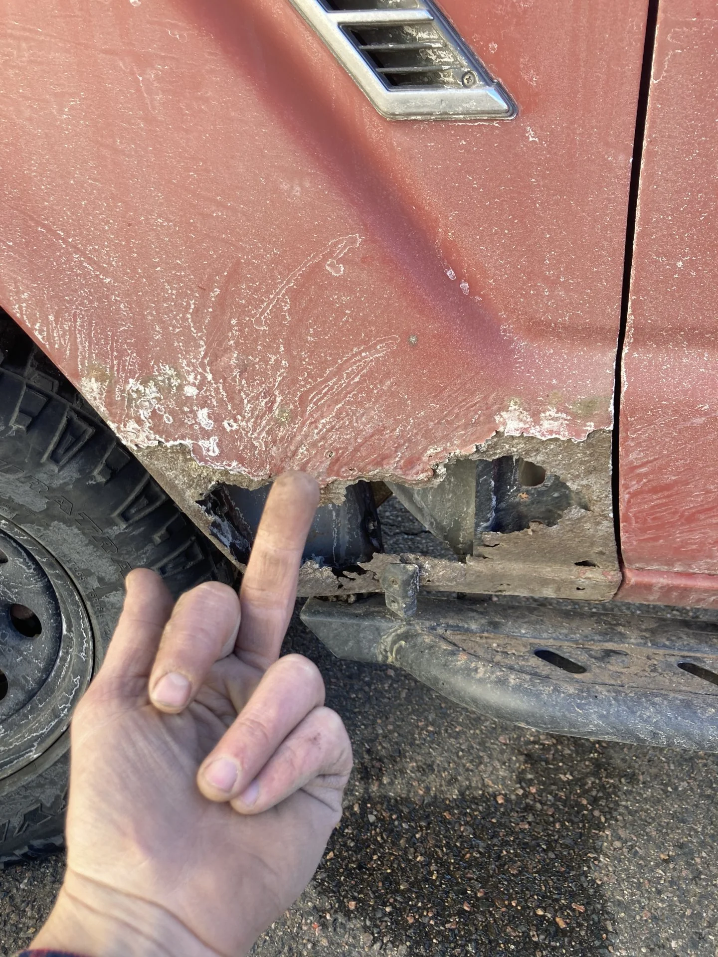

Onward to rust assessment… but first here’s what tomato looks like:

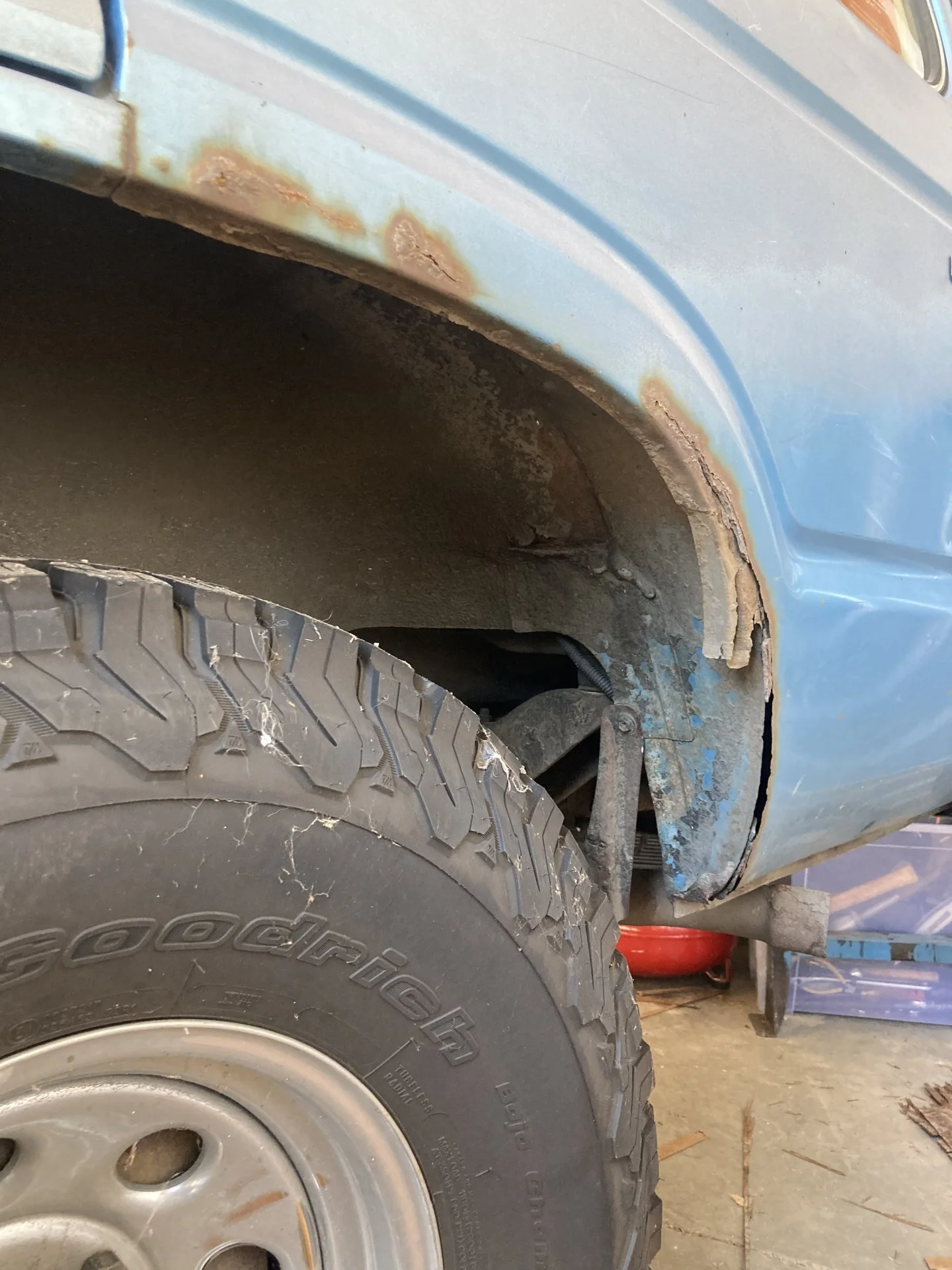

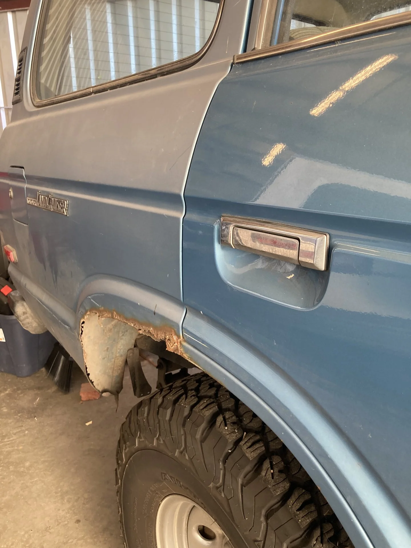

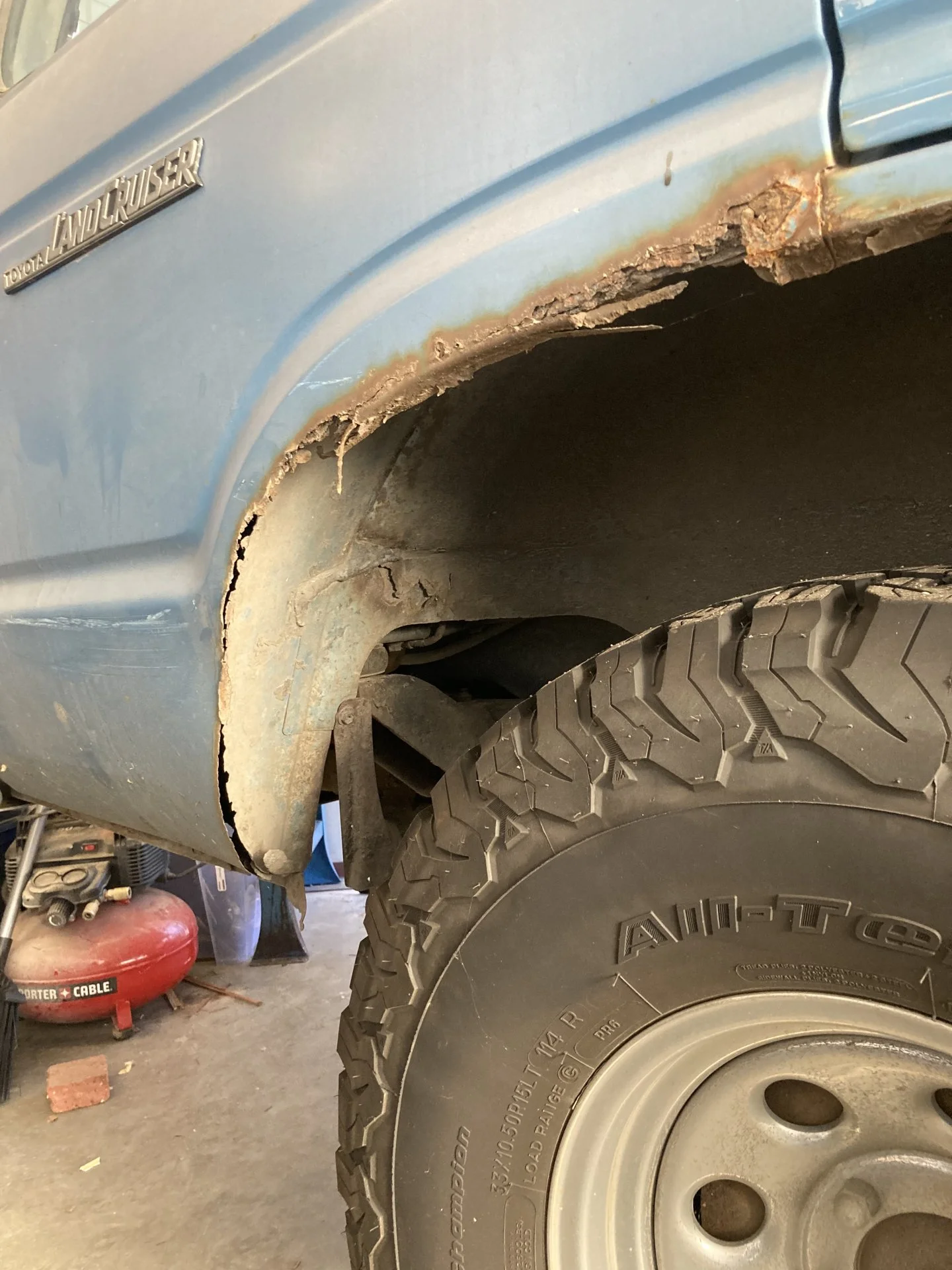

Rear quarters have a little more going on than I thought. It’s still almost nothing compared to the tomato.

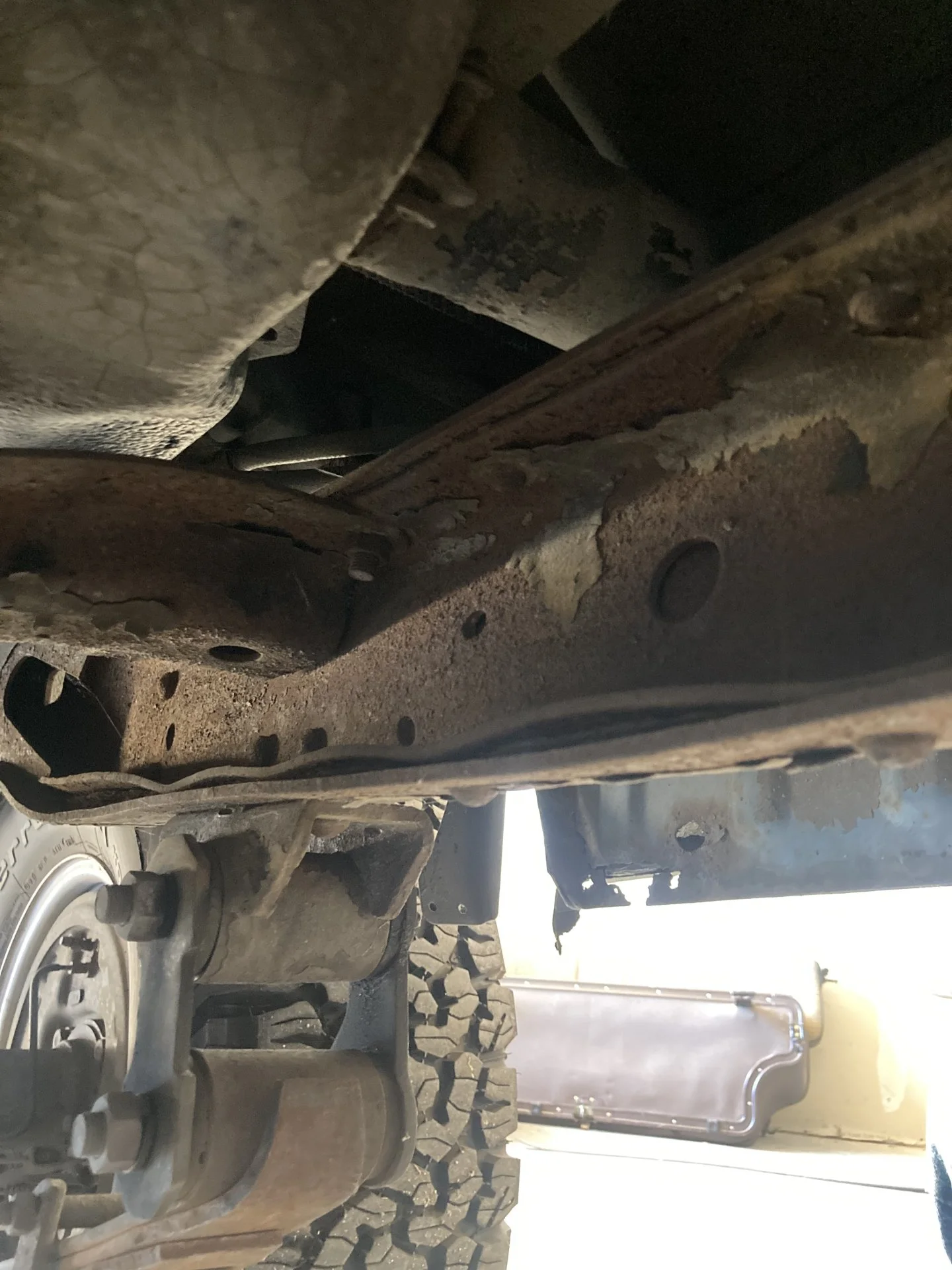

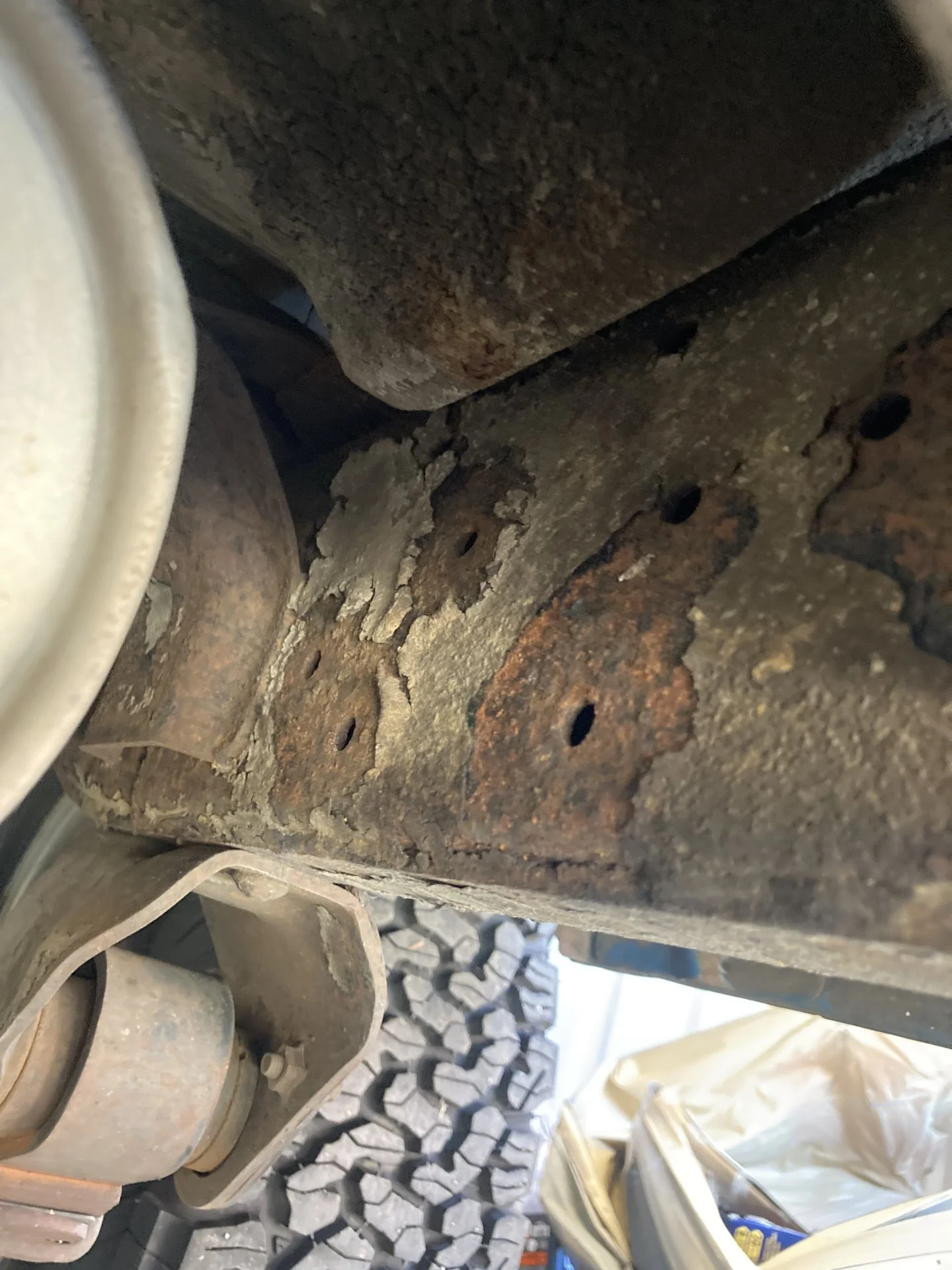

Surface rust in front of the forward hanger for the rear spring. Other side, behind the fuel lines, is about the same. There’s a surprising amount of the original frame coating.
C-channels are beginning their descent, but really this isn’t too bad.

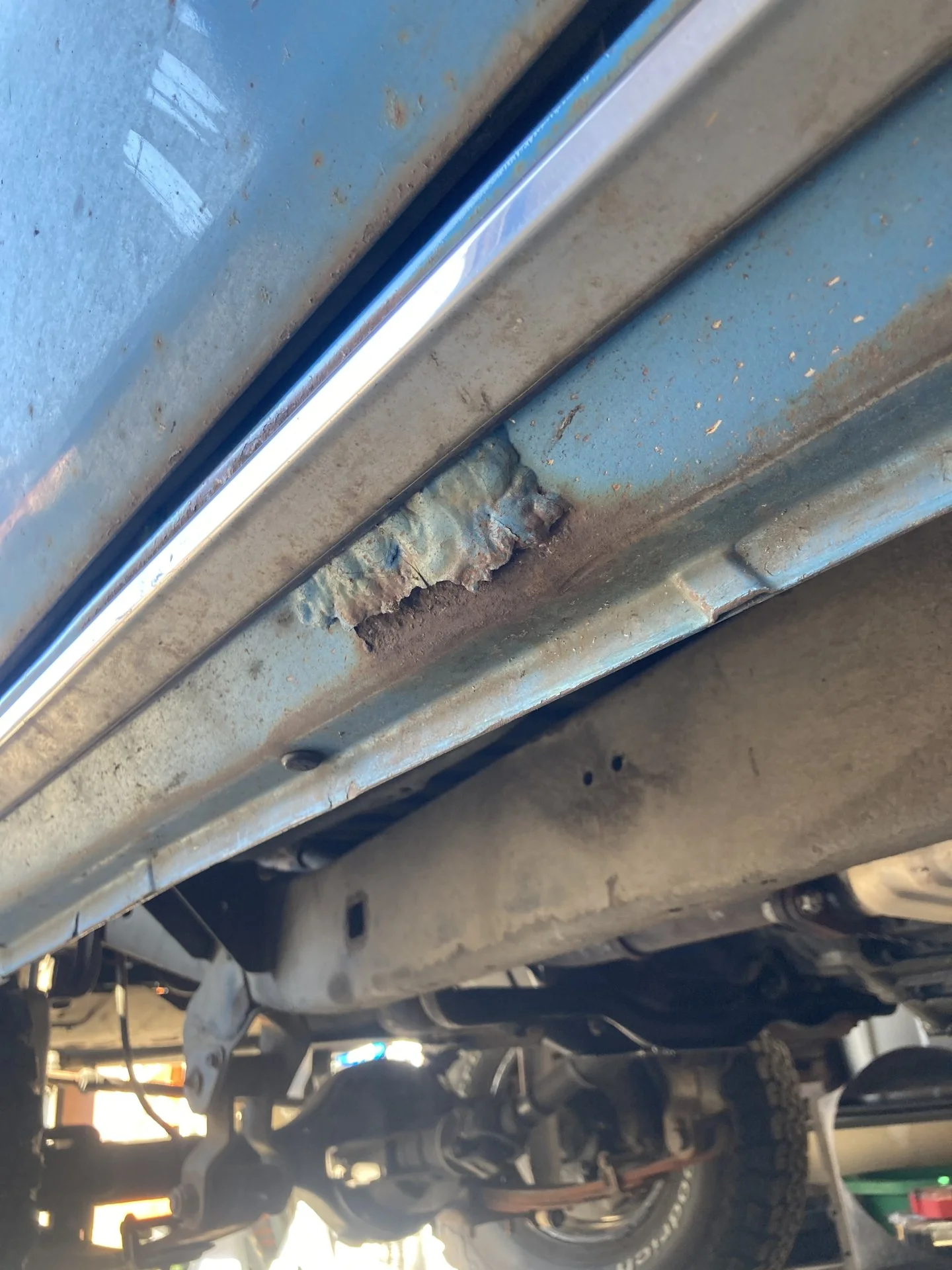

There’s some rust starting on the rockers.

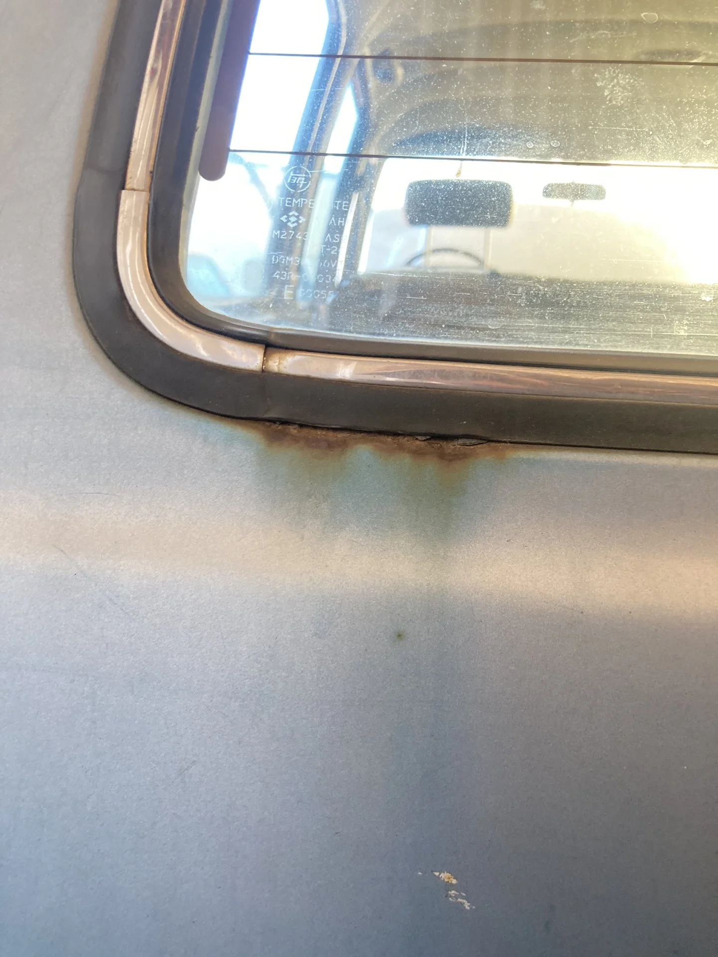

Back window frame has a thing going on. Front window doesn’t have any of this that I can spot.

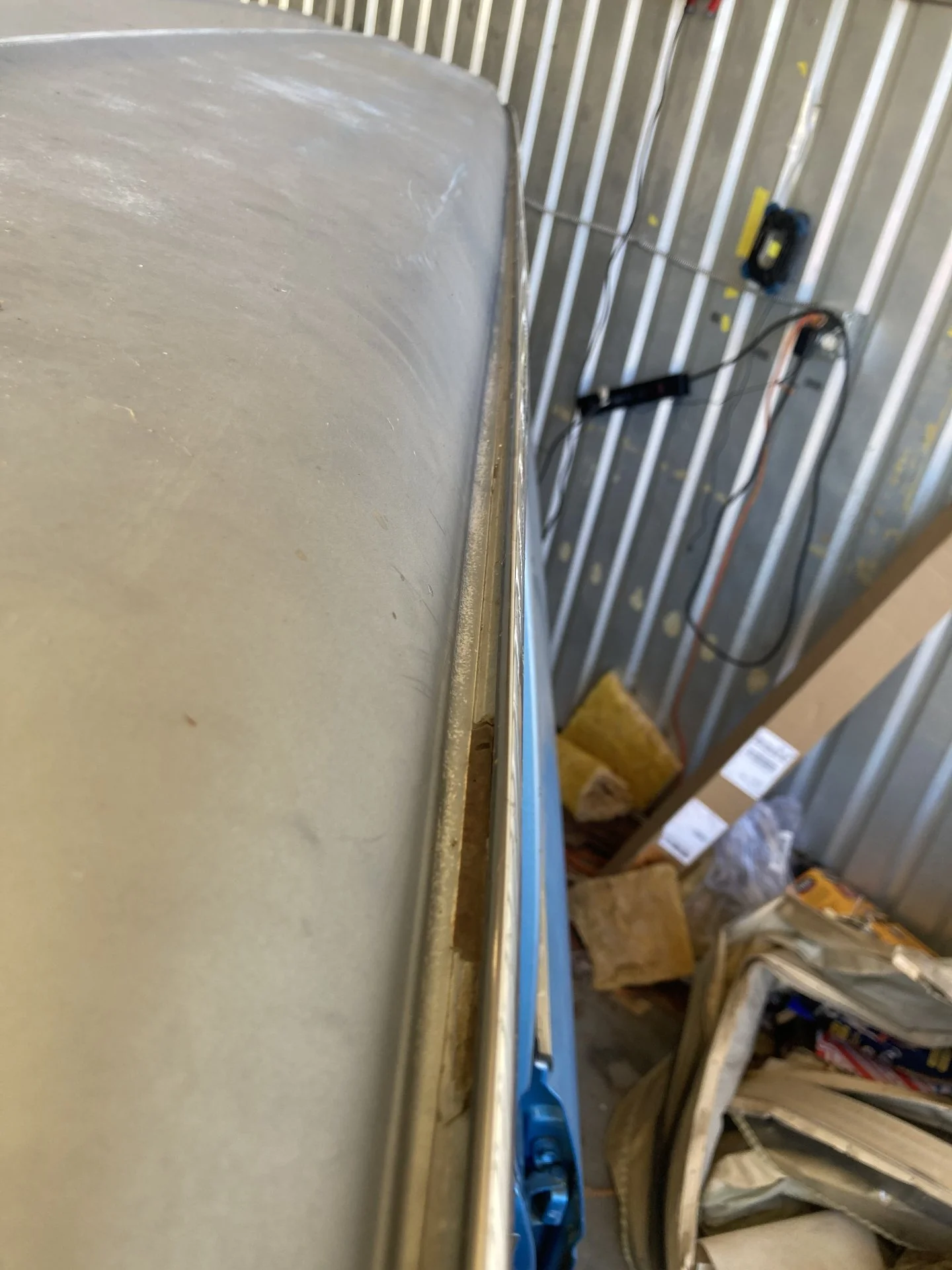

There’s one chunk of seam sealer missing on the drip rail, but otherwise it’s clean.

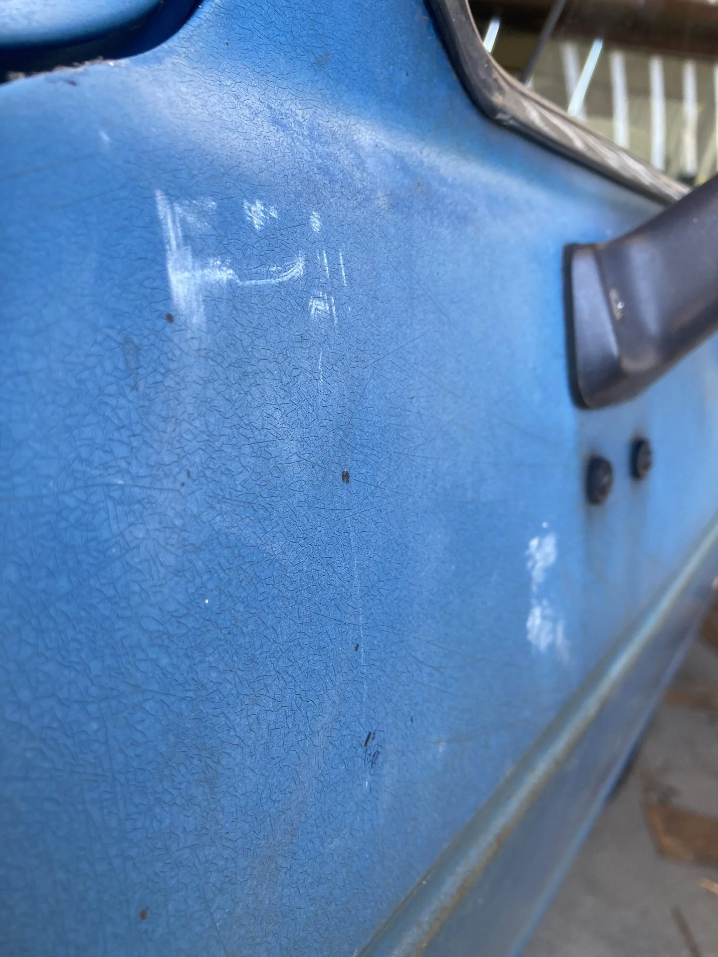

The driver’s door paint is doing a thing. Checking, crackling, whatever you want to call it. Not sure how this happens, but it will definitely need addressed.

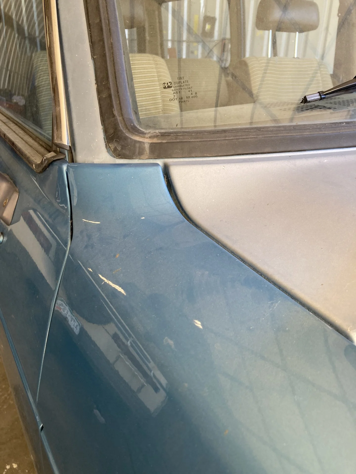

On to paint. It’s faded all over and each part looks like it’s half-faded differently. I kind of like the look.
And then we have the passenger side paint. The front fender and both doors look like they were resprayed. The color is a DEAD on match to #861. Like perfect. But there’s a little orange peel in the clear coat and it doesn’t match the rest of the truck at all because it really looks new. A magnet found no bondo, so no evidence of dent repair. The original seam sealer is intact on the front fender so it wasn’t ever replaced. I can’t find a line where new paint ends and old paint starts, not on the bottom of the doors or around the door jambs. I don’t get why this area looks so good and everything else is faded. Any theories?
The adjacent areas aren’t gray and they aren’t primer, they are just really faded blue. The fresh looking areas provide such a contrast though.

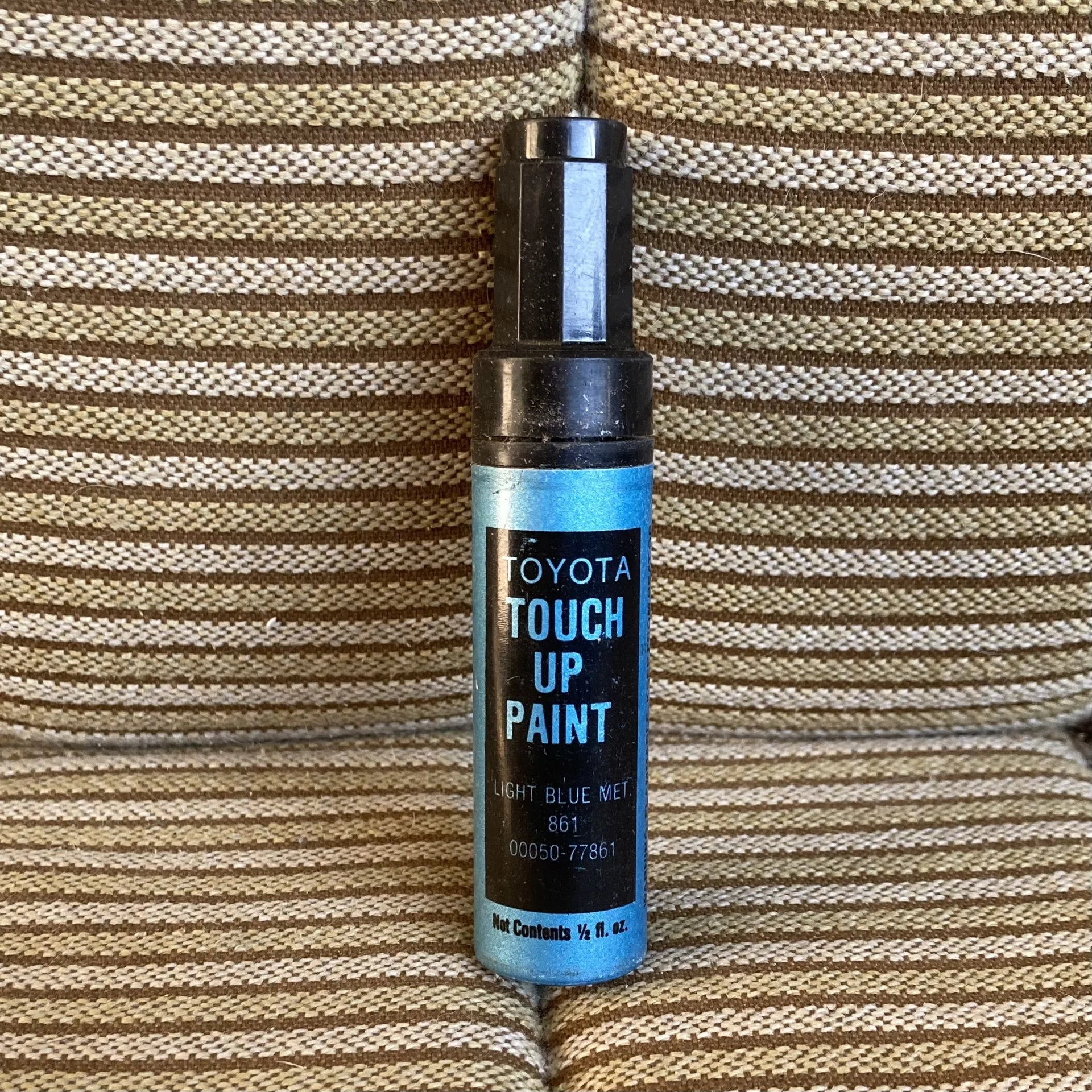

I found this in the glove box too. Anybody know where I could get a couple gallons of it? 😂

Also, thanks for the pix on the C channels. We have some of that flake too, and we thought it was the metal itself. Didn't know there was a factory coating that eventually starts to chip off. Ours isn't as far along but it's underway. Our mechanic just about had heart failure when he checked the underside, and told us it was a deathtrap. We're going to take it to TorFab here in WA state to get a more educated opinion about what to do with the underside.
These inner C-channels look darn good compared to a lot of them I see. @TRAIL TAILOR makes replacements, but the job is supposed to be traumatizing. You have cut and grind the old inner c-channels out which is roughly 742 rivets and some tack welds. Then clean everything up with a grinder and a wire wheel, coat the area with nasty solvent-based rust protectant of your choice, and finally install the new inner c-channels with new bolts & nuts.
